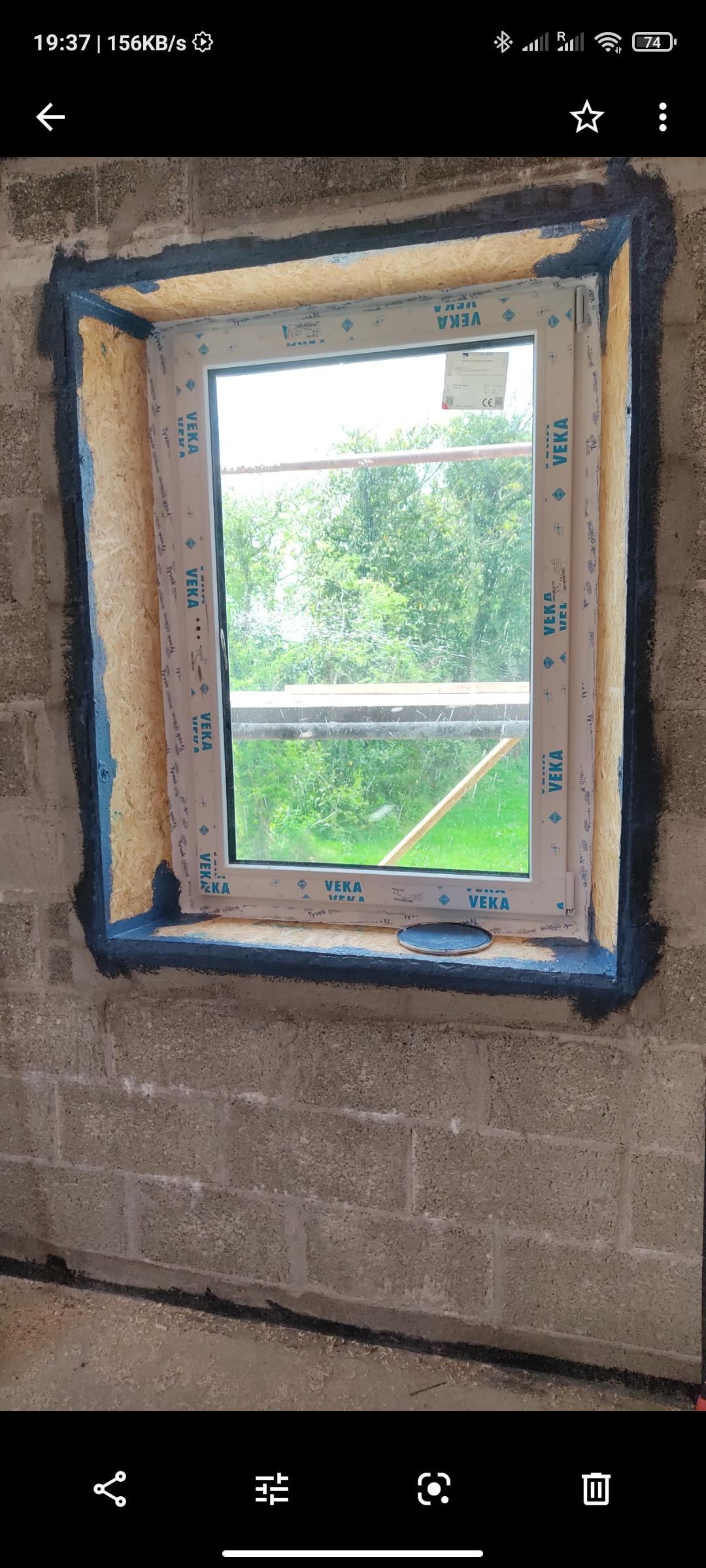

Oz07 Posted December 15, 2020 Share Posted December 15, 2020 Osb to jambs and heads foamed on with that illbruck airtight foam against the cav closers. Boards direct screwed to the osb afterwards. Same method with window board Link to comment Share on other sites More sharing options...

Iceverge Posted January 17, 2021 Share Posted January 17, 2021 0.31 ACH 50 with sand cement plaster here. On my preliminary testing with my DIY fan all the leaks were around the windows, doors, wall to ceiling junction, and back boxes where the electric drilled. These were quickly fixed with airtight sealant and tape. 1 1 Link to comment Share on other sites More sharing options...

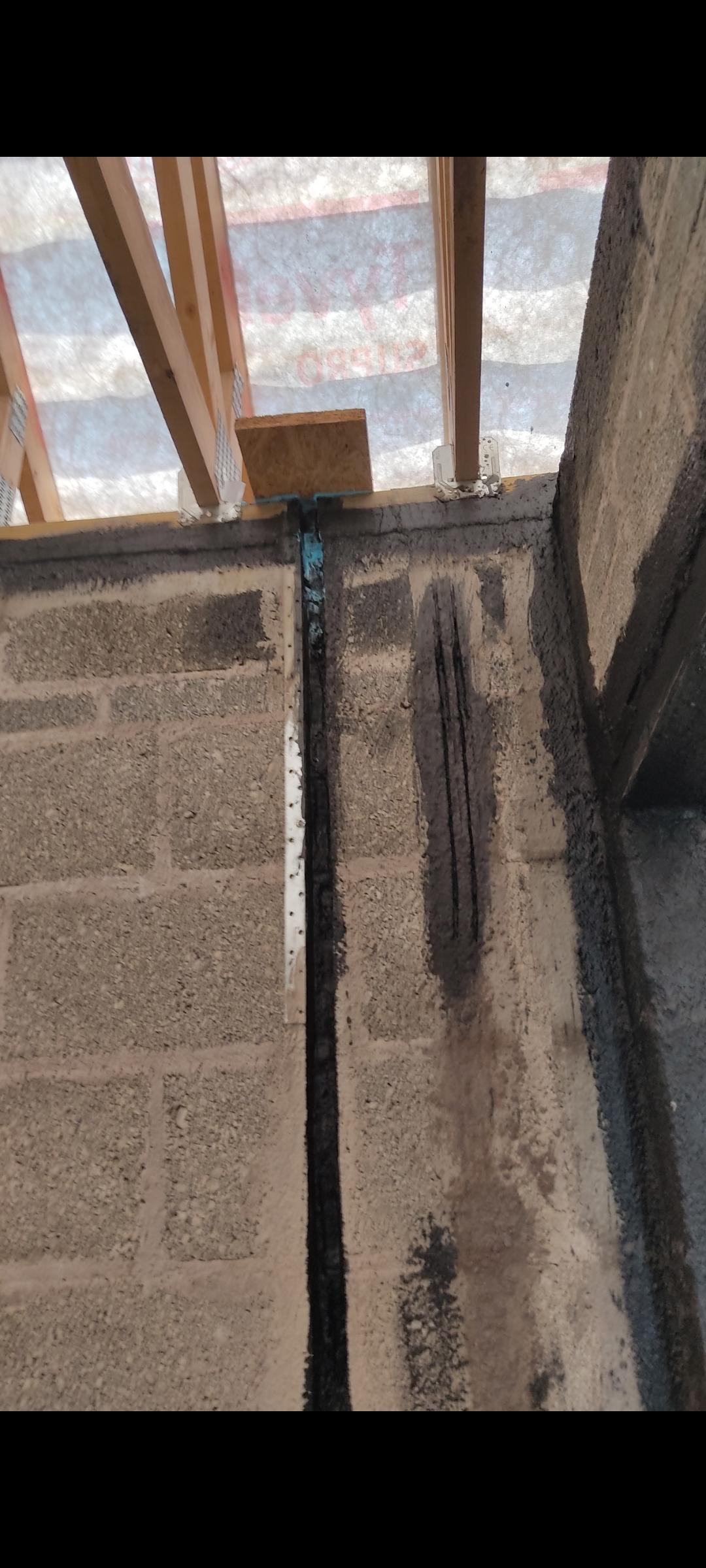

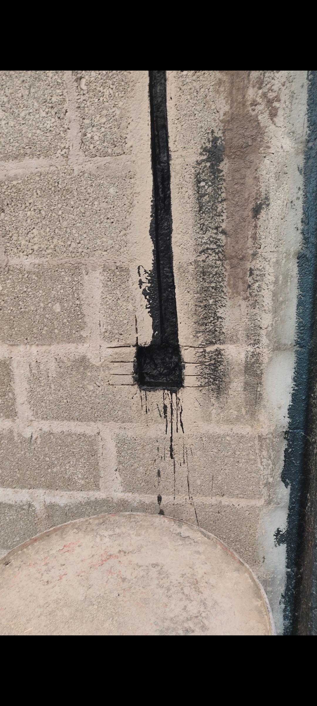

Iceverge Posted January 17, 2021 Share Posted January 17, 2021 1 hour ago, tanneja said: @Iceverge what was your strategy with the back boxes? Im torn between putty pads or airtight paint. I dont want to materially reduce the available internal depth of my backboxes as plan for zwave modules to permit automations. Not bought a putty pad yet to see how bulky it is. Airtight paint (belgacoat) in the chases and in the cut out for the boxes, wet plastered over everything afterwards. Airtight sealant for any pin holes detected later on as it was quicker for spot filling. I found priming the surfaces beforehand with a dilute solution of airtight paint improved adhesion and saved a lot of paint. Wrapping the back box isn't as robust a strategy in my opinion and it relies on the electrician. Link to comment Share on other sites More sharing options...

Iceverge Posted January 17, 2021 Share Posted January 17, 2021 How 4 minutes ago, TonyT said: No you wrap the metal boxes then hand them over to the electrician to fit as normal it then only leaves the cable entry hole and 2 fixing holes. I'm interested to know how this works. How do you stop air escaping from the chase at the back of the conduit? It can leak from the top or the conduit downwards along the exposed blockwork at the back of the chase that the wet plaster won't reach? What kind of blower door results have you had using it? Link to comment Share on other sites More sharing options...
joe90 Posted January 17, 2021 Share Posted January 17, 2021 2 minutes ago, Iceverge said: How do you stop air escaping from the chase at the back of the conduit? It can leak from the top or the conduit downwards along the exposed blockwork at the back of the chase that the wet plaster won't reach? Silicone or similar both ends of the chase Link to comment Share on other sites More sharing options...

Iceverge Posted January 17, 2021 Share Posted January 17, 2021 2 minutes ago, joe90 said: Silicone or similar both ends of the chase Before or after plastering? Link to comment Share on other sites More sharing options...
TonyT Posted January 17, 2021 Share Posted January 17, 2021 You aren’t going to get the top after plastering, that has to be done after cables are pulled in. Link to comment Share on other sites More sharing options...

Iceverge Posted January 17, 2021 Share Posted January 17, 2021 7 minutes ago, TonyT said: You aren’t going to get the top after plastering, that has to be done after cables are pulled in. My fear is that the silicon would be dislodged by the plasterers and electrician. We kept all the wiring inside the airtight envelope so air in the conduits itself wasn't an issue. My worry was the blockwork behind the conduit. Link to comment Share on other sites More sharing options...
