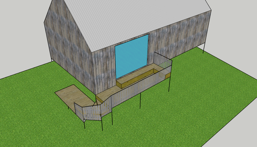

Crofter Posted January 26, 2017 Share Posted January 26, 2017 I've got an 8ft wide tilt/slide door on the front of the house, which currently opens a metre above the ground- obviously not ideal! This is due to the house sitting on piers above a sloping site. The plan is to have some sort of decking out here, where you can enjoy the view over the loch. I'd like it to lead around the side as well so that I can put a bench for people to sit with some shelter from the wind. I've searched Google images for decking ideas but most decking projects are far bigger than I had in mind, and would look pretty silly next to such a small house. A really big deck would also dominate the view out of the window. And with the sloping site, the further the deck extends from the front of the house, the taller the legs supporting it will have to be. I've thrown together a crude sketch of one possible design. The decking is 300mm lower than the floor of the house, so the step at the door is actually where you sit. This helps keep the pier height to 1072mm and also makes it easier to drop down meet the garden at the side of the house. Have given no thought yet to how I actually put it together... the winder stairs at the corner are easy in Sketchup but I suspect a little tricky in the real world Is it too small? Is the integrated seating a daft idea? What would *you* do?? 1 Link to comment Share on other sites More sharing options...

ProDave Posted January 26, 2017 Share Posted January 26, 2017 To some extent this is similar to our balcony we will have (except there won't be steps down from the balcony) It wants to be level with the door theshold, and at least 1.5 metres deep to allow for a table and chairs. To avoid spoiling the view it needs a glass balustrade. It's an easy structure to build and finish with standard decking timber. As your site is on a slope, rather than stairs, why not a gentle ramp leading all the way to the front where the ground level comes up to meet it? And then perhaps steps down from the right hand side of the deck (as viewed in the picture from outside) Link to comment Share on other sites More sharing options...

Crofter Posted January 26, 2017 Author Share Posted January 26, 2017 Thanks all. That first draft has a 300mm drop because that is the thickness of the floor buildup of the house. But no reason not to drop further, except that it might complicate things slightly in terms of structure. Ballustrade will probably be my old 5mm stainless steel rigging wire from my boat, it's just lying around looking for a job. Will need some new end terminals but the non-yacht grade stuff is quite cheap. Glass would be nice but from the little research I've done looks too expensive. Link to comment Share on other sites More sharing options...

Onoff Posted January 27, 2017 Share Posted January 27, 2017 (edited) Handrail height would concern me as you step out and are standing on the "seat". You'd be that much higher than when standing on the deck. Plus the danger/effect would be exaggerated if the deck doesn't project far enough - as in you've only one way to fall and that's over the handrail rather than onto the deck. (Especially after a wee dram or two!) I'd have the deck level with taller supports and disguise the height with bushes or by building the ground up a bit. As for putting it together I've seen some good brackets and connection techniques on kids timber climbing frames. You could even have a climbing net up the front or a love seat down below! Edited January 27, 2017 by Onoff Link to comment Share on other sites More sharing options...

Crofter Posted January 27, 2017 Author Share Posted January 27, 2017 More food for thought, thanks. I think I can work out the safety aspect. As viewed in the sketch, only the RHS half of the door opens, so the ballustrade that runs behind the shorter section of seating sticking out from the wall should be close enough to use as a handrail, with your left hand. Would need to replace the top wire with an actual wooden rail (maybe I need to do that all the way round actually). Not averse to making the decking a wee bit 'deeper' i.e. project out from the house a couple of feet more, especially if I drop it down by a second step. I'll spend a couple of minutes on Sketchup and come back with a MkII... Link to comment Share on other sites More sharing options...

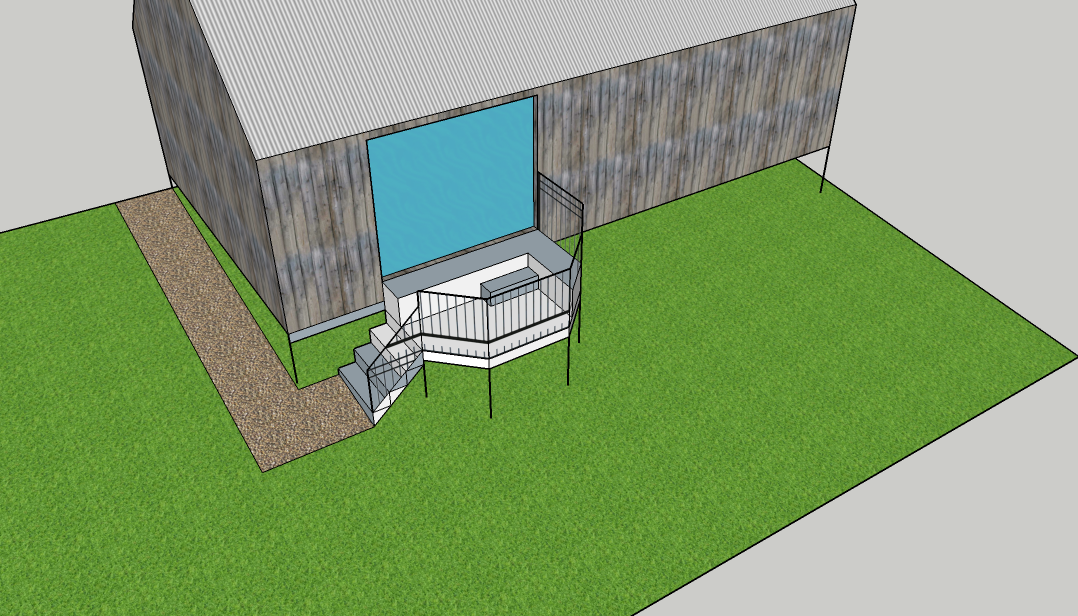

Crofter Posted January 27, 2017 Author Share Posted January 27, 2017 Next version... Link to comment Share on other sites More sharing options...
Auchlossen Posted January 27, 2017 Share Posted January 27, 2017 There are many proprietorial solutions to slippery decking, x2 costwise but probably worth the extra, eg rubber inserts. If BC have an interest, then horizontal SS cables will not be welcomed for the handrail. One cheap solution that I looked at was polypropylene mesh. Need to prevent folk Climbing and falling off. On design, I would be more inclined to extend round the corner, and use the slope to reduce the number of steps. Link to comment Share on other sites More sharing options...

Ferdinand Posted January 27, 2017 Share Posted January 27, 2017 1 hour ago, Crofter said: Next version... Surely round the corner makes sense as you get a longer sun on deck period? F Link to comment Share on other sites More sharing options...

Crofter Posted January 29, 2017 Author Share Posted January 29, 2017 On 27 January 2017 at 18:40, Ferdinand said: Surely round the corner makes sense as you get a longer sun on deck period? F The wall with the patio door is facing west, so going round the corner takes you on to the north facing gable. So you'll onoy get sun there very late in the day in summer, but it will be out of the wind. I was thinking some sort of bench seat round there would do the job, no need for building a much bigger deck. Likewise, the idea with the short 'L' on the integrated seating is that it tives you somewhere to sit with your back to the wind. It's not a lot of seating area but there will only be two people in this house. The ballustrade on the right hand edge of the decking would be more solid to provide a windbreak (I could even look at doing that one bit in glass?) Link to comment Share on other sites More sharing options...
