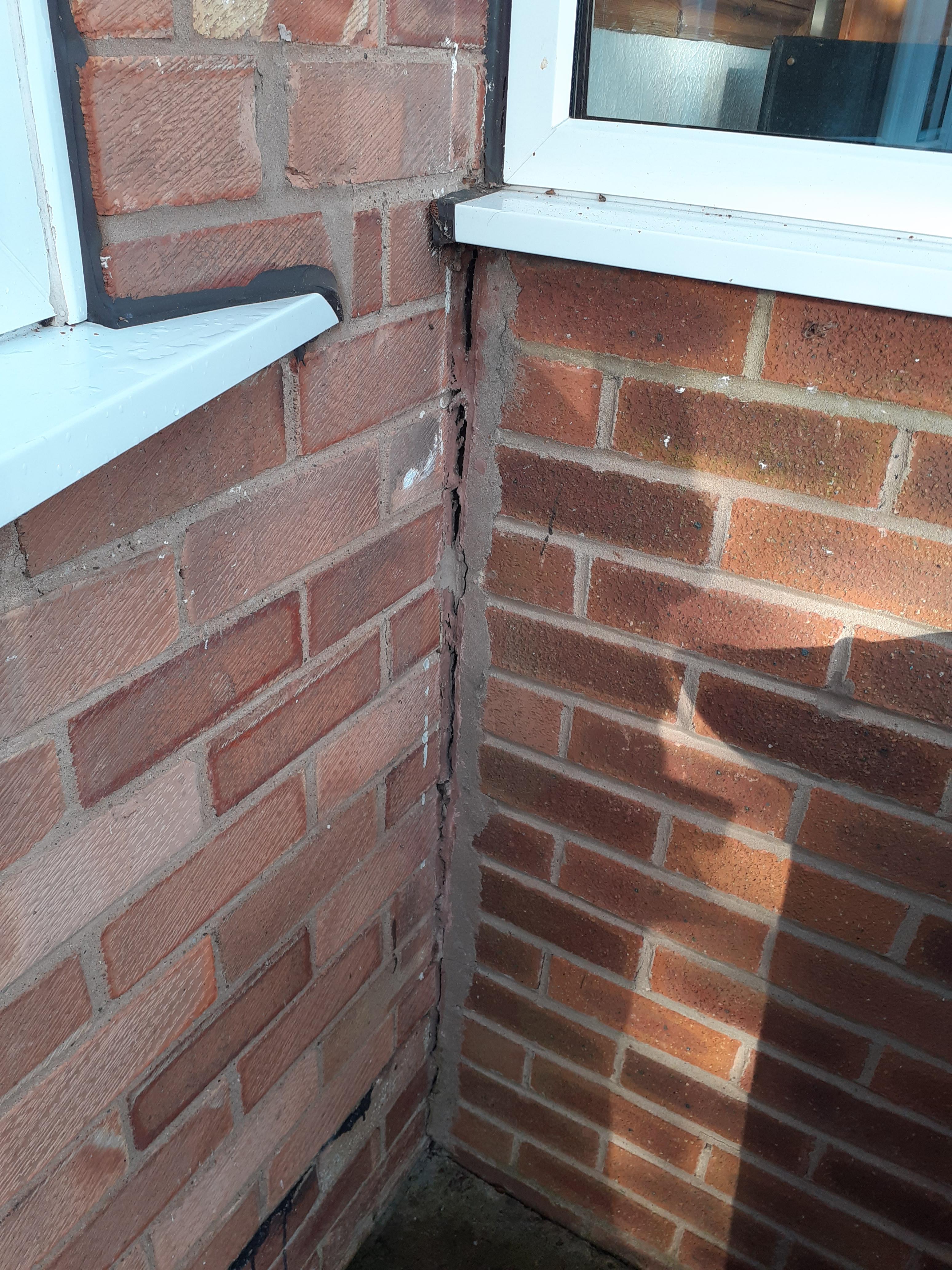

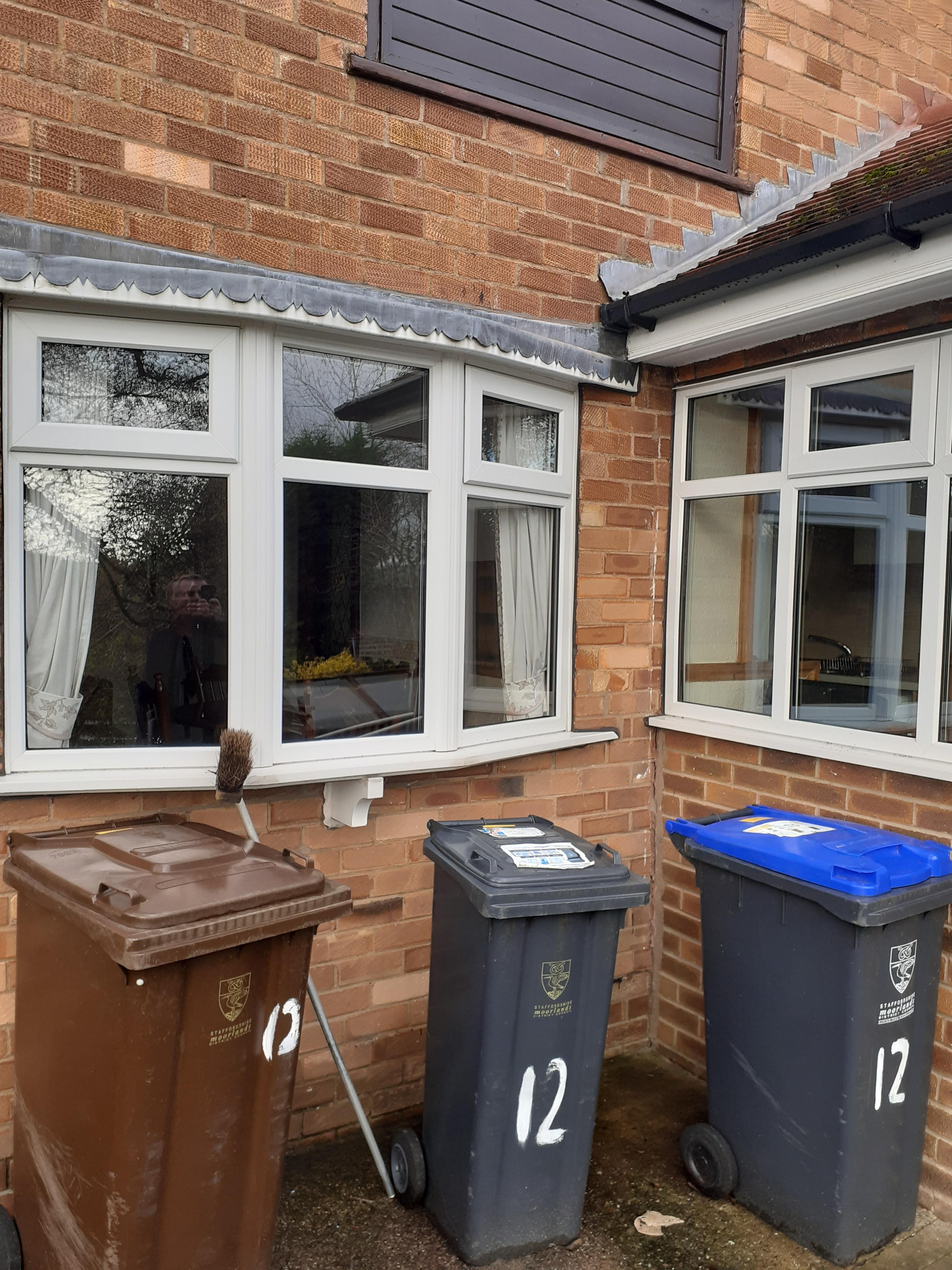

Endon Posted December 7, 2020 Share Posted December 7, 2020 Hi All, In the process of buying a property which requires full internal refurb. Having a Home Buyers Survey completed on the 15th Dec and as the place is empty went and had a further look without the agent hanging over my shoulder! There is a single storey kitchen extension to the rear, approx. 8x8 with a pitched roof. On this further inspection I saw that on one of the walls where the extension meets the main wall there is a fairly large crack (photo attached). Its been ‘masticed’ at some stage and looks fairly old. Thinking maybe movement or not tied in correctly but I am certainly no builder so wouldn’t really know! The crack appears to be just on the one side of the extension. Anyone any thoughts? Obviously will get the surveyor to have a good luck at it but would welcome any thoughts from anyone who has dealt with a similar problem. Thanks all, P. Link to comment Share on other sites More sharing options...
Dave Jones Posted December 7, 2020 Share Posted December 7, 2020 certainly isnt brick bonded into the wall, something like the fix below should have been used. https://www.screwfix.com/p/sabrefix-wall-starter-kit-stainless-steel/56037 There also isn't evidence of a DPC so likely to be a DIY job, the footings were crap and its dropped. Worst case you pull it down, would it effect the value ? Link to comment Share on other sites More sharing options...
Mr Punter Posted December 7, 2020 Share Posted December 7, 2020 It looks quite bodged but it could outlast the rest of the house. It may have replaced a previous lean-to or conservatory. Does it have building regs? Link to comment Share on other sites More sharing options...
epsilonGreedy Posted December 7, 2020 Share Posted December 7, 2020 What worries me is that there has been further movement since the mastic was used to seal the initial crack, this suggests the problem is ongoing and developing further. In general surveyors and builders are not too troubled by cracks providing they understand why the crack originally developed and are satisfied the motive force behind the problem has ceased. Link to comment Share on other sites More sharing options...

dangti6 Posted December 7, 2020 Share Posted December 7, 2020 Looks like they started lining up the courses nicely but totally lost it half way up. White paint line up the wall does suggest something like a lean to was there before in the same place. Potentially reusing those footings. Link to comment Share on other sites More sharing options...
Endon Posted December 7, 2020 Author Share Posted December 7, 2020 Thanks for the comments. I suspected that it may have replaced an old conservatory but no one has any of the build details. Sadly the owners have both died and its a probate sale so will have to see what the surveyors come up with. Have no idea what the cost would be to take down and re-build if required but it would certainly blow the budget! Shame is that its sits on such a good plot I still kinda want it ? Link to comment Share on other sites More sharing options...
ProDave Posted December 7, 2020 Share Posted December 7, 2020 If you can get it at a decent price I would be inclined to do nothing straight away, re seal it, an monitor for more movement. Is it really worth completely demolishing and re building just for a small crack in a single storey annex that is not likely to make it collapse? You might dream up plans in the future for a better, more ambitions extension and then it would be worth demolishing to start again with something bigger and better. My BIL lives in a 300 year old farm house. Every summer a small crack opens between the original house and the 200 year old extension and closes again in the winter. 1 Link to comment Share on other sites More sharing options...

PeterW Posted December 7, 2020 Share Posted December 7, 2020 Wonder if that is cheap brown mastic that has shrunk away as the gap looks fairly equal. If it was moving I would expect it to pivot away from the wall more at the top. Can always rake it out and repoint it. If you want belt and braces then use helical pins from the inside drilled through into the brickwork of the extension. Link to comment Share on other sites More sharing options...
tonyshouse Posted December 7, 2020 Share Posted December 7, 2020 I would always prefer to see a movement joint in such circumstances (unless built as original building on same foundations at the same time). Not a big surprise, I would add an acme measuring gauge and report to your insurer that you are monitoring a crack, photo it every month and save in a spreadsheet - we are looking for ongoing or cyclical movements if not big problems simply Re mastic it Link to comment Share on other sites More sharing options...
