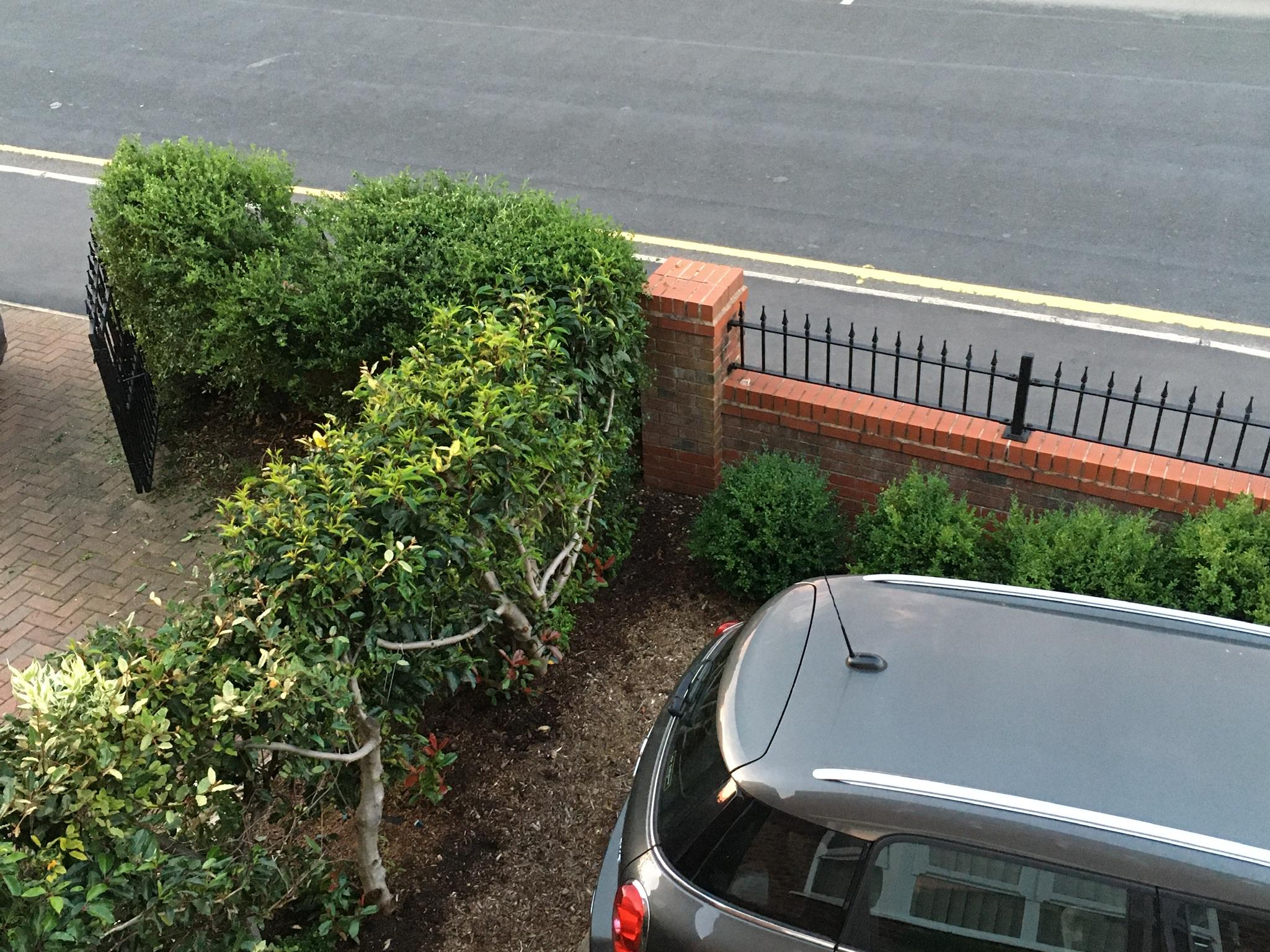

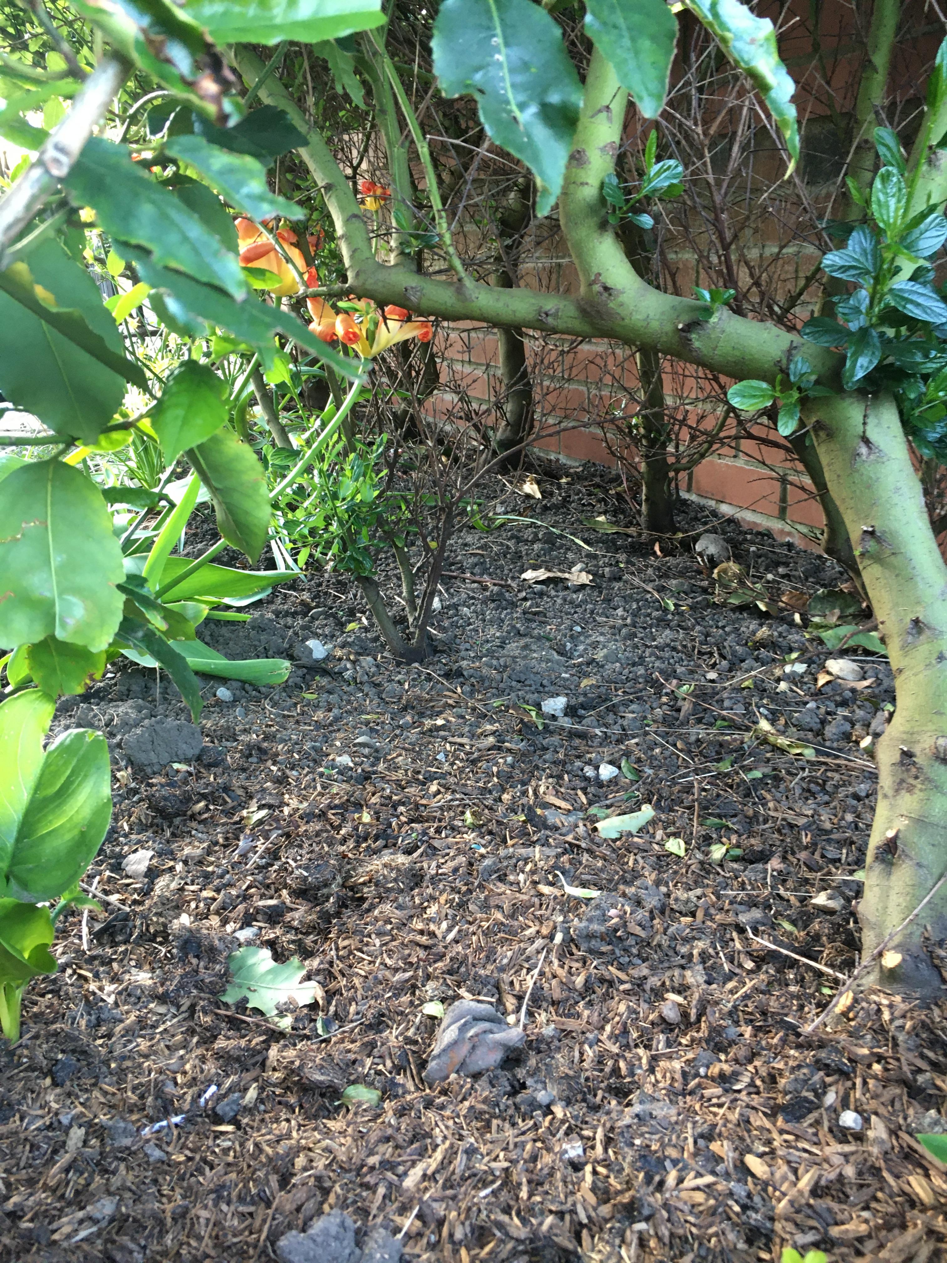

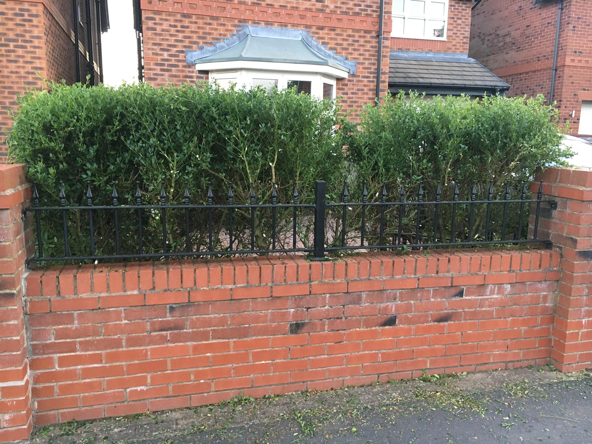

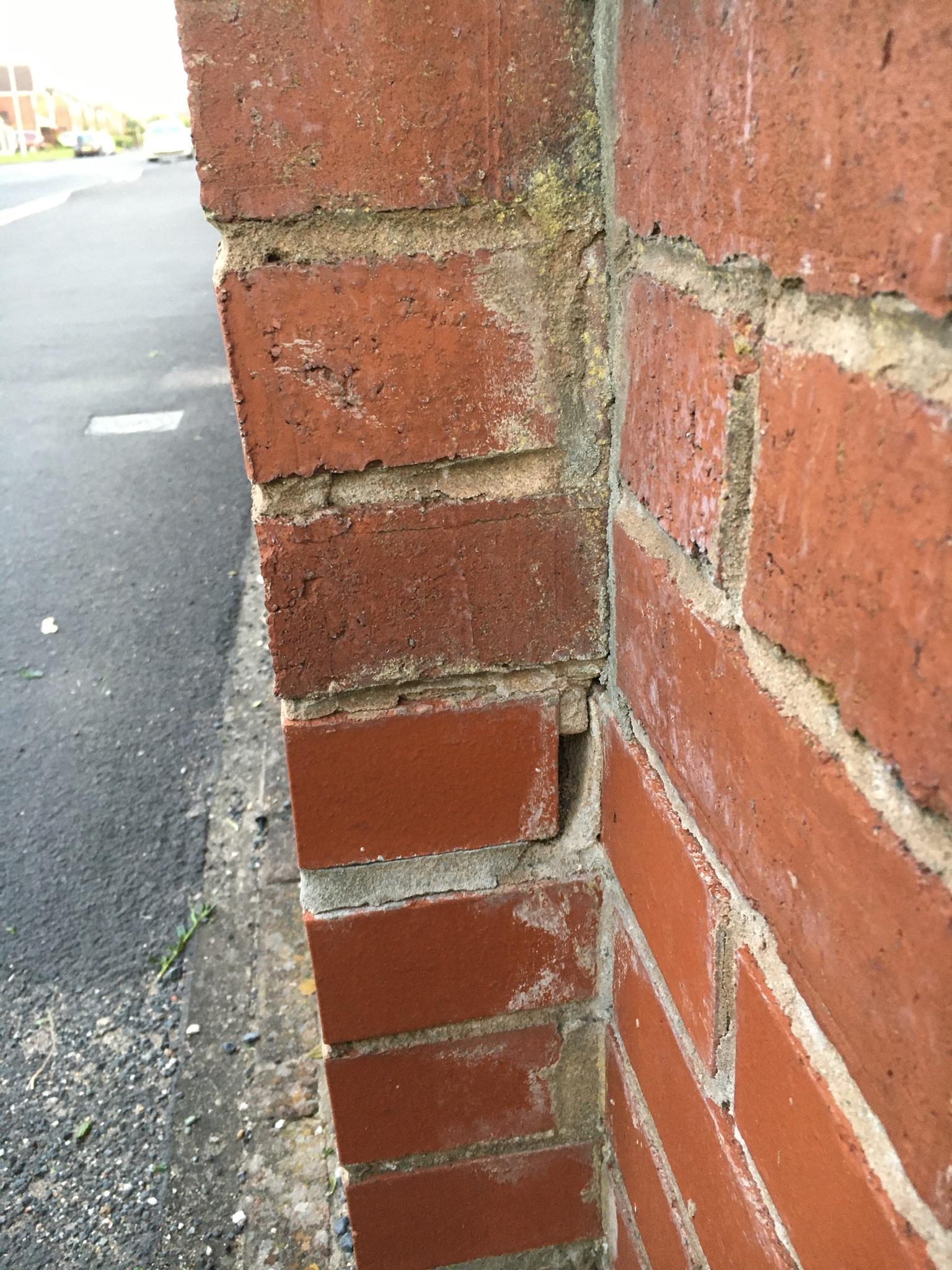

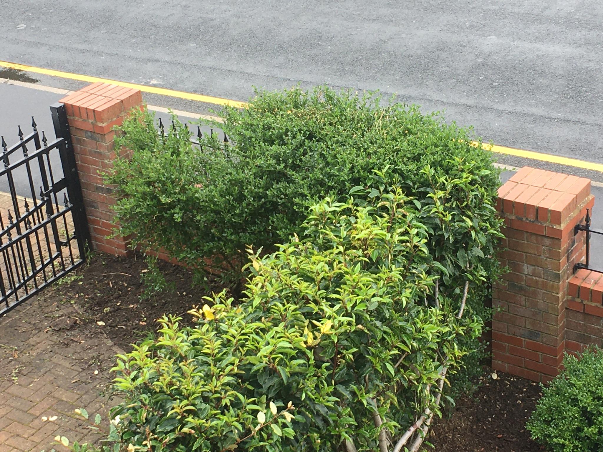

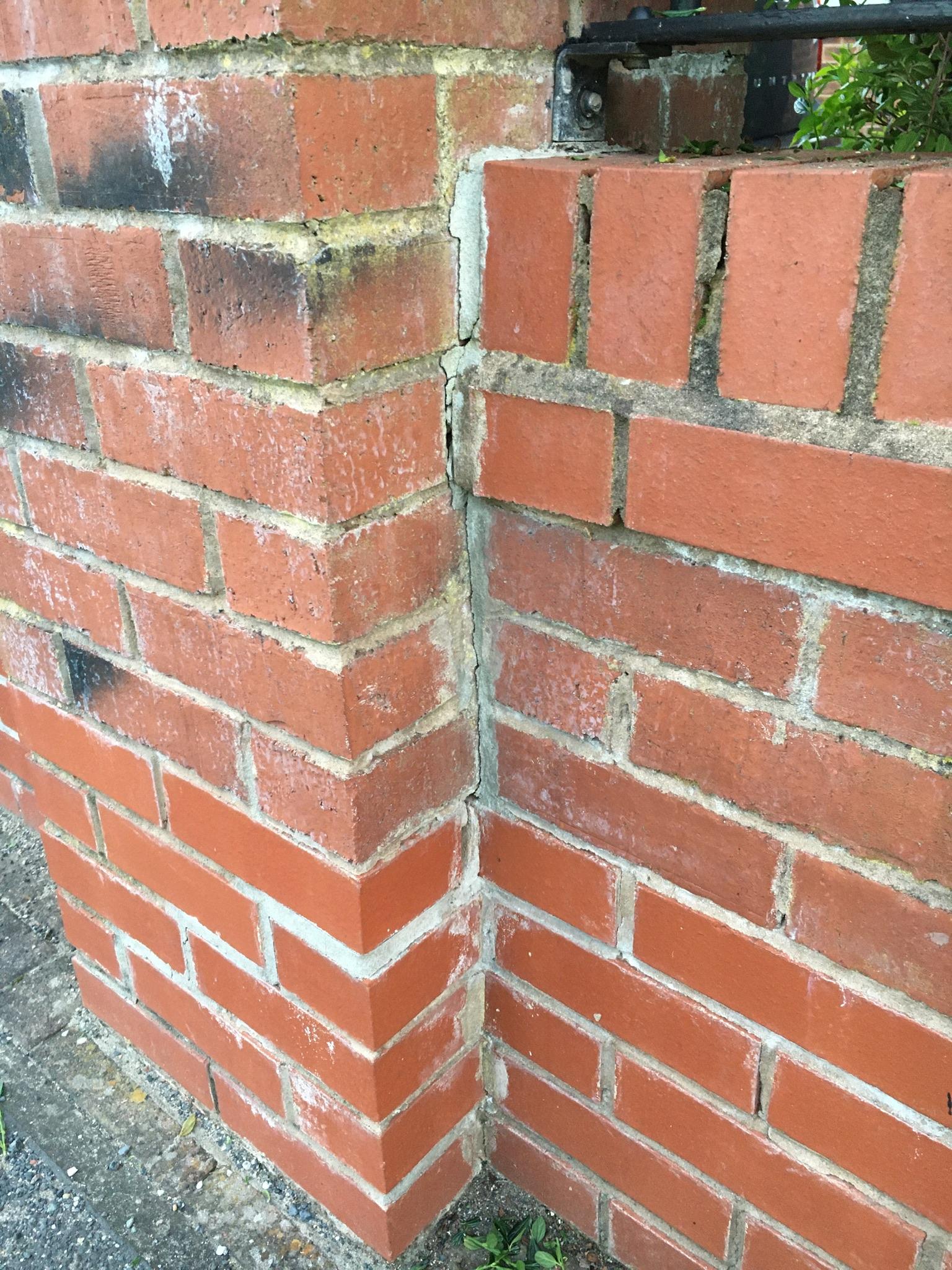

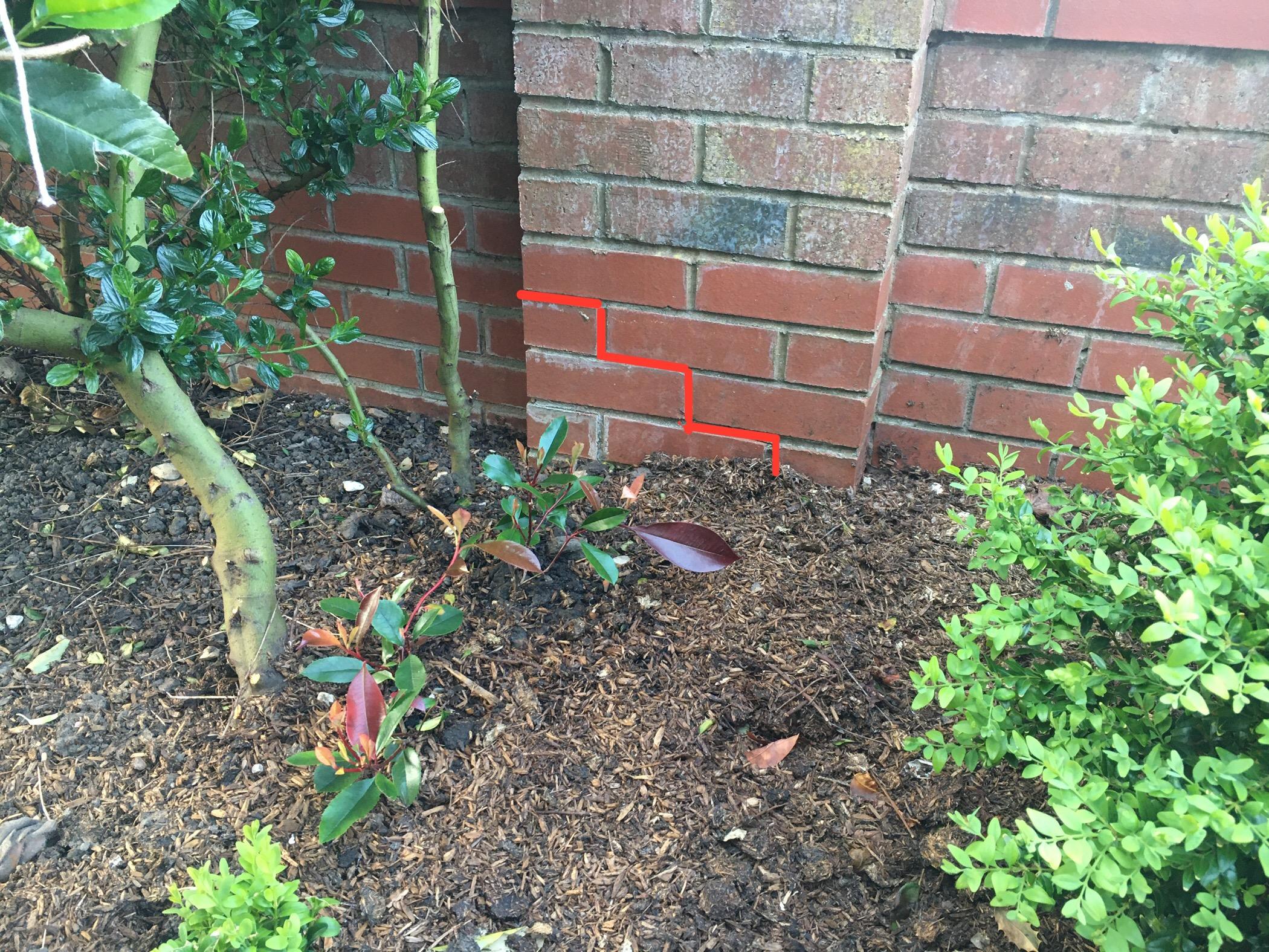

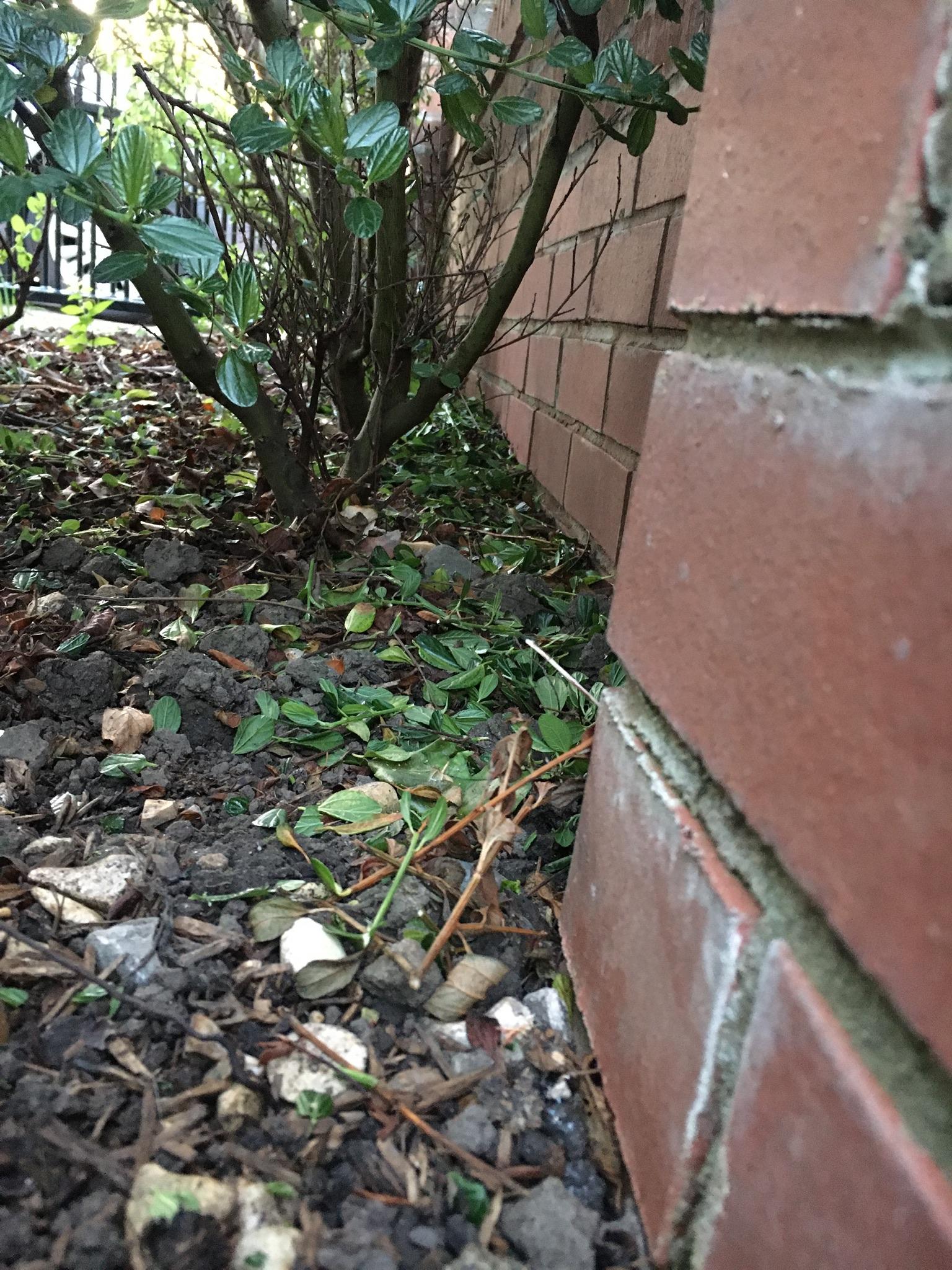

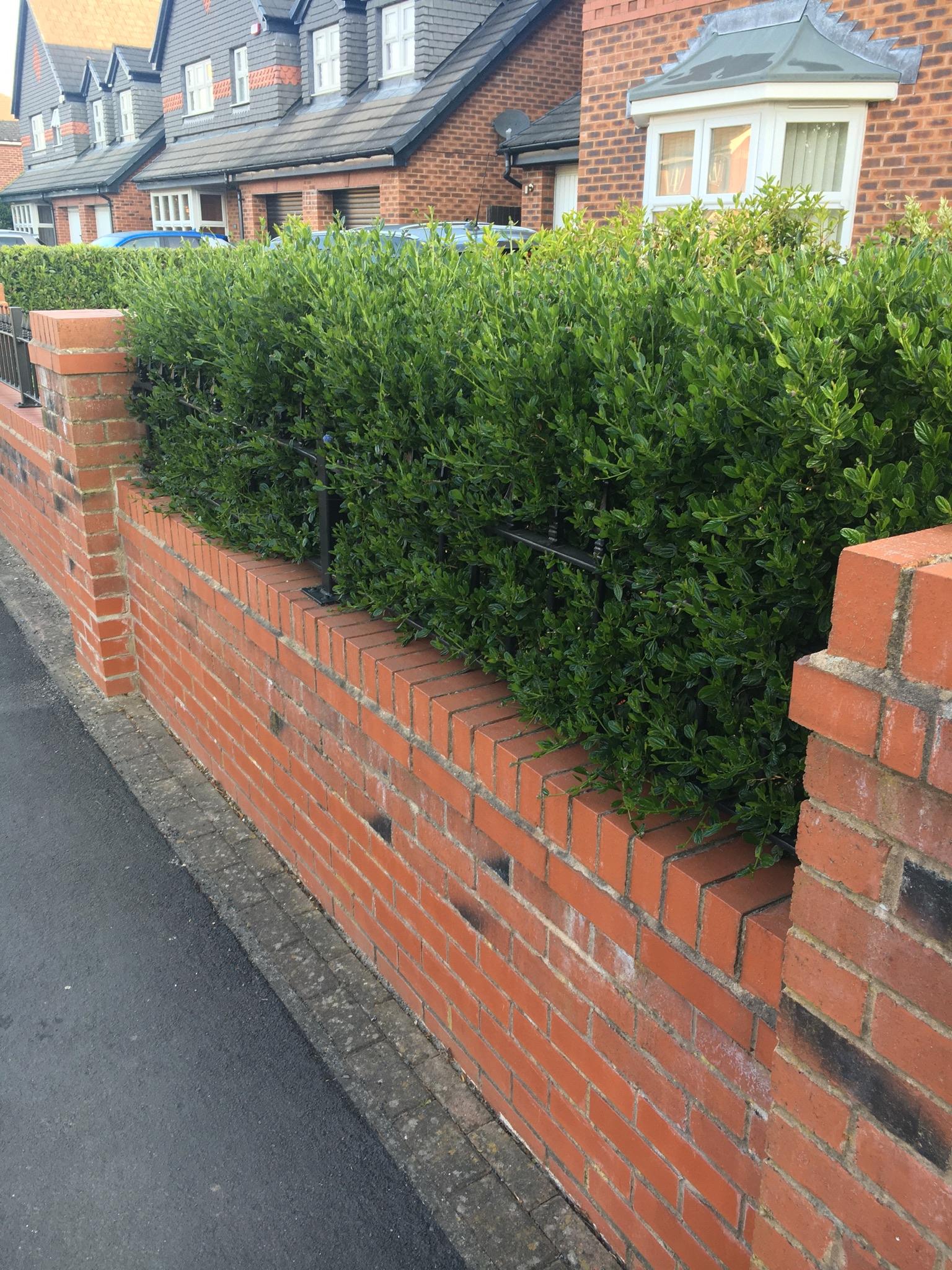

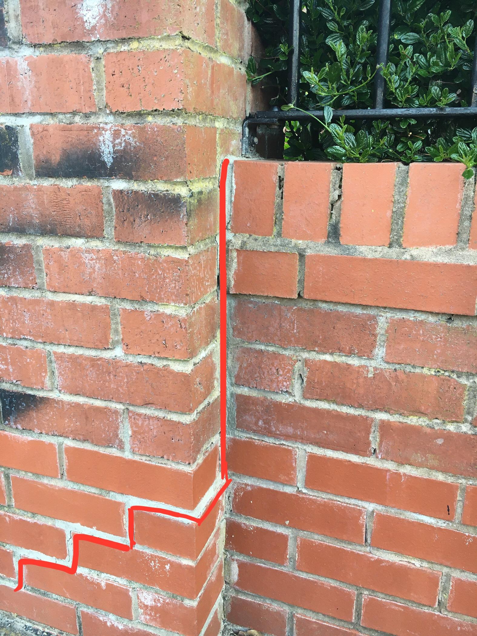

HappyDays80 Posted December 6, 2020 Posted December 6, 2020 Hi there Would be grateful for some advice. I share a boundary wall with my neighbour which acts as a partition between the public pavement and our properties. We both live in a detached house with this wall spanning across as the front border. There are 3 pillars and 2 walls and 2 railings. The middle pillar divides the boundary (with end pillars on either side). My neighbour had decided to grow a California Lilac right up against their wall which has resulted in the central pillar developing 3 cracks ( 2 of the cracks are at the base and match from front to back which indicates the pillar is not supporting the wall but is now being supported by the two walls either side). I raised this issue with my neighbour amicably – they removed the hedge but now refuse to repair the central pillar –They are disputing that the hedge had no cause for this damage - Legally where do I stand? What is reasonable? Communication has gone down hill. I did take pictures of the hedge before they removed it for my own records. The deeds state we are responsible for our boundary walls - equally the middle pillar is supporting our own boundary walls so common sense says to me that both of us are responsible for its repair. Equally I feel nothing is on our side that has contributed to this damage, when they have an obvious aggressive hedge planted so close to their wall putting strain on the central pillar - also on the outside of the wall joining the central pillar on the neighbours side the mortar is crumbling away. See pictures what is the probability that the hedge was responsible considering how it planted so close to their side of the wall? any opinions would be much appreciated.

Jilly Posted December 6, 2020 Posted December 6, 2020 Even if that was in a building it would be 'treated' by simply removing or reducing the offending trees and monitoring. Ceanothus is not known for being damaging or thirsty. I would stop worrying and try to repair your relationship rather than the wall... 1

HappyDays80 Posted December 6, 2020 Author Posted December 6, 2020 Hi folks Much appreciated for all your comments. Completely respect and value what you say. The wall is not about to fall I agree but I personally do not want a problem further down the line, equally it has already been raked out and attempted to be repaired which has not worked. You are correct it is not worth falling out over the neighbours but equally they have not reciprocated my communication in discussing options as they feel they are not responsible and the hedge has no bearing on the wall. I have grown California lilac in my back garden and i disagree as it can grow big and the issue is not the plant per se....it’s planted too close to the wall for its size. I agree with you Joe that removing the hedge can also be a problem too....hence why I suggested we should get advice before removing it....they made the decision to remove it but now the cracks are open to weather......they have been raked and filled in before which did not work. im afraid the building of a rapport has been worked on ( even prior to this) but unfortunately some folk do not want to reciprocate this - only so much trying you can do.
Russell griffiths Posted December 6, 2020 Posted December 6, 2020 I would say the wall has been built on standard poor garden wall type footings, it’s done a bit of settling. Yes the shrubs wouldn't have helped, but I don’t think I would loose any sleep over it. @Jilly well done spotting ceanothus from those pics.
Roundtuit Posted December 6, 2020 Posted December 6, 2020 (edited) As above; looks like the quality of the wall and foundation isn't the best and there's been a bit of settlement. I don't think you can reasonably pin it on the hedge. There are garden walls like this everywhere; as @joe90 said, just point it up for now. Edited December 6, 2020 by Roundtuit typo
HappyDays80 Posted December 6, 2020 Author Posted December 6, 2020 Thanks Russell and Roundtuit - good to know these facts. I’m just confused as to why the other 6 walls have not behaved in the same way. I just want to understand the possible reasons why the wall has behaved like this so I can understand how to move forward - I’m more interested in fixing the problem. I appreciate comments have been made to take out the mortar and re-point.....I don’t want to do this if it’s simply wallpapering over a crack that is likely to reappear.....the wall has been there for 13 years and these cracks only appeared since the Ceoenthus hedge has been planted and grown.....mistakes and errors like this happen which no one intentionally goes out to damage a wall.....I suppose it doesn’t help the neighbours do not want to engage which does not leave me an option to be proactive and repair it myself - if I touch it I own the problem if anything happens if you get where I am coming from.
Roundtuit Posted December 6, 2020 Posted December 6, 2020 There could be any number of reasons why your section has moved a bit, but at the end of the day , it's a garden wall, so unless it becomes so unstable as to present a risk to you or the public, then I'd just 'wallpaper'. The only real 100% fix would be to take it all down, put in fresh 'belt and braces' foundations to prevent future movement, and re-build. Based on the photos, I suspect most people won't judge it as actually needing repair.

Onoff Posted December 7, 2020 Posted December 7, 2020 (edited) Imho the wall has been built with the pillars separate and the infilling walls abutting them rather than being keyed in. It's then cracked on that abutting line. Certainly the upper courses. The lower 5 courses are engineering bricks, can't really tell what's going on there in terms of keying in. Probably doesn't have any wall starters used. You'll be lucky if there's a few nails banged in! See the pictures here, not quite your set up but see how the bricks of the infills and piers interlock. https://www.gardeningdata.co.uk/construction/brickwork/stretcherpier.php If you're going to repoint then mortar rake in a grinder then use a mortar gun. Follow the mortar gun instructions to the letter ref the mix and use a plasticiser. A video I found on YouTube: Tbh this particular gun has had some bad reviews but I can't fault it. My nephew in fact gave me his as he couldn't get on with it. What screwed him up I think is that he always adds a shovel of sharp sand to his mortar or render mixes. He also doesn't add plasticiser. Years back, not reading the instructions I tried putting a pure sharp sand / cement mix through another make of gun and it was so hard to squeeze out I cracked the barrel. Edited December 7, 2020 by Onoff 1
Ferdinand Posted December 7, 2020 Posted December 7, 2020 To me it just looks like a poor wall. (Sorry). Not really sure why the whole thing is not engineering bricks - for that quantity the extra cost is very little. Suspect it will a tartup every 12-15 years anyway. 1

Mr Punter Posted December 26, 2020 Posted December 26, 2020 There is no real issue with the wall. If you want to neaten up the corner where the pier abuts you could scrape off the smeared mortar and apply a wide bead of low modulus sealant like an expansion gap. You need to finish it neatly though. https://www.sealantsonline.co.uk/Products/Expansion-joint-mastic-sealants 1
