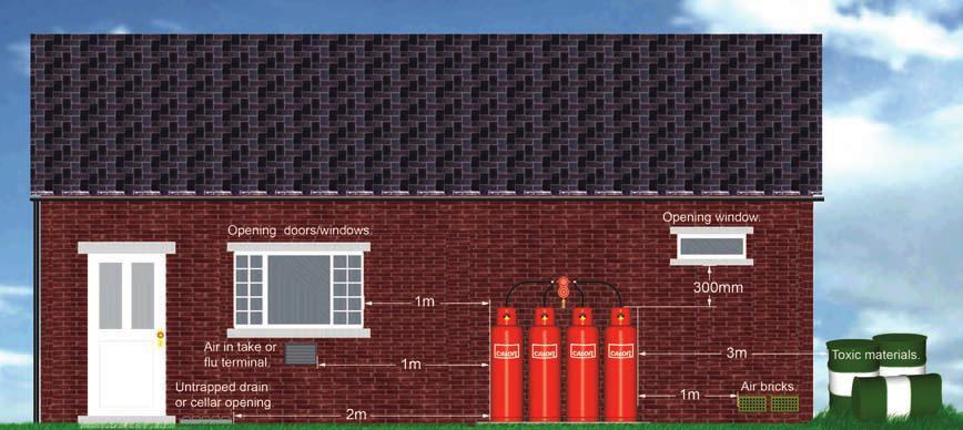

ProDave Posted December 2, 2020 Author Share Posted December 2, 2020 11 minutes ago, joe90 said: by whom? (Just looked at the above and I am ok, that’s lucky as I did not know there were regulations). Building control. Here is a picture grabbed from one of the documents that @Onoff posted But it does not answer my question and poses another one. At the back of my house is a sun room (orangery) measuring a little over 3 metres on each side. There will be windows or doors on all sides, so no "plain" wall. the cylinders are in the middle of the back wall. That wall will have two large NON OPENING and non ventilated windows. That drawing does not show a non opening window. It implies an opening window can be 300mm above the cylinders but does not make it clear if that opening window could be directly above the cylinders as the one shown in the picture is off to one side, but with no dimension to the side shown. But what is now worrying me is it shows 3M from the cylinders to the corner of the building. Is that a minimum? If so I am not going to achieve 3M each side of the cylinders when the wall is only just over 3M long. That is a new one I was not expecting. Link to comment Share on other sites More sharing options...
Russell griffiths Posted December 2, 2020 Share Posted December 2, 2020 Doesn’t that pic show 3m to the toxic materials not the corner of the building @ProDave Link to comment Share on other sites More sharing options...
joe90 Posted December 2, 2020 Share Posted December 2, 2020 6 minutes ago, ProDave said: But what is now worrying me is it shows 3M from the cylinders to the corner of the building. No, that’s 3m from toxic materials !!! Frankly a non opening window is the same as a plain wall IMO. 1 Link to comment Share on other sites More sharing options...
Onoff Posted December 2, 2020 Share Posted December 2, 2020 Just now, Russell griffiths said: Doesn’t that pic show 3m to the toxic materials not the corner of the building @ProDave Was just about to say the same. Link to comment Share on other sites More sharing options...
ProDave Posted December 2, 2020 Author Share Posted December 2, 2020 Just now, Russell griffiths said: Doesn’t that pic show 3m to the toxic materials not the corner of the building @ProDave Yes I think you are right, so that worry goes. So it's just the window thing. Either there is no issue with a non opening window? Or if the opening window rules apply I would need confirmation that the window can be directly above the cylinders and I might have to raise the window slightly to get the 300mm. I also might have to move a couple of air bricks. Link to comment Share on other sites More sharing options...

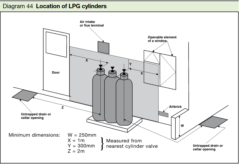

Temp Posted December 3, 2020 Share Posted December 3, 2020 Page 67 of Approved Doc J Link to comment Share on other sites More sharing options...

ProDave Posted December 3, 2020 Author Share Posted December 3, 2020 4 minutes ago, Onoff said: Can you not dig a little pit thus lowering the cylinders? No. There are rules on pits due to Propane being heavier than air, so you are not allowed cylinders "underground" the best I can do is paving slabs level with the ground. Unless I can find a document or drawing that shows non opening windows I will have to go with raising my window heights slightly which will make the windows slightly smaller. At the moment it is a bare shell so it is easy to block up the window opening to make it a bit smaller. It is a good job I had not already got the windows here or I would now be stuck with no sollution. Link to comment Share on other sites More sharing options...
joe90 Posted December 3, 2020 Share Posted December 3, 2020 2 hours ago, ProDave said: but the thing I can't get an answer on and BC are arguing, is does a fixed, non opening, sealed window count as an "opening" in the building. My BC officer says yes. I disagree, otherwise it would have said “window”, not “opening window “ I found this on the Calor website... “There should be no openings into buildings, cellars or pits within 2m of an LPG storage area or the separation distance given in Table 1, whichever is greater. If there is an unavoidable opening within 2m, the opening should be securely covered and fitted with a suitable water seal to prevent the entry of vapour.” it’s all about vapour entering the building and a non opening window is effectively a water seal as above IMO. Tell your BC chap you got this from Calor! ? 2 Link to comment Share on other sites More sharing options...

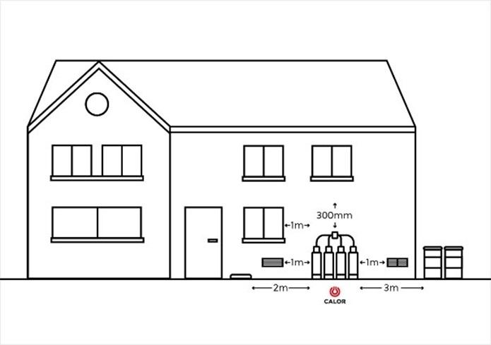

Onoff Posted December 3, 2020 Share Posted December 3, 2020 26 minutes ago, ProDave said: I guess what I am seeking to show my dumb BC officer is something that shows a non opening window can be anywhere, or at least that an opening window can be directly above the cylinders as long as it is 300mm above them. There's this image: Here: https://www.calor.co.uk/home-energy/new-to-lpg/my-options/lpg-installation-options?tabname=lpg-cylinders Link to comment Share on other sites More sharing options...
ProDave Posted December 3, 2020 Author Share Posted December 3, 2020 4 minutes ago, Onoff said: There's this image: Here: https://www.calor.co.uk/home-energy/new-to-lpg/my-options/lpg-installation-options?tabname=lpg-cylinders So close, BUT that 300mm above the cylinders is not very clear. I have That implies it is above the regulator that is an unspecified distance above the top of the cylinder? the picture in post 4 shows the 300mm is above the top of the cylinder. Link to comment Share on other sites More sharing options...
