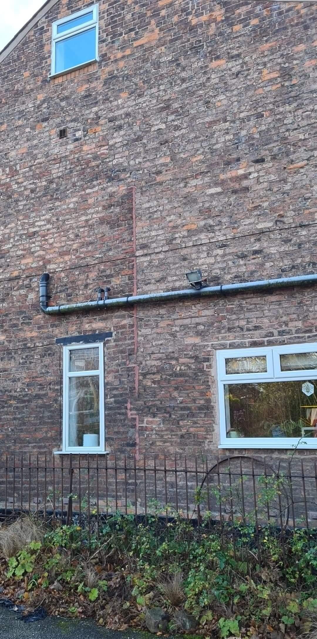

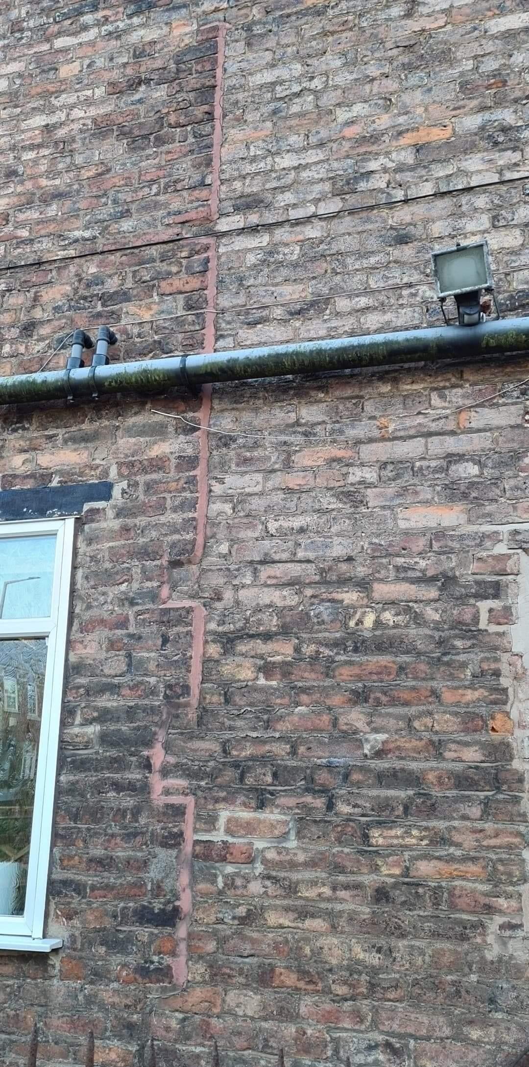

Country Geek Posted November 23, 2020 Share Posted November 23, 2020 OK so situation: We tried selling 4 years ago and some homebuyers surveys came back with 'possible movement.' Its an old house (over 100 years old) and I don't want anything to stop the sale. The sign of movement is old (see attached). Would I be best getting a structural survey as the seller, as a preemptive strike, so that when a buyer is ready, I can present the structural survey for them to provide to their mortgage lender? What would you do? Link to comment Share on other sites More sharing options...
joe90 Posted November 23, 2020 Share Posted November 23, 2020 Yes, I would get a report (as long as it’s good) so you can fend off possible delays, some would walk away without a report (risk adverse). 1 1 Link to comment Share on other sites More sharing options...
bassanclan Posted November 23, 2020 Share Posted November 23, 2020 For the money you spend on a surveyor you could get that takes out and repointed so it looks more seamless. I presume that movement hasn't occured during your ownership. What happened when you bought the house? Link to comment Share on other sites More sharing options...
joe90 Posted November 23, 2020 Share Posted November 23, 2020 A newly pointed building join (which is what that is) may cause raised eyebrows. Link to comment Share on other sites More sharing options...
Mr Punter Posted November 23, 2020 Share Posted November 23, 2020 That looks awful. A note from a structural surveyor would not satisfy me on this one. Can you clad the wall with something? The brick courses either side of the join do not line up. The mastic has been applied by a blind man with a shovel. 1 1 Link to comment Share on other sites More sharing options...

Roundtuit Posted November 23, 2020 Share Posted November 23, 2020 Have parts of the house been built at different dates perhaps? Looks like 'historical settlement'. A report to that effect should help to fend off any questions if it comes up. 1 Link to comment Share on other sites More sharing options...
Country Geek Posted November 23, 2020 Author Share Posted November 23, 2020 1 minute ago, Roundtuit said: Have parts of the house been built at different dates perhaps? Looks like 'historical settlement'. A report to that effect should help to fend off any questions if it comes up. With regards to this wall, not to my knowledge. Heres the full wall: Link to comment Share on other sites More sharing options...
joe90 Posted November 23, 2020 Share Posted November 23, 2020 (edited) I am still of the opinion that this is a “join” not a crack. Cracks don’t tend to be vertical and in a straight line with “block bonding” (blocks of three courses tying new to old walls). The bricks to the right of this “join” appear a slightly lighter colour and the courses tend not to line up till they get to the top of the join, which suddenly stops! And the brick courses then do line up!. Also the “join” suddenly stops at the bottom just below window cill level. Settlement cracks don’t do this IMO. do the deeds have any info on building work in the past?. Edited November 23, 2020 by joe90 1 Link to comment Share on other sites More sharing options...

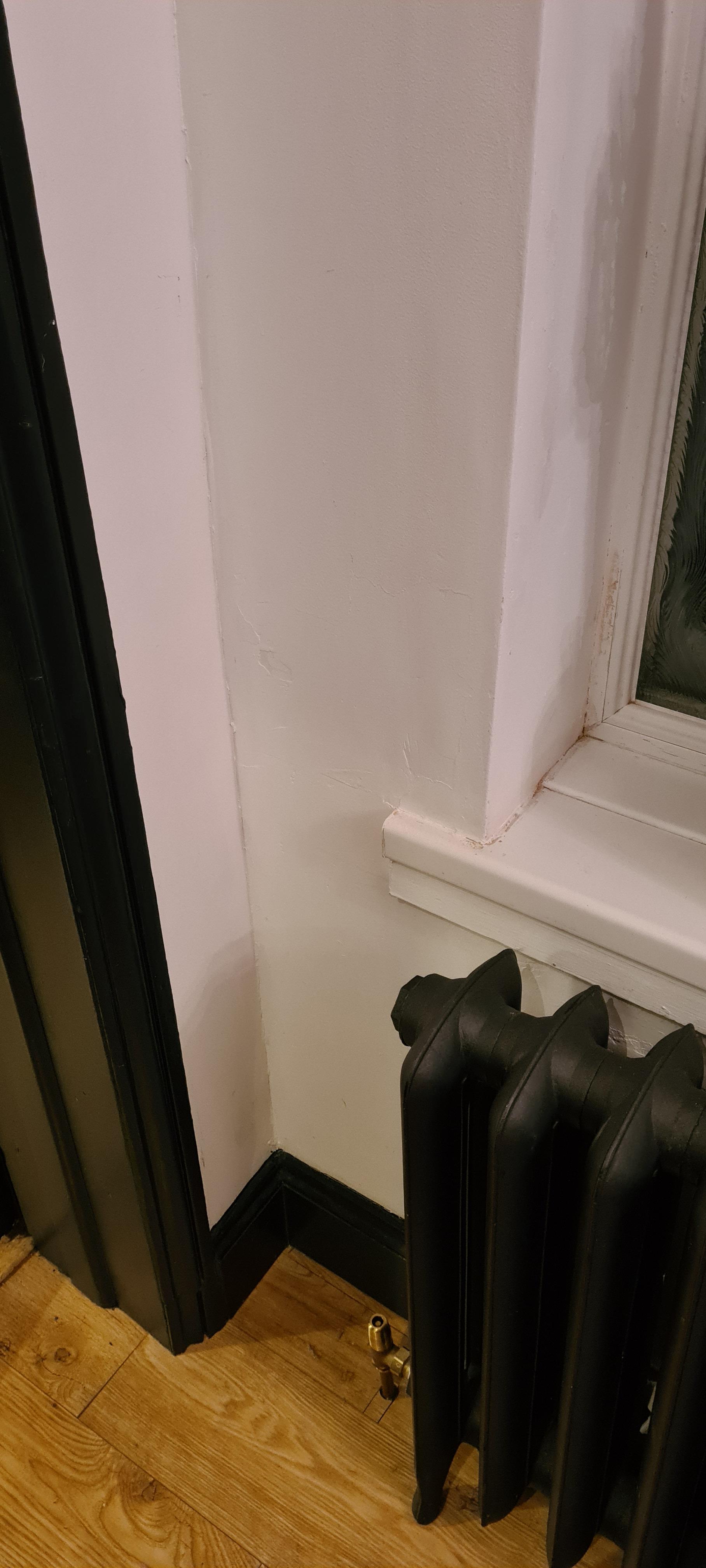

joe90 Posted November 23, 2020 Share Posted November 23, 2020 4 minutes ago, Country Geek said: The wall internally does jut out at the hallway yup, that’s about 4” (I guess) so one brick thicker. Pull out that “muck” and point it up properly. If anyone is not satisfied with that explanation let them get (and pay for) a professional opinion. ? Link to comment Share on other sites More sharing options...
Country Geek Posted November 23, 2020 Author Share Posted November 23, 2020 10 minutes ago, joe90 said: yup, that’s about 4” (I guess) so one brick thicker. Pull out that “muck” and point it up properly. If anyone is not satisfied with that explanation let them get (and pay for) a professional opinion. ? But wouldn't fresh pointing just raise more eyebrows? The "jut join" is still going to be there, just a little tidier. Structural survey = peace of mind, 450 Repoint I guess about the same, looks slightly better, still question marks. Both = 900! Link to comment Share on other sites More sharing options...
Country Geek Posted November 23, 2020 Author Share Posted November 23, 2020 19 minutes ago, joe90 said: yup, that’s about 4” (I guess) so one brick thicker. Pull out that “muck” and point it up properly. If anyone is not satisfied with that explanation let them get (and pay for) a professional opinion. ? I still don't get this though. Why isn't it opened out at the bottom too? Link to comment Share on other sites More sharing options...
joe90 Posted November 23, 2020 Share Posted November 23, 2020 4 minutes ago, Country Geek said: I still don't get this though. Why isn't it opened out at the bottom too? who knows! It’s over 100 years old so without ripping the floor up you won’t know what exists below, I bet it does tho. Link to comment Share on other sites More sharing options...

ProDave Posted November 23, 2020 Share Posted November 23, 2020 I would love to know what happened there. the "join" ends 2/3 of the way up. Above that the bricks are bonded across properly. It's like a small building got extended to the side and over the top? How do you know it's going to be an issue in surveys if there is no sign of movement? Any attempt to cover it up would just be seen as trying to hide a fault. 1 Link to comment Share on other sites More sharing options...
