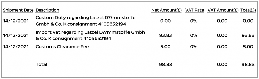

ThomasD Posted September 6, 2021 Share Posted September 6, 2021 Just to let everybody know, I bought 13 rolls of Tescon Vana tape from Latzel Dammstoffe for about 16 Euro each. A few points worth knowing: - Post brexit your order value with them has to be over 200 Euro. (They are not registered in some way for the below £135 scheme where VAT isn’t refunded). - They refund you the German VAT less a few fees (approx 25 euro in my case). - You pay the UK VAT and UK Import Duty to the courier before the parcel is released for delivery. Even with the additional charges, it’s considerably cheaper than buying the tape in the UK. The above is probably obvious to most but it was the first time I’d bought anything of any value from the EU post Brexit so it might be useful to some. 5 Link to comment Share on other sites More sharing options...

Dreadnaught Posted September 9, 2021 Share Posted September 9, 2021 On 07/09/2021 at 17:19, marone said: Could I ask a couple of questions? How did you order with them? Was it through ebay de, their website or did you contact them direct? Did you have to request the German VAT refund or did they automatically sort it? What was the Duty rate you had to pay? I have corresponded with Thomas on this and he said the following: He ordered through the DE site (the German version of the site as the English version did not work very well). They automatically refunded the German VAT once the consignment shipped (less a small arrangement fee). He then received a message from the courier to the UK VAT and duty. He said the duty on 13 rolls of Vana was about £10. He said it was still a lot cheaper than buying in UK. Hope that's helpful. And thanks to Thomas for sharing his experiences. Link to comment Share on other sites More sharing options...

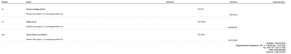

BenP Posted September 14, 2021 Share Posted September 14, 2021 I've recently placed an order for various breather membranes, Intello, tapes, gaskets etc. I estimated around £2.2-2.3k's worth if purchased over here. Once it's arrived and I've paid our VAT, duty etc I'll try and pull a breakdown together and see how it all compares. Delivery time etc. Ben 4 1 Link to comment Share on other sites More sharing options...
BenP Posted September 18, 2021 Share Posted September 18, 2021 Quick update: All four parcels dispatched. I've paid two import duties so far and they attempted delivery yesterday but we were out. Ordered on Monday! I've just had the other 2 import duty emails so should have delivery of everything mid next week. Really impressed so far. Latzel / Thomas has been incredibly quick with everything and DPD make it very easy to pay fees etc. Full breakdown of cost comparison to follow... 1 Link to comment Share on other sites More sharing options...

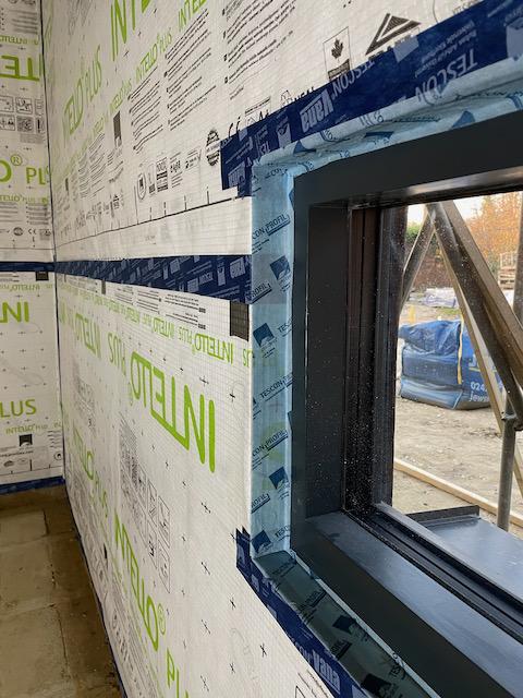

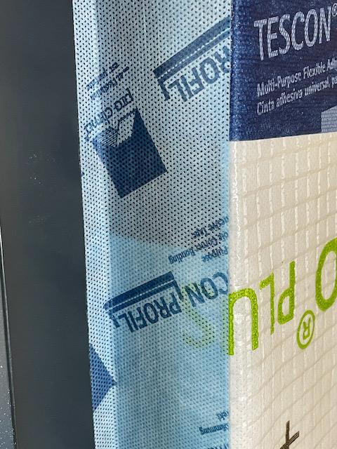

BenP Posted November 1, 2021 Share Posted November 1, 2021 8 hours ago, SuperJohnG said: @BenP did you manage to do a breakdown? also did most select the normal intello or the plus version. Only difference I think I can see I that the plus is reinforced? I assume if you are blowing in insulation? I have SIPS so guessing the standard stuff would be OK? @LA3222 what did you sure? Not yet @SuperJohnG - the build has started now and I'm a little occupied. Have even started using the Vana tape - blimey it's sticky.! Anywho, roughly speaking I worked out to buy over here my order would have been around £2300 inc VAT from ecomerchant or similar. My total order cost from Germany was a sniff under £1600 all in. This was for 2x roof membranes, 2x wall membranes, 3x intello plus, various sizes pipe grommets and 30 rolls of Vana. I hope this helps! 1 Link to comment Share on other sites More sharing options...
