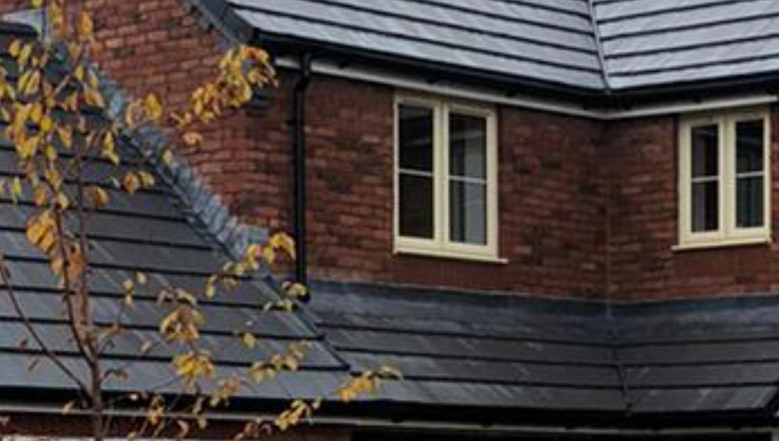

BobAJob Posted November 22, 2020 Share Posted November 22, 2020 (edited) I wonder what happens when it rains and water comes down that downpipe on the porch. Presumably it spreads to the left and under those strange looking tiles between the garage and the porch. I suspect that the ridge tiles will all lift and rattle in a strong window as the top clip looks like it hasn't been pushed down before the screw was put it. Usually the top clip has a teeth on it that hook into the dry ridge union and it can be set at different heights to handle different thicknesses of tiles. Edited November 22, 2020 by BobAJob Link to comment Share on other sites More sharing options...

Declan52 Posted November 22, 2020 Share Posted November 22, 2020 It's your money at the end of the day so it's your risk. Just by looking at the pics you have posted it doesn't paint a very good picture of the quality of the work that has been done already so could well be a very good indicator of what you will find inside. So it all boils down to how much you and your family really want to live in this house in this location and how quick the builder will be to remedy any faults that arise in the coming months. Link to comment Share on other sites More sharing options...

Mr Punter Posted November 22, 2020 Share Posted November 22, 2020 5 hours ago, Oz07 said: Mr punter c'mon wouldn't you ever try to sell a house with that porch to garage roof transition? Screams amateur builder to me. No, like I say, strip off the porch and re-roof, tidy the gutter and fix the dry ridge. I suspect that @Oz07 is right there is a window above the porch so the lead is too low. The window the other side has a soldier course under and that corresponds to the location of the lead here and the ensuing mess. Maybe architect drawings were poor or different size windows selected. Brickie just wants to finish and get paid. It all gets left to the roofer / leadworker, neither of whom are at the top of their game. With the walls either side of the garage door, again it looks like this has not been set out to brick dimensions and having got there the bricklayer did not know how or could not be bothered to make the broken bond look acceptable. It is not the best but not unusual either. Link to comment Share on other sites More sharing options...

Tomfromsurrey Posted November 22, 2020 Author Share Posted November 22, 2020 In answer to the question about the window over the porch, yes there is one. I can see the lead is under the soldier course under the window. Link to comment Share on other sites More sharing options...
Tomfromsurrey Posted November 23, 2020 Author Share Posted November 23, 2020 On 22/11/2020 at 11:48, Oz07 said: To be fair there could be a window cill at that porch lead flashing level. It's a poxy 3" upstand and could be the only reason someone would leave that transition looking like that...and there are still better ways of dealing with it. OP do I win? Is there a window to the right of that picture above the porch? If they cannot raise the porch roof to match the garage roof to give a better transition, how could it be constructed to make the join look better? Should the lead work where the garage roof joins the wall be over the tiles or under the tiles? At the ridge the final ridge tile is up at an angle and only fitted at one end because it is sitting on the lead. What should have been done at that point? Photos are in earlier replies. Link to comment Share on other sites More sharing options...
Mr Punter Posted November 23, 2020 Share Posted November 23, 2020 May be good to strip the tiles and replace with lead, done by a proper leadworker. Link to comment Share on other sites More sharing options...
Oz07 Posted November 23, 2020 Share Posted November 23, 2020 my god I could have forgiven it if the cill was tight to the flashing but why not just grind through the soldiers 3" up to give it a proper upstand?! 1 Link to comment Share on other sites More sharing options...

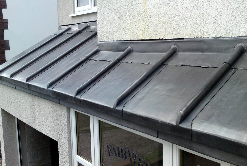

Tomfromsurrey Posted December 10, 2020 Author Share Posted December 10, 2020 Maybe this is whats needed. Dry Valley, equal depth at the lower end, and unequal depth at the upper end so deeper on the right top. Image is a bit of a quick drawing, but you get the idea. That would need to be bespoke in GRP I assume. something made with lead and battens would probably do the job. Better that what is there now. 1 Link to comment Share on other sites More sharing options...
joe90 Posted December 10, 2020 Share Posted December 10, 2020 My god that’s crap. Link to comment Share on other sites More sharing options...
Declan52 Posted December 10, 2020 Share Posted December 10, 2020 If they took the plastic edges of and dressed it in lead it might not be as bad looking. Link to comment Share on other sites More sharing options...

Dave Jones Posted December 11, 2020 Share Posted December 11, 2020 (edited) the nail through the last dry virge clip really makes the whole job shine. If your still wanting it, snag it - cost to correct. Lower offer based on this to the developer. Otherwise just budget it in to fix it up, none of its a show stopper. Who was the developer ? Edited December 11, 2020 by Dave Jones Link to comment Share on other sites More sharing options...

BobAJob Posted December 11, 2020 Share Posted December 11, 2020 On 10/12/2020 at 16:26, Tomfromsurrey said: Maybe this is whats needed. Dry Valley, equal depth at the lower end, and unequal depth at the upper end so deeper on the right top. Image is a bit of a quick drawing, but you get the idea. That would need to be bespoke in GRP I assume. something made with lead and battens would probably do the job. Better that what is there now. Looks a bit bodged to me. 1 Link to comment Share on other sites More sharing options...
