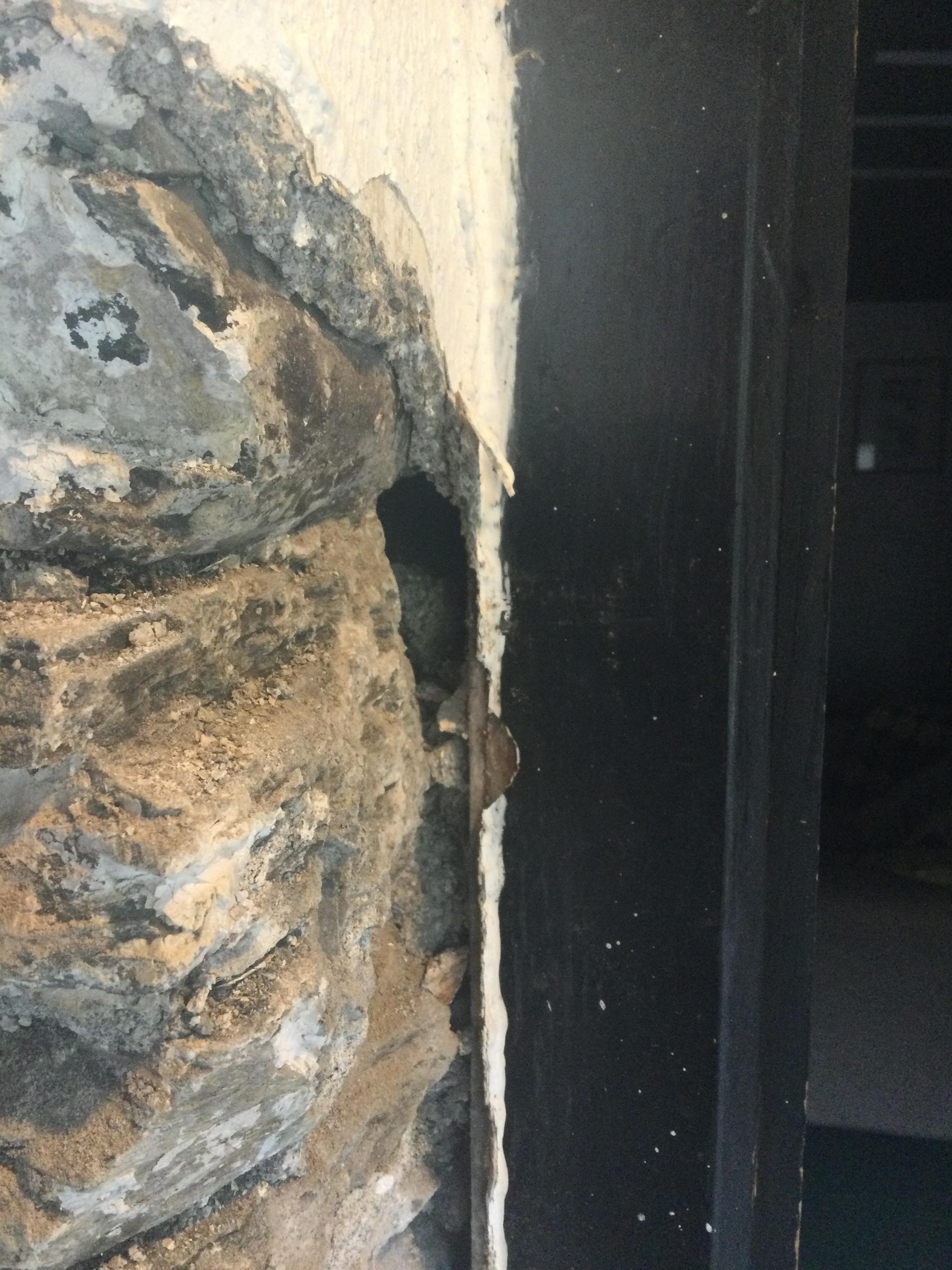

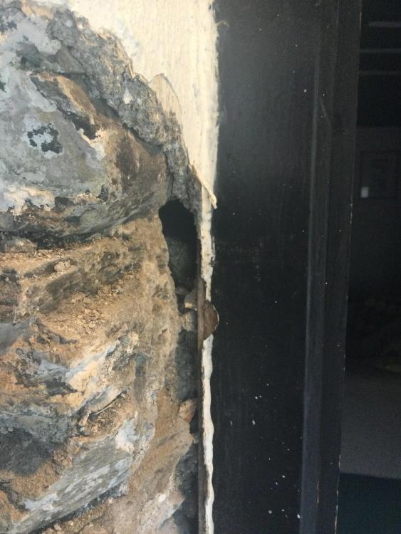

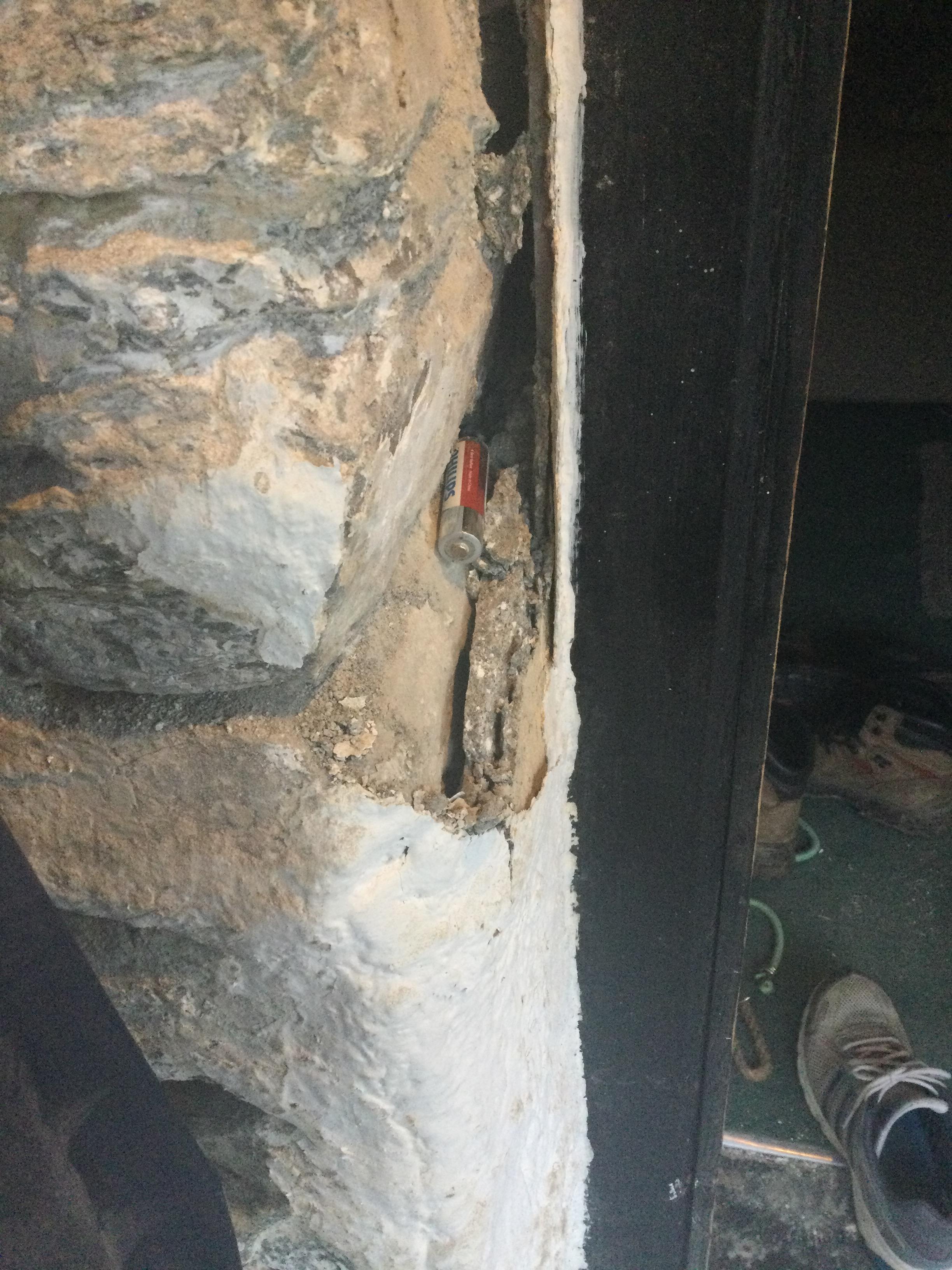

Gone West Posted December 13, 2020 Share Posted December 13, 2020 On 13/12/2020 at 09:41, zoothorn said: What would you do at the reveal areas? IE now Ive removed 3-4cm layer of old whatever mortar stuff, Ive now got this bad 1-2cm gap from stonework to jams. If I just repoint these reveals, gap isn't closed at all. Foam in.. then plaster or something? Or should I be putting back a thick 3cm of render/ mortar whatever it is, back on these upright reveals, including underside of lintel stones? Expand I would foam the 1-2cm gap leaving enough depth, around 20mm, to point it up. 1 Link to comment Share on other sites More sharing options...
TonyT Posted December 13, 2020 Share Posted December 13, 2020 For the gap at the door frame use https://www.amazon.co.uk/Everbuild-TROWST-Stone-Trowel-Mastic/dp/B0013B95YC/ref=asc_df_B0013B95YC/?tag=googshopuk-21&linkCode=df0&hvadid=214440742293&hvpos=&hvnetw=g&hvrand=16323749131247911257&hvpone=&hvptwo=&hvqmt=&hvdev=m&hvdvcmdl=&hvlocint=&hvlocphy=9046864&hvtargid=pla-420778815299&psc=1 Available from builders merchants too. apply with a trowel ( funny that) and smooth to a finish. Link to comment Share on other sites More sharing options...
Onoff Posted December 13, 2020 Share Posted December 13, 2020 A pointing gun might be good but not all lime mortars are suitable for guns and vice versa. Link to comment Share on other sites More sharing options...
joe90 Posted December 13, 2020 Share Posted December 13, 2020 I would use one of these with a hawk. https://www.ebay.co.uk/itm/THIN-NARROW-FINGER-TUCK-POINTING-POINTER-TOOL-JOINTING-TROWEL-BRICK-LAYING-14A/331402965074?epid=1743515516&hash=item4d2927f052:g:HkEAAOSwaNBUfd~o Link to comment Share on other sites More sharing options...
TonyT Posted December 13, 2020 Share Posted December 13, 2020 I’m with Joe90 on the tuck trowel, different widths available and are excellent. 1 Link to comment Share on other sites More sharing options...

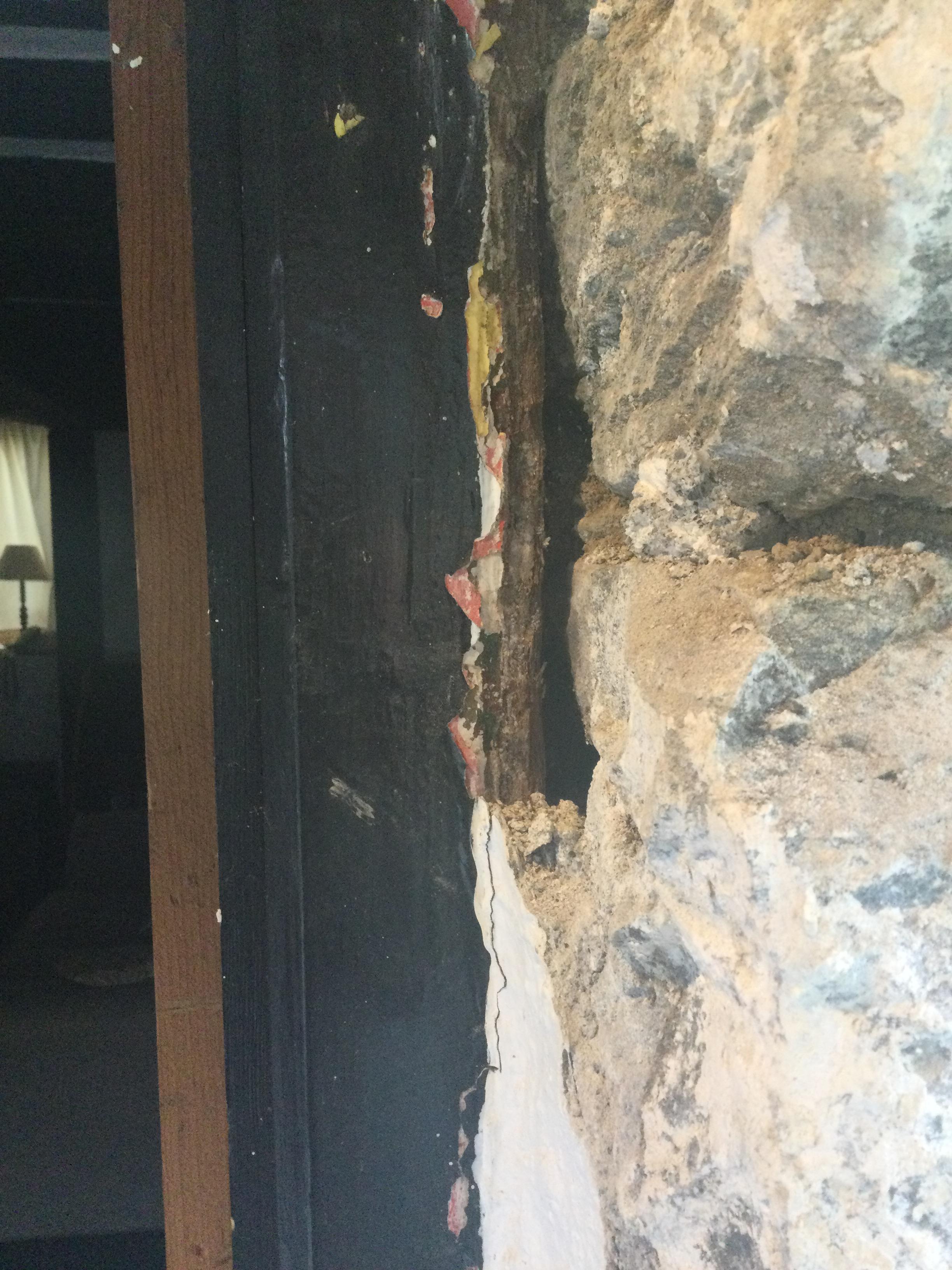

zoothorn Posted December 13, 2020 Author Share Posted December 13, 2020 On 13/12/2020 at 11:41, PeterStarck said: I would foam the 1-2cm gap leaving enough depth, around 20mm, to point it up. Expand Yes get this.. the gap does go quite deep, so if mortar filled would go in then fall down.. i guess i admit. So use so of the lime mortar to fill this trench? No new mix needed? Better pics coming up.. thx Peter Link to comment Share on other sites More sharing options...
zoothorn Posted December 13, 2020 Author Share Posted December 13, 2020 @Onoff that gun looks the biz. But i did buy a cheapo two ended mini pointing trowel thing.. will have to do i think unless those guns reasonably cheap, dont expect so. Yes that gap you referred to in that pic you put up.. are the ones in q. Better pic here ? Link to comment Share on other sites More sharing options...
zoothorn Posted December 13, 2020 Author Share Posted December 13, 2020 @Onoff @joe90 you can see the pretty whopping hole, aa battery here etc, also the thick render layer im prizing off below it. So its right to take all this layer off, i mean i havent gone ott and shoulda left some of the firmer stuff on? It mostly tapped hollow. But of course i didnt think that was to do with the void behind, rather than the surface 'popped', which is fairly idiotic, but par for course for me. Link to comment Share on other sites More sharing options...
joe90 Posted December 13, 2020 Share Posted December 13, 2020 Yes, foam that nearly full leaving 20mm fir pointing. Save holding a big hawk I sometimes use a bucket trowel to hold the mix and thin trowel to push it in. Link to comment Share on other sites More sharing options...
Onoff Posted December 13, 2020 Share Posted December 13, 2020 It may well be slightly damp in that cavity which will help the foam stick. Not usually an issue to give where you're foaming a dampening from a plant sprayer beforehand. If you go a bit mad with the foam and it's not the low expansion type then make sure the door is shut whilst it sets. You don't want to bow the jam. Unlikely but you never know. Link to comment Share on other sites More sharing options...

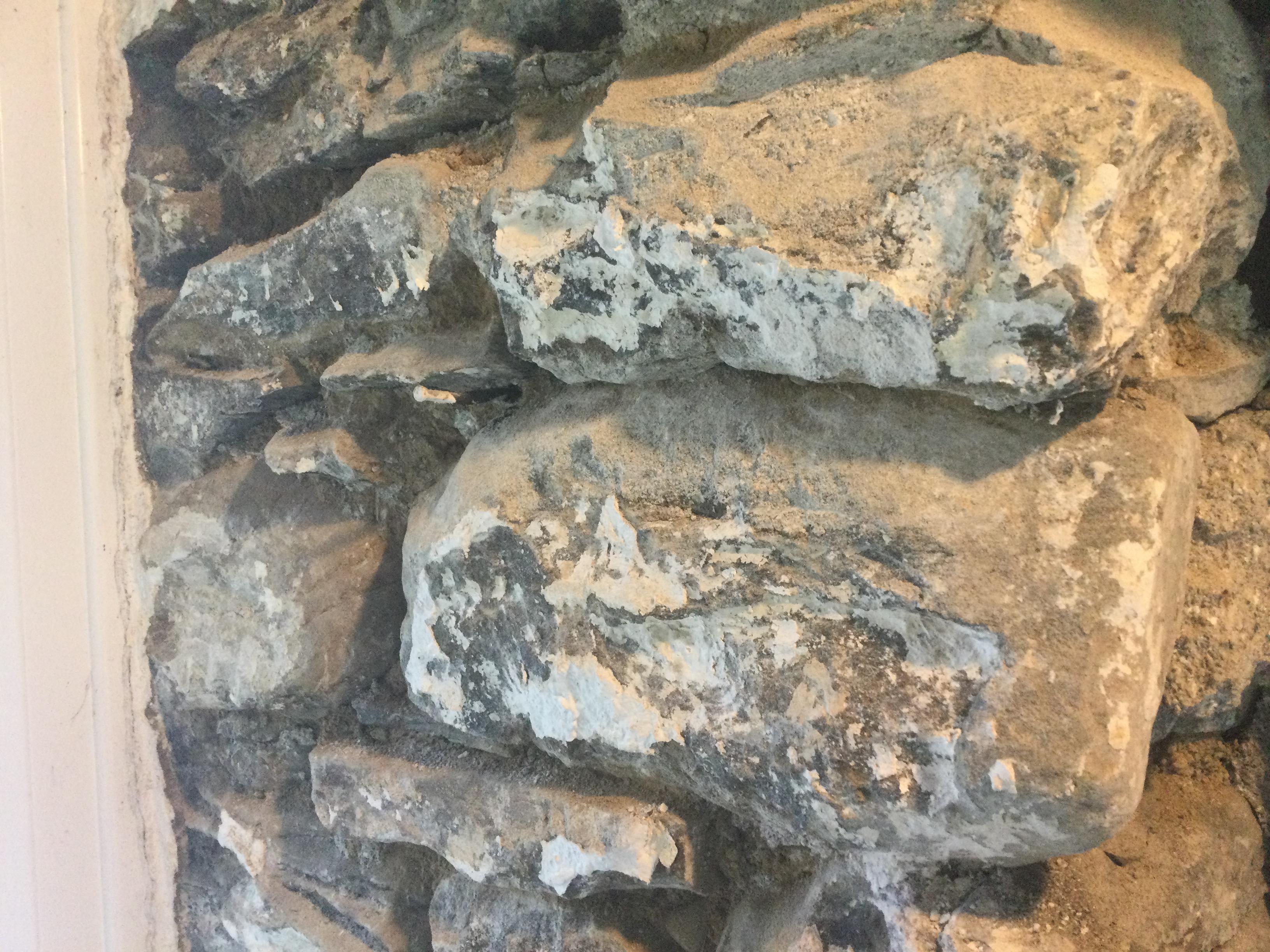

zoothorn Posted December 14, 2020 Author Share Posted December 14, 2020 On 13/12/2020 at 17:03, Onoff said: It may well be slightly damp in that cavity which will help the foam stick. Not usually an issue to give where you're foaming a dampening from a plant sprayer beforehand. If you go a bit mad with the foam and it's not the low expansion type then make sure the door is shut whilst it sets. You don't want to bow the jam. Unlikely but you never know. Expand Onoff I'm really struggling with this job. The idea of pointing, & brushing off stone, is totally not applicable for this whole area. The reason is a welded-on layer of 1830 white lime-surface whatever stuff, underneath a welded-on layer of 1960's stuff ontop. Plus the craggy non-flat surafces (mostly). This means Im spending huge ammount of time chisseling each 1 sq inch, before even getting to brushing, to remove all this. Its just not tennable to continue, over the whole area, as Id be weeks doing it just to prep. If the stone faces were flat.. this would be possible, just. I must consider the original idea. This being to both point up, plus, cover the whole faces with something (mortar/ render I dont understand), like it was approximately before, in order to A) retain the look of the rest of the old cottage walls, and B) to be able then to white it. Im also extremely concerned about the ammount of render/ mortar whatever it is 1 inch layer Im removing around the 3 reveal sides. especially under the lintel: I keep pulling out such big chunks Im concerned about the structure. I think its fair to say I haven't got a clue what Im doing. Link to comment Share on other sites More sharing options...
zoothorn Posted December 14, 2020 Author Share Posted December 14, 2020 The impossible to get clear craggy stone surfaces.. And the huge chunks im taking out under the lintel stones.. Link to comment Share on other sites More sharing options...

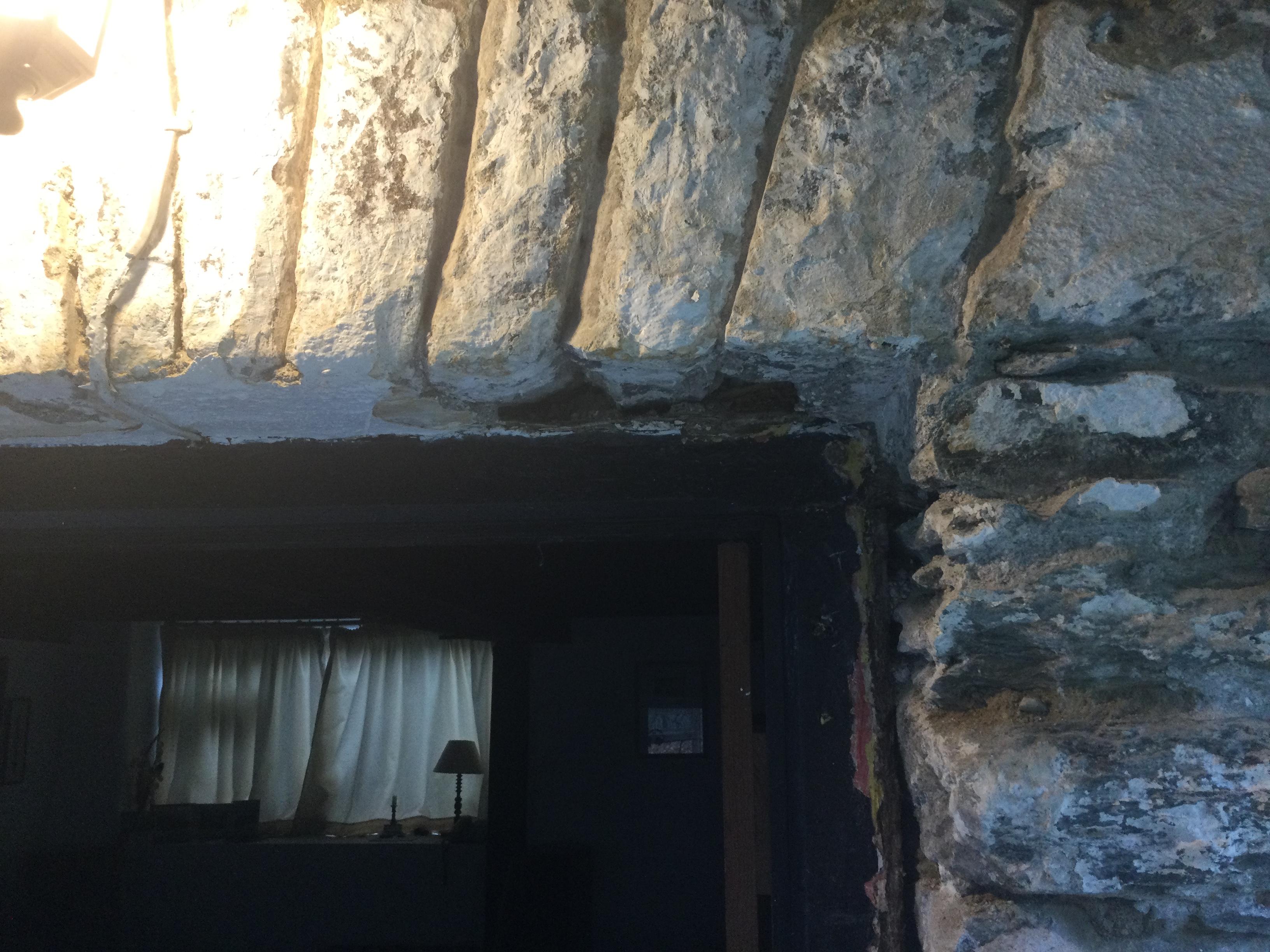

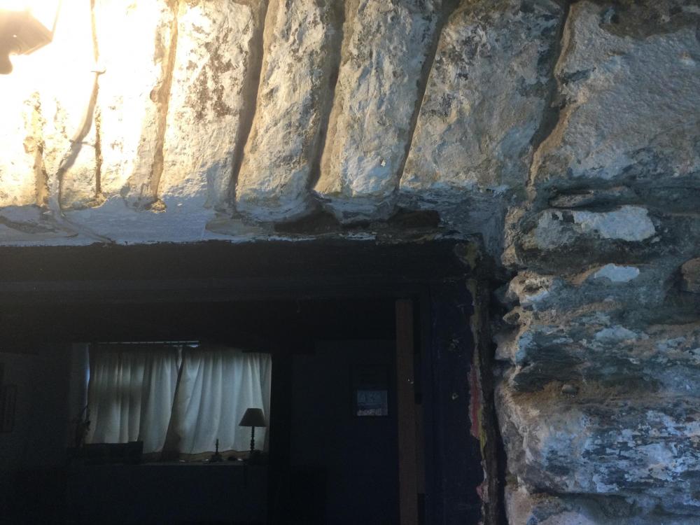

zoothorn Posted December 14, 2020 Author Share Posted December 14, 2020 If anyone can help. What I seem to be pulling out, from under lintel stones, is chunks of concrete. Now I dont know if this is 'render', or 'mortar', or concrete. Or whether all are words for the same thing. The top of the door frame, where its been in contact with earth "mortar" is rotten. But only 1cm or so: thankfully its mostly sound. But whether this wood 'lintel' is actually holding the lintel stones up (I cant see how a piece of wood is meant to bear the weight of alot of stone) I don't know. I must prep this area, make sure its structurally sound, before I continue. Do I even need the builder in-? i dont know. I'm sure my welsh house name translates as 'can of worms'. Link to comment Share on other sites More sharing options...
zoothorn Posted December 14, 2020 Author Share Posted December 14, 2020 Can anyone help? Having removed the old mortar stuff under the lintel, Ive found one of the lintel 'diagonal' stones (seems to be two halves, one ontop the other) actually moves a bit, IE the lower section. So if I take out the concrete mortar below it, just above the door frame, it'll likely fall.. which in turn will surely mean the next diagonal stone will too.. then the whole series (if they're wedged in together). I need to sort out this lintel area. I'm really stuck at the mo. & getting concerned. thanks zoot. Link to comment Share on other sites More sharing options...
Roundtuit Posted December 14, 2020 Share Posted December 14, 2020 OK. If the lintel is basically sound, I'd repoint the bit you've done before you rake out any more mortar, and then do a bit at a time until it's complete. I see what you mean about cleaning up the stone. I'd probably re-point and paint it white first, and then if I didn't like it, render it and re-paint. And why are the curtains closed? You working naked again?? ? 1 Link to comment Share on other sites More sharing options...
PeterW Posted December 14, 2020 Share Posted December 14, 2020 @zoothorn that lintel is self supporting - the shape of the stones gives it away. Just don’t take out too much from the vertical joints on the header stones - they look pretty good anyway. Link to comment Share on other sites More sharing options...
zoothorn Posted December 14, 2020 Author Share Posted December 14, 2020 On 14/12/2020 at 18:17, PeterW said: @zoothorn that lintel is self supporting - the shape of the stones gives it away. Just don’t take out too much from the vertical joints on the header stones - they look pretty good anyway. Expand I can sort of see what you mean, but if ive got one of these offset lintel header stones split across its midrift in two, and the lower half is wobbly only being supported in place by the concrete mortar below it ( sort of wedged in between it and the frame top) then if this bit of already slightly loose mortar comes out, the lower section of this stone will fall.. then i cant see how the whole lot of these headers won't fall too if they're self supporting. Link to comment Share on other sites More sharing options...
zoothorn Posted December 14, 2020 Author Share Posted December 14, 2020 On 14/12/2020 at 17:46, Roundtuit said: OK. If the lintel is basically sound, I'd repoint the bit you've done before you rake out any more mortar, and then do a bit at a time until it's complete. I see what you mean about cleaning up the stone. I'd probably re-point and paint it white first, and then if I didn't like it, render it and re-paint. And why are the curtains closed? You working naked again?? ? Expand This makes sense. But its the underside of these header stones im most concerned about. Its replacing this concrete mortar stuff.. and the slightly rotten door frame too. What would you paint it with tho? Its covering this lime mortar stuff afaict is the thing preventing me doing this. No i get such little light in this side over winter its not worth opening them. Link to comment Share on other sites More sharing options...
Roundtuit Posted December 14, 2020 Share Posted December 14, 2020 The stuff under the lintel is doing nothing much really; it looks like the frame was fitted after the stone was rendered. Unless you want to replace the frame, just foam and repoint as already suggested. Paint with something breathable - whitewash was traditional, high opacity emulsion would do it, or maybe a masonry paint (but perhaps that's not ideal for rendering over). Link to comment Share on other sites More sharing options...
