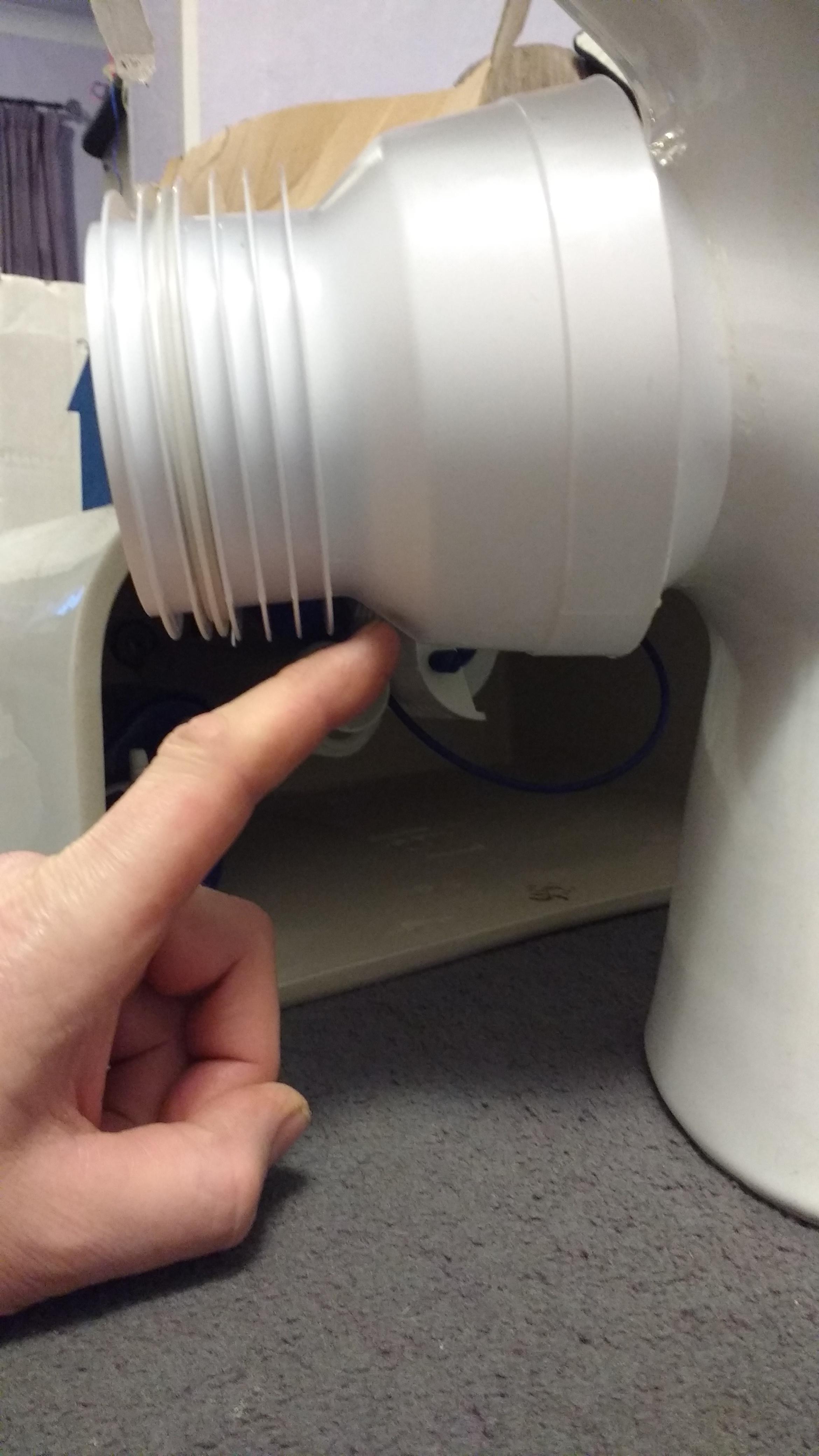

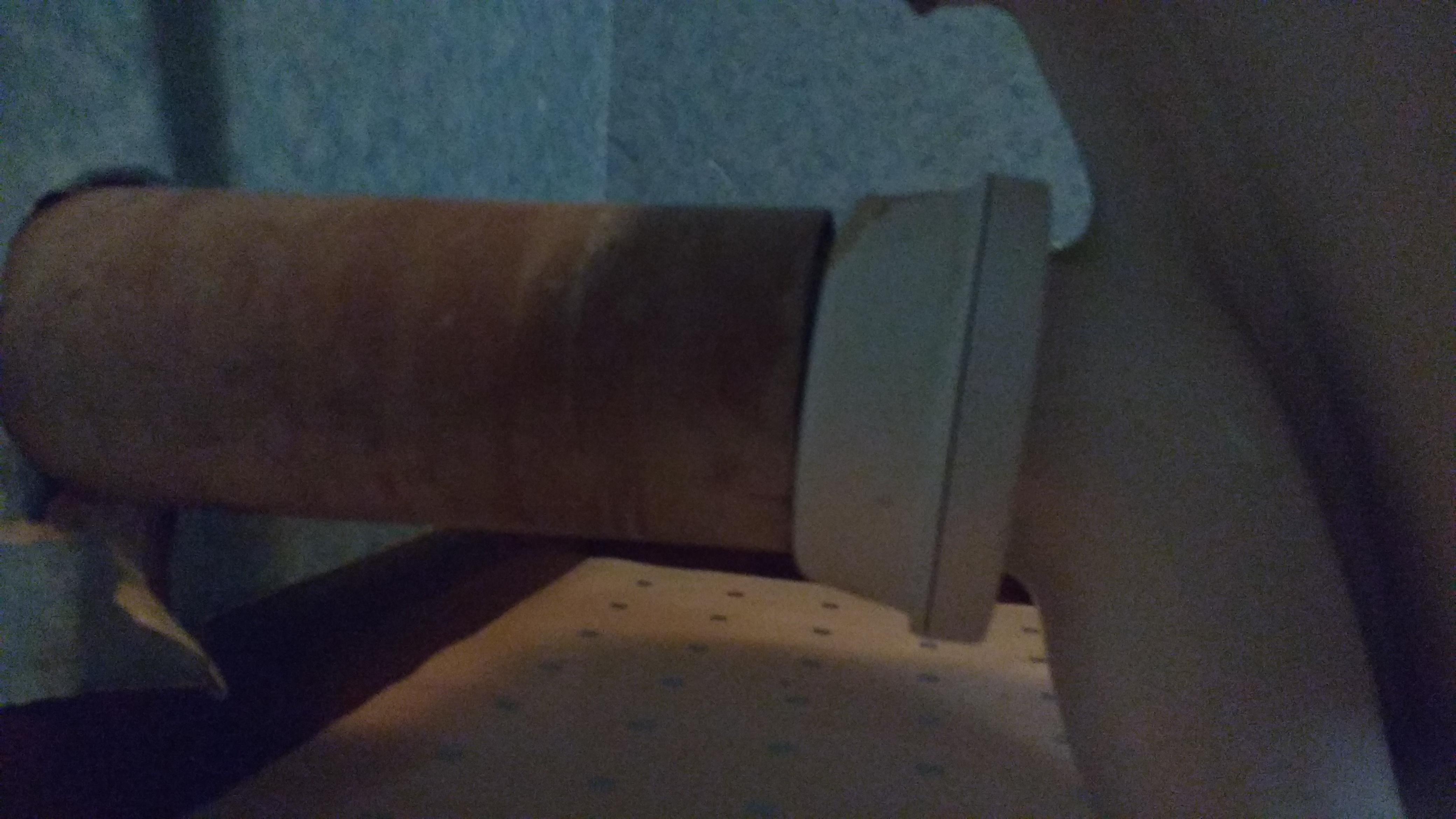

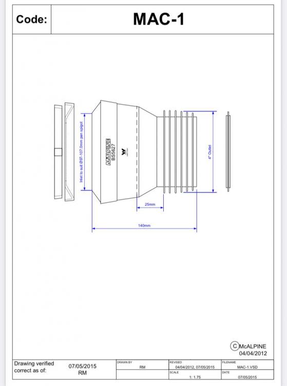

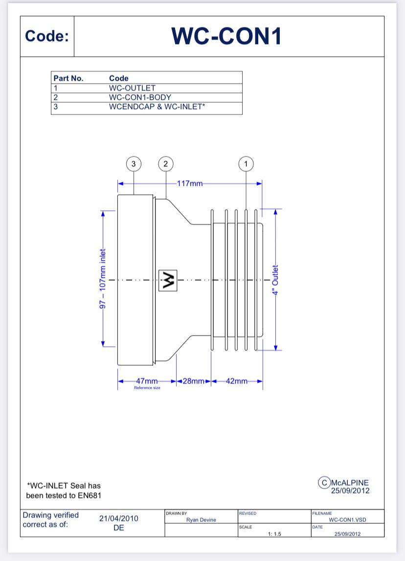

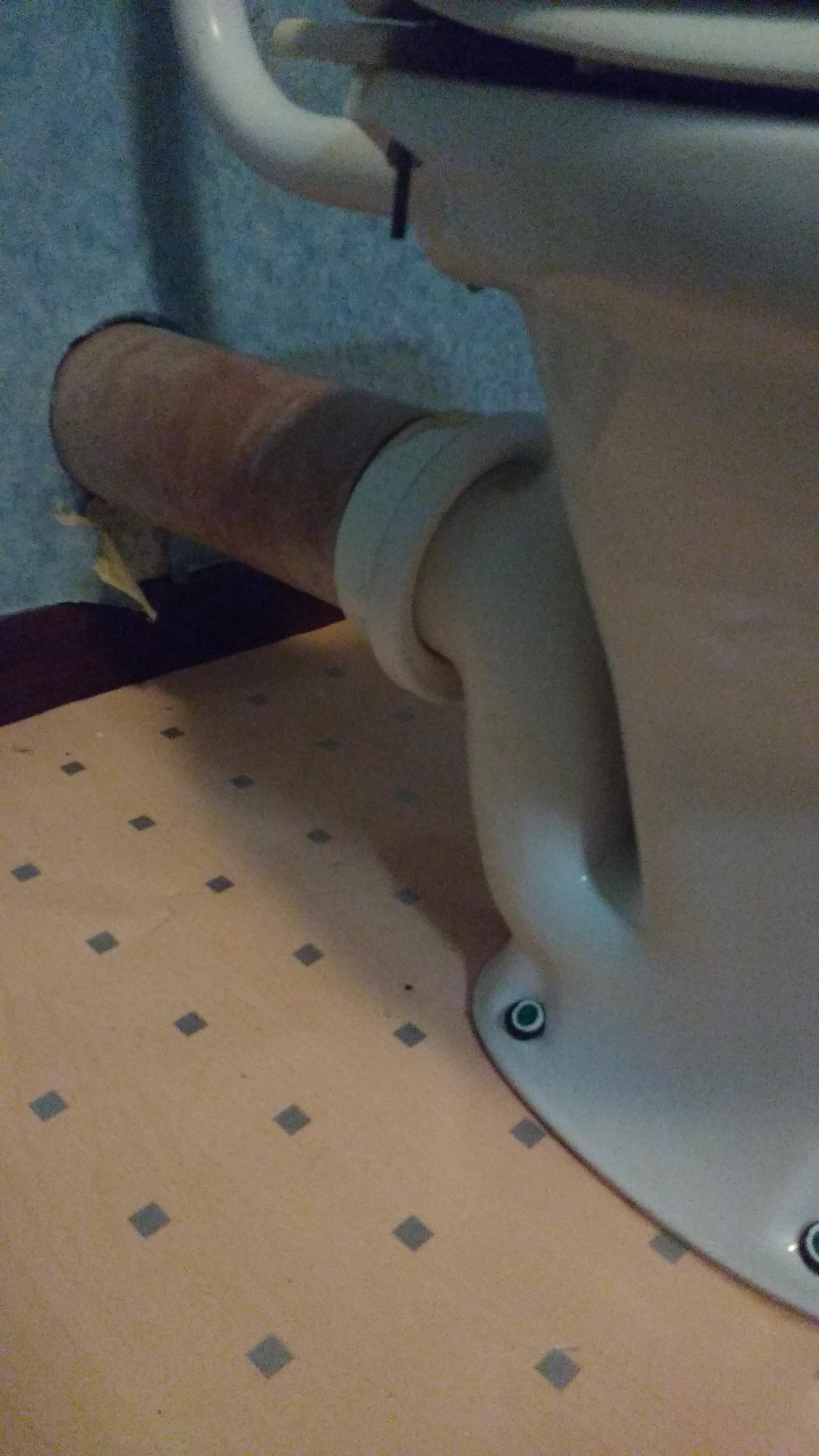

Onoff Posted November 16, 2020 Share Posted November 16, 2020 (edited) The horrible ensuite wc here has never been right. 'Eventually' I'll fit a wall hung WC but in a different position if I ever get to extend the dormer. For now though I need to sort this. There's a drip from the flush pipe that's been filled with ancient silicone, might even be boss white tbh. The 110mm (brown) outlet pipe slopes upwards slightly too and now the pan connector has a drip. I think it's a crappy Floplast one. I can't for the life of me tell what the difference is between these two McAlpine pan connectors: This: https://www.screwfix.com/p/mcalpine-macfit-mac-1-wc-straight-pan-connector-white-90-112mm/78806 & https://www.screwfix.com/p/mcalpine-wc-con1-straigt-rigid-wc-pan-connector-white-110mm/2866p Edited November 22, 2020 by Onoff Link to comment Share on other sites More sharing options...
Big Jimbo Posted November 16, 2020 Share Posted November 16, 2020 Hi On Off, I can't help much with words of wisdom, but having to climb the soil pipe wont help. I expect that you are getting water sitting at the pan connector and just not getting away. Empty the pan, raise the toilet on a bit of ply perhaps. Or a crap load of silicon, put on in Two coats, and dont use it for a couple of days. Link to comment Share on other sites More sharing options...
Onoff Posted November 16, 2020 Author Share Posted November 16, 2020 4 minutes ago, Big Jimbo said: Hi On Off, I can't help much with words of wisdom, but having to climb the soil pipe wont help. I expect that you are getting water sitting at the pan connector and just not getting away. Empty the pan, raise the toilet on a bit of ply perhaps. Or a crap load of silicon, put on in Two coats, and dont use it for a couple of days. SWMBO wants a new pan. Tbh no 'effin difference to what's there. So this weekend it's old one out and new one in. The "new" one is the one that came with the bathroom suite. Put that to one side when we went wall hung. Wtf not just sort this one??? She'll paint a room ceiling again and again where the flat roof is leaking. Or buy expensive wallpaper and paste on the hardboard walls we have here in place of pb. Beats me. Getting very like her mother! ? 1 Link to comment Share on other sites More sharing options...

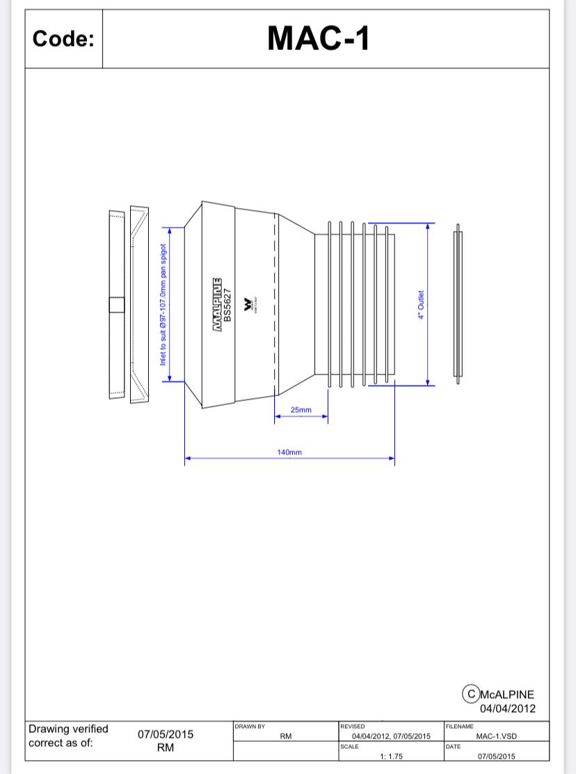

PeterW Posted November 16, 2020 Share Posted November 16, 2020 48 minutes ago, Onoff said: I can't for the life of me tell what the difference is between these two McAlpine pan connectors: Length ... CON-1 is 117mm, Macfit is 140mm Link to comment Share on other sites More sharing options...
Onoff Posted November 16, 2020 Author Share Posted November 16, 2020 44 minutes ago, PeterW said: Length ... CON-1 is 117mm, Macfit is 140mm, Must be reading a different bit... Says Macfit 130mm, CON-1 120mm under More Info unless I'm missing something. For 10mm I thought it must be some other difference. The EVA construction maybe? Link to comment Share on other sites More sharing options...
PeterW Posted November 16, 2020 Share Posted November 16, 2020 This is from the McAlpine tech info Link to comment Share on other sites More sharing options...
Onoff Posted November 16, 2020 Author Share Posted November 16, 2020 1 minute ago, PeterW said: This is from the McAlpine tech info Cheers, that's brilliant. Screwey's info is clearly wrong then! ? Either then I guess. Link to comment Share on other sites More sharing options...

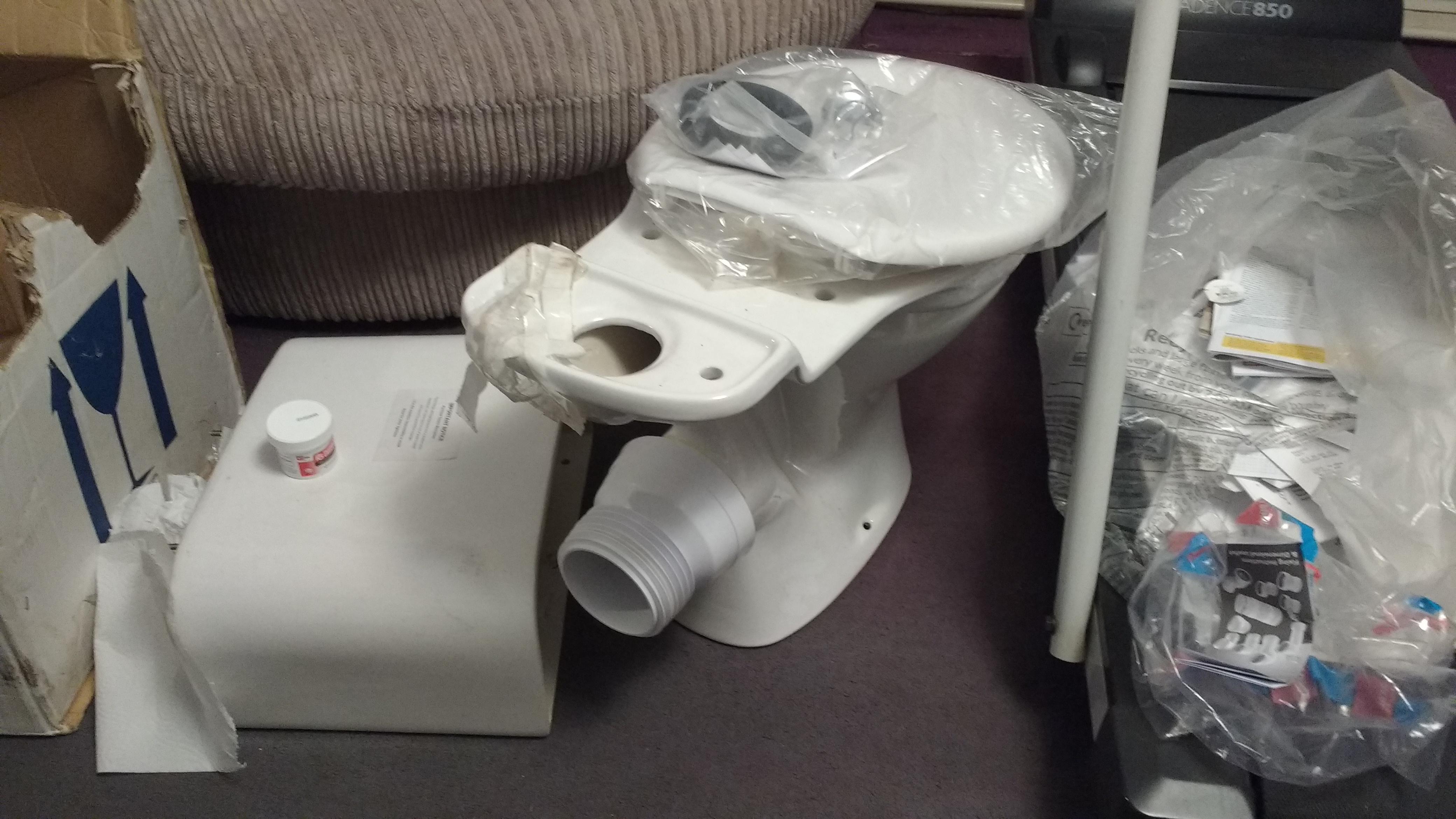

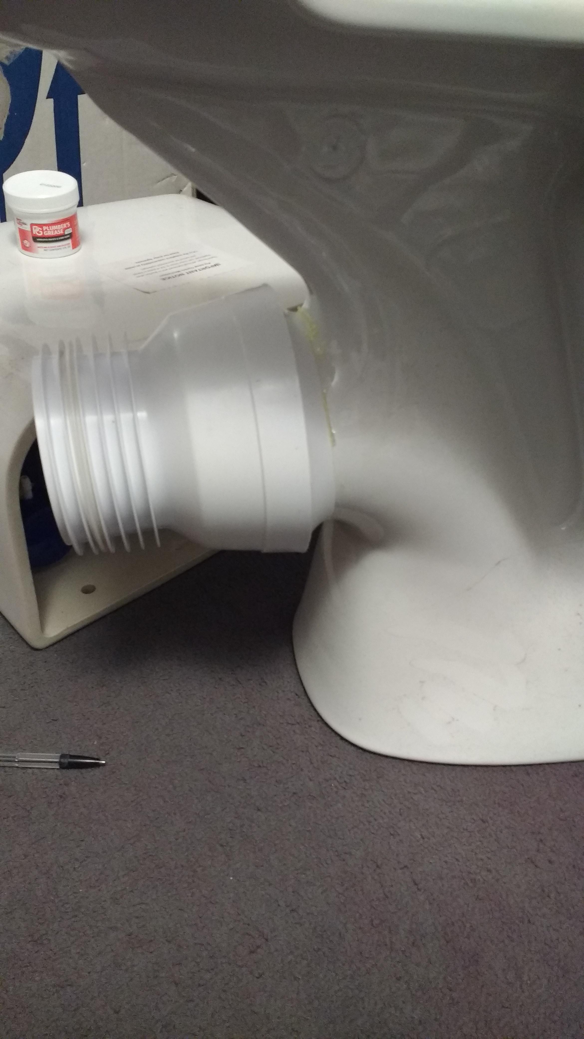

Onoff Posted November 17, 2020 Author Share Posted November 17, 2020 Any problem with this pan connector detail: Surely where I'm pointing with the pen is going to fill up with "stuff"? Link to comment Share on other sites More sharing options...
ProDave Posted November 17, 2020 Share Posted November 17, 2020 Normally the pipe flows down hill from the pan, so anything will drain down away from the pan. But if your pipe is going up hill then yes "stuff" will settle there. Link to comment Share on other sites More sharing options...

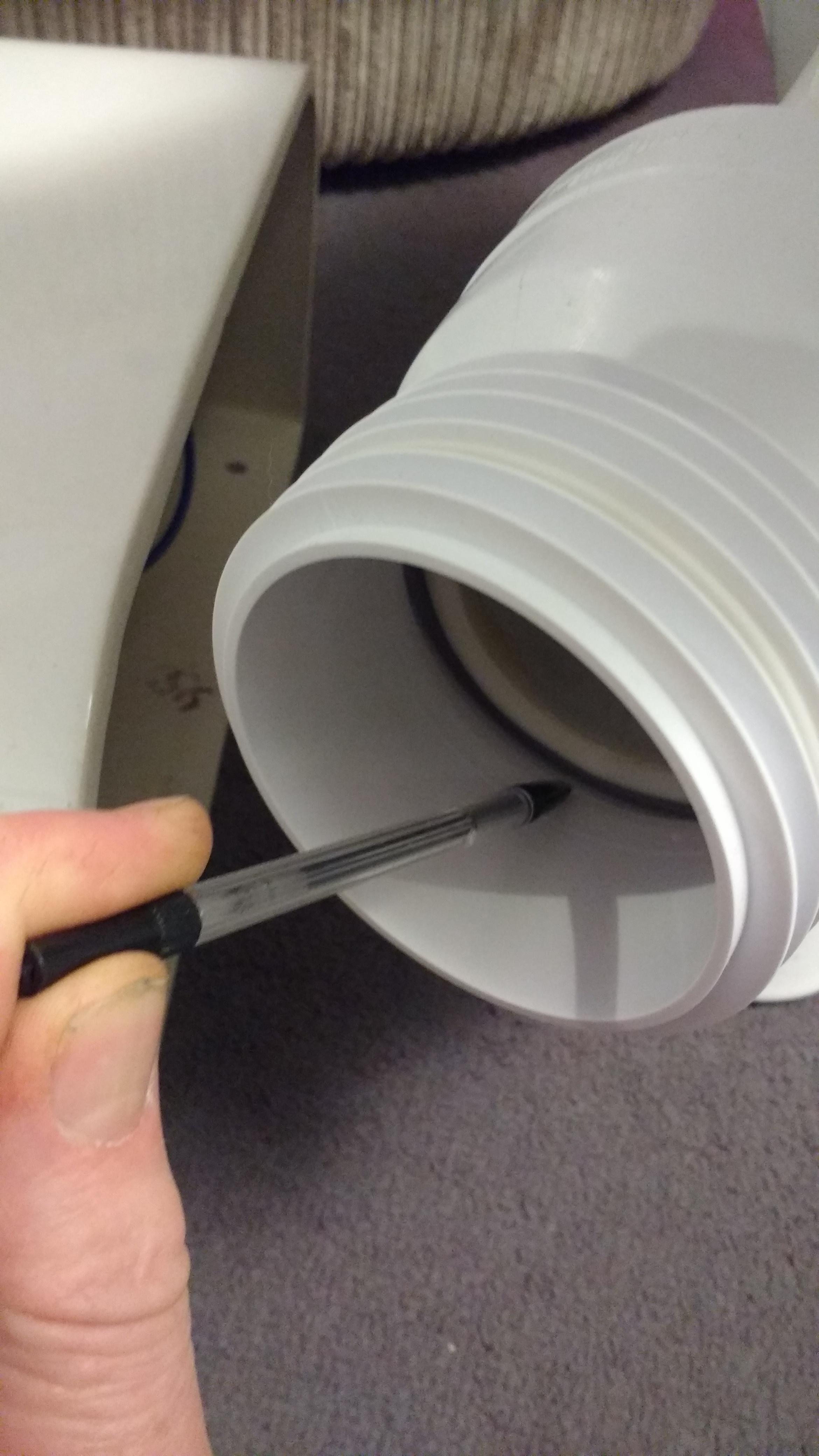

Onoff Posted November 17, 2020 Author Share Posted November 17, 2020 1 hour ago, ProDave said: Normally the pipe flows down hill from the pan, so anything will drain down away from the pan. But if your pipe is going up hill then yes "stuff" will settle there. I wonder if I'd be better with the WC-CON1... Probably overthinking it but irrespective of the angle, the section behind where I'm pointing will fill up with "stuff": Link to comment Share on other sites More sharing options...
Gav_P Posted November 17, 2020 Share Posted November 17, 2020 Is that “normal” for all pan connectors... there’s always some “stuff” lingering when you remove an old toilet. ? Link to comment Share on other sites More sharing options...
MJNewton Posted November 17, 2020 Share Posted November 17, 2020 (edited) 3 hours ago, Onoff said: Surely where I'm pointing with the pen is going to fill up with "stuff"? Yes, I've seen that before. You need to connect that white bit to the waste system. Do let me know if I can be of any more help... ? Edited November 17, 2020 by MJNewton 1 Link to comment Share on other sites More sharing options...
Onoff Posted November 17, 2020 Author Share Posted November 17, 2020 34 minutes ago, MJNewton said: Yes, I've seen that before. You need to connect that white bit to the waste system. Do let me know if I can be of any more help... ? Geberit it ain't. Link to comment Share on other sites More sharing options...

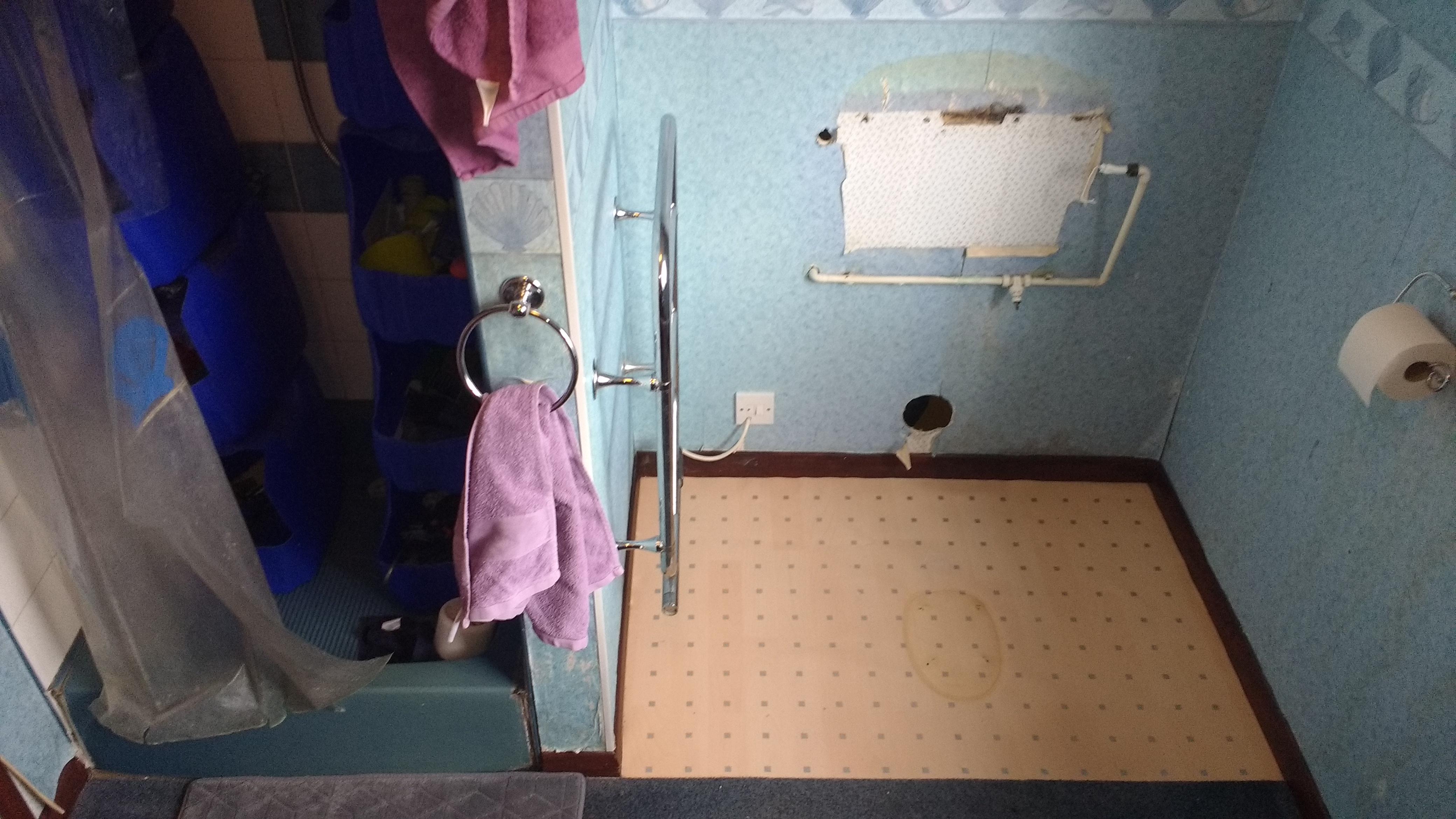

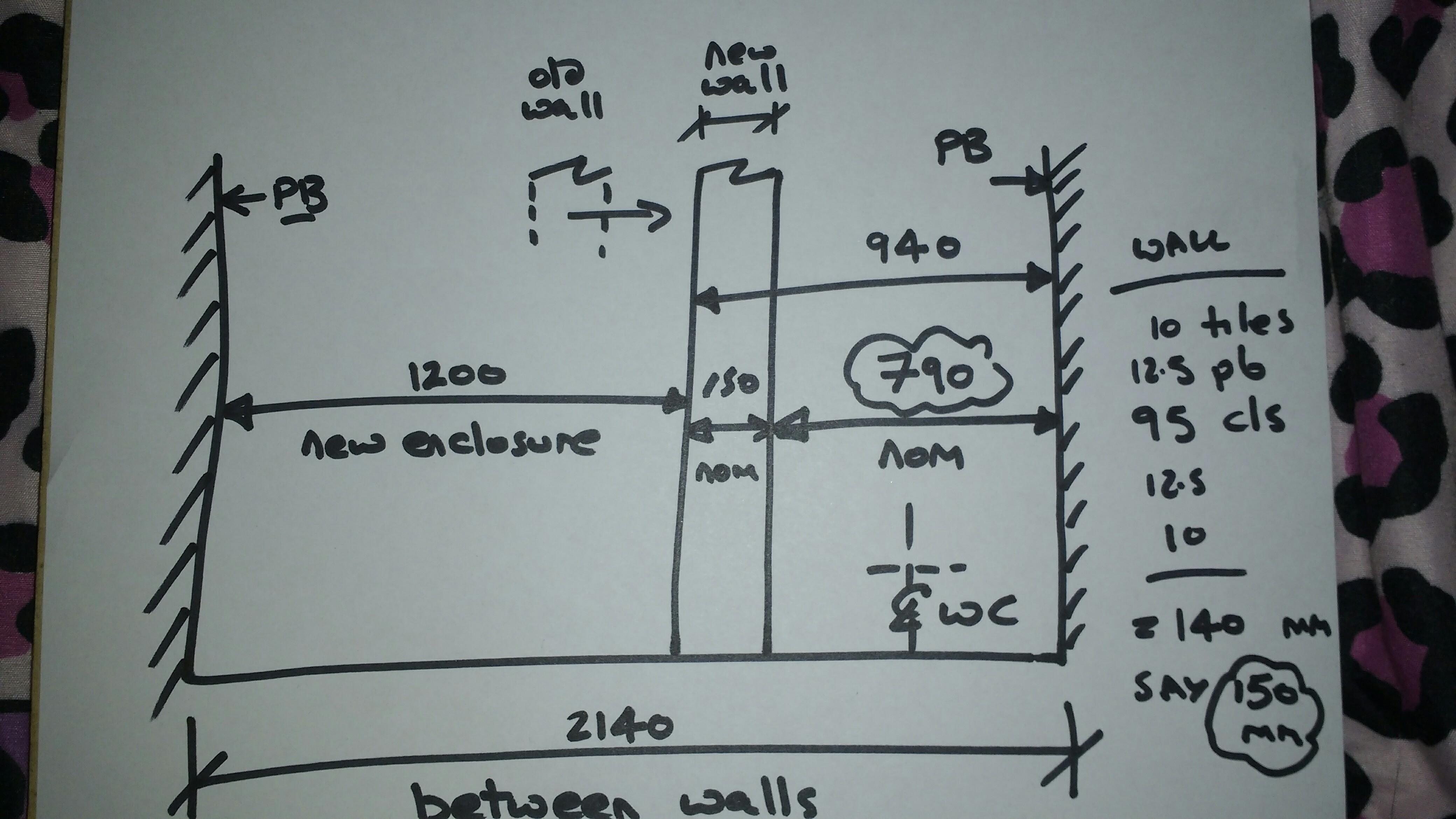

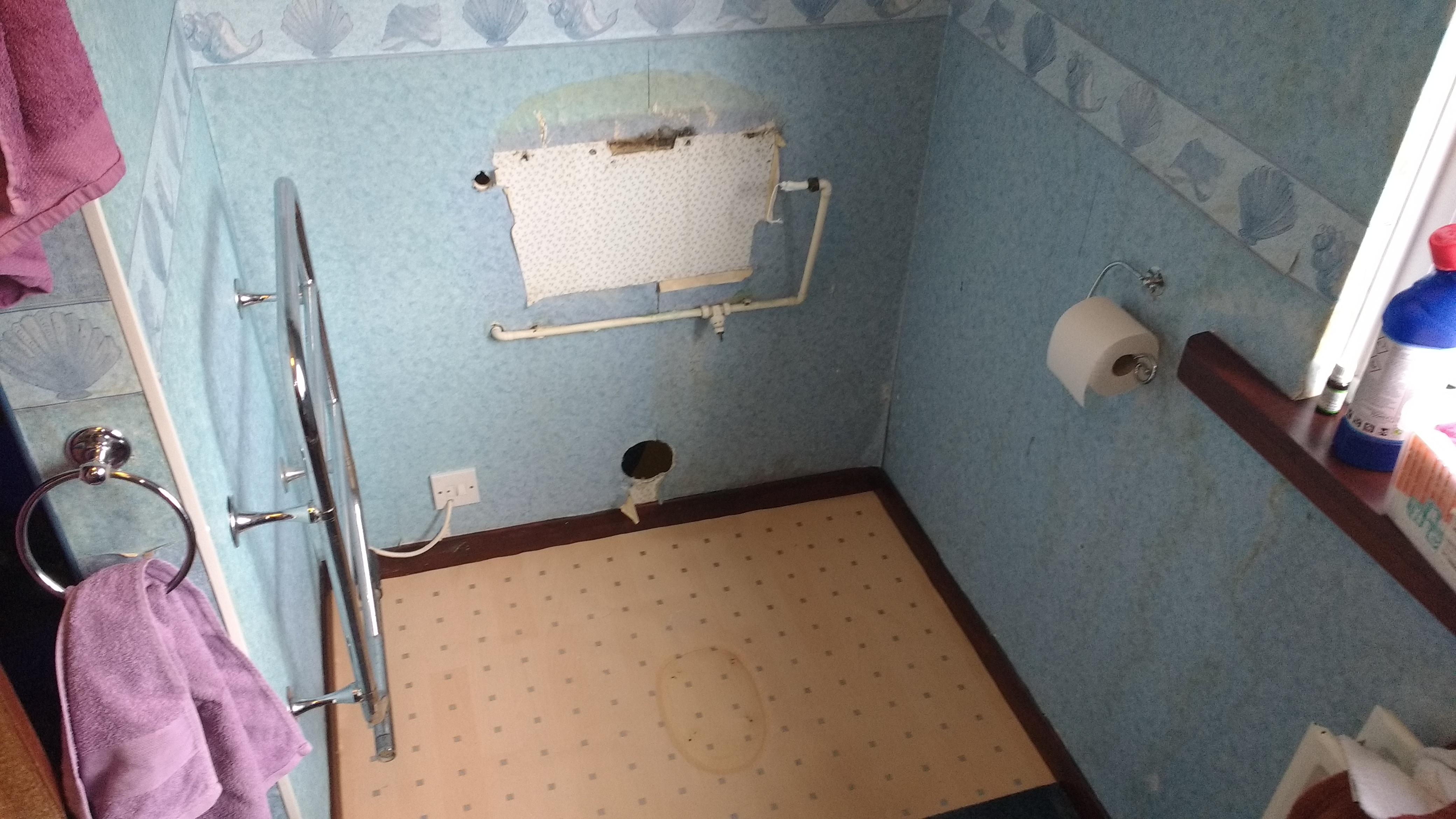

Onoff Posted November 22, 2020 Author Share Posted November 22, 2020 Looking like this thread title could change! Is 790mm too narrow a recess for a WC? Thinking elbow room etc: Link to comment Share on other sites More sharing options...
ProDave Posted November 22, 2020 Share Posted November 22, 2020 Just been to measure. The WC room in our static caravan measures 690mm wide. That is definitely at the "cosy" end of the spectrum. Placing of the loo roll holder needs care so it is not in the way, and there is even a tiny wash hand basin to squeeze past on your way to the loo. The wall between the shower and WC will be fine at 100mm so will buy you a bit more "room to manoeuvrer" but why not make it a glass panel of negligible thickness? Link to comment Share on other sites More sharing options...
Onoff Posted November 22, 2020 Author Share Posted November 22, 2020 4 minutes ago, ProDave said: Just been to measure. The WC room in our static caravan measures 690mm wide. That is definitely at the "cosy" end of the spectrum. Placing of the loo roll holder needs care so it is not in the way, and there is even a tiny wash hand basin to squeeze past on your way to the loo. The wall between the shower and WC will be fine at 100mm so will buy you a bit more "room to manoeuvrer" but why not make it a glass panel of negligible thickness? Unfortunately this is looking to be a "goer". Just measured from the centre of the downstairs WC to the tiled wall and that's 450mm. Losing 2" of that would still work i.e 400mm centre to wall. Watch this space. I'm going to try "But you'll lose the towel rail!" Always thought it super unhygienic there anyway. (I always get one from the cupboard). Link to comment Share on other sites More sharing options...

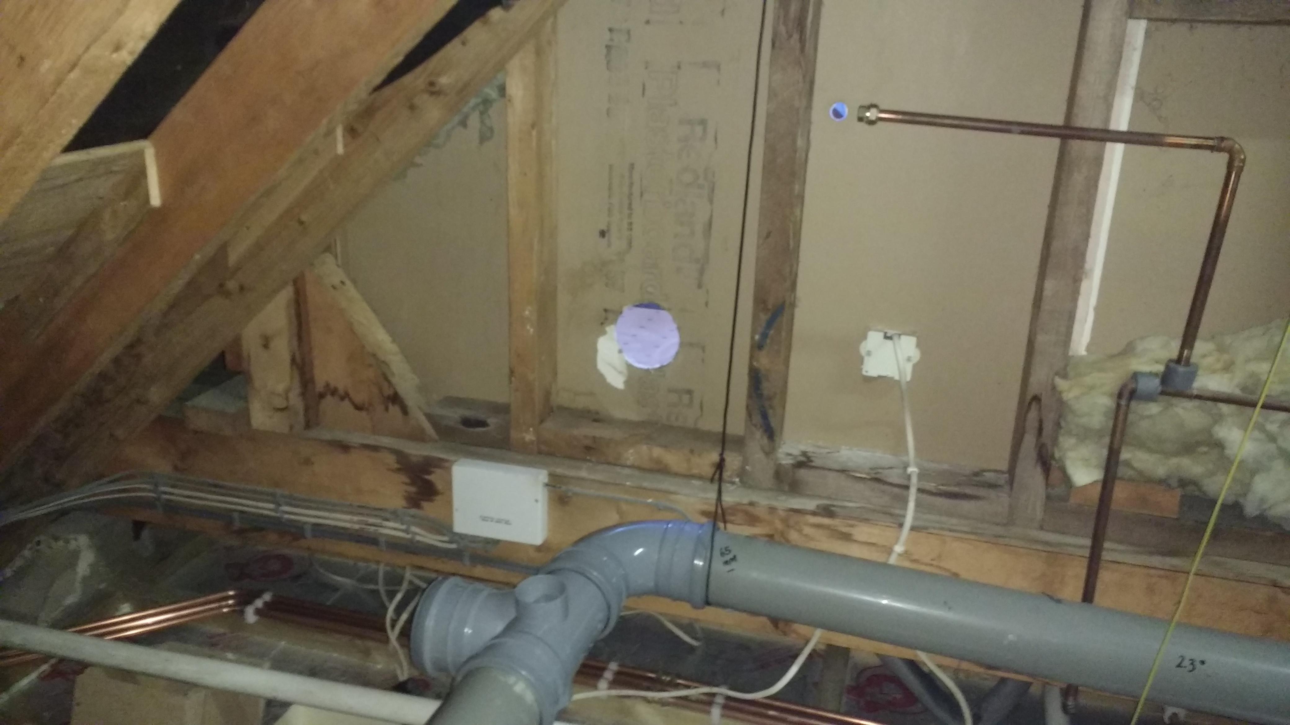

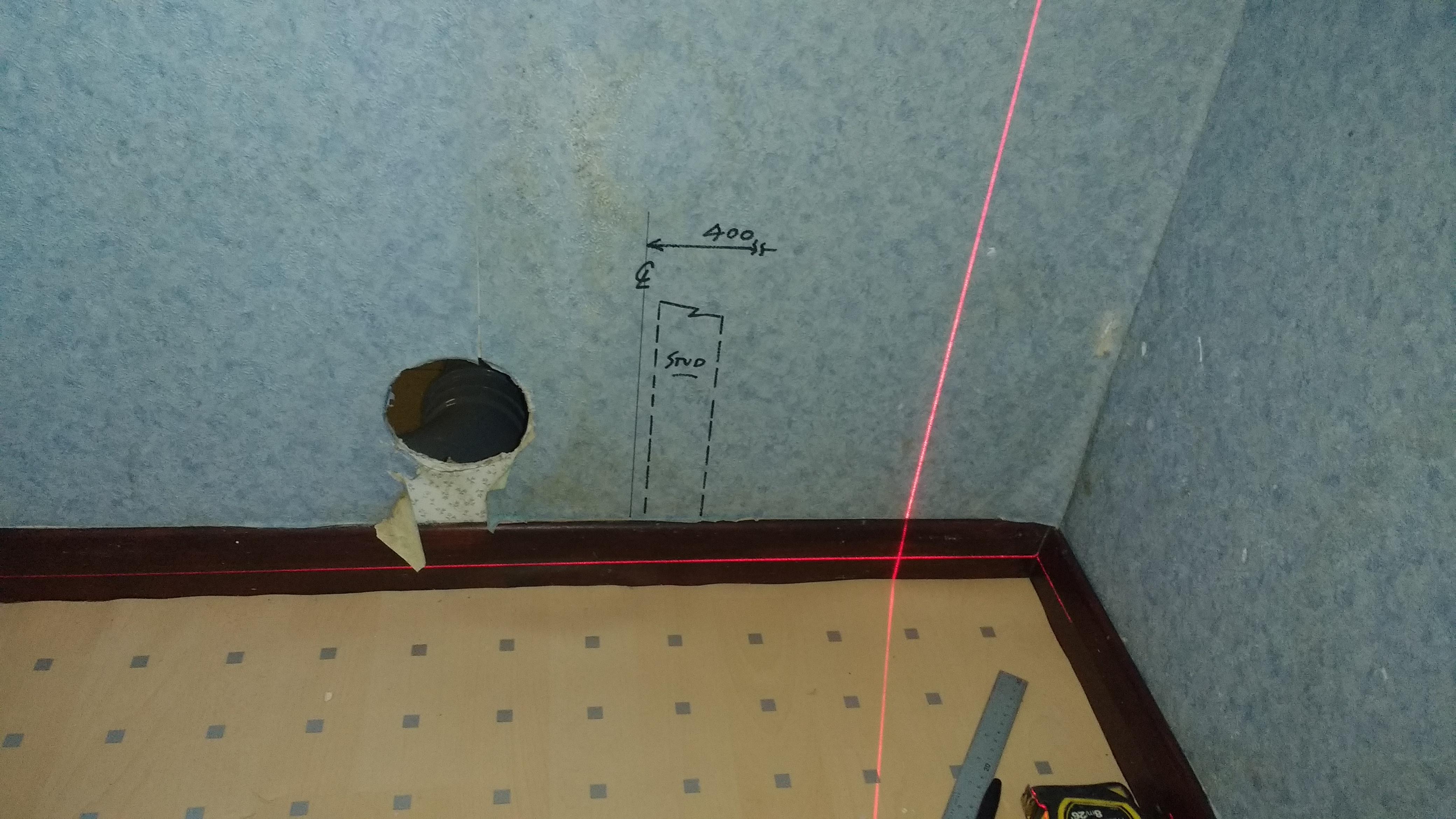

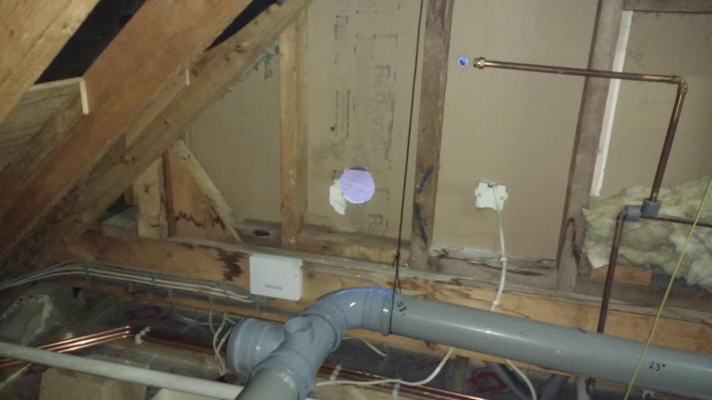

Onoff Posted November 22, 2020 Author Share Posted November 22, 2020 Holy Thread Drift Batman! & so it begins, the anti Christmas story... WC is now moving to the right. 1st problem there's a stud in the way. I'll be taking that out shortly with the multi tool. Let's hope the corner of the dormer doesn't fall down ? Link to comment Share on other sites More sharing options...
ProDave Posted November 22, 2020 Share Posted November 22, 2020 Look on the bright side. At least now you can get the pipe falling away from the pan. Now I am not usually a betting man, but I will wager this will NOT be complete before Christmas. I am not yet convinced this thread will rival the length of the "boxing in" thread. BUT. Looking at all that space in the loft. I would fit a back to wall pan and concealed cistern in the loft. 1 Link to comment Share on other sites More sharing options...
