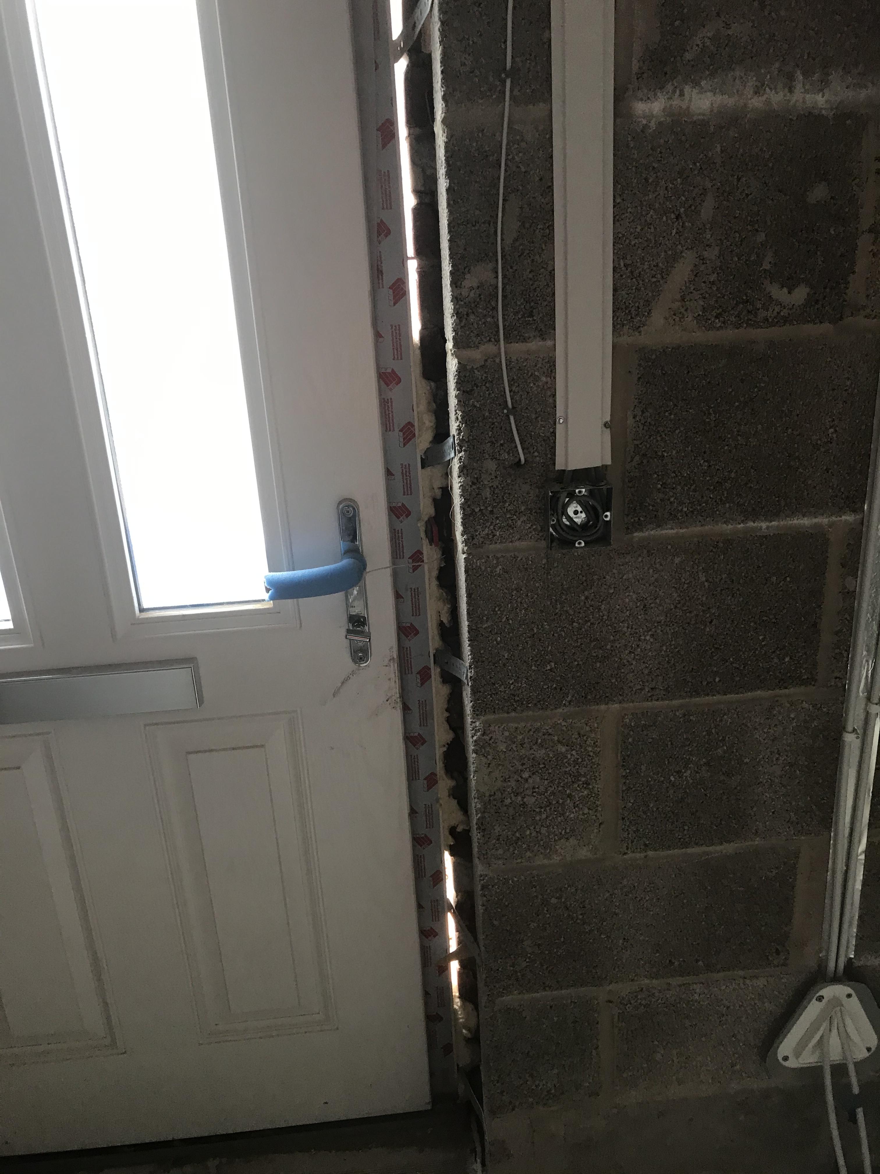

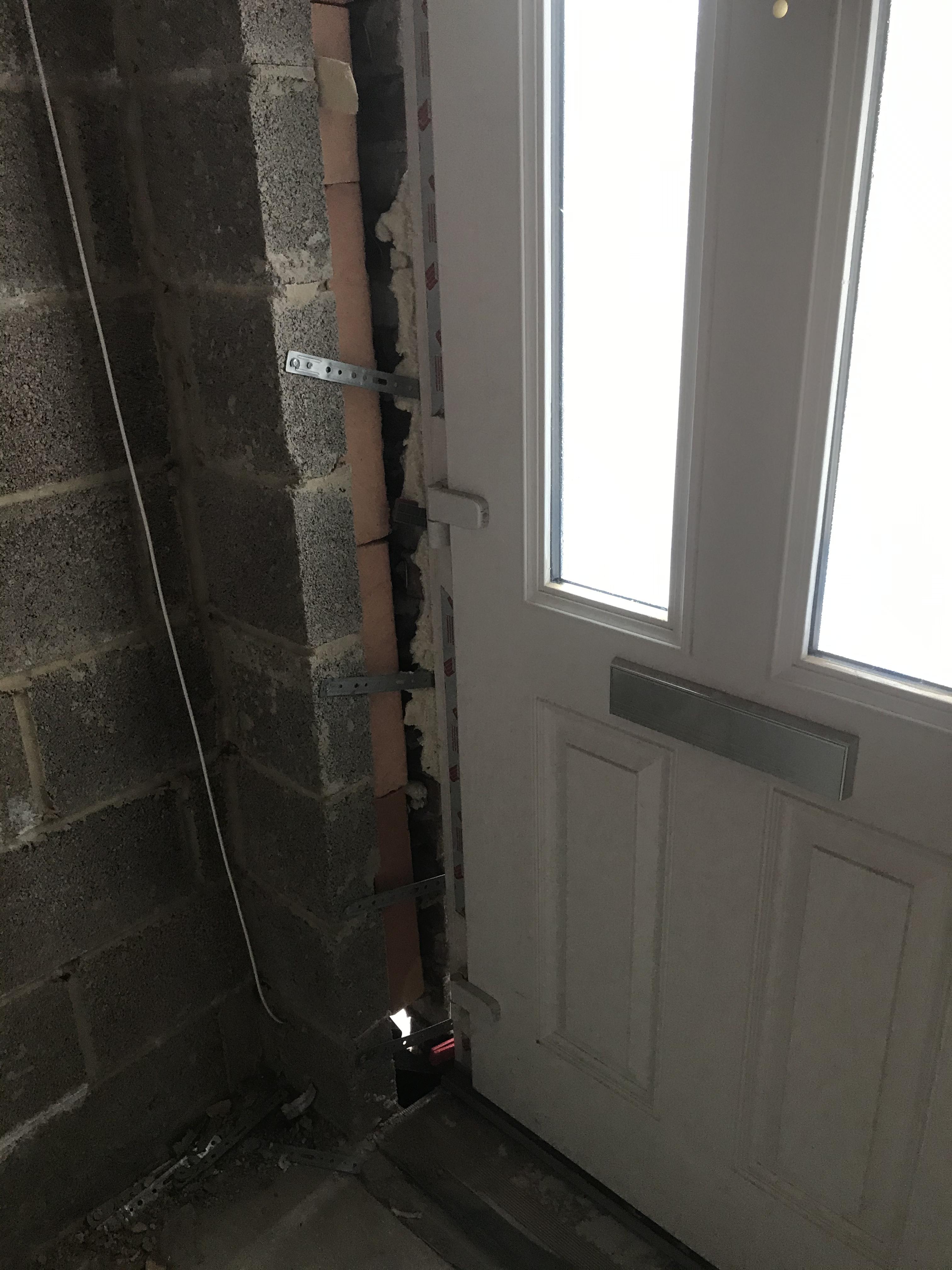

nod Posted November 15, 2020 Share Posted November 15, 2020 12 hours ago, gwebstech said: Hi guys Im getting ready to book my airtightness test and im wondering what they do with the vents on the windows and doors? do they just tape them up and tjhe same for the extraction fans too? im a bit worried as i have french doors and all that joins the 2 doors is a pipece of plastic screwed in place, it doesnt seem to have any rubber seal around it and what if you dont pass the test - do you need to rebook it and pay again? thanks I wouldn’t worry Ive never heard of a air test fail They normally work around the number you give them pictured is a site that we are doing at the moment The houses leak like a civ But ALL scot a 2 1 1 Link to comment Share on other sites More sharing options...
Oz07 Posted November 15, 2020 Share Posted November 15, 2020 No chance that is a legit score @nod When I told the site manager where I'm working what mine scored he genuinely thought it was impossible. OP the test company should tape everything up. 1 Link to comment Share on other sites More sharing options...
nod Posted November 15, 2020 Share Posted November 15, 2020 No None of them are If you look online how many companies are offering air testing it explains Tge oresure they are under to follow the sap Before this all began I was working on one of the largest Medicine storage facilities We where still sealing the building when four range rovers arrived with four massive fans and requested no one leave for 60 minutes It was several days before we finished sealing the building yet it still scored slightly under two While it is a very well put together refrigerated building It simply wasn’t ready Link to comment Share on other sites More sharing options...
