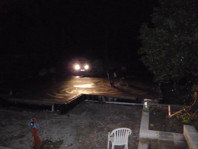

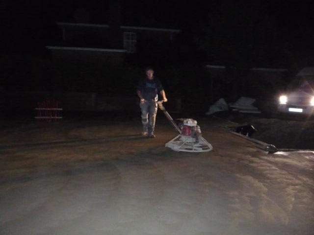

Bitpipe Posted November 10, 2020 Posted November 10, 2020 I recall from others here that power floating can be a bit stressful as it can only commence when the floor is starting to go off and if the concrete is late to site you can be doing this late in the evening much to the annoyance of neighbours etc. Once set, concrete floors are also susceptible to staining from oils and other liquids, until sealed they are very absorbent. Then you have damage from drops, drags scuffs etc. Corex is better than nothing but not very durable, you'd need to use ply or carpet to really protect it and that won't be cheap. In a similar vein, we only installed our final staircase once the complete build was finished and all trades had left. We used cheap MDF stairs during the build and when the final stairs were ordered, we had all the final finished floor levels to measure from. You can get a microscreed (2-3mm) that gives a polished concrete effect, we looked into this but went with resin instead.
HerbJ Posted November 10, 2020 Posted November 10, 2020 7 minutes ago, Bitpipe said: if the concrete is late to site you can be doing this late in the evening much to the annoyance of neighbours etc. I remember it well. Concrete delivery was late and weather conditions were such that concrete would not go off as quick as anticipated Bottles of wine for neighbours, fish and chips for the MBC team. 2200hr in September, finally had to stop.
Bitpipe Posted November 10, 2020 Posted November 10, 2020 3 minutes ago, HerbJ said: I remember it well. Concrete delivery was late and weather conditions were such that concrete would not go off as quick as anticipated Bottles of wine for neighbours, fish and chips for the MBC team. 2200hr in September, finally had to stop. Our 120m2 slab was in basement so never considered floating it but I remember our fifth and last concrete load arrived hours after the previous four - the pump needs to keep running (and they are noisy) so we didn't wrap up until 6.30pm.
HerbJ Posted November 10, 2020 Posted November 10, 2020 (edited) Fortunately, the slab was only being floated to give good surface for tiling and other floor finishes. So, the finish we managed to achieve was acceptable, though not to the expected standard. It was never our plan to have a"polished floor" as the final finish. Edited November 10, 2020 by HerbJ
