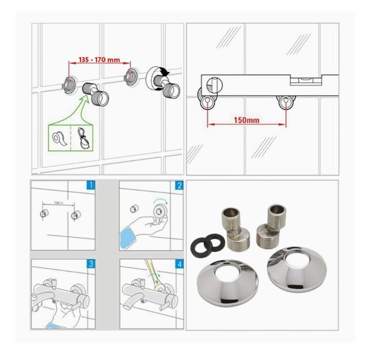

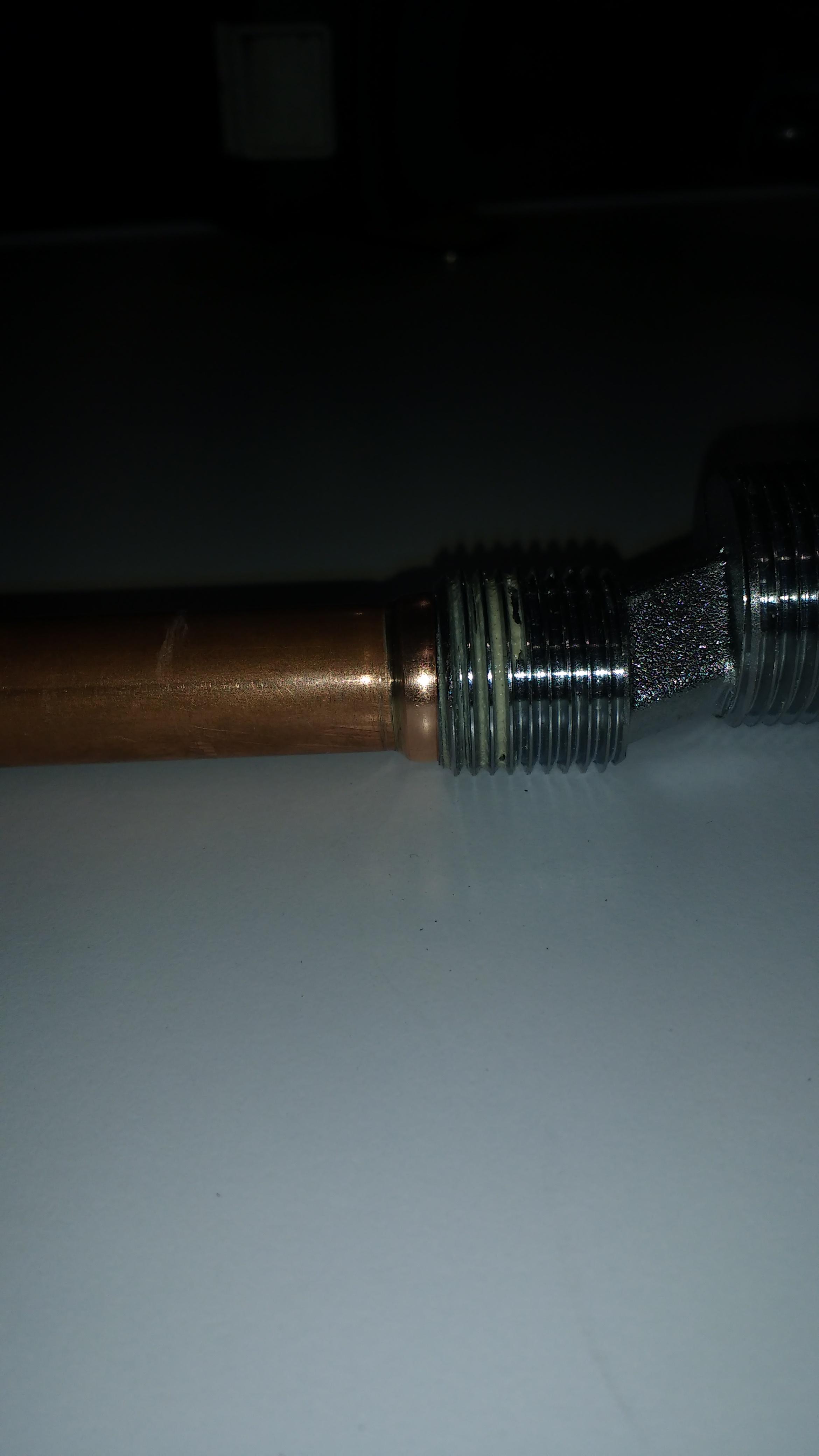

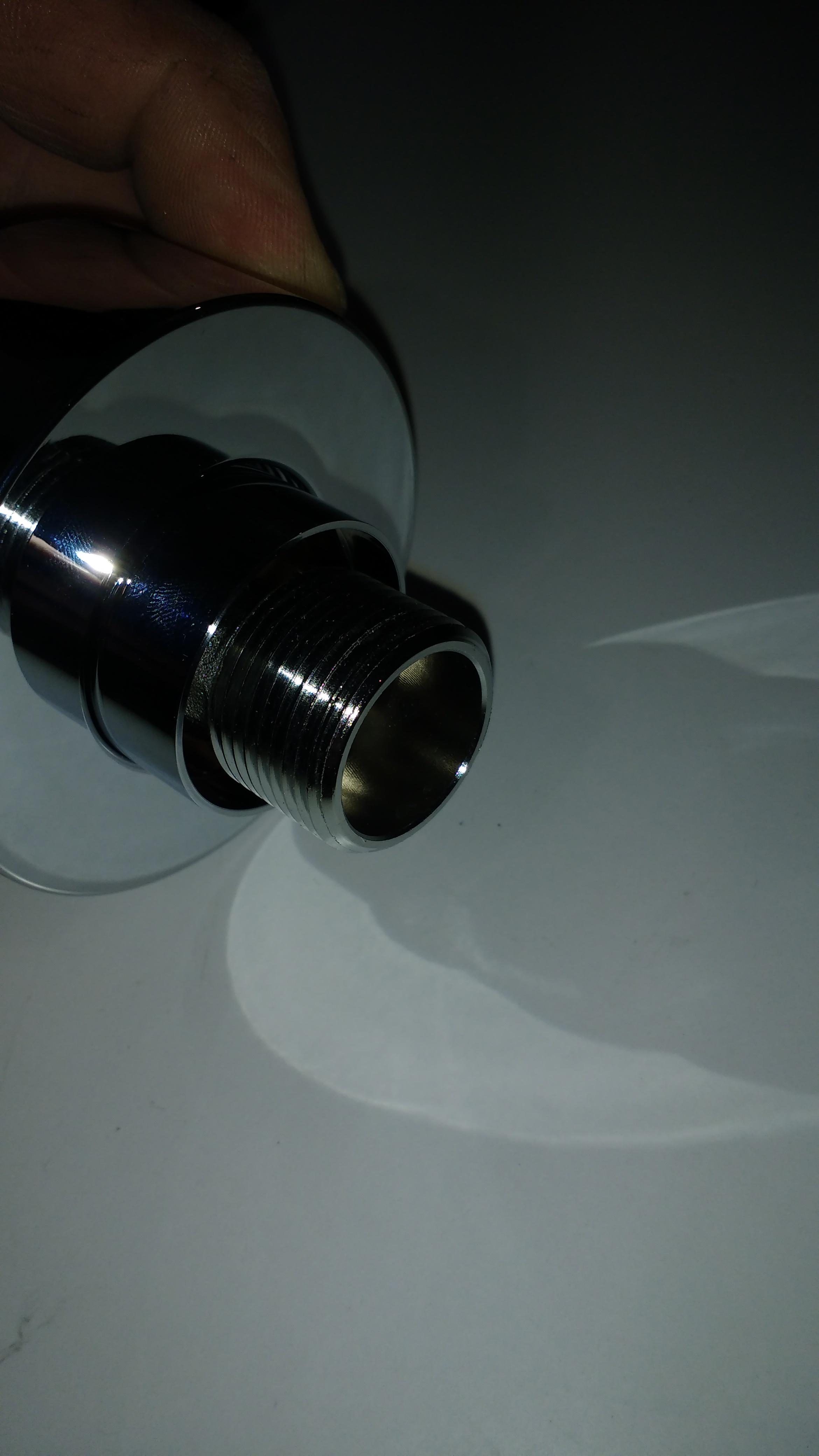

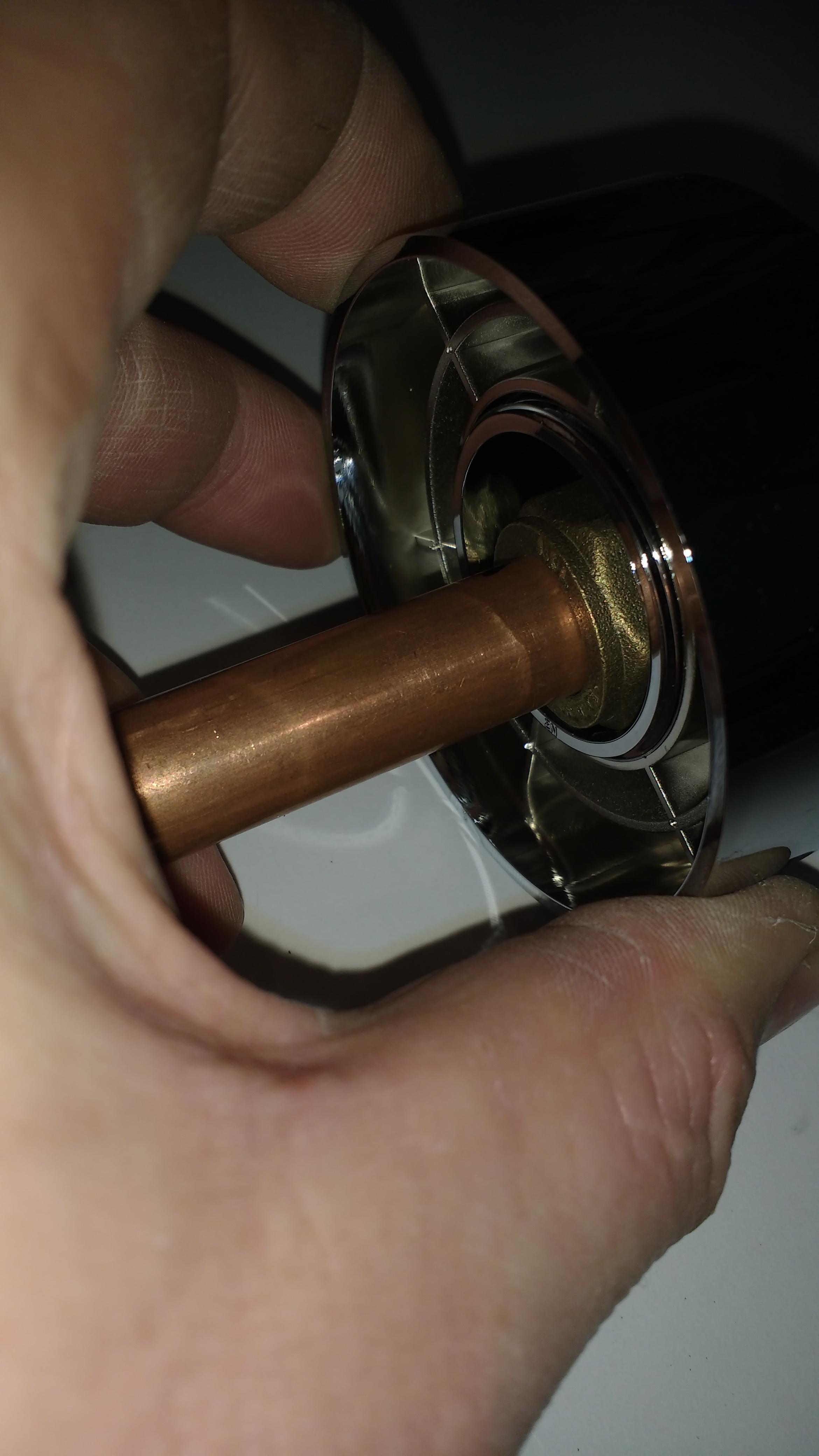

amavadia Posted October 17, 2020 Share Posted October 17, 2020 Hi need some help fitting a shower bar. 150 centres but the pipes are 145. ive got wall mounts and the shower cake with cranked connectors. But the smaller end of the crank does not fit on the wall mounts. Cant seem to find any crank connectors which have the larger thread on both ends either. moving pipes would be almost impossible now without damaging. any ideas? Link to comment Share on other sites More sharing options...

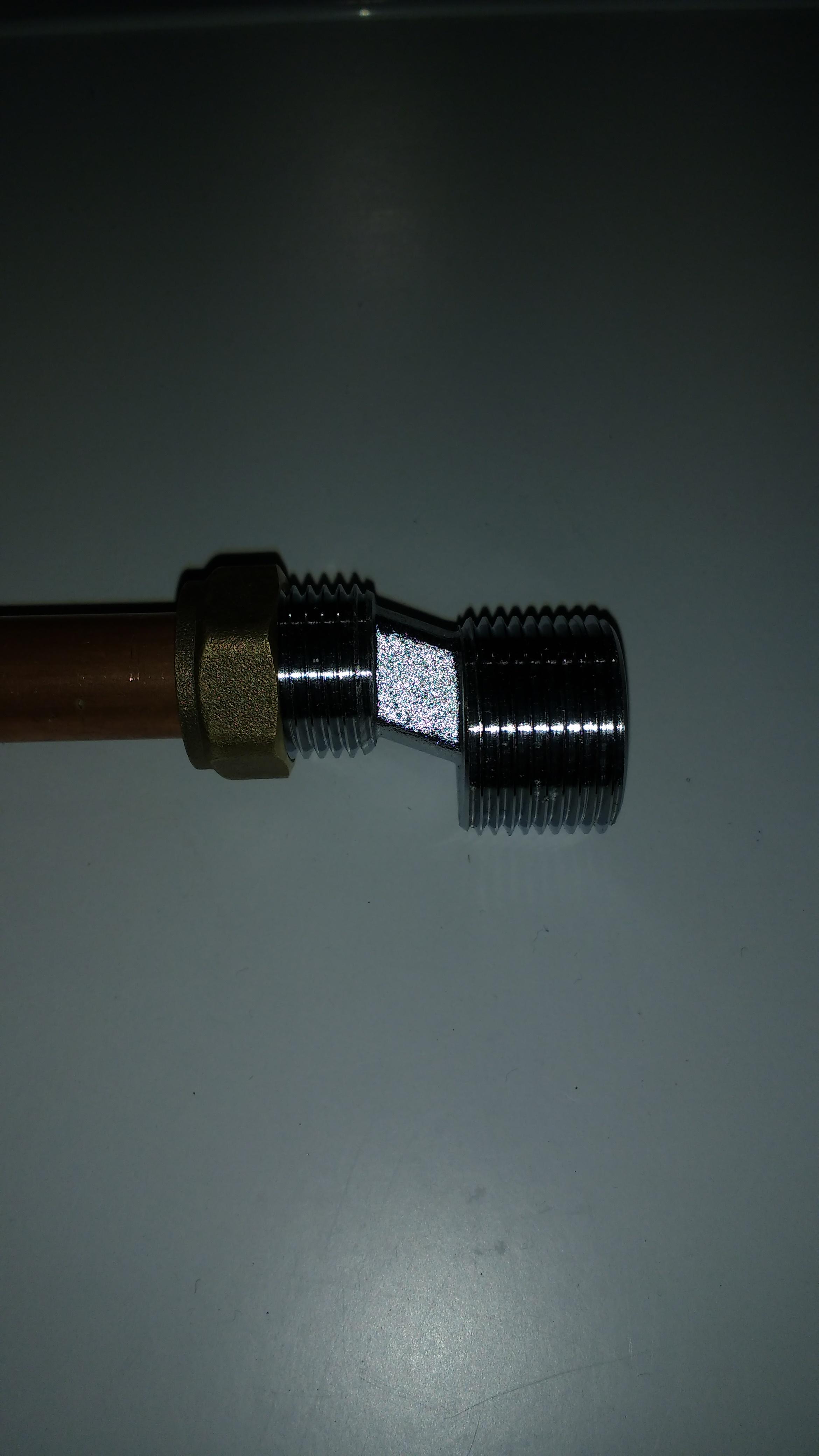

ProDave Posted October 17, 2020 Share Posted October 17, 2020 The fitting you have is a front mount fitting often championed on this forum. The idea is you adjust those for final spacing from the front then screw them to the wall and the shower bar fits straight onto those. The cranked fittings you have screw into a female BSP fitting. That is an alternative way of doing it, you fit the female BSP behind the wall at roughly the right spacing and used the cranked adaptors to make the final adjustment. the two are not compatible. Apart from anything else if you could use the cranked fitting like that, the bar would be a long way off the wall. Link to comment Share on other sites More sharing options...

Onoff Posted October 17, 2020 Share Posted October 17, 2020 Those cranked things are meant to work like this as @ProDave said: Link to comment Share on other sites More sharing options...

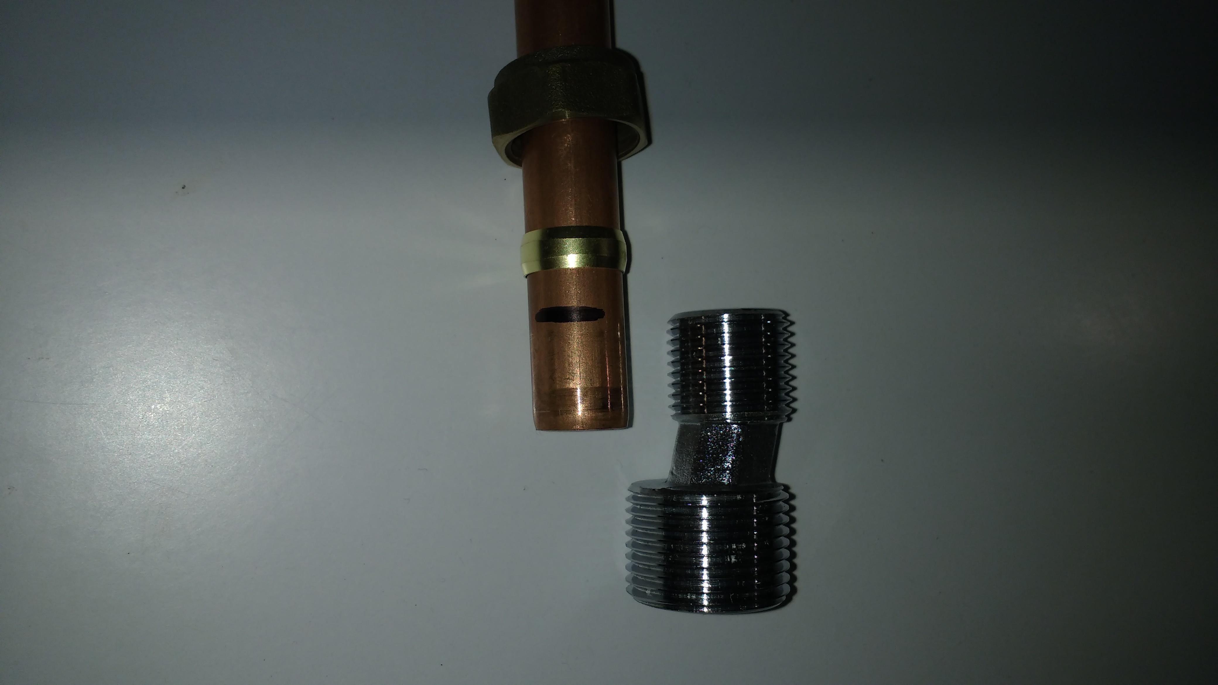

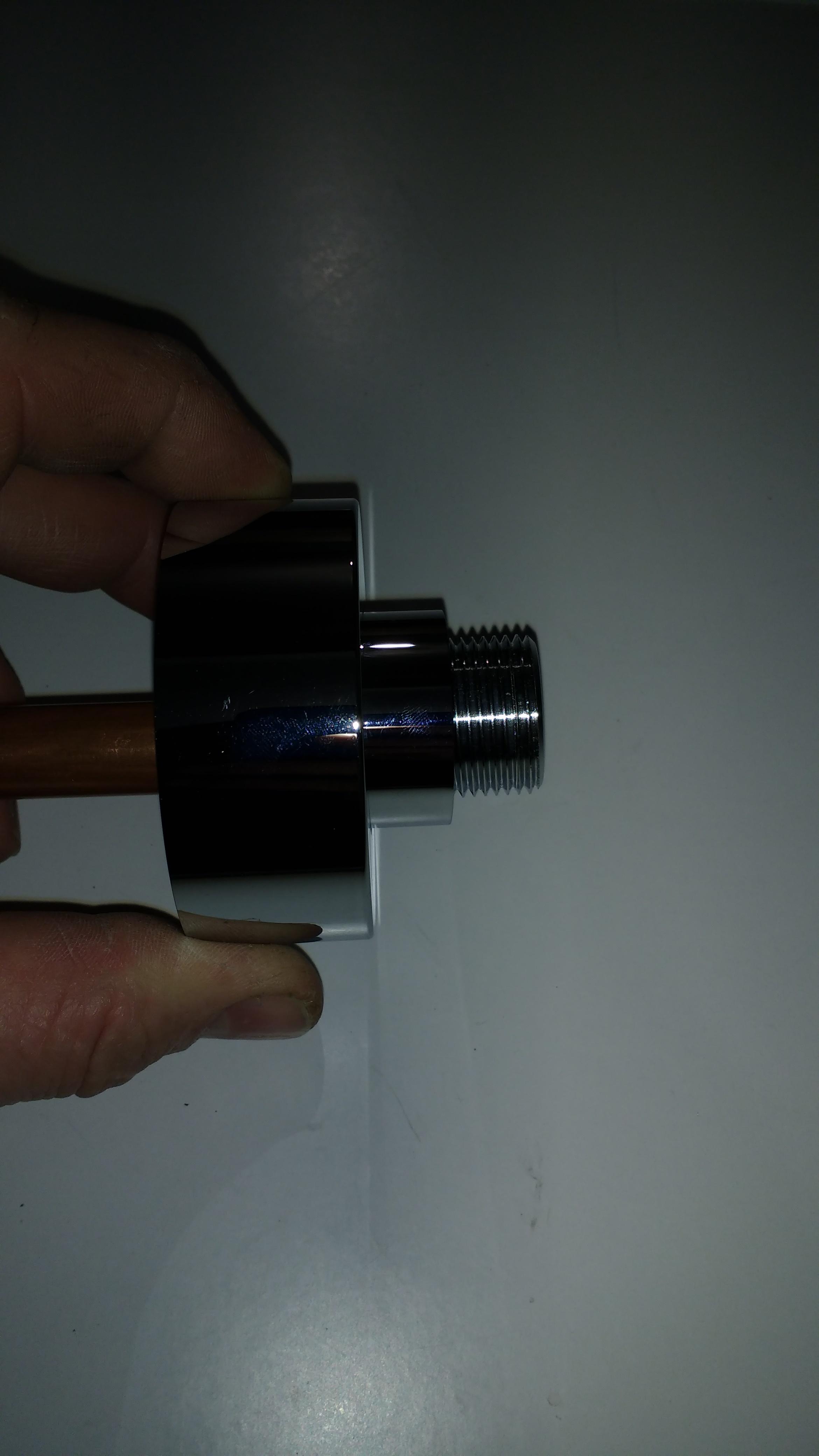

Onoff Posted October 17, 2020 Share Posted October 17, 2020 Hmmm...what if you were to ditch the silver bit with the spanner flats on. Then put a 1/2" nut over the pipe, olive then the cranked adapter. Would the cover plates that go over the 3/4" end of the cranked bit be deep enough to hide your faux pas? @Nickfromwales!!!! Link to comment Share on other sites More sharing options...
ProDave Posted October 17, 2020 Share Posted October 17, 2020 41 minutes ago, Onoff said: Hmmm...what if you were to ditch the silver bit with the spanner flats on. Then put a 1/2" nut over the pipe, olive then the cranked adapter. Would the cover plates that go over the 3/4" end of the cranked bit be deep enough to hide your faux pas? @Nickfromwales!!!! I doubt the cranked bit is the right size or has a tapered inlet for an olive. And if it could be engineered to work, it would still stick out to far and not get covered by the cover plates. Have you cemented the pipes solid in the wall then? The idea is there should be a bit of slack in them so you can set the final spacing then screw the brass bits to the wall at that spacing. Link to comment Share on other sites More sharing options...

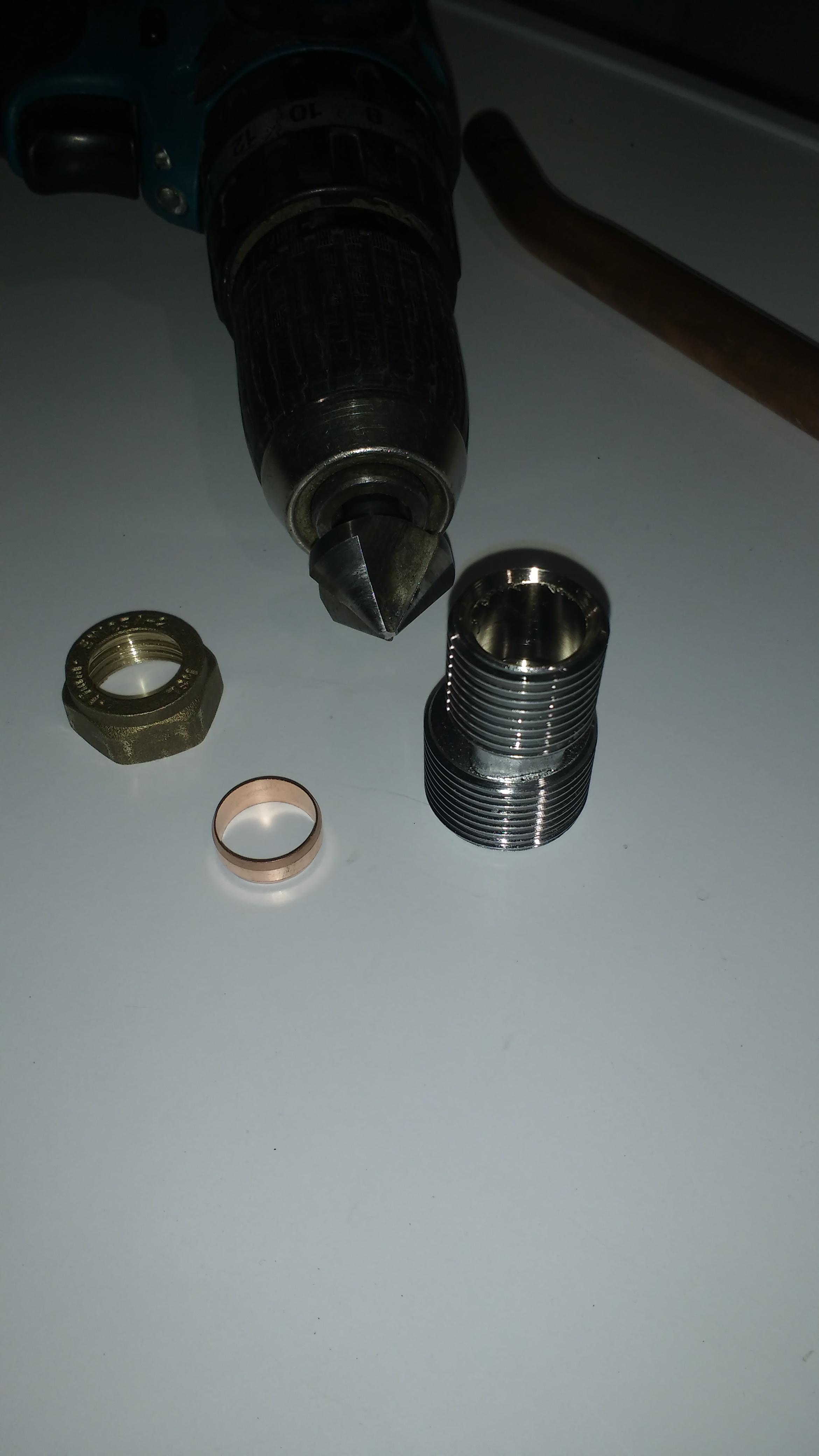

Onoff Posted October 17, 2020 Share Posted October 17, 2020 (edited) 46 minutes ago, ProDave said: And if it could be engineered to work OK 15mm pipe goes into the cranked fitting by a country mile: I could probably countersink the end a bit to make a seat for the olive. So it'd look something like this. Back of nut against the tiles. You'd lose that square plate brass backing plate thing: Next, found in the "this is going down the tip unless I can find a hoarder to take it box" kindly donated by @PeterStarck: What are these btw Peter? Ending up something like this: Might need a good dose of silicone to fill the gap: Bits in the post if you want to have a play. Edit: Sorry about the photo quality. Edited October 17, 2020 by Onoff Link to comment Share on other sites More sharing options...

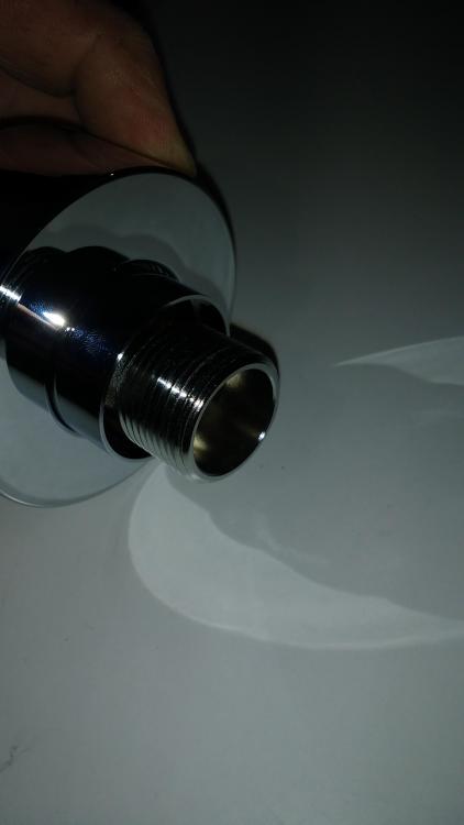

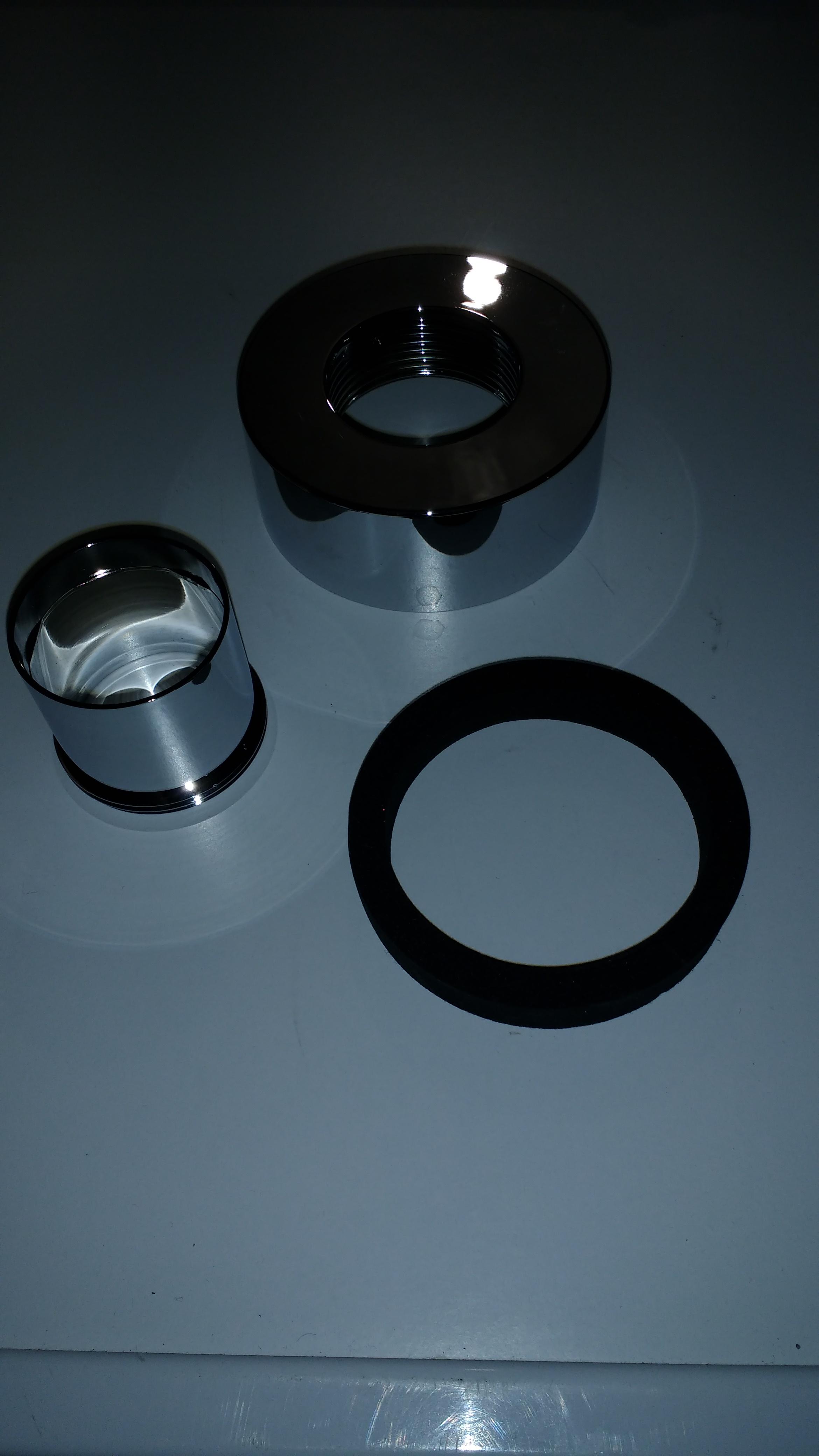

Nickfromwales Posted October 17, 2020 Share Posted October 17, 2020 People, stop right there. The fittings in the first pic are what the shower connects to, and the cranked bits go in the bin !! I can only hope that the pipes coming out of the wall are at 150mm centres? @amavadia please measure the pipe centres and post back. 3 hours ago, Onoff said: Those cranked things are meant to work like this as @ProDave said: .....only IF you need the offset. If the pipes are at 150mm centres then the shower goes straight onto the fittings supplied with the brass backplates. Link to comment Share on other sites More sharing options...

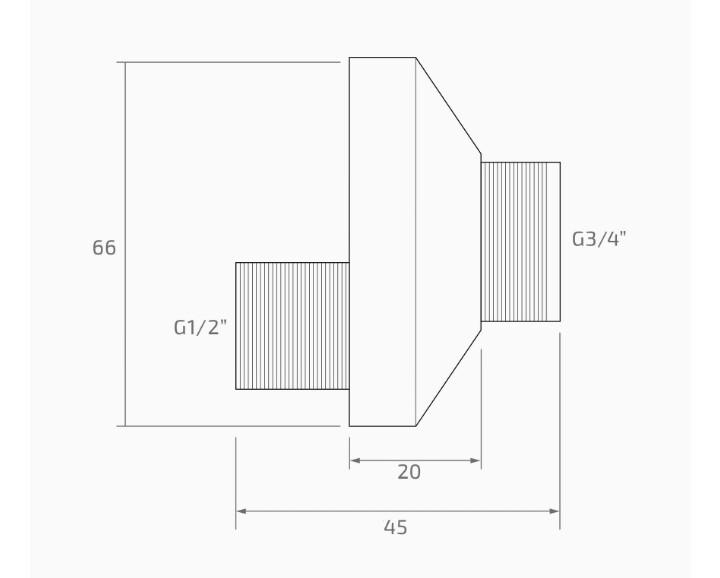

Nickfromwales Posted October 17, 2020 Share Posted October 17, 2020 Also, the 1/2" side of the 3/4" x 1/2" cranked union is flat faced, so CANNOT take the bevelled edge of the olive. That can ONLY be PTFE taped and put into a female brass union and cannot be made off directly to copper as shown in "the bodge" above. Blue Peter badge for trying, but that could just blow straight off with the water pressure alone. Link to comment Share on other sites More sharing options...
wozza Posted October 17, 2020 Share Posted October 17, 2020 (edited) 5 hours ago, amavadia said: Hi need some help fitting a shower bar. 150 centres but the pipes are 145. Are the pipes loose behind the tile, do they have any wiggle in them? is it just the holes in the tiles that are spacing them at 145mm? Can you cut out 2.5mm from the tile each side of each pipe and push the pipes out to widen the spacing to 150mm? As has already been said - the silver threaded section with the flats on is used to compress the olive onto the bracket - the shower them screws directly on. The cranked connectors are not designed to be used with those brackets. The brackets need to be spaced correctly. Edited October 17, 2020 by wozza Link to comment Share on other sites More sharing options...
Onoff Posted October 17, 2020 Share Posted October 17, 2020 7 minutes ago, Nickfromwales said: Also, the 1/2" side of the 3/4" x 1/2" cranked union is flat faced, so CANNOT take the bevelled edge of the olive. That can ONLY be PTFE taped and put into a female brass union and cannot be made off directly to copper as shown in "the bodge" above. Blue Peter badge for trying, but that could just blow straight off with the water pressure alone. See, this is what happens when the kids are left unsupervised! Surely the olive would tighten onto the pipe to stop it popping apart? Aware it's flat, I'd have countersunk the face anyway to take the olive. 1 Link to comment Share on other sites More sharing options...
Nickfromwales Posted October 17, 2020 Share Posted October 17, 2020 3 minutes ago, Onoff said: See, this is what happens when the kids are left unsupervised! Surely the olive would tighten onto the pipe to stop it popping apart? Aware it's flat, I'd have countersunk the face anyway to take the olive. No it wouldn't, and don't call me Shirley Link to comment Share on other sites More sharing options...

amavadia Posted October 17, 2020 Author Share Posted October 17, 2020 4 minutes ago, Nickfromwales said: errrrr, ?? The pipes are 145mm centres unfortunately. Thats the whole problem here otherwise I wouldnt have needed to use the cranked pieces and the wall mounts would have been fine connecting straight to the bar. So will try and make some more play in the pipes to spread them by another 5mm and then just use the wall mounts Link to comment Share on other sites More sharing options...

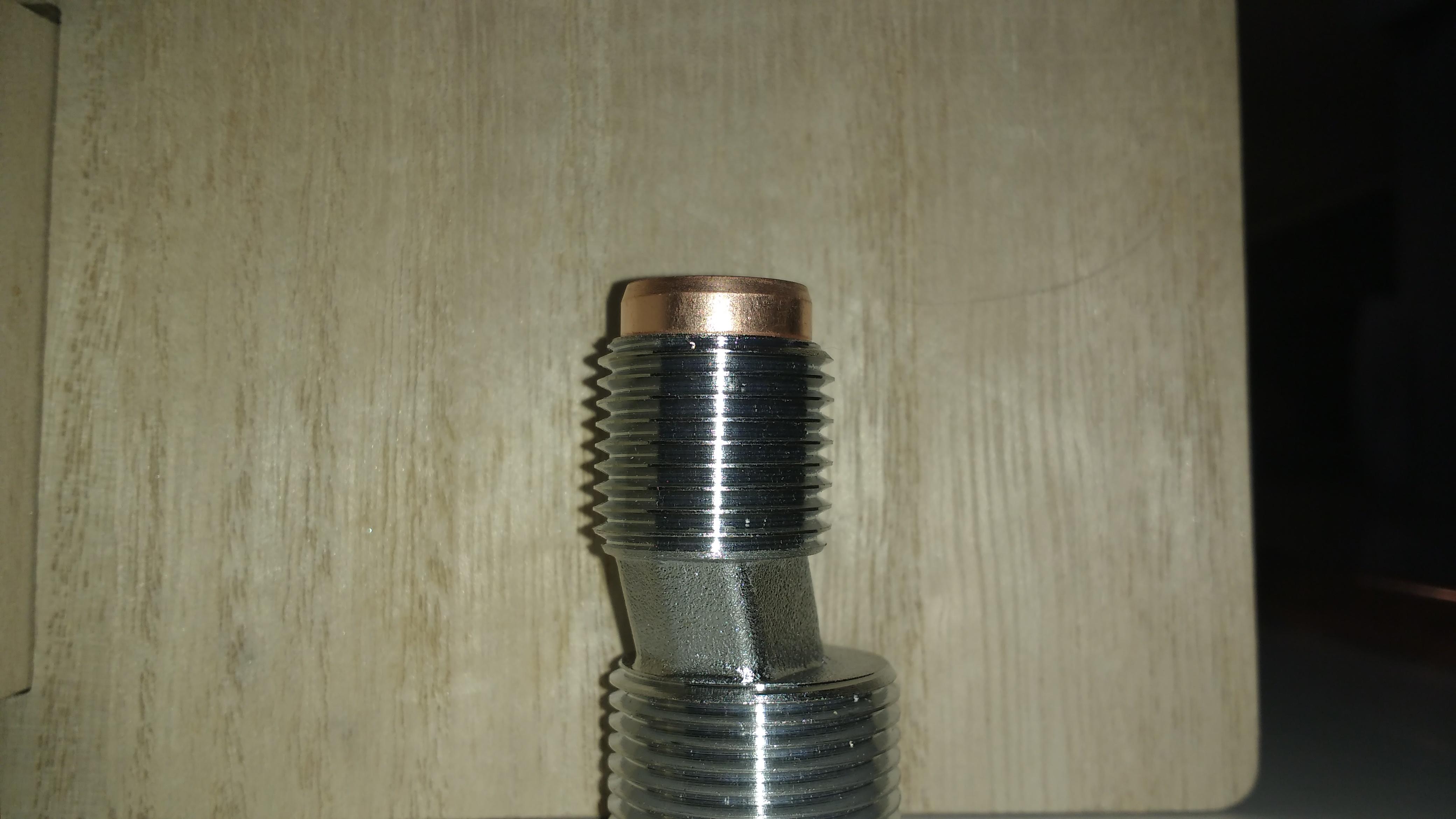

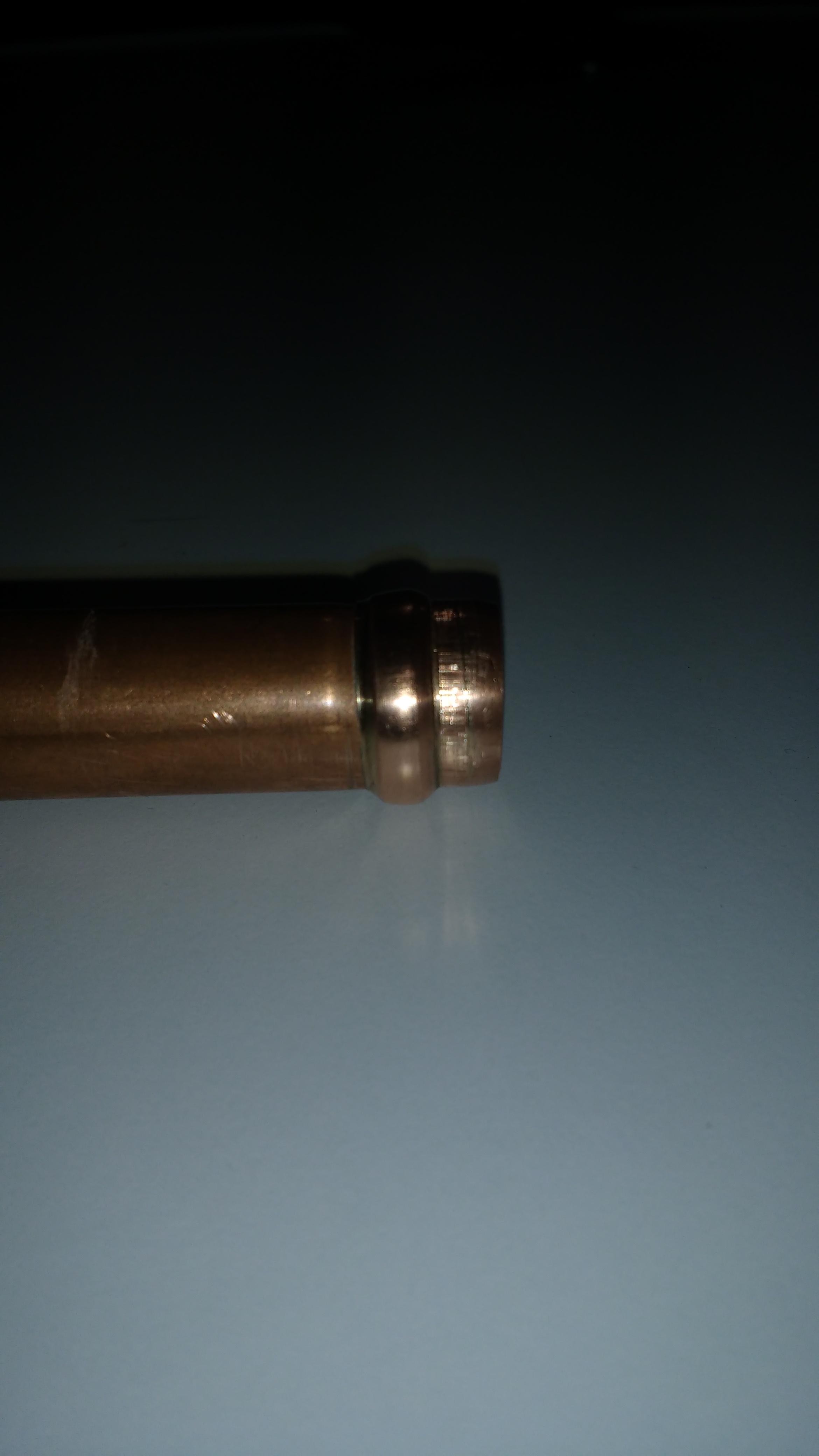

Onoff Posted October 17, 2020 Share Posted October 17, 2020 21 minutes ago, Nickfromwales said: No it wouldn't, and don't call me Shirley I'm missing An Officer And A Gentleman for this! So I countersunk the fitting: Olive fits in the chamfered end a treat: A bit of Jet Blue Plus to lube things up. I'd need to take the burr off created by the countersinking so the pipe goes in further: Imho it works. Didn't go OTT with tightening the nut but it definitely squeezes the olive into the pipe. I'd risk it: (No I don't have a life ?) 2 2 Link to comment Share on other sites More sharing options...

Nickfromwales Posted October 17, 2020 Share Posted October 17, 2020 2 minutes ago, amavadia said: The pipes are 145mm centres unfortunately. Thats the whole problem here otherwise I wouldnt have needed to use the cranked pieces and the wall mounts would have been fine connecting straight to the bar. So will try and make some more play in the pipes to spread them by another 5mm and then just use the wall mounts Gotcha. Use a high speed diamond bit to enlarge the holes. Macrist bit is damn good, as porcelain is tough as old boots. example. Use a water spray bottle to keep the drill bit soaking wet at all times. Two person job ideally. Use that to enlarge and then see if the pipes will move at all. 2.5mm on each pipe should be possible. The weight of the shower is supported by the drill holes that you then make to fit the brass plates back to the wall with screws. Fitted loads of these without issue so no probs there. 1 Link to comment Share on other sites More sharing options...
PeterW Posted October 17, 2020 Share Posted October 17, 2020 5 minutes ago, Onoff said: I'm missing An Officer And A Gentleman for this! Sure you’re not watching something by Clint Eastwood running a countersink into the end of a fitting ...??!!! I’m with @Nickfromwales on this, dremel with a carbide burr and cut the edge out of the hole where the pipe is. 1 Link to comment Share on other sites More sharing options...
