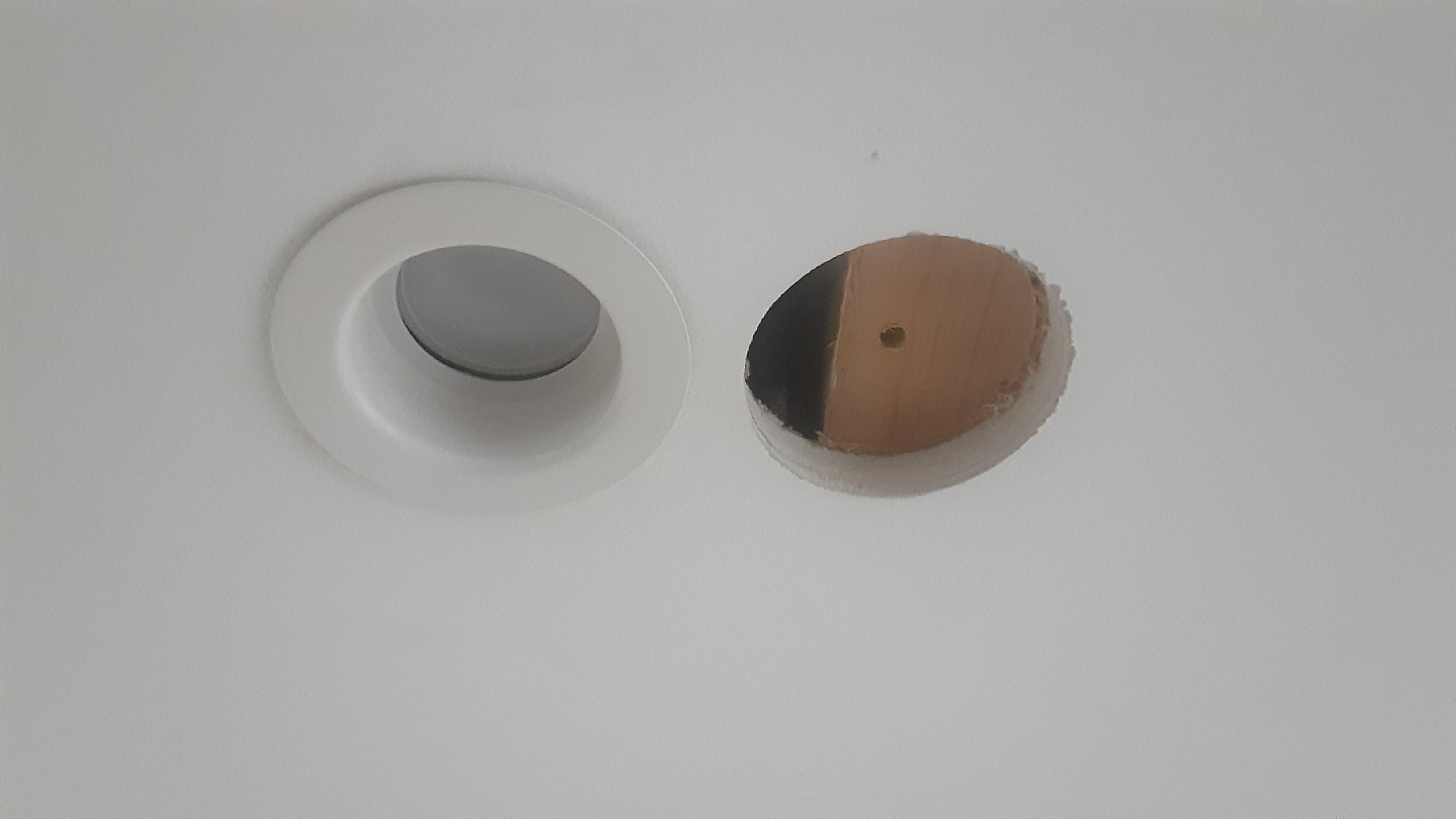

ToughButterCup Posted October 17, 2020 Share Posted October 17, 2020 ... apart from knocking the house down and starting again..... I'm told we've all done it, so we've all sorted it out. Help me not to cock the repair up please. Ta! Link to comment Share on other sites More sharing options...
Onoff Posted October 17, 2020 Share Posted October 17, 2020 Been there! Piece of plasterboard cut with the same hole cutter. Affix with one or two pb screws but leave a constant gap round the edge. Squirt in some no nails or similar with an uncut nozzle. Make sure the no nails is below the surface. Finish with Easifill. Paint and forget. Link to comment Share on other sites More sharing options...
Russell griffiths Posted October 17, 2020 Share Posted October 17, 2020 You’ve just built a whole house, I’m sure you can figure out how to patch that up, c,mon mix up up an egg cup full of board adhesive, dampen sides of hole , coat edges with adhesive, fit cutout back in hole. Fill with fine surface filler, re paint. Sort of like onoff but I don’t like no nails as it’s non sand able so any drips or bits that hang down are a pain, board adhesive can be allowed to squidge out and trimmed back with a knife before filling. Link to comment Share on other sites More sharing options...
MJNewton Posted October 17, 2020 Share Posted October 17, 2020 (edited) Access ceiling from above, reposition joist, move light back to original hole... Edited October 17, 2020 by MJNewton 1 2 Link to comment Share on other sites More sharing options...
Onoff Posted October 17, 2020 Share Posted October 17, 2020 I could get to my faux pas from both sides and it was pre skimming do I clamped the pb round in with a couple of bits of batten. Secured with no nails or similar. Once set the round was perfectly level. I might in TB's case, genuinely fill the gap (sub level) with intumescent mastic with the aim of retaining the fire integrity of the board at that point. I didn't do this on as I have fire hoods covering the downlights. Different strokes etc. Link to comment Share on other sites More sharing options...

Onoff Posted October 17, 2020 Share Posted October 17, 2020 Just screw a round in and Easifill. You'll have it done and painted before SWMBO gets back and she'll be none the wiser! ? Link to comment Share on other sites More sharing options...
PeterW Posted October 17, 2020 Share Posted October 17, 2020 32 minutes ago, Onoff said: I might in TB's case, genuinely fill the gap (sub level) with intumescent mastic with the aim of retaining the fire integrity of the board at that point. I didn't do this on as I have fire hoods covering the downlights. Different strokes etc. Using board adhesive as @Russell griffiths said rather than no nails etc would do that anyway so no need as the adhesive has a fire rating. Link to comment Share on other sites More sharing options...
ProDave Posted October 17, 2020 Share Posted October 17, 2020 I have seen some that make that mistake, and then carry on and drill out half the joist so the light can still go in the "right" place. No don't do that. Link to comment Share on other sites More sharing options...
wozza Posted October 17, 2020 Share Posted October 17, 2020 I have done it - and repaired pretty much the same as everyone has suggested. Before completing the repair - use the joist as a datum to check the rest of your holes will be in the correct place Link to comment Share on other sites More sharing options...

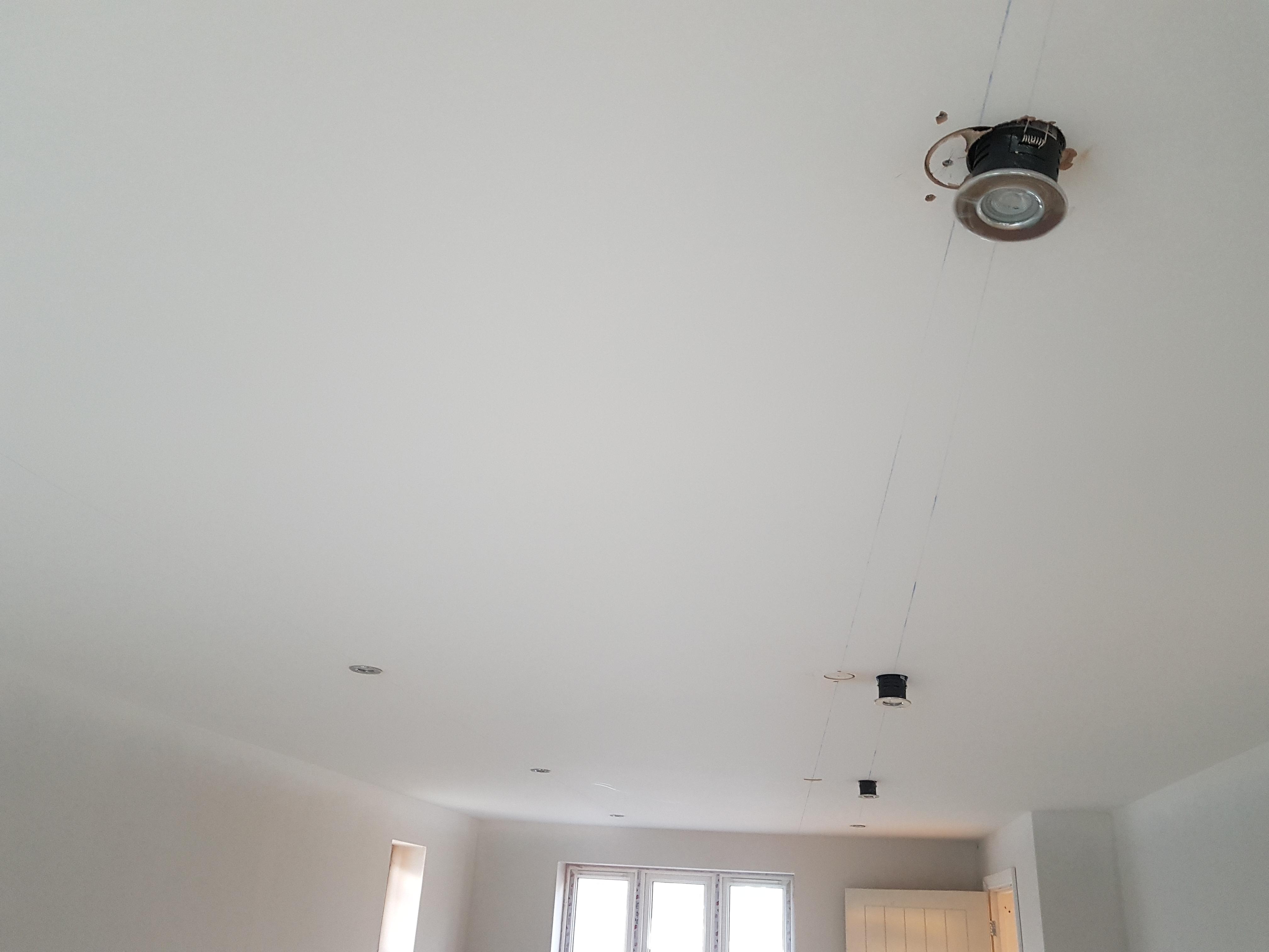

Oz07 Posted October 17, 2020 Share Posted October 17, 2020 Look what this idiot did the other day. Not my job I'm just there subbing. I mean the fact he uses chalk annoys me as opposed to laser, then the fact he can't see it's not running parallel with the wall. Worst bit is it wasn't even the apprentice. Client visited the 9ther day, apparently used to be in f1, is now into automation and he has an eye for detail. He going to be in for a world of pain when he moves in here. Asked me to quote to board his garage loft think I'll swerve that one thanks... Link to comment Share on other sites More sharing options...
