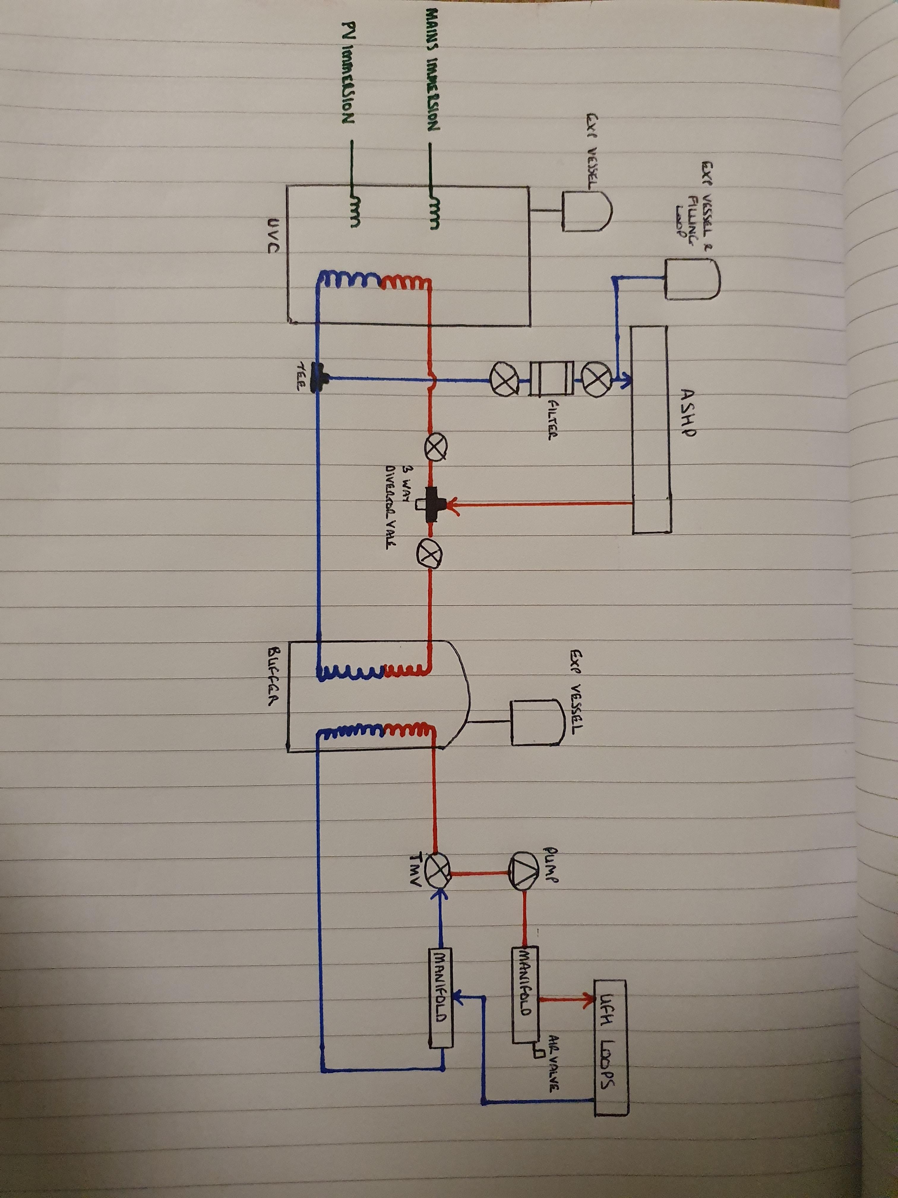

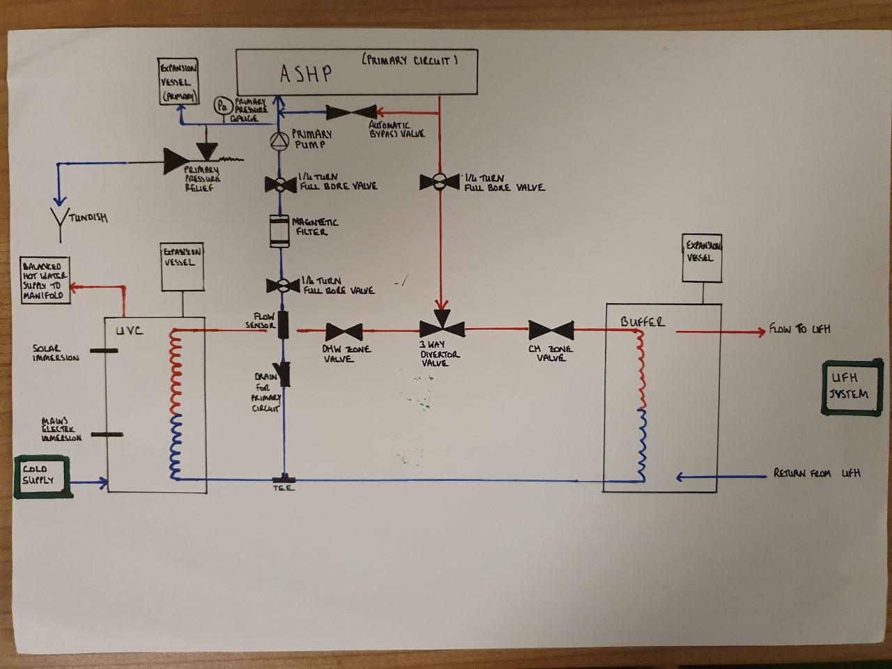

Hi folks,
I've read everything I can on here and have tried to blend all the drawings I came across into one. The sketch below is where I am at so far, if advice can be given as to whether I'm on the right track, if not why then that would be much appreciated.
TIA

  • The first drawing has two coils for buffer tank, second has one. So the coil in the buffer tank is to circulate the ASHP water through thereby heating the buffer tank. The UFH then taps directly into
  • Pump ..? Should be one on the cold return to the ASHP.    Buffer with coils - only a coil for either the UFH or the ASHP. Don’t need both. If buffering the UFH then you need the expansion on th
  • Thanks for the steer.   When drawing version 1 I forgot about the fact I have two manifolds tapped onto the buffer vessel rather than a coil (as per previous discussion on multiple manifolds
Buffer with coils - only a coil for either the UFH or the ASHP. Don’t need both. If buffering the UFH then you need the expansion on the UFH circuit.

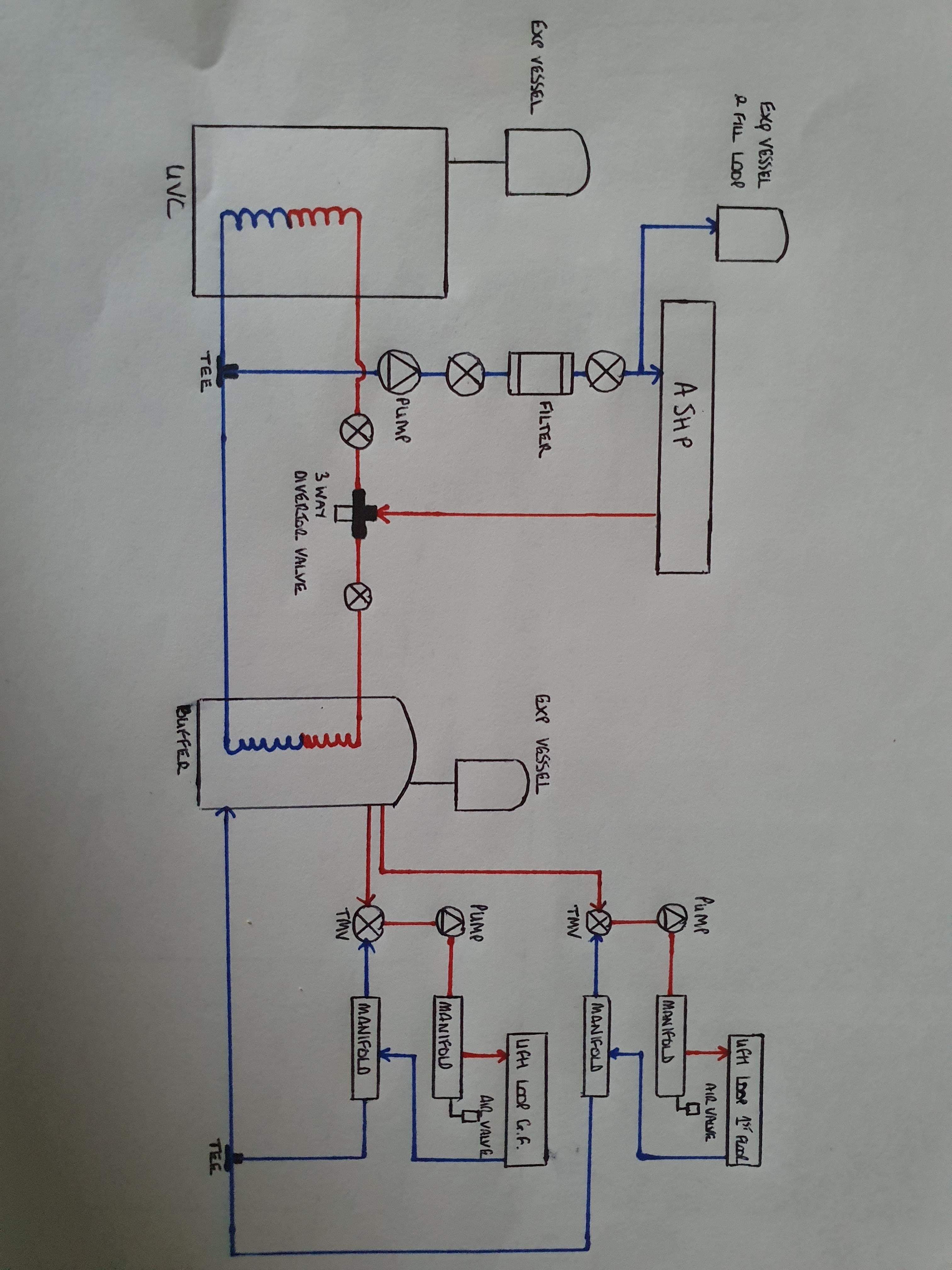

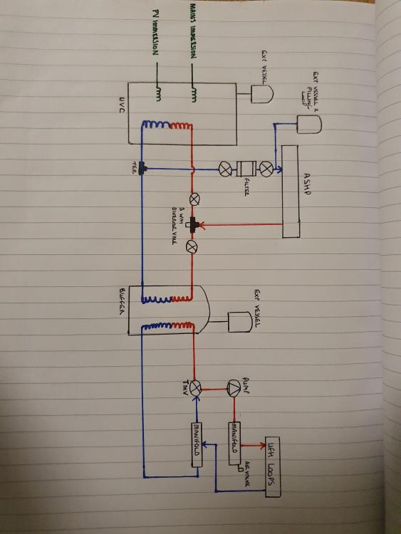

When drawing version 1 I forgot about the fact I have two manifolds tapped onto the buffer vessel rather than a coil (as per previous discussion on multiple manifolds!).
Version 2 now attached, any feedback is much appreciated.
Looks good to me. You will need some method of filling the UFH and buffer but another F&E will be easy to add.
Immersions in all the tanks are a good idea - even the buffer. It can act as your secondary dump for excess PV too.
Thanks Peter, F&E - fill & expansion? So make the expansion tank on the Buffer a fill loop aswell?
Good shout on the immersions in the buffer.

Yep you need some way to fill the buffer and loops - don’t forget to add some inhibitor too.
Thanks for the feedback Peter.
So a bit of reading tells me that inhibitor goes into the UFH loops to stop bacteria etc. growing and potentially blocking pipes.
The loop which goes from ASHP --> UVC/Buffer is filled as you mentioned elsewhere:
On 10/09/2018 at 22:44, PeterW said:
As @ProDave says - you can use ordinary inhibitor based antifreeze which isn’t that expensive and the volume is about 15-20% to get the cover down to -10c. It’s only really an issue if the ASHP isn’t in use and the outdoor pipes freeze - it takes water a fair while to drop to freezing point if they are insulated with 15mm of nitrile rubber insulation (35c to -2c is 9 hours from memory) so this is only really needed if the heat pump is not on for a long cold period or the power fails.
I plan to use a mix of decent insulation, an amount of inhibitor and also a timed frost programme on the heat pump to run the pump every couple of hours if the outside temperature is below zero. All those should resolve any issues.
Now I want to try and understand things a bit better if you don't mind giving me a steer?:
Expansion Vessels on the UVC & Buffer - is this a standard detail due to those systems being a closed loop and pressurised? i.e the UFH loop which draws from the heated water in the buffer needs somewhere to expand into as it heats, the UVC is a 'closed' loop until a tap opens up to draw water from the tank.
The circles with an X through them - these are something I've merged into my drawing from elsewhere, what are these and their purpose? Valves of some description, to isolate parts of the system?
Are there any other components that should be included which i have failed to include which i should take into consideration?
Just checking on this second drawing and your ref to buffer with coils etc as it still seems the same to my untrained eye!!TIA
The first drawing has two coils for buffer tank, second has one. So the coil in the buffer tank is to circulate the ASHP water through thereby heating the buffer tank. The UFH then taps directly into the buffer, using the heated water within for the UFH.
I'm still working on all of this in the background. I think the fundamentals are there but I suspect a lot of component parts are missing. What I'm after is a 'complete' schematic rather than a 'general overview' which is what I think I have at the minute.  As I learn more I will post amendments to the drawing. Not sure why in the four yrs or so this forum has been running that a 'complete' schematic has yet to be posted up. I know that there will be nuances to each install but when you have a ASHP/UVC/UFH setup i can't believe they will be that different in terms of setup from build to build?‍♂️

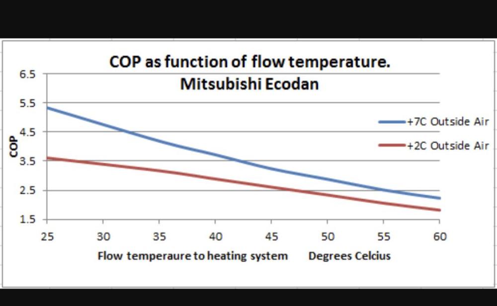

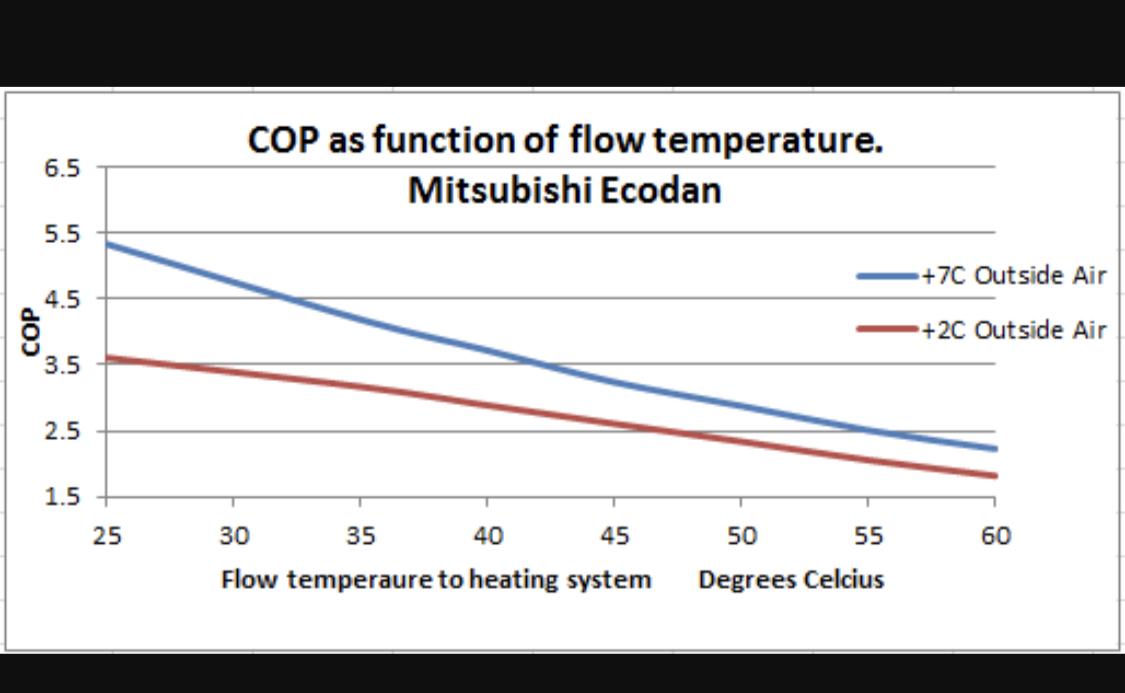

from my understanding the COP goes down with water temp. I’ve always been told/read that 35c would be much better over 45c for example. So therefore having the ASHP flow hotter than the final flow temp of the UFH means you’re running at a COP lower than needed
where have you seen 48c is a sweet spot? That seems high to me.
My ASHP can only be set to one temp and I need 48’ fir my DHW, My ASHP has never defrosted. I don’t have the ability to accurately measure my COP as I would be interested (if I could). ( @SteamyTea, as my tech support guy how could I do this?). I followed  @Jeremy Harris as I have the same ASHP as him, unfortunately he is not available to comment as he would know these things.

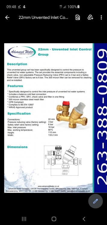

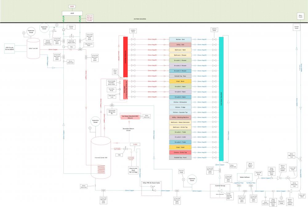

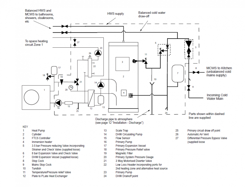

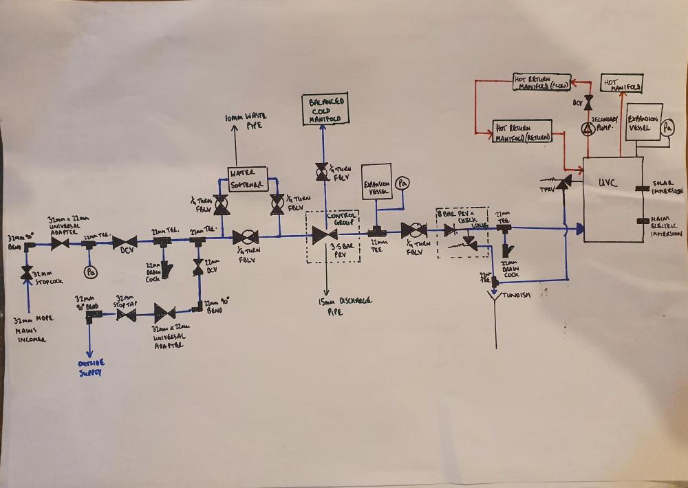

Well, I have started to focus my attention on the plumbing side of the build now. After a fair bit or reading and looking at other layouts etc. I have come up with an updated version, basically an amalgamation of everything I've come across so far.
A few queries I still have:
Is the filter supposed to go on the cold return?
Should there be an air vent on the primary circuit somewhere?
Should the PRV be there? The drawing from an Ecodan manual shows one, yet elsewhere I read not to put one in?
Does it matter what order the components go in i.e. of the cold return loop?
Flow sensor - is that needed? I came across a couple of drawings which showed one.
Any feedback would be appreciated.
