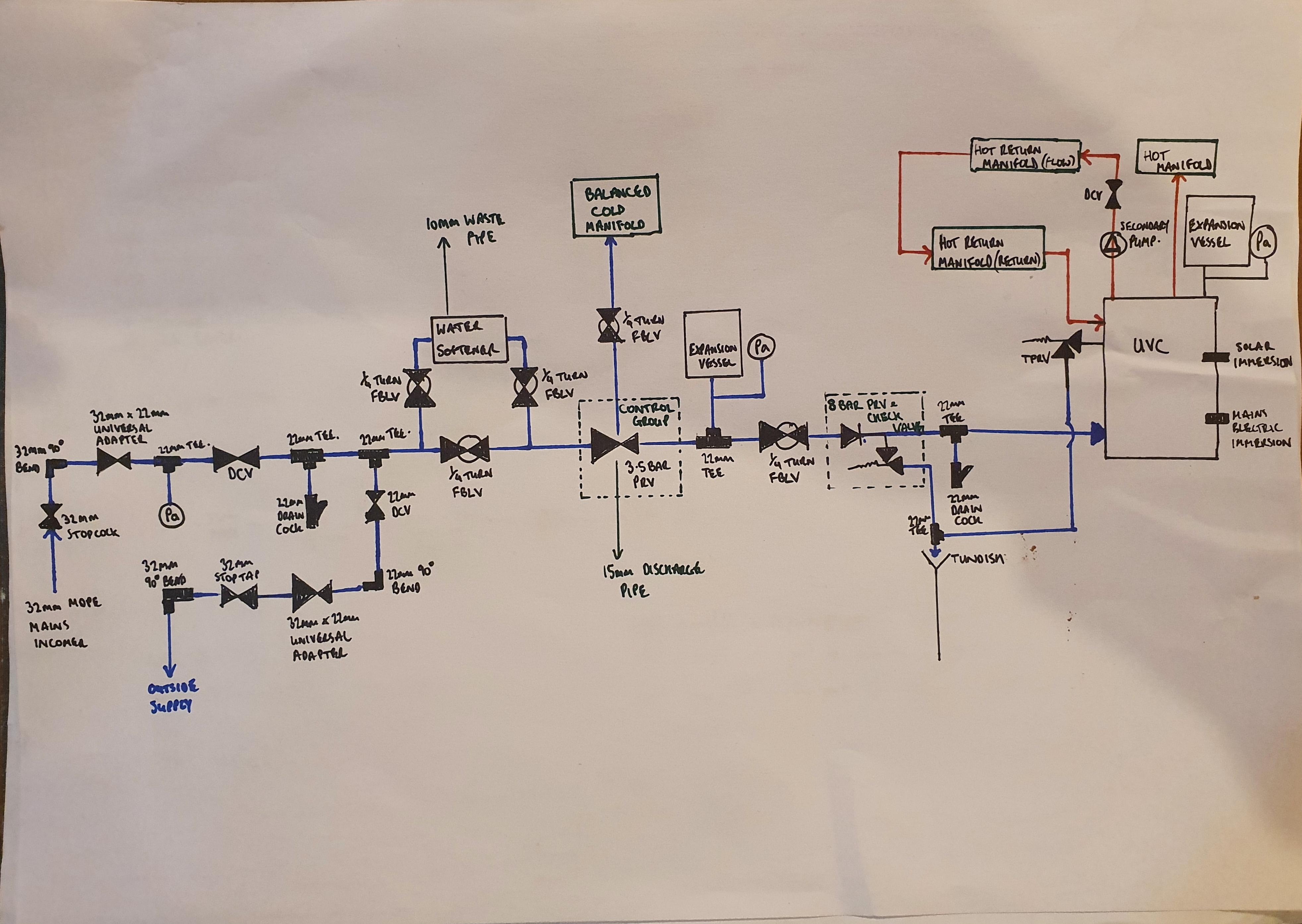

Nearly there!
Right folks, in particular @PeterW if you would be so kind to cast a critical eye here - this is the next piece of the plumbing puzzle.
It covers:
Mains incomer --> UVC and other Outputs
A few things I am pondering:
Are Y strainers required anywhere?
Pressure gauges anywhere - any harm in putting them in anyway?
Additional isolation valves required? Worth having more to isolate individual parts for maintenance etc?
Expansion vessels -missing? In wrong place?
Any feedback is much appreciated?
Don’t need the first PRV and strainer - balanced cold comes off the control group that you get with the UVC.
best place for UVC cold feed drain is as it goes into the tank.
Hot return goes into the tank at the top, not in to the cold feed.
I feed WCs off the same branch as the outside taps but that is preference - they don’t need to have soft water or be reduced pressure.
I've drawn the layout as if I have a naked cylinder and I'm plumbing in everything required.
With that in mind is the 3.5bar PRV drawn in the right place? I believe there needs to be one so that the pressure into the cylinder does  ot exceed 3.5bar and the balanced cold needs to come after it?
I've drawn the UVC cold drain as second to last, physically it would be right before the cold inlet on the UVC.
The HRC, not sure now why I drew it like that as I'm sure I read summat about it bot going in at the bottom as it disturbs the stratification etc in the UVC? - I understand which tapping you refer to.
Unsoftened water - I've been scratching my head over this one as there are conflicting POVs throughout the threads on the forum. Kitchen tap is the main one as I want a quooker tap so more reading needed here!
The control group comes with 4 ports. Inlet, reduced pressure outlet to the cylinder, balanced cold to the rest of the system and pressure relief, all in a single block.
The Expansion vessel goes after the control group and before the cylinder, and nothing can go between them (no valves).

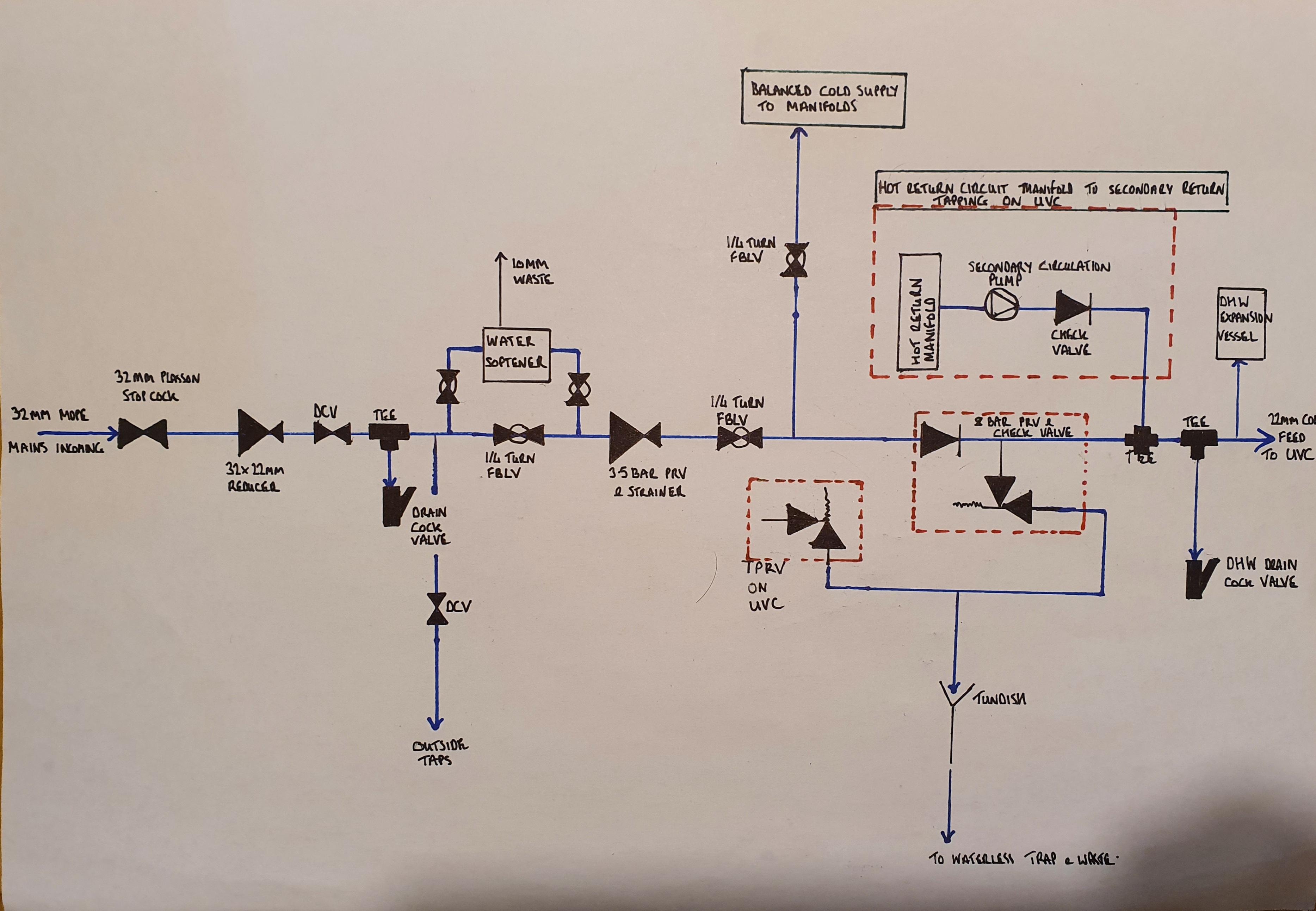

Latest iteration or the plumbing from mains incomer to UVC.
Small changes each time but trying to flesh it out so all parts are on it which can then lead to an easy to work out materials list.
Any feedback is appreciated.

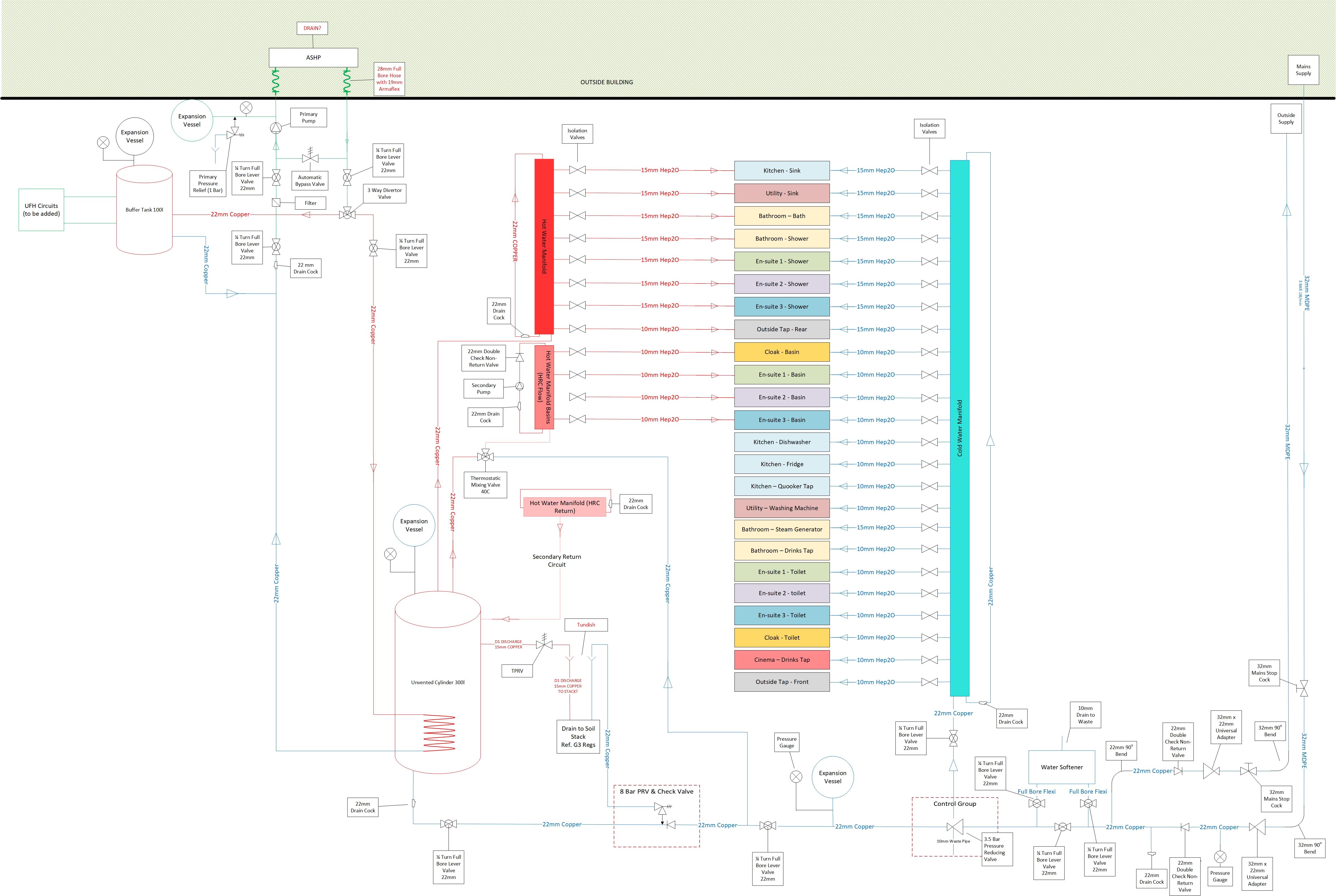

Thought it had been much longer but seems to only have been a couple of weeks since I was last chipping away at this. I have now got Visio and have cannibalised the drawing done by Andy (cheers?) on here and now have a plumbing schematic for critique:
@PeterW, @Nickfromwales if you chaps could spare a few minutes to take a look and shred my plan it would be much appreciated.
Ta all.

Does the ASHP have a pump built in?  I have my suplimentary pump on the flow from the ASHP not the return (anyone else care to comment on that)
I personally dislike 3 port valves.  I have a 2 port valve for DHW and another two one for upstairs and downstairs UFH.  I put the 2 port valves local to the UFH or DHW tank and put the automatic bypass at the DHW tank so it was as far away from the ASHP as possible.  Many ASHP's will turn on and circulate water on their own when "off" as an anti freeze measure so need somewhere to get warm water from.

What is your mains water pressure?
It looks like you have decided drinking water can be delivered via the softener?
Worth mentioning that clicking on the diagram pops open a higher resolution version with legible labels.
Only thing I woukd query is the need for a pump feeding the ASHP. What's the need for this? As it should have a pump in it? Also do you need that other expansion vessel above that pump? As no matter what you are connected to an expansion vessel at the buffer or UVC at all times.
Edit: I'm only comparing this with hydraulics systems I design. I'm not stating having a pump is an issue. Id just like to know what it's for (apart from the obvious).
Edited by SuperJohnG
@SuperJohnG & @ProDaveThe pump was directed by @PeterW on the first page - an earlier iteration of the design.  The expansion vessel was added based on the drawing I found in some Ecodan documentation, this also shows a pump on the return flow too?
Dave, your point ref three port valves I'll have to think about. I need to draw the setup you described first so I can weigh it up properly.
@epsilonGreedy Jonathon, mains pressure is just under 3bar. I do intend to use a water softener, not decided yet on whether to take a hard water supply for drinking water. Its something that has been discussed elsewhere here, some do, some don't. I think I'd have to try it to see how we get on with it maybe before making a decision.
