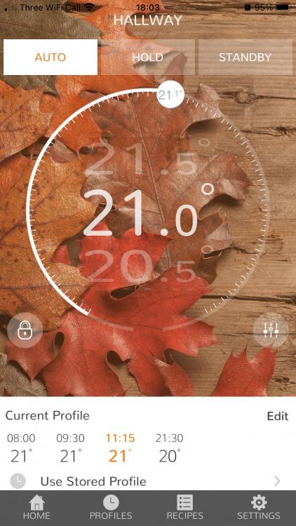

AdamSee Posted October 2, 2020 Share Posted October 2, 2020 17 hours ago, AshleyH said: The other zones still seem to be heating up quicker! This is un-related to your problem. But what brand of control system/application are you using? Link to comment Share on other sites More sharing options...
AshleyH Posted October 2, 2020 Author Share Posted October 2, 2020 1 minute ago, AdamSee said: This is un-related to your problem. But what brand of control system/application are you using? Heatmiser neo stat v2, UH8 system, individual room wired thermostat's. 1 Link to comment Share on other sites More sharing options...
