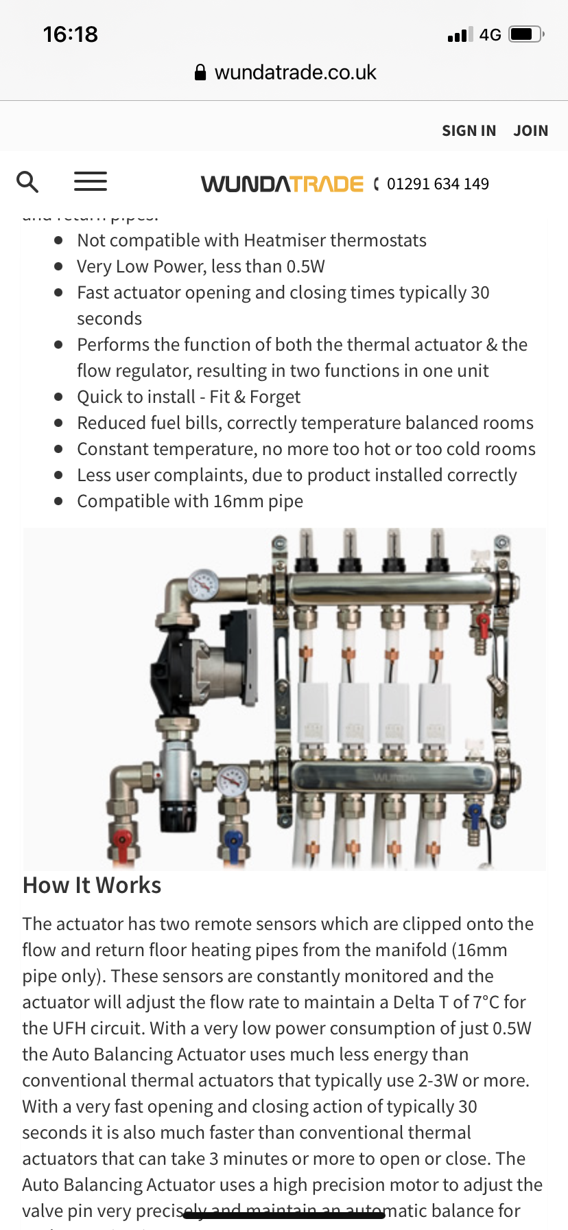

Auto-balancing in real time will be the best you can hope for. Salus heads are the only way you can achieve this real time response.

will the Salus auto balancing actuators work with the heatmiser ufh8?
It appears not. I may make a call to see why and if it can be done with a little ‘engineering’.

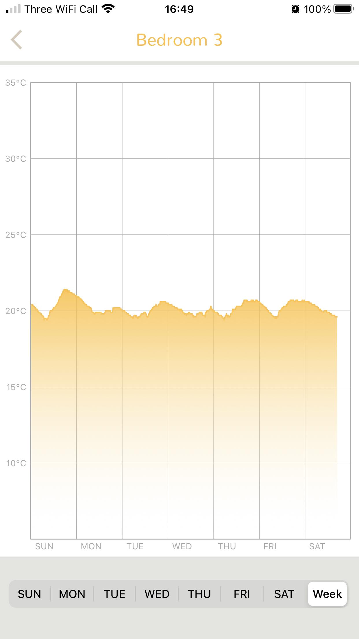

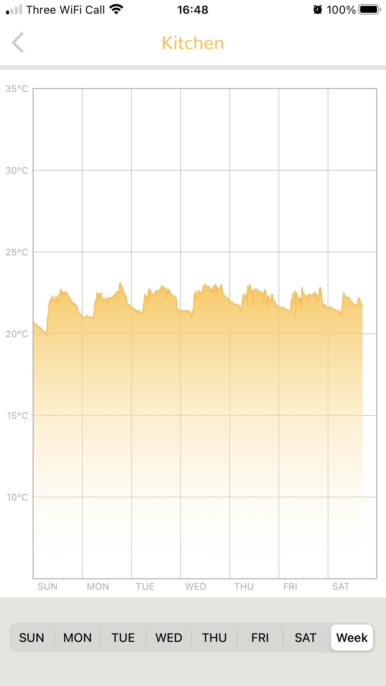

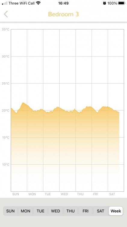

If I attach the kitchen in my house you see it cools down slowly, not as slow as some, it is a downstairs room with tiles and a screed over PIR floor. It heats up very quickly, you see a very sharp spike in the morning when the temperature increases.
If I attach bedroom 3 - It is upstairs, and above the garage, it also faces north and has a wooden floor, so it is by far the slowest room to heat up in the house.

thanks for the info, I’ve attached the trends over the last week, baring in mind there are some sharp spikes where I have been playing around with it!

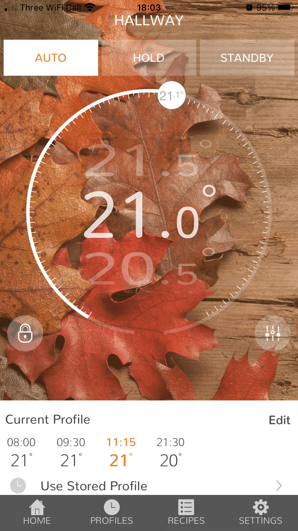

Also I’ve attached the profile I’m using, we aren’t in the house during the days only in the evenings so I’ve set it to heat up as below? Would this be more energy efficient?

If you tap on he three vertical lines in the right side of the screen as shown, it gives an option called optimum start. Using this, Heatmiser is supposed to calculate how long rooms take to heat up, so you set the temperature you want e.g. 22C at 6am and it calculates if it needs to switch on at 4.30 or 5 or 5.30 etc. I have mine set to a maximum of an hour as it heats pretty quickly.
It also gives you the option to change the temperature differential before the heating kicks in from 1C to 0.5C. I did this, as for example if the thermostat is set at 20C and the differential set at !c, the heating won't come on until 19C which is a little cold.
Do you want the rooms to be to temperature at 6am and 4pm, or did you set these times as before you end them to be at that temperate to give it time to heat up. If these are the times you want the temperature then it may simply be that you need to change the settings so it starts to heat up an our before you need it, it does not look to be heating up particularly slowly to me.
The other issue is setting the temperature back to 16C when you are not at home. I don't know what your local temperatures have been like, a couple of nights last week it got to 3-4C here, but it looks like you are sometimes losing temperature quite quickly at night, 3C over a couple of hours in the lounge. I suspect if it was really cold you would lose 4-5C. It will take a long time to heat back up from this kind of loss.
You probably need to look at the temperature during the night and when you are at work as being set at 20C so that if if gets really cold, the heating kicks in to stop the temperature falling even more, then it is less hard to get up to temperature at the required time.
Out of interest, have you felt it too cold or slow to heat up in the last week. The temperature has been normally between 20 and 22C which would seem reasonably comfortable. It looks like heating up last Sunday and Monday morning may have been an issue

28 minutes ago, AshleyH said:
That setback is far too low - up it to 17c.
I think the issue is that the room itself is losing heat - I’d check the insulation in the attic before doing much more.
I used to have mine set back 2-3C, but I changed some rooms to 1-2C just so if they did cool down they would warm up faster.
If you want it to be 22C I would recommend setting it back to 20C during the night and when you are at work.
The 0.5C differential helps as at 1C it has to be1C away from the set temperature for the UFH to switch on, so say you want it to be 22C. The UFH switches off at 22C, it starts to cool down to 21C then it comes on. It could get to below 21C before it starts to warm up again. Thus with 1C you can find it getting colder than you would like before the heating kicks back in.
I am a bit confused though as looking at the charts, it doesn't look as if it is taking too long to heat up and the temperatures look broadly ok. The only thing is it looks like set at 22C it is dropping to 21C which you maybe find a bit cold in the lounge before the heating comes on. The 0.5C differential might help.

Isit worth getting the self adjusting actuators would this save energy ontop of these settings?
I doubt would be worth the cost and effort. The biggest driver of the times and costs of heating is going to be the insulation of the room. You do have a faster heat loss than most people on the forum, but considering this is not a  new build, I don't think it is surprisingly fast.
