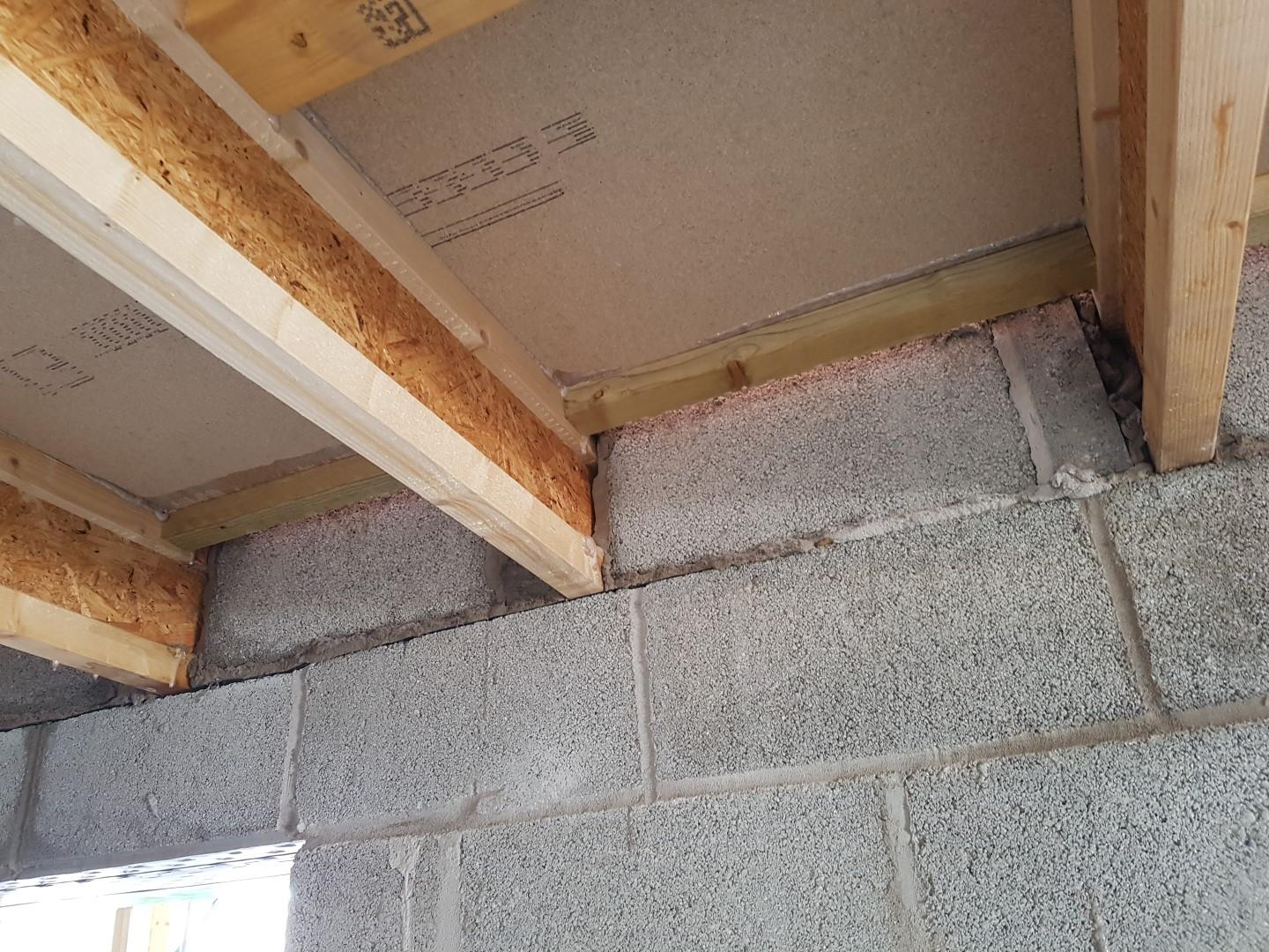

Moonshine Posted October 14, 2020 Author Share Posted October 14, 2020 On site today and saw these i-joists built into an external wall, a fair amount of gaps around them. Link to comment Share on other sites More sharing options...
joe90 Posted October 14, 2020 Share Posted October 14, 2020 (edited) Flexible mastic might be your friend here to help with air tightness. The timber will shrink a little so any gap filler must be able to flex with it. Are you going to parge the walls?, wet plaster? You need to get parging done on the blockwork between joists before the ceiling goes up . I did mine before the upper floor went down as well,. Edited October 14, 2020 by joe90 Link to comment Share on other sites More sharing options...
Moonshine Posted October 14, 2020 Author Share Posted October 14, 2020 @joe90 this isn't my build but I was on the site of a local medium volume builder 1 Link to comment Share on other sites More sharing options...
PeterW Posted October 14, 2020 Share Posted October 14, 2020 Looks about right for a spec builder - that one won’t be air tested ... Link to comment Share on other sites More sharing options...
Russell griffiths Posted October 14, 2020 Share Posted October 14, 2020 That’s a standard shit job, you should be aiming for 100% better than that. 1 1 Link to comment Share on other sites More sharing options...
