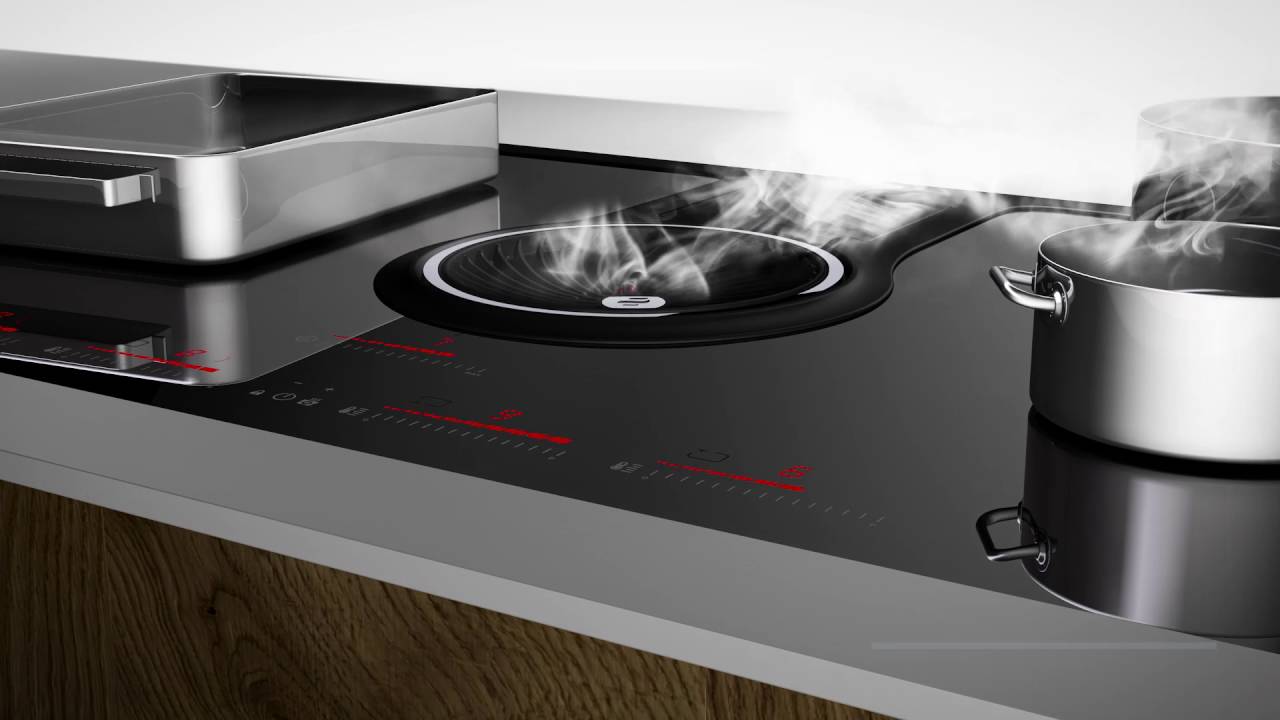

Guest Alphonsox Posted January 12, 2017 Posted January 12, 2017 We've been trying to decide on a recirculating extraction fan and induction hob for our new kitchen. I still like the idea of combining them into a single unit, On the other place we had discussed the Bora basic system but it's just too expensive (around 4500 Euro). Last night I came across a similar looking setup from Elica (http://elica.com/GB-en/nikolatesla), This is available from various places/countries, the cheapest I can find is £1500 from Italy Vs £2100 in the UK. Has anyone imported items like this from Italy - Any hints or thoughts as to whether this is a good idea ?

Guest Alphonsox Posted January 13, 2017 Posted January 13, 2017 1 hour ago, ryder72 said: Yes thats a huge price difference. I suspect that hob is actually made by EGO and badged Elica. Its a well made product but I didnt know Elica supplied hobs in the UK. Apparently the Hob uses EGO induction units and Eurokera glass, so a reasonable combination used by lots of manufacturers that should be reliable. There are a few kitchen outfits advertising this hob in the UK but I don't know whether they are sourcing through Elica UK or directly from the continent.
ryder72 Posted January 13, 2017 Posted January 13, 2017 2 hours ago, Onoff said: Elica cooker hoods at least seem very well respected: http://www.ukwhitegoods.co.uk/help/about-the-appliance-industry/manufacturer-information/2806-elica-cooker-hoods I wouldnt rate their hoods really. Quality is quite mediocre on their mainstream product but very good on their top end bought in products. I am pretty sure this is a bought in product from EGO. 4 minutes ago, Alphonsox said: Apparently the Hob uses EGO induction units and Eurokera glass, so a reasonable combination used by lots of manufacturers that should be reliable. There are a few kitchen outfits advertising this hob in the UK but I don't know whether they are sourcing through Elica UK or directly from the continent. Most good manufacturers use EGO induction loops and their products are well made. Its the occasion when it goes wrong that you need to be prepared for. We have rarely had problems with EGO made products, but the failure rate hasnt been zero or insignificant. I would buy their product as I know the core product is sound. With induction hobs, the bit that are most likely to cause problems are the control circuits, not the loops themselves.

Pocster Posted January 18, 2017 Posted January 18, 2017 Forgive me dumbness. This is an induction hob with a built in extractor??? How can the extractor work whilst not above the hob as in a traditional design?? If it works as suggested! - I want one!!
Guest Alphonsox Posted January 18, 2017 Posted January 18, 2017 The extractor is fitted under the counter top and sucks 600+ M3/hr of air downwards through the central duct, then cleans it with some filters and vents it at floor level (or optionally out through the wall). How well this works I am trying to find out. The other manufacturer of the same type of extractor (Bora) seems to be well regarded, although this particular unit seems to be too new for any reviews. I'm hoping that this hob along with the MVHR ceiling extracts will combine to give us air cleaning.

Simplysimon Posted January 18, 2017 Posted January 18, 2017 4 hours ago, Alphonsox said: The extractor is fitted under the counter top and sucks 600+ M3/hr of air downwards through the central duct, that's a lot of air being moved in a relatively small area, i wonder how loud it is? one thing that puts me off extract units, though with going mvhr i may need one to keep extract filter clean.
Guest Alphonsox Posted January 18, 2017 Posted January 18, 2017 20 minutes ago, Simplysimon said: that's a lot of air being moved in a relatively small area, i wonder how loud it is? one thing that puts me off extract units, though with going mvhr i may need one to keep extract filter clean. It's speced at 59 dB at full tilt, but its unclear how you measure the noise of a unit that may be under a bit of chipboard or a tonne of granite. I guess you measure from the extract duct. EDIT :- for the re-circulation unit i'm looking at the numbers are 480m3/hr at 62 db(A), the numbers above are for the external vent unit.
Stones Posted January 18, 2017 Posted January 18, 2017 When we were given a demonstration of the Bora extractor, it certainly seemed very effective. I do recall asking the chap in the showroom about recirculation option rather than vented direct outside and he advised against it, indicating performance of the extractor was compromised / not as good when recirculating. How much of a difference there would be performance wise, I'm not sure. I guess when recirculating, quality and performance of filters is important, and if additional filters (compared to venting outside) are required, there will be some impact on extraction rates.
