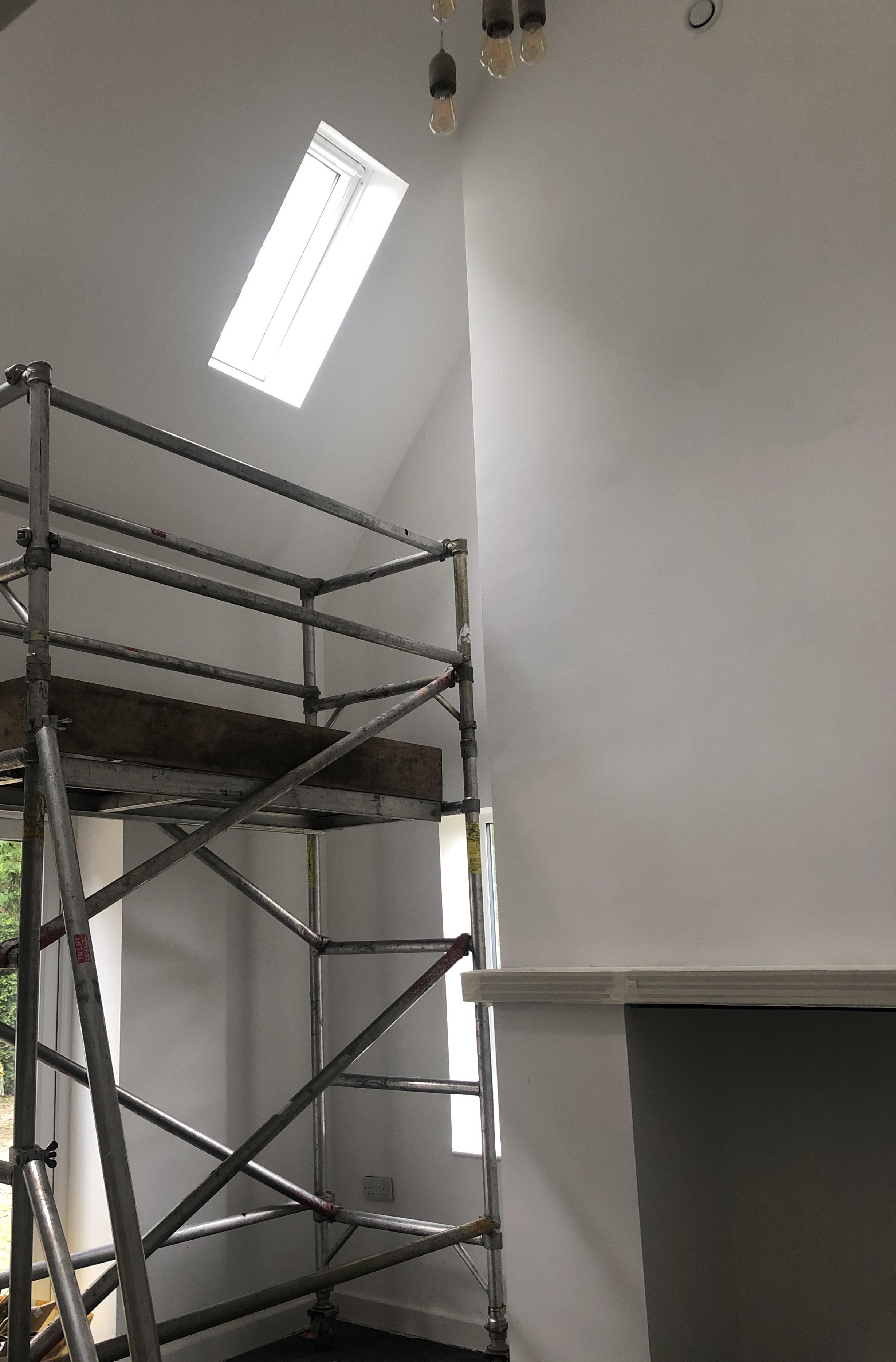

PeterW Posted September 18, 2020 Posted September 18, 2020 Can just see one here in the top right - 4.8m up mounted into the front of a false chimney breast. Just think before you finish though how you will adjust it to balance it ....
joe90 Posted September 18, 2020 Posted September 18, 2020 1 hour ago, PeterW said: how you will adjust it to balance it .. unless like some (and me) you balance at the manifold.

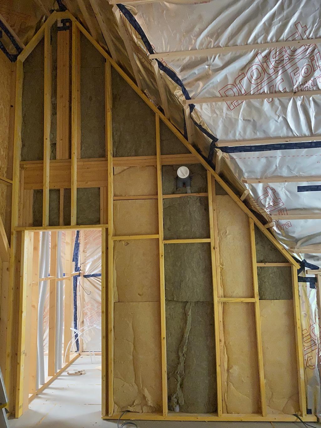

Andrew Posted September 18, 2020 Posted September 18, 2020 (edited) I went for high enough to be out of the way but low enough to reach from steps. Edited September 18, 2020 by Andrew Found a better piccy
