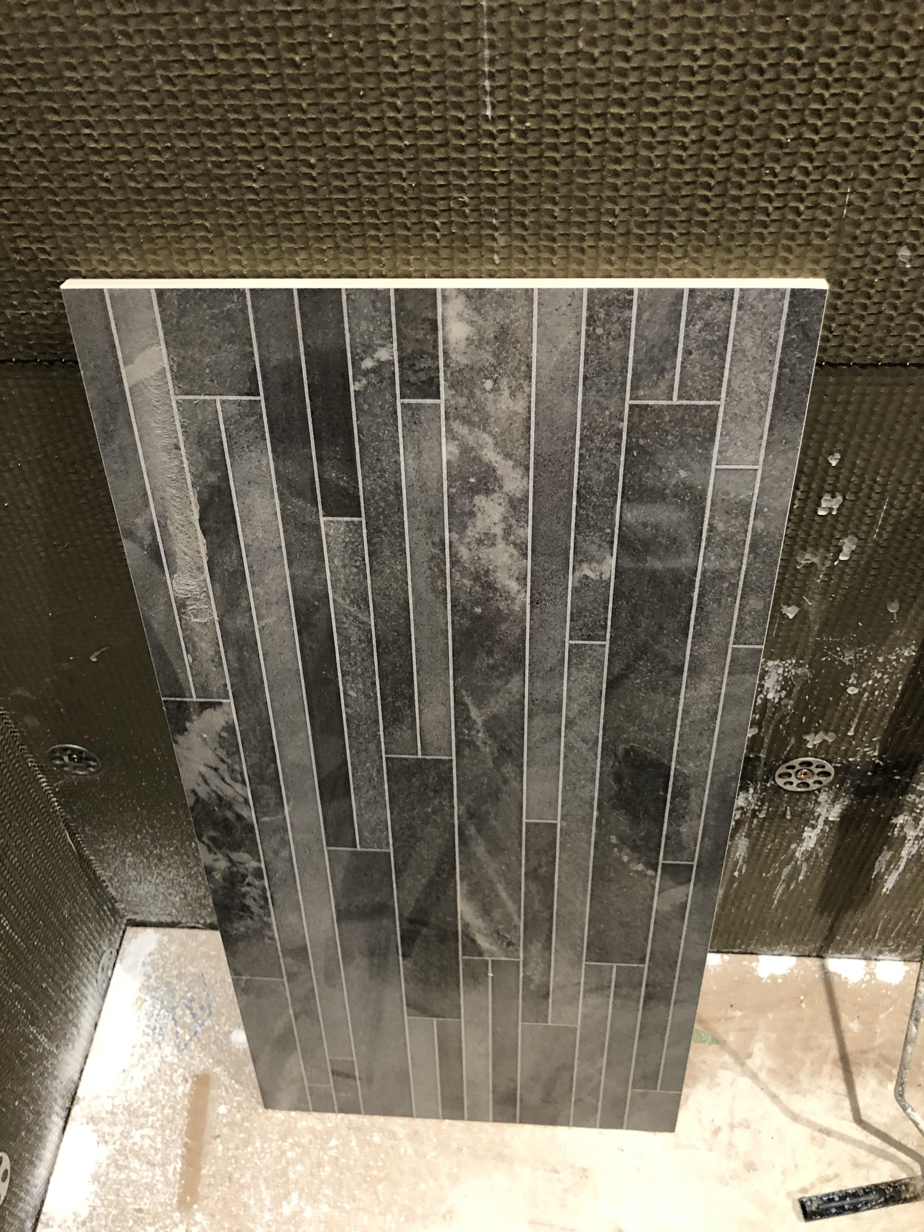

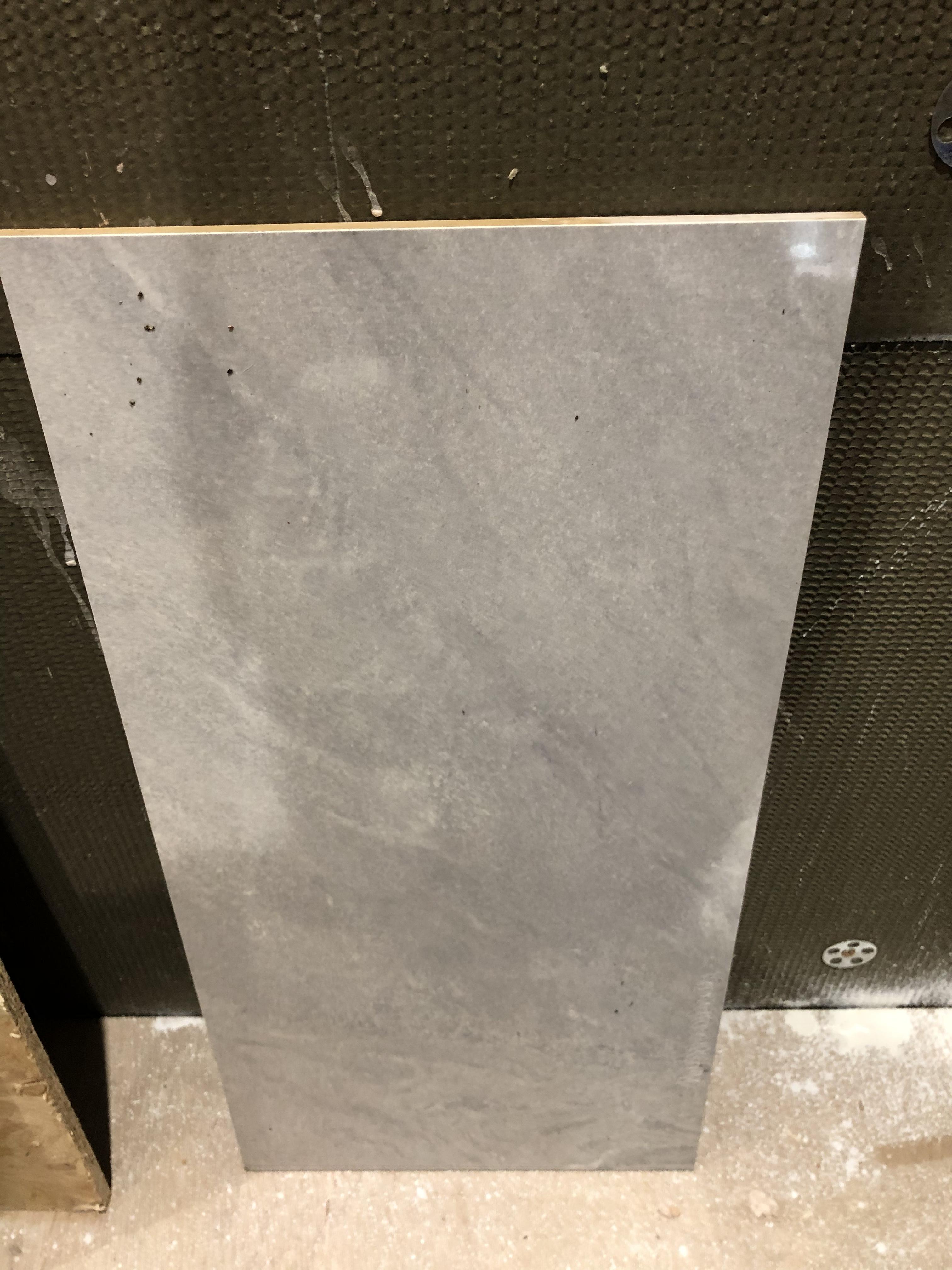

Pocster Posted September 4, 2020 Posted September 4, 2020 Ok - title slightly mis leading ! SWMBO inspected my ensuite effort so far , I was given the thumbs up ! ????? Unfortunately she is now delusional that my tiling skills are not finite ! And so forms her vision ..... The grey stripped mosaic tiles will run in a vertical strip floor to ceiling ( 2 strips in the bathroom somewhere ) . The pale tiles also run vertical but joints staggered ? So ! My assumption this is more tricky and therefore more prone to f up’s . For starters tiling ‘conventially’ i.e horizontally you start half a course up to allow for the bottom tiles to be cut to suit the floor level . No floor tiles are going down until walls done as that feels like a big job full of fun in itself . Therefore how do I start my strips ? I should of done a sh*t tiling job in the ensuite then SWMBO would of expected less ? 1
ProDave Posted September 4, 2020 Posted September 4, 2020 I always tile floor first, so wall tile comes down onto floor tile. Less chance of a leak and looks correct. But then i always tile up from the floor, cutting the bottom edge if needed to get the top of the first row level. But I don't tile much. Multipanel is SO much easier for walls. So you start your strip in this case just as any other row, a little but up from the floor? 1 1 1
nod Posted September 4, 2020 Posted September 4, 2020 44 minutes ago, pocster said: Ok - title slightly mis leading ! SWMBO inspected my ensuite effort so far , I was given the thumbs up ! ????? Unfortunately she is now delusional that my tiling skills are not finite ! And so forms her vision ..... The grey stripped mosaic tiles will run in a vertical strip floor to ceiling ( 2 strips in the bathroom somewhere ) . The pale tiles also run vertical but joints staggered ? So ! My assumption this is more tricky and therefore more prone to f up’s . For starters tiling ‘conventially’ i.e horizontally you start half a course up to allow for the bottom tiles to be cut to suit the floor level . No floor tiles are going down until walls done as that feels like a big job full of fun in itself . Therefore how do I start my strips ? I should of done a sh*t tiling job in the ensuite then SWMBO would of expected less ? You can go either way Plenty do Walls first You don’t want to damage or stain those nearly laid floor tiles 1
ProDave Posted September 4, 2020 Posted September 4, 2020 So a compromise in this case: Tile the floor before you fill in the missing bottom half row of tiles? 1
Pocster Posted September 4, 2020 Author Posted September 4, 2020 15 minutes ago, ProDave said: So a compromise in this case: Tile the floor before you fill in the missing bottom half row of tiles? No doing the floor ! That’s a whole new set of issues ! 1 problem at a time .

bassanclan Posted September 4, 2020 Posted September 4, 2020 I always start marking out from the windowsill height. If you have any sense any boxing in etc is set at the same height as you windowsill and follows round, so a whole tile(s) goes below the windowsill, then a cut to the floor. With staggered vertical joints there would be a half tile. Spend a bit of time laying it right out now and it will save you a lot of messing about later 1

Onoff Posted September 5, 2020 Posted September 5, 2020 9 hours ago, bassanclan said: I always start marking out from the windowsill height. If you have any sense any boxing in etc is set at the same height as you windowsill and follows round, so a whole tile(s) goes below the windowsill, then a cut to the floor. With staggered vertical joints there would be a half tile. Spend a bit of time laying it right out now and it will save you a lot of messing about later Excellent points. I wish I had hindsight, I might then have started at the window like you say, dropped the pockets in line and the long dwarf wall/shelf to the right. Luckily all my tiles are stuck on with Blu Tack so I'll change it over the weekend... ? 1
Pocster Posted September 5, 2020 Author Posted September 5, 2020 11 hours ago, bassanclan said: I always start marking out from the windowsill height. If you have any sense any boxing in etc is set at the same height as you windowsill and follows round, so a whole tile(s) goes below the windowsill, then a cut to the floor. With staggered vertical joints there would be a half tile. Spend a bit of time laying it right out now and it will save you a lot of messing about later No boxing in just 1 small window . Will use that as a guide for at least what height tiles start at ?
Pocster Posted September 5, 2020 Author Posted September 5, 2020 (edited) 12 hours ago, Ferdinand said: Is the principle not that you ignore everything we say and do it your own way that we all tell you that it will be a disaster, and it takes 3 times as long? As evidenced by the sprayed ceiling? That way fups are reduced by 67% per unit time because you have only done the other 33% of the project? Ferdinand PS No abusive, prejudiced, anti-@pocster assumptions or unwarranted and unjustified floccinaucinihilipilifications have been made in this post. PPS /lie PPPS Have a Fogcutter and you will not remember any of it anyway. PPPPS Before you do, where does one find that sort of delusional optimistic SWMBO? I just got clearance from the medics for a sort-of social life. Well ! I have no opinion whether floors or walls get done first . But I don’t want to do the floor first . Lots of reasons . I haven’t done all the drainage in the bathroom yet . Don’t have a bath so not sure where waste is going . Don’t want to risk dropping tools on tile floor . Worried bathroom floor tiles won’t be flush with hallway tiles ( planned to do them first ) . Bathroom tiles are different to hallway ones - I want the tile change to be under the bathroom door when closed ( so you don’t see the wrong tile from either side ) . Hot water and a sink on site would be nice , floor doesn’t help me there . Don’t want floor down as bound to get filthy . Regarding my spray painting . The result is fine . But can’t do whole house as it’s not finished ! . Too much gear / materials in the way . Trying to break it up into smaller manageable jobs . Using up materials and making space ! Edited September 5, 2020 by pocster 1
Onoff Posted September 5, 2020 Posted September 5, 2020 I was happy I tiled the floor first tbh. Meant I got a near perfect 1mm gap between the bottom wall tile and floor. I did though have to tape Correx sheets down on the finished floor and leave a nominal gap all round to do the wall tiling. Left me a bit to clean up around the edge.
Pocster Posted September 5, 2020 Author Posted September 5, 2020 14 hours ago, Ferdinand said: Is the principle not that you ignore everything we say and do it your own way that we all tell you that it will be a disaster, and it takes 3 times as long? As evidenced by the sprayed ceiling? That way fups are reduced by 67% per unit time because you have only done the other 33% of the project? Ferdinand PS No abusive, prejudiced, anti-@pocster assumptions or unwarranted and unjustified floccinaucinihilipilifications have been made in this post. PPS /lie PPPS Have a Fogcutter and you will not remember any of it anyway. PPPPS Before you do, where does one find that sort of delusional optimistic SWMBO? I just got clearance from the medics for a sort-of social life. Apologies my response a little blunt ; @Ferdinand The plan now is Baton as usual around the floor . Vertical tiles off of that . Once floor tiles down , make upstands from floor tiles to go at the base of the walls . Thereby this allows all criteria to be met ! ?

bassanclan Posted September 5, 2020 Posted September 5, 2020 Before you use the window as your starting point you really should take some measurements around the room and see if t will work. Also are you going to fully tile all walls or have some half height? I always do some half height and then full walls around baths/showers as it can be a bit oppressive as fully tiled (and it saves tiles), but that's personal preference.
Pocster Posted September 5, 2020 Author Posted September 5, 2020 3 hours ago, bassanclan said: Before you use the window as your starting point you really should take some measurements around the room and see if t will work. Also are you going to fully tile all walls or have some half height? I always do some half height and then full walls around baths/showers as it can be a bit oppressive as fully tiled (and it saves tiles), but that's personal preference. I like oppressive . Like a deep dark dungeon where no one can escape . Floor to ceiling almost all of it , ceiling slopes towards window so obviously that will be lower . I want the bathroom to install fear and trepidation into its victims . Also with especially those mosaic type tiles much easier to hide a camera .....
