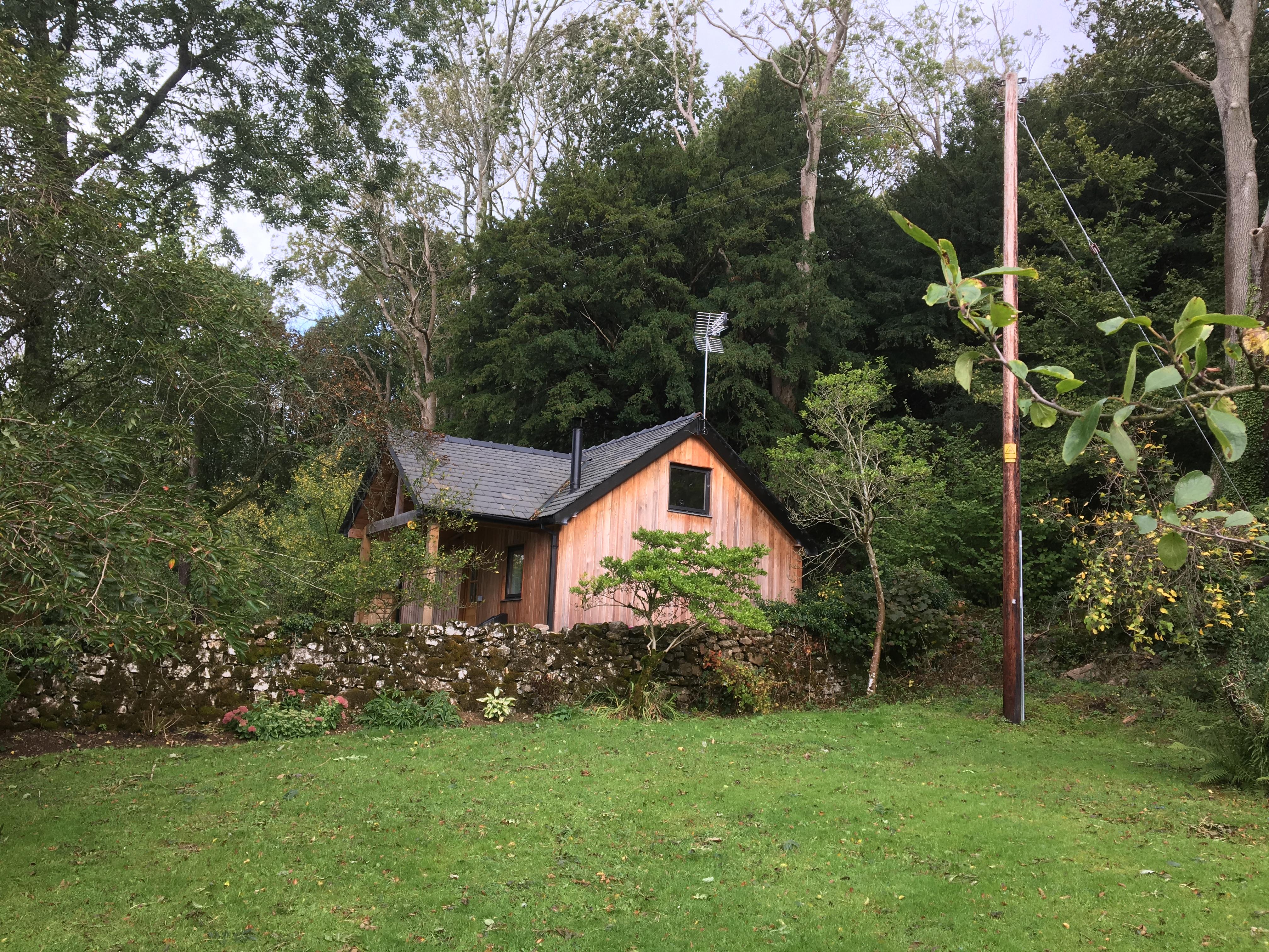

Triassic Posted August 28, 2020 Share Posted August 28, 2020 I built a one bedroomed timber framed, latch clad tiny house for £30,000. 5 Link to comment Share on other sites More sharing options...
