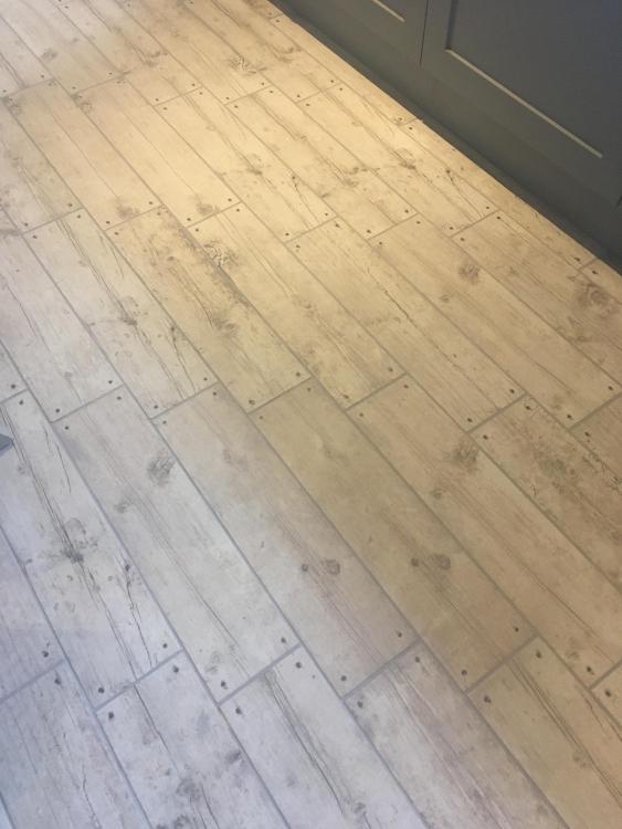

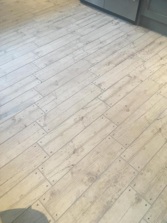

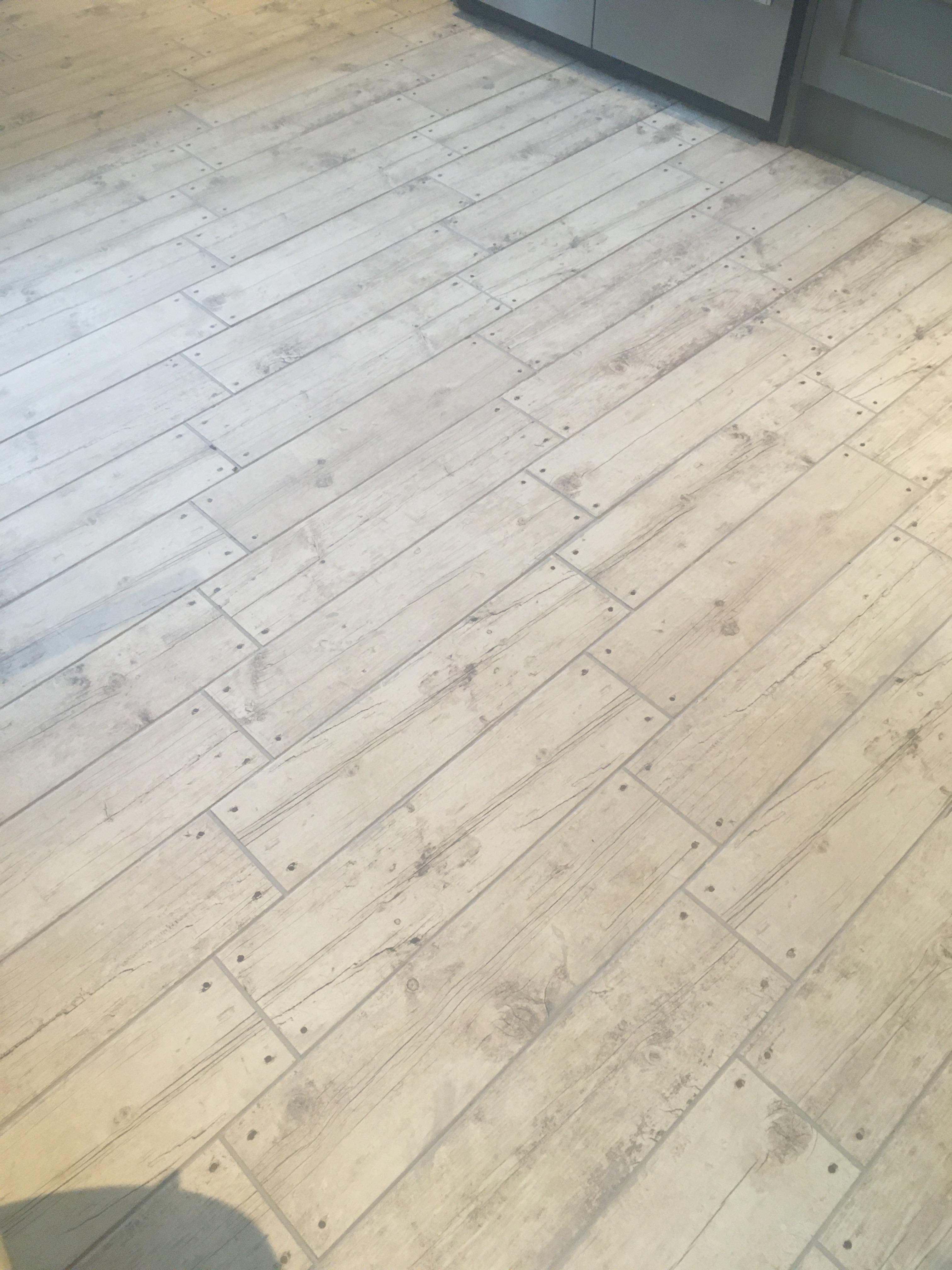

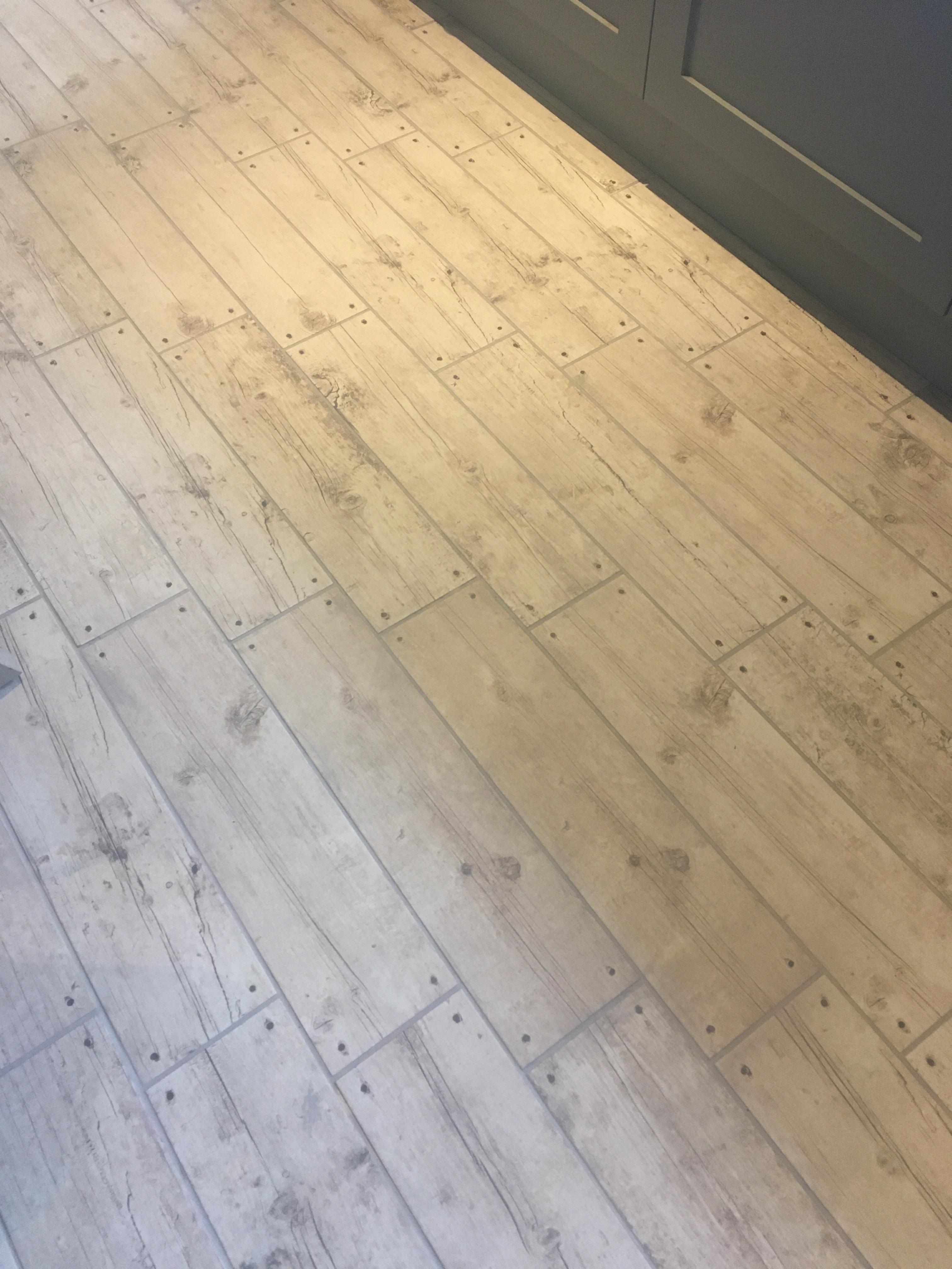

recoveringbuilder Posted August 29, 2020 Posted August 29, 2020 24 minutes ago, ProDave said: We considered "wooden tiles" for our kitchen. It was the tiler that put me off. He was telling me most of them come bent, they are very hard to lay without a step between tiles because of that, so best way to lay them is with only a slight bond. They are all uniform length so the joints will all all line up, unlike real wood supplied in random lengths with random joints. The tiler did a good job of putting us off them. Depends on your tiler, we have them in the kitchen and the tiler made a really good job of staggering them, most visitors think they are wood

Thorfun Posted August 29, 2020 Posted August 29, 2020 7 hours ago, Christine Walker said: Depends on your tiler, we have them in the kitchen and the tiler made a really good job of staggering them, most visitors think they are wood thanks for this comment @Christine Walker. it's nice to get a positive opinion on them. don't suppose you'd be able to post of photo of them would you please?
scottishjohn Posted August 29, 2020 Posted August 29, 2020 8 hours ago, ProDave said: He was telling me most of them come bent, then you know what to look for when you go shopping --take a straight edge with you to check my guess is it will depend on how much you pay for them and are they porcelain or just ceramic tiles
ProDave Posted August 29, 2020 Posted August 29, 2020 6 minutes ago, scottishjohn said: then you know what to look for when you go shopping --take a straight edge with you to check my guess is it will depend on how much you pay for them and are they porcelain or just ceramic tiles So the one in the showroom is flat. What happens when the ones you order arrive bent?
recoveringbuilder Posted August 29, 2020 Posted August 29, 2020 1 hour ago, Thorfun said: thanks for this comment @Christine Walker. it's nice to get a positive opinion on them. don't suppose you'd be able to post of photo of them would you please? No problems with them, all flat and appear to be hard wearing as they have 4 dogs regularly tramping over them! 2
ProDave Posted August 29, 2020 Posted August 29, 2020 That kind of proves what my tiler said. Yours are laid with a short bond so any bend in the tiles would not show up as they would all pretty much bend the same, and they are all uniform length.
Thorfun Posted August 29, 2020 Posted August 29, 2020 1 hour ago, Christine Walker said: No problems with them, all flat and appear to be hard wearing as they have 4 dogs regularly tramping over them! thank you for the photo. they look really good. nice to see that it's not a uniform print on each tile.
