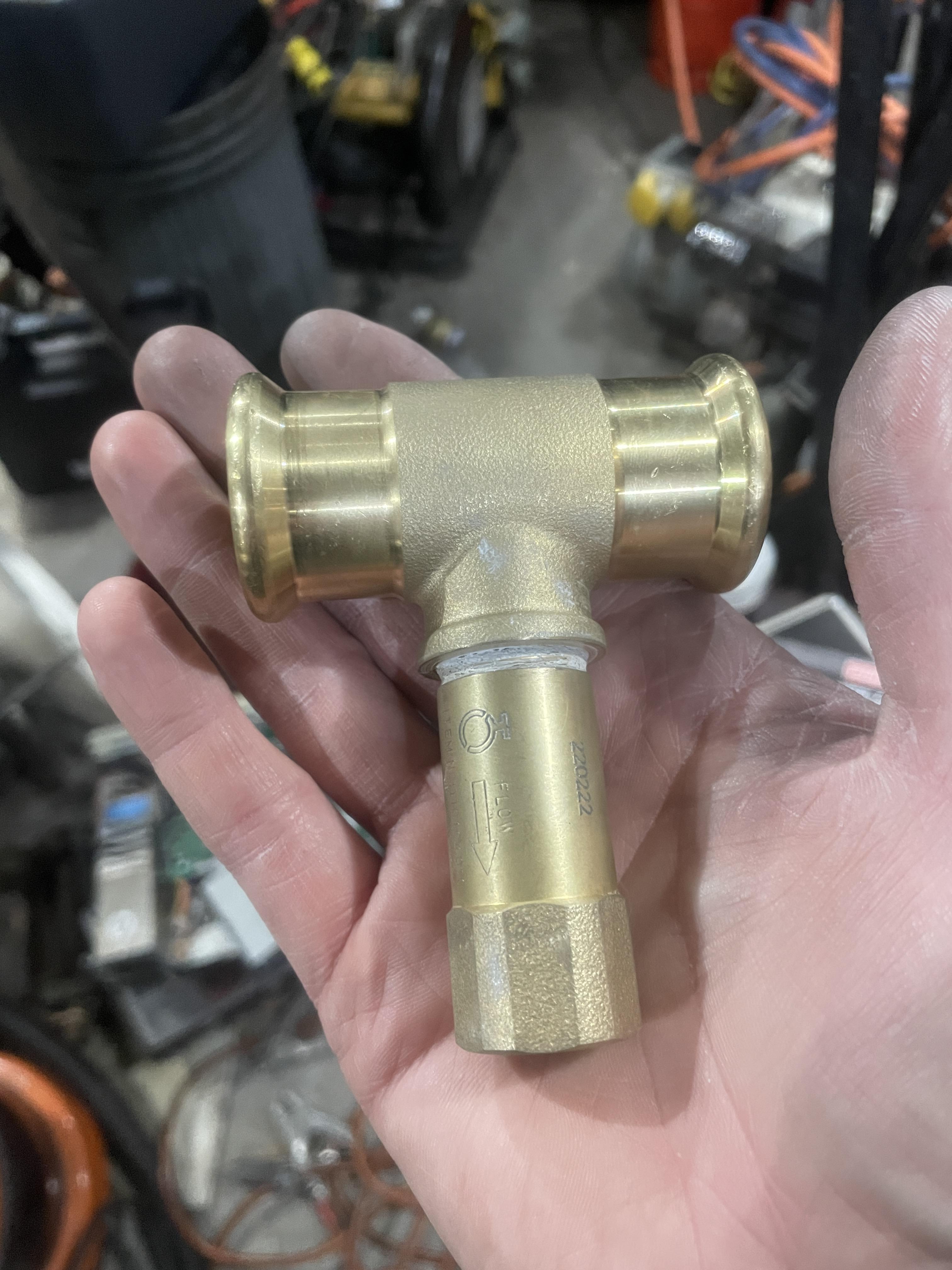

JohnMo Posted December 5, 2022 Posted December 5, 2022 On 05/12/2022 at 22:37, ruggers said: Thanks John, What have you got installed in Scotland. We have freeze issues outside up North. If you just used the anto freeze valves, would you not just lose all of the system water every time it's below 3°C outside, is it not like a combi where below a certain pressure the system stops working until you fill it back up? Expand I'm still on gas but been doing lots of reading, I need a cooling solution as much as anything else. Heat pumps generally run a pressurised system same as combi, so if the freeze valves open the system would loose pressure. If the system is operation ie you have power, the pump would circulate to protect the system. Only in a prolonged power cut would the water drop below 3 deg and the valve open. 1
Dan F Posted December 5, 2022 Posted December 5, 2022 On 05/12/2022 at 22:30, ruggers said: What brand is the 25L buffer? Expand https://www.seconrenewables.com/volano-wall-mounted-buffer-7698-p.asp On 05/12/2022 at 22:30, ruggers said: I've no idea why they wanted to use glycol then, especially as a registered installer. You'd expect a random plumber to maybe do things that way. Expand Not all installer have moved on to use anti-freeze vales. 1
Dan F Posted December 5, 2022 Posted December 5, 2022 https://www.caleffi.com/international/en-int/catalogue/antifreeze-valve-brass-body-108601 1
ruggers Posted December 5, 2022 Posted December 5, 2022 On 05/12/2022 at 22:41, Dan F said: https://www.seconrenewables.com/volano-wall-mounted-buffer-7698-p.asp Not all installer have moved on to use anti-freeze vales. Expand Seems so. Maybe concerned where we live is too cold or just not heard of them. On 05/12/2022 at 22:41, JohnMo said: I'm still on gas but been doing lots of reading, I need a cooling solution as much as anything else. Heat pumps generally run a pressurised system same as combi, so if the freeze valves open the system would loose pressure. If the system is operation ie you have power, the pump would circulate to protect the system. Only in a prolonged power cut would the water drop below 3 deg and the valve open. Expand I was about to say, It's nearly always 3 degrees or less in a Scottish winter so it would be leaking out constantly. So it's just if the pump has no power to it. If it's not running because theres no heat demand but it then drops down to a low temperature, it would fire the pump up instead of dumping the pressure.
HughF Posted December 6, 2022 Posted December 6, 2022 (edited) On 05/12/2022 at 23:24, ruggers said: Seems so. Maybe concerned where we live is too cold or just not heard of them. I was about to say, It's nearly always 3 degrees or less in a Scottish winter so it would be leaking out constantly. So it's just if the pump has no power to it. If it's not running because theres no heat demand but it then drops down to a low temperature, it would fire the pump up instead of dumping the pressure. Expand Exactly…. The anti freeze valves are for the rare case where there’s no residual heat in the system, there is a power cut, and it’s freezing outside. Only then will they open and release the water to prevent freezing. They are the way forward, and you only need one of them, not two as specified by most installers. And you can get them as 1/2 mount direct from china for £16. I stuffed mine into a 28mm press T Edited December 6, 2022 by HughF 1
JamesPa Posted December 6, 2022 Posted December 6, 2022 On 06/12/2022 at 07:10, HughF said: Exactly…. The anti freeze valves are for the rare case where there’s no residual heat in the system, there is a power cut, and it’s freezing outside. Only then will they open and release the water to prevent freezing. They are the way forward, and you only need one of them, not two as specified by most installers. And you can get them as 1/2 mount direct from china for £16. I stuffed mine into a 28mm press T Expand HughF you have obviously been doing good work thinking about eliminating unnecessary components - "1 valve not 2". My current design also calls for 2 normally closed (ie closed when unpowered) solenoid valves indoors as part of the antifreeze protection, so that only the external bits, not the whole system, is drained. Have you a design which eliminates one or either of these - they seem like a sledgehammer to crack a nut.
HughF Posted December 6, 2022 Posted December 6, 2022 (edited) On 06/12/2022 at 12:35, JamesPa said: HughF you have obviously been doing good work thinking about eliminating unnecessary components - "1 valve not 2". My current design also calls for 2 normally closed (ie closed when unpowered) solenoid valves indoors as part of the antifreeze protection, so that only the external bits, not the whole system, is drained. Have you a design which eliminates one or either of these - they seem like a sledgehammer to crack a nut. Expand I just copied what I saw on Instagram, seemed to make perfect sense to me to just have one valve at the lowest point in the system. The easiest way to eliminate your valves is to remove them and replace them with bits of pipe To be honest, down south, how rare are these edge case conditions that we fit these protection systems for? I can't remember the last time we had a power cut. Edited December 6, 2022 by HughF

ProDave Posted December 6, 2022 Posted December 6, 2022 Are you serious about valves to dump the water out of your system of it freezes? I just mixed an inhibitor / antifreeze with the water in mine at a level that should prevent it from freezing to -10. Job done.
jack Posted December 6, 2022 Posted December 6, 2022 On 06/12/2022 at 12:46, HughF said: I can't remember the last time we had a power cut. Expand I'm in the southeast and we get the occasional one - maybe once every year or two for 1-4 hours.
HughF Posted December 6, 2022 Posted December 6, 2022 On 06/12/2022 at 13:55, ProDave said: Are you serious about valves to dump the water out of your system of it freezes? I just mixed an inhibitor / antifreeze with the water in mine at a level that should prevent it from freezing to -10. Job done. Expand At Caleffi prices, I wasn't going to bother, but for £16 from AliExpress I thought I'd fit one.
