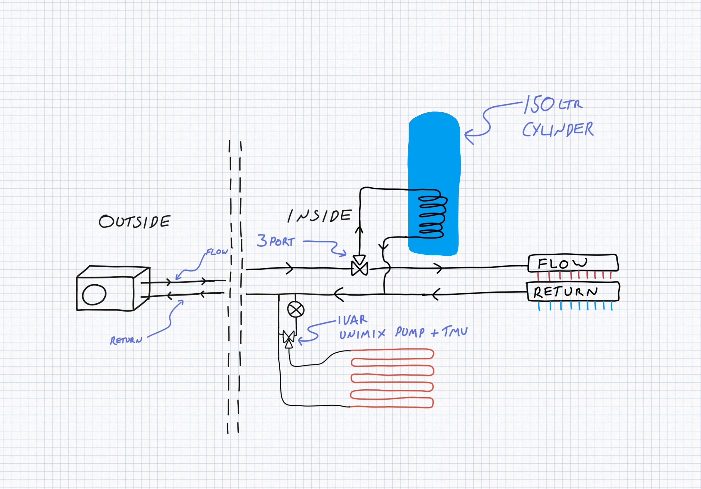

HughF Posted November 29, 2022 Share Posted November 29, 2022 (edited) Use the pump in the ashp to drive the rad circuit, use close coupled Ts on the return to hydraulically separate the ufh mixer/pump station. Use an ivar unimix3 pump station (eBay seems to have some on occasion) or if you want to go fancy, an esbe valve and a separate weather comp valve controller. I probably sound like a stuck record by now, but have you considered Cool Energy? Their 9kW offering is very capable, sensibly priced, and they sell direct. The system is built on a Carel industrial refrigeration control platform and is very capable. And their installation instructions have plumbing diagrams for a variety of standard configurations. @dpmiller has had his machine running for a while now and seems pleased with the performance of the package. He self installed. Edited November 29, 2022 by HughF Link to comment Share on other sites More sharing options...

ReedRichards Posted November 29, 2022 Share Posted November 29, 2022 11 hours ago, HughF said: Does this work? It looks to me as if when neither the cylinder or radiators are calling for heat then there is no supply of heated water to keep the UFH up to temperature. Perhaps there is an invisible buffer in there somewhere or I am misinterpreting the drawing? Link to comment Share on other sites More sharing options...
HughF Posted November 29, 2022 Share Posted November 29, 2022 (edited) 1 hour ago, ReedRichards said: Does this work? It looks to me as if when neither the cylinder or radiators are calling for heat then there is no supply of heated water to keep the UFH up to temperature. Perhaps there is an invisible buffer in there somewhere or I am misinterpreting the drawing? No thermostat, heating is just on or off from the Cool Energy controller. If it’s set to dhw the tank is charged till it is satisfied, if it’s set to heating the weather compensated liquid flows through the rad and ufh circuit. Rad and ufh always together (ufh is one loop in the extension we’re building)… About as simple as I could make it. Will see how well it works when I get round to plumbing it up. Can’t see why it won’t though. EDIT: I'm rambling, sorry. The UFH and the rads work together, they are not zoned separately. Edited November 29, 2022 by HughF Clarifying what I mean 1 Link to comment Share on other sites More sharing options...
ReedRichards Posted November 29, 2022 Share Posted November 29, 2022 1 hour ago, HughF said: No thermostat, heating is just on or off from the Cool Energy controller. If it’s set to dhw the tank is charged till it is satisfied, if it’s set to heating the weather compensated liquid flows through the rad and ufh circuit. Rad and ufh always together (ufh is one loop in the extension we’re building)… About as simple as I could make it. Will see how well it works when I get round to plumbing it up. Can’t see why it won’t though. EDIT: I'm rambling, sorry. The UFH and the rads work together, they are not zoned separately. Well it's nice and simple but can you do a night time setback? I don't want my house to be at one constant temperature for 24 hours; perhaps you do? Then if you did have a setback then the rads would recover faster than the UFH so that might be awkward. Link to comment Share on other sites More sharing options...
HughF Posted November 29, 2022 Share Posted November 29, 2022 26 minutes ago, ReedRichards said: Well it's nice and simple but can you do a night time setback? I don't want my house to be at one constant temperature for 24 hours; perhaps you do? Then if you did have a setback then the rads would recover faster than the UFH so that might be awkward. Yep, I can program a change to the WC for a nighttime setback. The UFH will be slow to respond because it will be in 100mm of concrete, so the pump timing for that will need some figuring out. Link to comment Share on other sites More sharing options...
ruggers Posted November 29, 2022 Share Posted November 29, 2022 14 hours ago, HughF said: What are you running in the outside lines from the compressor to indoors? Whats separating this, theres usually a wall unit isn't there with the heat exchanger in? I've seen the Meiflow jackets housing esbe mixing valves with control units for controlling the heating curves, and grundfos or wilo pump inside. Is that set up for priority hot water with the 3 port valve? The Unistor cylinders have a 15 minute reheat time or 11 mins to 70% for a 250L Link to comment Share on other sites More sharing options...

HughF Posted November 30, 2022 Share Posted November 30, 2022 7 hours ago, ruggers said: What are you running in the outside lines from the compressor to indoors? Whats separating this, theres usually a wall unit isn't there with the heat exchanger in? I've seen the Meiflow jackets housing esbe mixing valves with control units for controlling the heating curves, and grundfos or wilo pump inside. Is that set up for priority hot water with the 3 port valve? The Unistor cylinders have a 15 minute reheat time or 11 mins to 70% for a 250L Monobloc heat pumps have everything inside, you get hot water out of them. No need for an indoor heat exchanger. those pipes are the flow and return and carry the central heating circuit water. Link to comment Share on other sites More sharing options...
