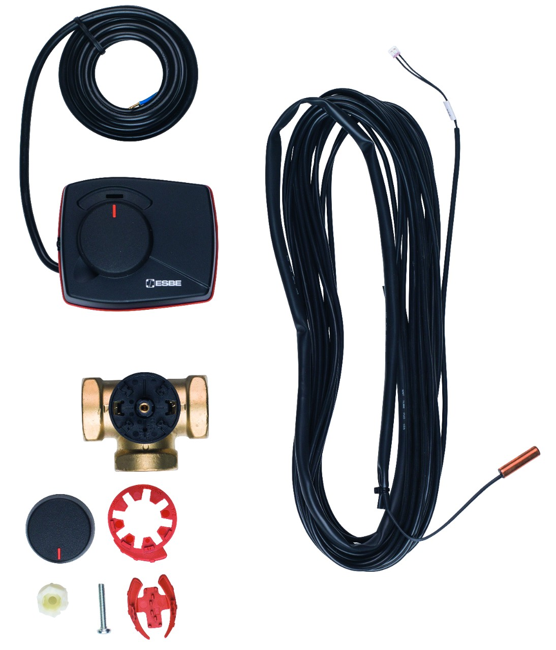

Roz Posted August 18, 2020 Author Posted August 18, 2020 (edited) Also @ProDave and anyone else that know the answer I guess. I got a Telford tank on recommendation from this forum actually, but I might be starting to regret it. Apparently the merchant or Daikin have told our plumber that we need a 'third party kit' because of the cylinder not being Daikin. It's probably a bit premature to ask this question because I am waiting to find out what this kit involves, but at the cost of £200 or £250 it's making it seem like I should have got the Daikin water tank, which seemingly would have ended up a similar price according to this list I have from the merchant. Has anyone else experience with a 'third party kit' and what it involves? EDIT: Google gives me this picture, still don't really know what it is Edited August 18, 2020 by Roz
ProDave Posted August 18, 2020 Posted August 18, 2020 My LG heat pump had an "optional kit" for a "sanitary water tank" (not my description) It was included FOC with my heat pump. It consisted of the temperature probe on a long (but not long enough) length of flex, and a box containing a contactor and a MCB. That box is wired to control the immersion heater in the tank, so if you want to, you can program the ASHP to do a legionairs cycle toheat the tank water to 65 degrees once a week. I have that disabled. So I could have installed the tank with just the temperature probe, which is a plain old thermistor.
ProDave Posted August 18, 2020 Posted August 18, 2020 13 minutes ago, Roz said: Thanks! Do the tanks 'top up' the temperature though, so you have the feed from the ASHP but you can store it at a higher temperature? Then mix this hot with cold to get a usable temperature. I am not sure if that's an efficient thing to do but I had thought that would get us around the small tank we have No I just have the one tank, heated by the ASHP to 48 degrees. For much of the summer, surplus solar PV lifts the temperature a lot higher than that.
