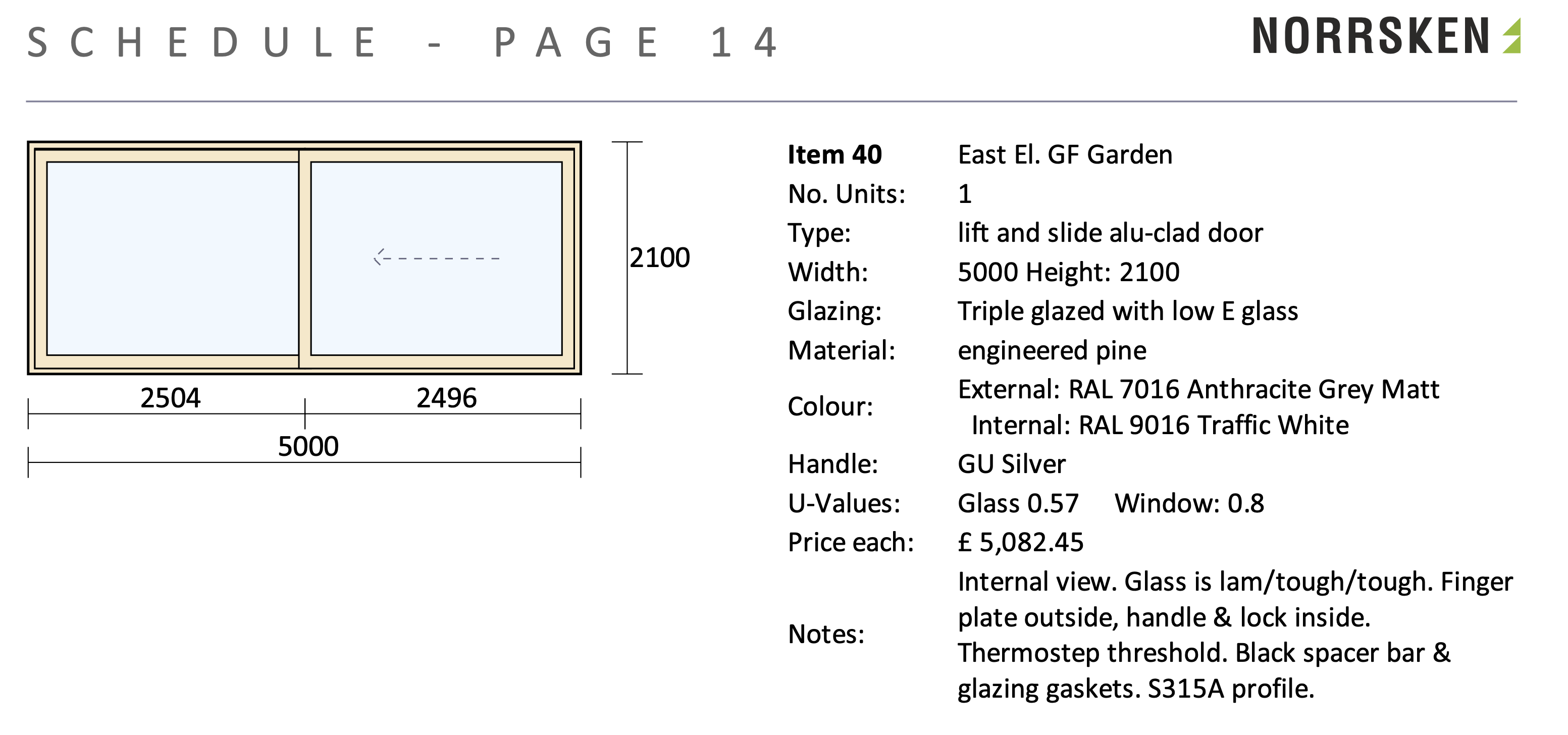

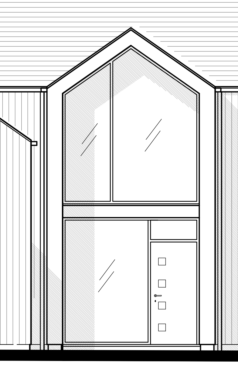

Thorfun Posted August 18, 2020 Posted August 18, 2020 and as another comparison, here's our largest slider quote from Norrsken. and I agree with @ToughButterCup in that comparing quotes was hard. I found that Norrsken were very upfront and contained a lot of detail in their quotes and included everything I could possibly need in the quote. so there were no hidden extras. although they don't do UPVC so will probably not be what you're after. but they were able to do the following window with no size issues. (3.3m high at the apex) (all posted with the caveat that I haven't started building yet so my opinion could all change once we get to the delivery and installation stage)

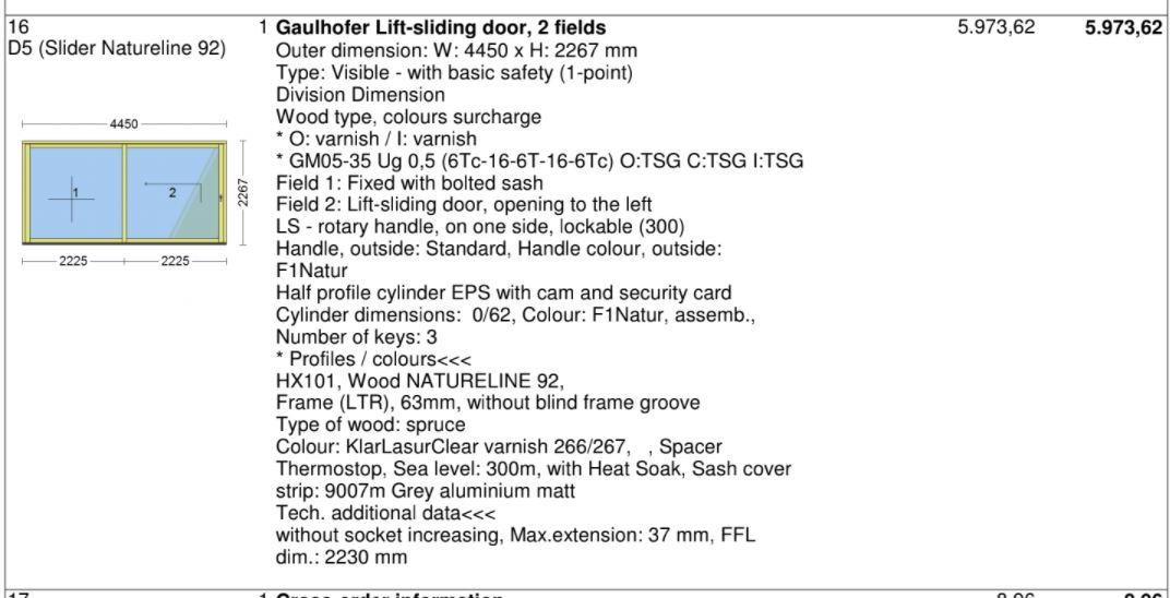

SuperJohnG Posted August 18, 2020 Posted August 18, 2020 It funny the different sizes different suppliers cam cope with. I have a 4.6m opening and decided I want a two section slider (one pane fixed) Express were able to do it,.but rational can only get up to 4m wide which is a pain as they are a decent price but I feel like 600mm is a lot to lose. Waiting on Nordan coming back and sent something to Gaulhoffer but not heard back @craig who is the Scottish dealer? Is that you guys? Id never heard of norssken until now, thanks @Thorfun
