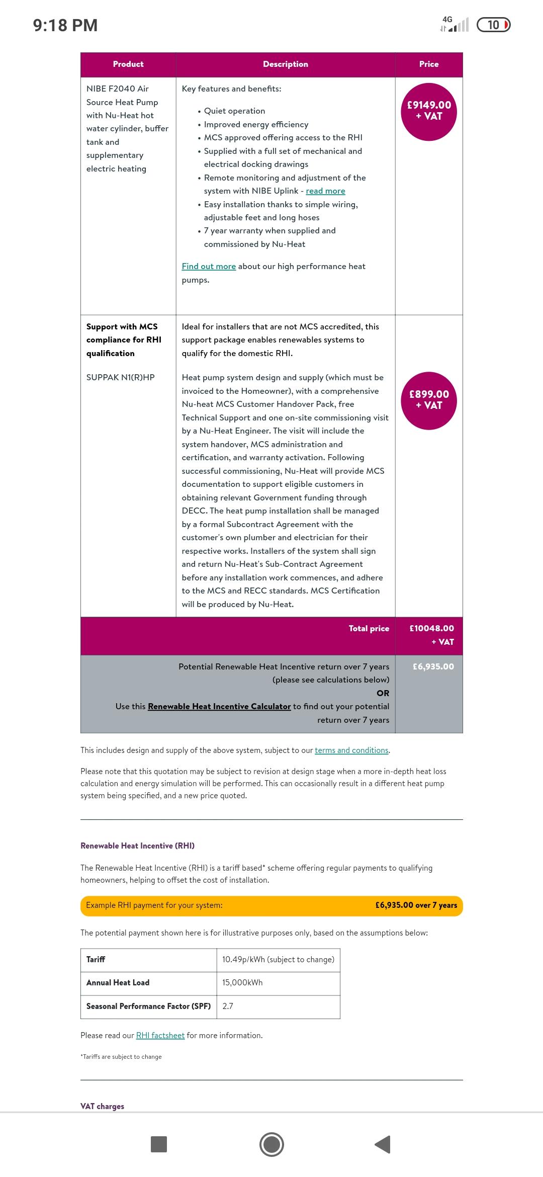

canalsiderenovation Posted August 15, 2020 Share Posted August 15, 2020 Hi We are meeting with our plumber next week to go through things. We had a provisional quote a few months ago, prior to any building starting so we may need to make some tweaks now. This is going down the RHI route for our ASHP and all underfloor heating throughout the bungalow and included all plumbing of three bathrooms too (actual sanitaryware excluded as we have purchased this). I'd be grateful if I could get some opinions on this in prep for the meeting next week. Thanks Plumbing 1.pdf plumbing 2.pdf Link to comment Share on other sites More sharing options...

ProDave Posted August 15, 2020 Share Posted August 15, 2020 So you have been quoted £22K and will get back £10K in RHI payments so a net cost of £12K You can buy the ASHP and cylinder for £4914 plus VAT = £5896 Is the UFH and install really going to cost £6K if you just get an ordinary plumber to fit it? (hint mine did not) I am just saying before you sign up to an MCS / RHI scheme, check the alternatives. If you can cost the install and UFH separately with a non MCS plumber and it comes at at no more than £6K then there is no point in the RHI scheme. Link to comment Share on other sites More sharing options...
canalsiderenovation Posted August 15, 2020 Author Share Posted August 15, 2020 50 minutes ago, ProDave said: So you have been quoted £22K and will get back £10K in RHI payments so a net cost of £12K You can buy the ASHP and cylinder for £4914 plus VAT = £5896 Is the UFH and install really going to cost £6K if you just get an ordinary plumber to fit it? (hint mine did not) I am just saying before you sign up to an MCS / RHI scheme, check the alternatives. If you can cost the install and UFH separately with a non MCS plumber and it comes at at no more than £6K then there is no point in the RHI scheme. Thanks I'll get the plumber to also price not going through the RHI scheme and see what the difference is. Link to comment Share on other sites More sharing options...

ProDave Posted August 15, 2020 Share Posted August 15, 2020 If you want to answer the RHI question, separate the quotes to general plumbing, and heating system (with or without RHI) on separate quoted. My gut feeling is there is too much to give a fixed quote. I know most people don't like it, but I feel certain you would end up with a better finished price on a day rate. I always maintain a fixed quote has to allow for the worst case of everything which may not happen. 1 Link to comment Share on other sites More sharing options...

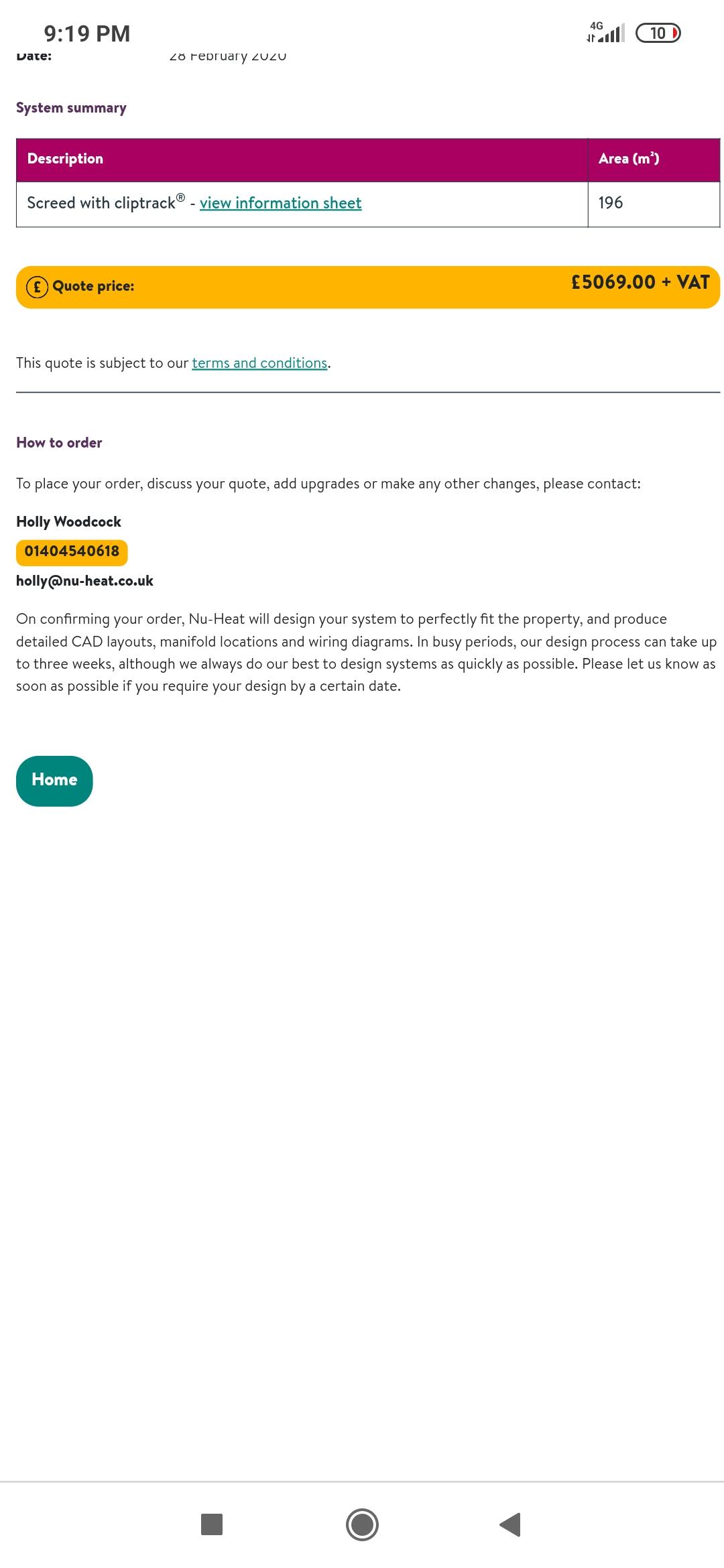

Alexphd1 Posted August 15, 2020 Share Posted August 15, 2020 (edited) I agree with prodave but all depends on finding decent tradesmen. How much bathrooms and is there a utility sink? 170m2 is maybe ufh 800m of pipe (very rough est and loops depends on zones). Emmeti is a decent brand I am 99% sure they used (8 years ago) rebranded uponor mlcp pipe (it was my favorite ugh pipe) Edited August 15, 2020 by Alexphd1 Link to comment Share on other sites More sharing options...
canalsiderenovation Posted August 15, 2020 Author Share Posted August 15, 2020 15 minutes ago, Alexphd1 said: I agree with prodave but all depends on finding decent tradesmen. How much bathrooms and is there a utility sink? 170m2 is maybe ufh 800m of pipe (very rough est and loops depends on zones). Emmeti is a decent brand I am 99% sure they used (8 years ago) rebranded uponor mlcp pipe (it was my favorite ugh pipe) Three bathrooms, two with shower, toilet and sink, one with the addition of a bath. One kitchen sink one utility sink. Link to comment Share on other sites More sharing options...

canalsiderenovation Posted August 15, 2020 Author Share Posted August 15, 2020 Located my quotes from NU heat. Excluding Vat and installation, product only. The UFH was for a bit extra M2 but we have now done away with an extra room we had planned. We aren't going with Nu heat, this was a quote we had following seeing them at a home show. Link to comment Share on other sites More sharing options...
Alexphd1 Posted August 15, 2020 Share Posted August 15, 2020 That's a fair bit of plumbing alone, material he is providing wont add to much but time will add up. Also keep eye on small details as thickness of insulation esp if outside heated envelope of house. What about a tap in the garage? Try and cut out expensive 'extras' just now. Link to comment Share on other sites More sharing options...
