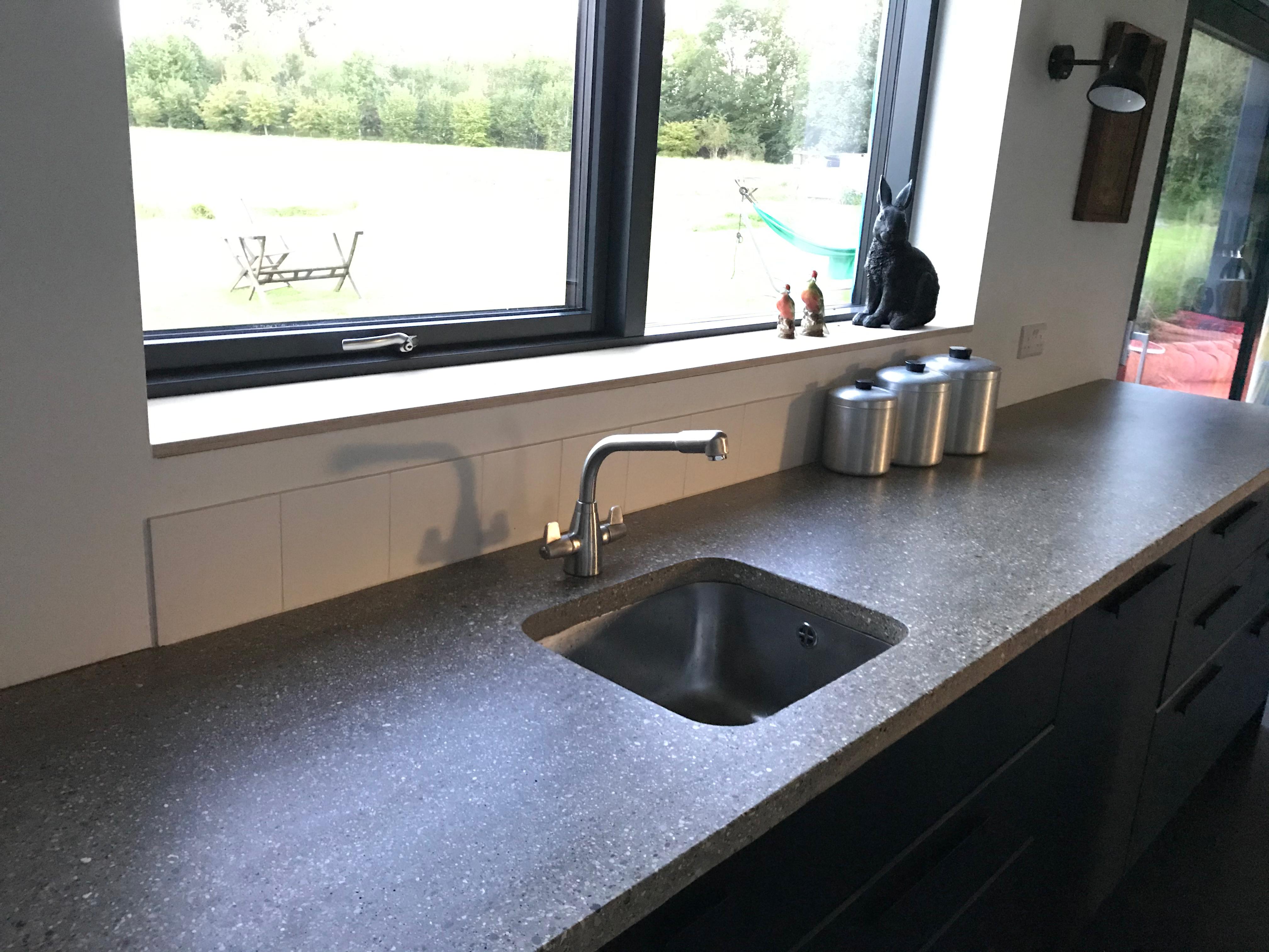

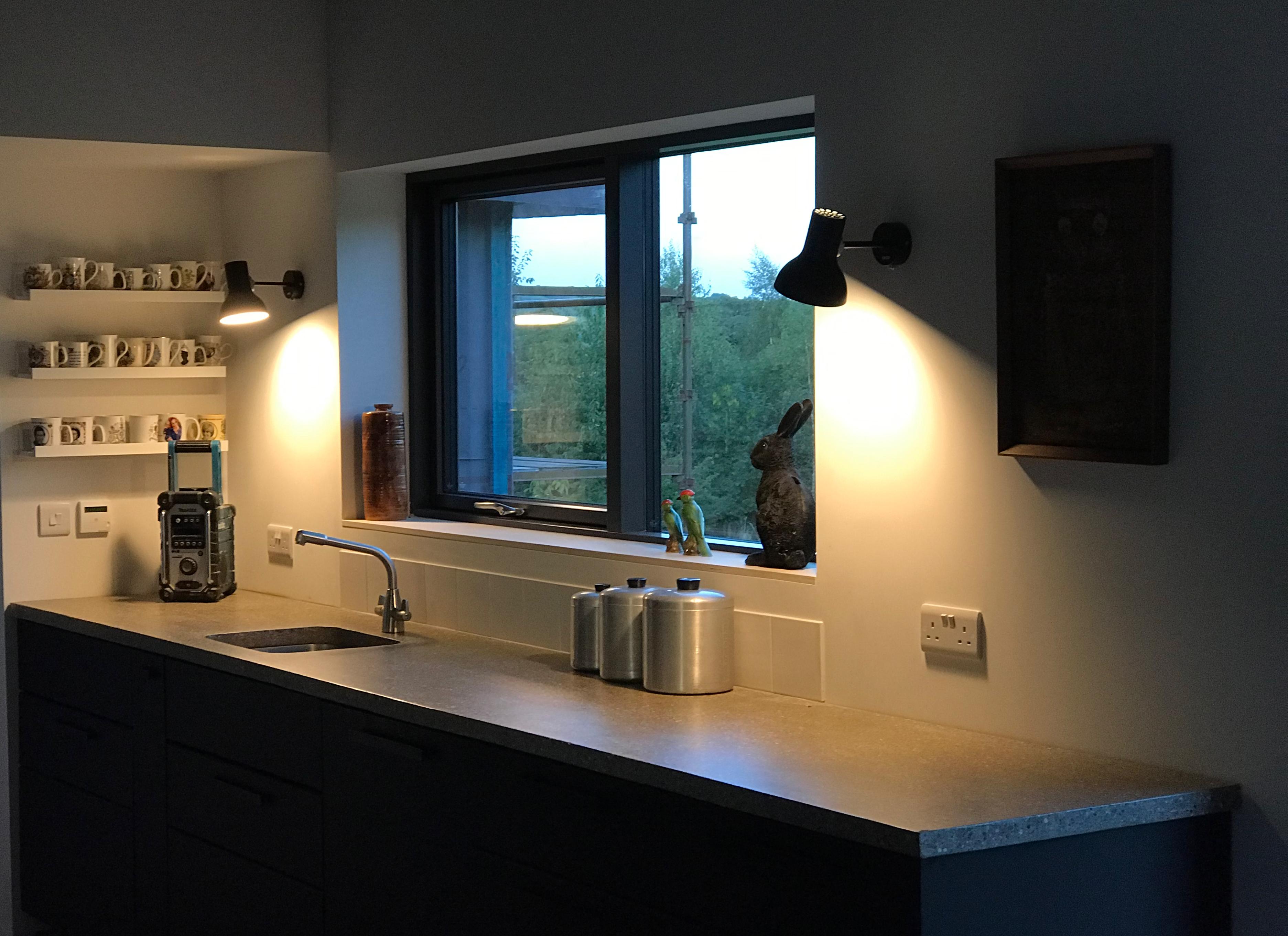

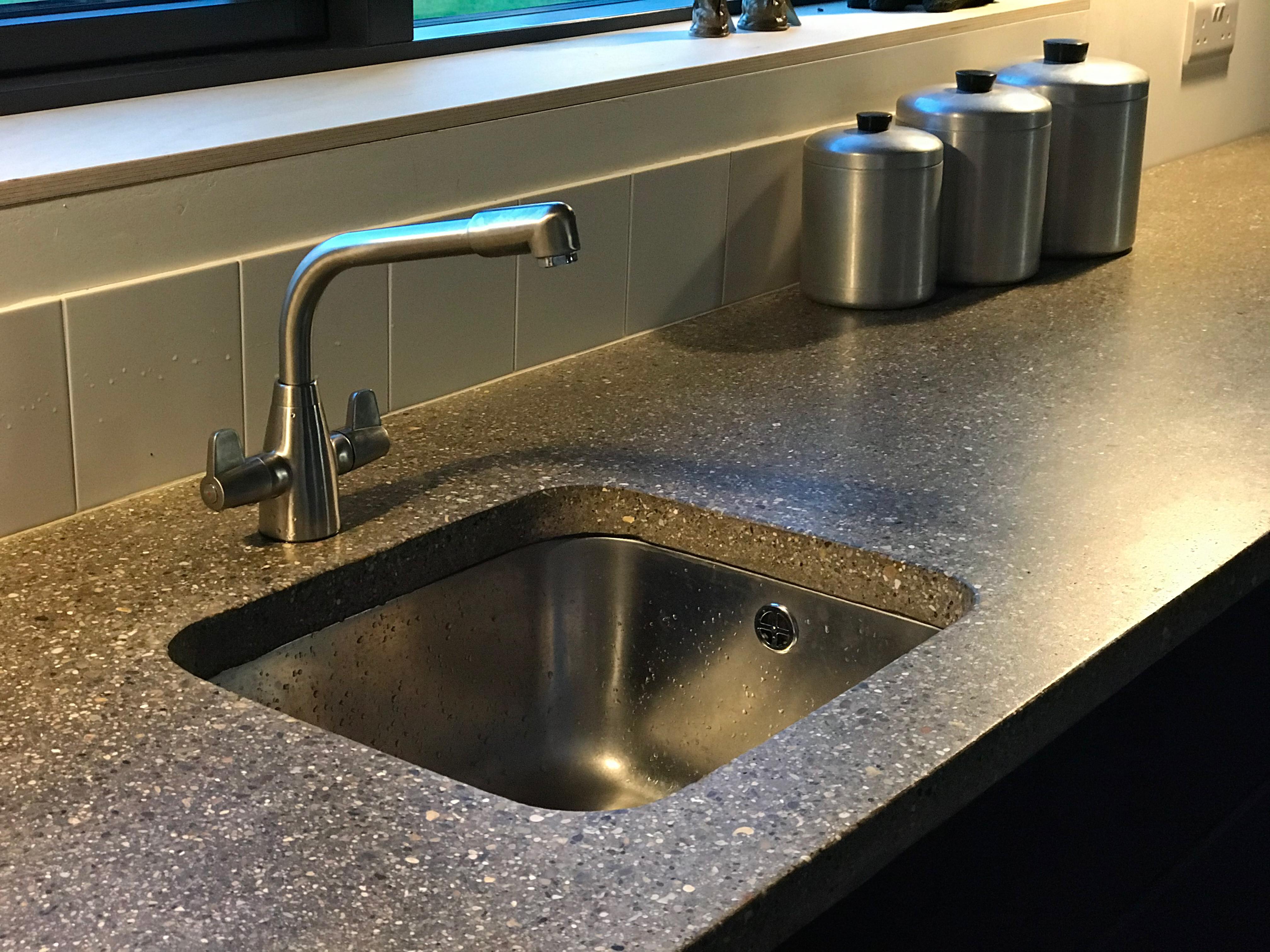

JamesP Posted September 3, 2020 Posted September 3, 2020 I made some concrete worktops for the kitchen and utility, 40mm depth, two with under mount sink. Kitchen sink worktop is 3.6m, utility 2.4m and the island 1.2m x2m with hob. Major challenge was the weight but they are in. Tiles are temporary. I had a quote for 5.4K so thought I would give it a go. 9

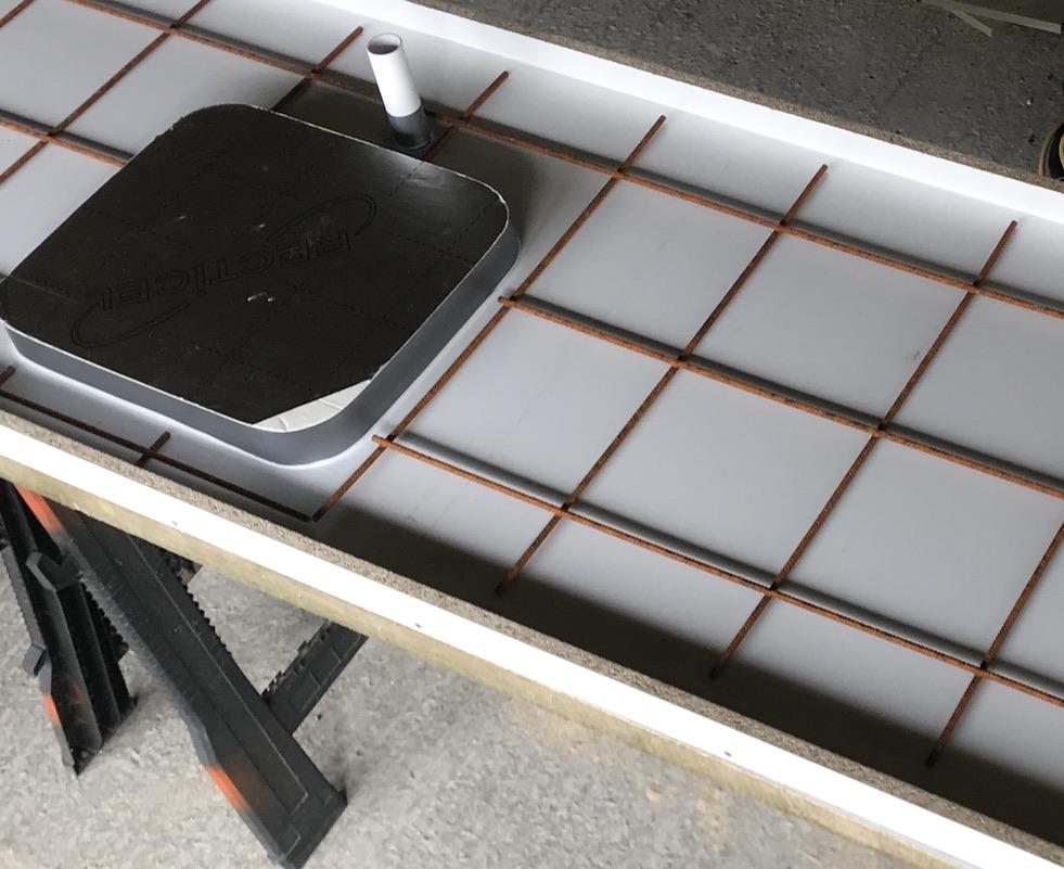

JamesP Posted September 3, 2020 Posted September 3, 2020 8 minutes ago, PeterW said: @JamesP love the Makita radio ..!! What aggregate did you use and did you have to polish or diamond grind them.? Were they cast in situ..? I made some formas using 18mm matt white melamine. Cast in the garage and then moved across to the house. I purchased a cheap 4' wet grinder off the bay which has worked surprisingly well. Started with a 30, 50, 100 and finished with a 200 using copper bonded diamond grinding/polishing pads. I did a few tests with different aggregate but went with bagged 20kg Blue Circle High strength 40N for consistency across the 3 worktops. Our Pure DAB gave up after 20 years so Makita for the win. 2
Onoff Posted September 3, 2020 Posted September 3, 2020 You didn't use silicone on the internal corners to produce a rounded top edge? Any mesh used?
JamesP Posted September 3, 2020 Posted September 3, 2020 (edited) @Onoff I siliconed all the internal corners, used reinforcing mesh and some glass fibres. Edited September 3, 2020 by JamesP 1
Onoff Posted September 3, 2020 Posted September 3, 2020 (edited) 35 minutes ago, JamesP said: @Onoff I siliconed all the internal corners, used reinforcing mesh and some glass fibres. Nice. I couldn't see the edges on my phone. Did you vibrate the mix. Edited September 3, 2020 by Onoff
JamesP Posted September 3, 2020 Posted September 3, 2020 20 minutes ago, Onoff said: Nice. I couldn't see the edges on my phone. Did you vibrate the mix. I tried using a soft mallet, tapping on the sides and an orbital sander. Tiny air bubbles appeared around the edges. After grinding I used a PVA / cement mixture to coat the surface to fill any holes then went over again with the grinder / polisher.

Onoff Posted September 4, 2020 Posted September 4, 2020 I like using this stuff for pretty much anything mortar or concrete related. On the back of the container is says it has de aerating properties which I'd agree with. Takes much less tamping and you don't get the bubbles you would without it. I wonder if this would assist? https://www.everbuild.co.uk/product/202-integral-liquid-waterproofer/ Guessing you used a black dye? What did you seal it with? @Construction Channel, didn't you do similar?
JamesP Posted September 4, 2020 Posted September 4, 2020 2 hours ago, Onoff said: I like using this stuff for pretty much anything mortar or concrete related. On the back of the container is says it has de aerating properties which I'd agree with. Takes much less tamping and you don't get the bubbles you would without it. I wonder if this would assist? https://www.everbuild.co.uk/product/202-integral-liquid-waterproofer/ Guessing you used a black dye? What did you seal it with? @Construction Channel, didn't you do similar? I used a Bostik concrete sealer applied with a small roller. a few coats. I did not use any dye, the colour is straight out of the bag. I will try the waterproofer you recommend for some smaller worktops for a pantry. I know, I know......

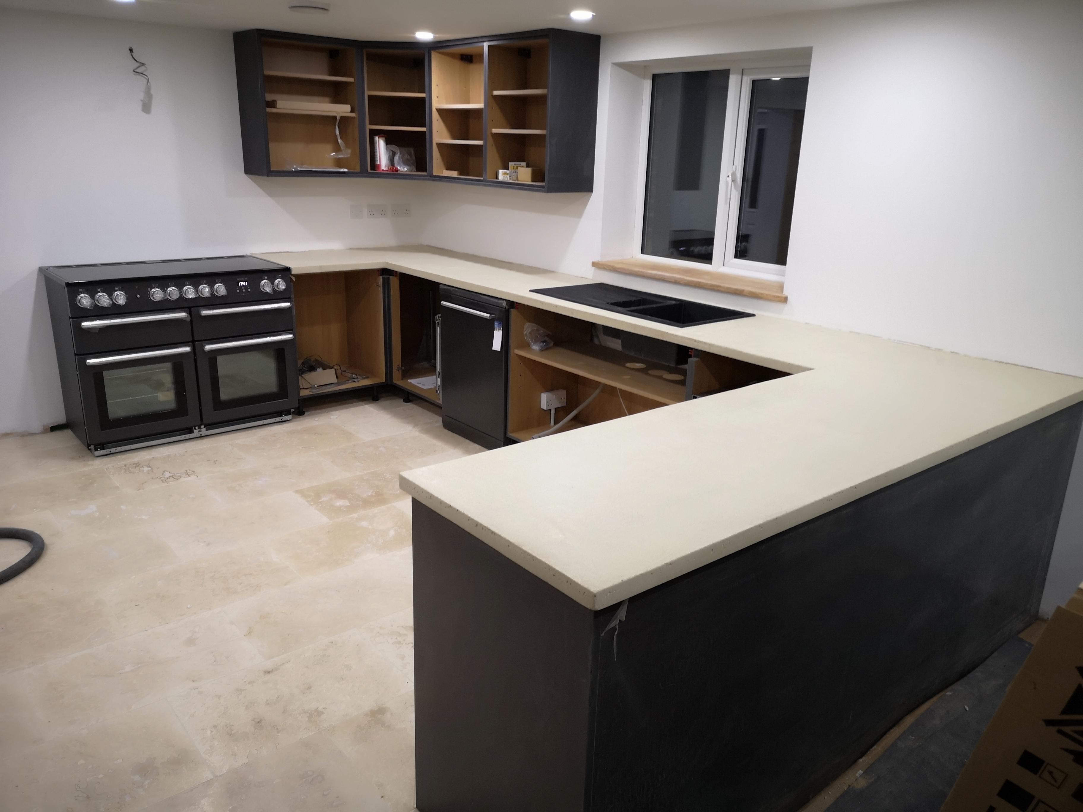

Construction Channel Posted September 4, 2020 Posted September 4, 2020 10 hours ago, Onoff said: I like using this stuff for pretty much anything mortar or concrete related. On the back of the container is says it has de aerating properties which I'd agree with. Takes much less tamping and you don't get the bubbles you would without it. I wonder if this would assist? https://www.everbuild.co.uk/product/202-integral-liquid-waterproofer/ Guessing you used a black dye? What did you seal it with? @Construction Channel, didn't you do similar? Pretty much, i used white cement and lime instead of dye. Also i cast it in situ so i had to polish the top afterwards. Came out ok but definately not perfect. Looks pretty good though. 4
