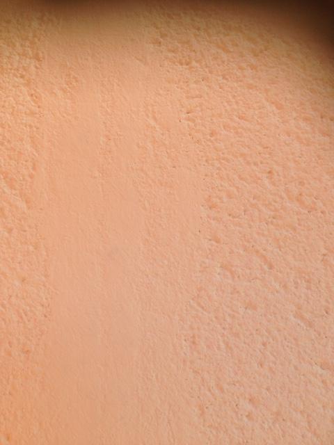

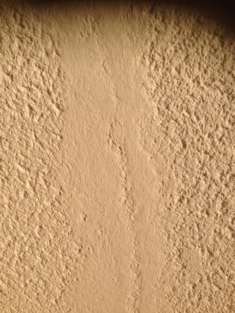

Below is bodge attempt at fixing cracks.

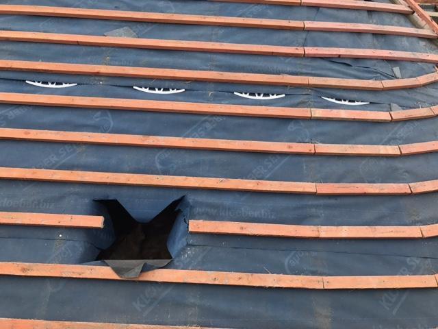

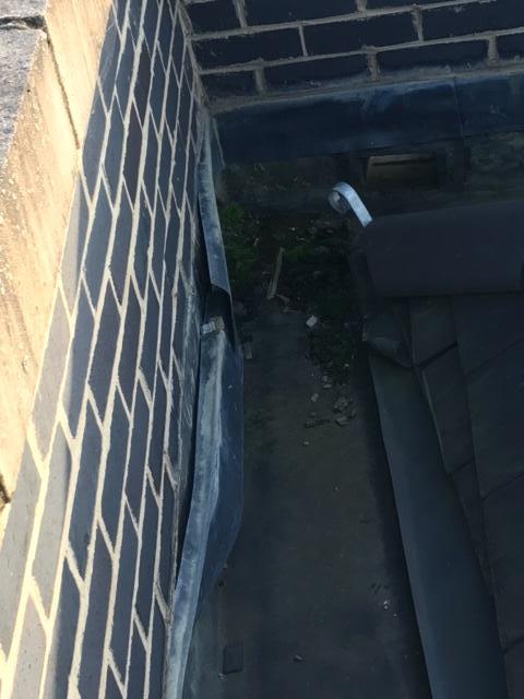

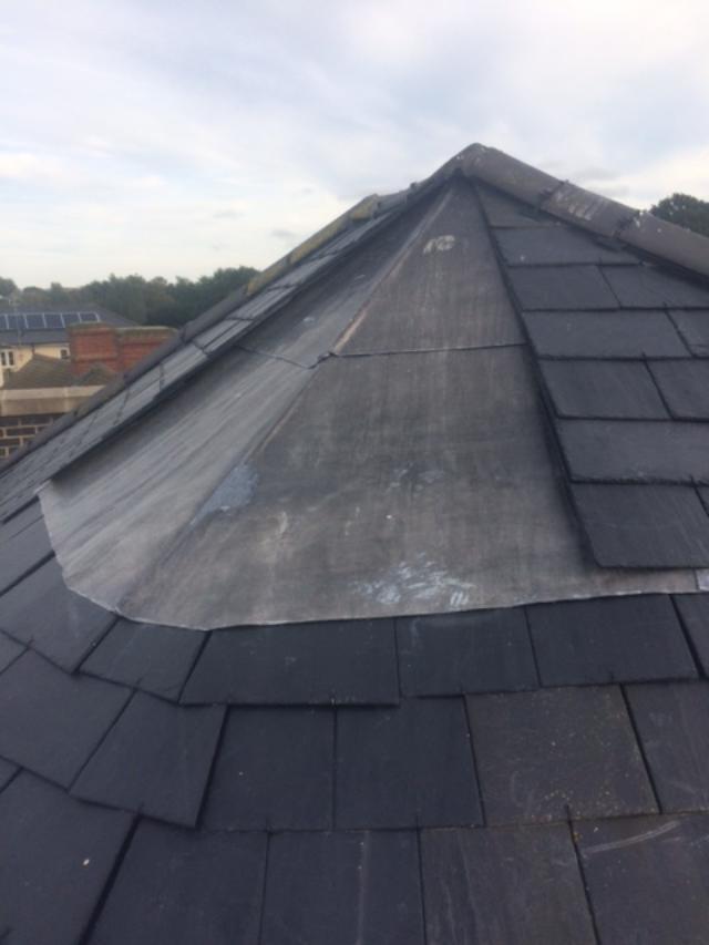

When I purchased the whole pitch was tiled. Now it has lead on the curve as they said it is built incorrectly and tiles won`t fit. There was a hole under the tiles where they were going to fit a vent, then never, lead hanging off, the water build up.
Looking closely in and outside the house I can see where they have touched up faults.
Here are a few more pictures of the roof before it was repaired. It still has the lead corner.
Edited by Bri44

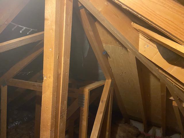

Just looked at that link. It would appear my roof beams/joists are incorrect then as the whole roof was suppose to be tiled and the repair roofers could not get them to fit so used lead.

Tricky as your roof imo isn't a total conical roof. Seems to have elements of a conical and hip end. Whatever, it should at least look good.
It looks better after the 2nd repair but my point was i bought a house with a fully tiled roof and they had to change it because it has been constructed wrong.

Is there anyway I can find out if my expansion joints have been fitted to the blockwork and if so, where hey are located?
Is there anything on the inside that could be causing the building to stress. Like a large beam carrying a roof section or a large open plan area.
From your first posts it just looked like the house has dried out and cracked in a few places but the more and more info and pics you post it's evident is way more than that.
There's no way to dress this up nice I think you have bought a turd. Unless you can find the root cause of the cracks no amount of cosmetic work will hide the fact it's still a turd.
If there was an expansion joint on a wall you would see it very clearly. It shouldn't have been plastered over as that defeats the point of one.
I`ll get my ladders and check the loft. There are two expansion joints on the render that start and stop at windows and doors so they are not continuous from top to bottom. I know the blockwork should have them as well. I was wanting to know if there is a way to find them or would that involve pulling all the render off?

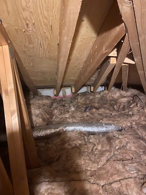

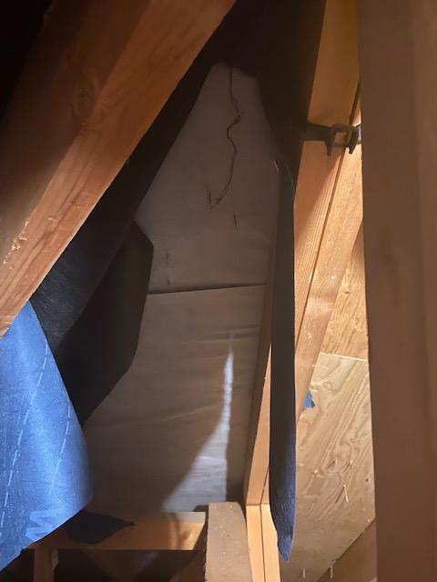

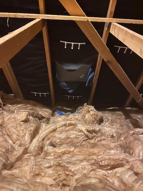

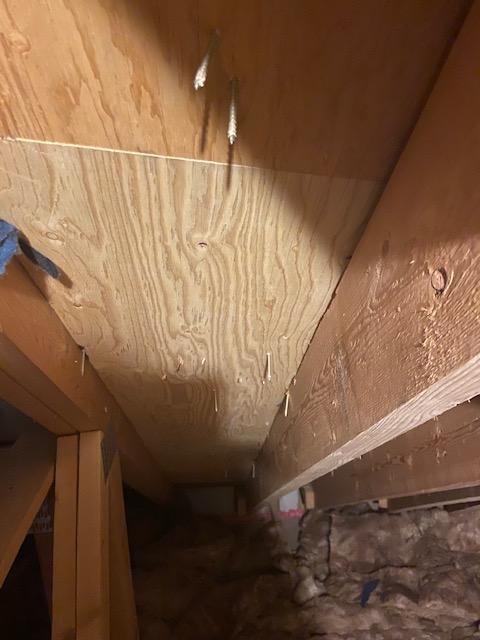

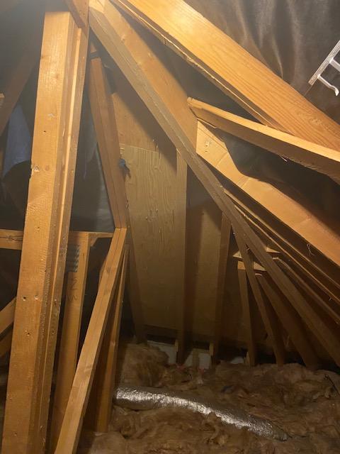

There is too much insulation thrown in to see if any large beams.

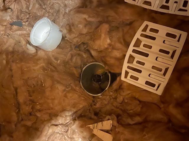

Where the hole was left in the roof when a vent was not fitted looks like whatever they used to cover it has come away.
Here are a few pictures of the curved part of the roof with big screws sticking through and the hole from inside.
Edited by Bri44
