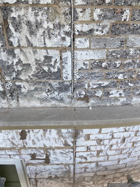

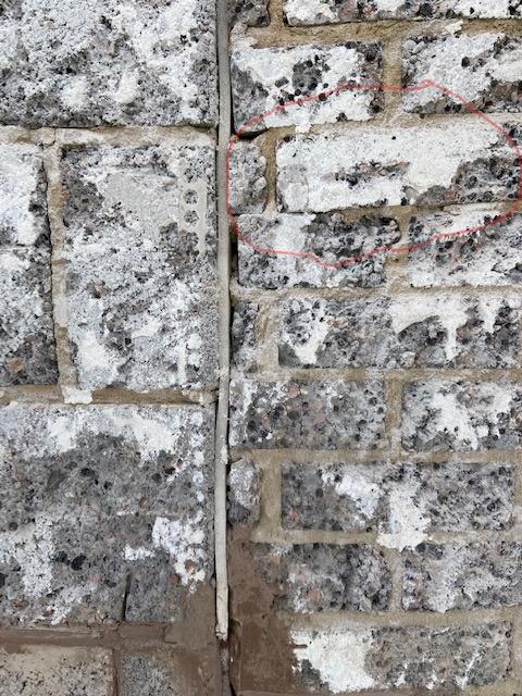

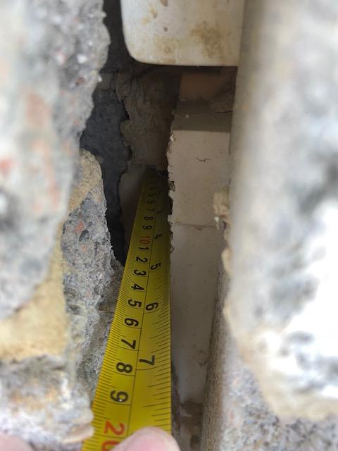

40mm Gap between blockwork

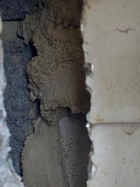

A better picture showing badly fitted insulation, missing insulation and big mortar snot stuck on inner block and xtratherm board.

The insulation...
Is that full fill?
If so, does it have a High Impact Plastic face to it?
18 hours ago, MikeGrahamT21 said:
The insulation...
Is that full fill?
It is xtratherm, it has a hard plastic face which they say is to prevent water penetration.. Other areas it is just rockwool type, others I can see polystyrene and other areas nothing at at.
was worried they'd put full fill normal PIR, looks like they've used CT-PIR in places. Its designed to be a full system and should be used all over tho, with differing types you'll have cold spots, especially where theres nothing at all.

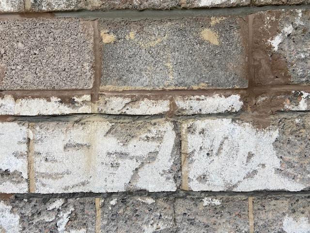

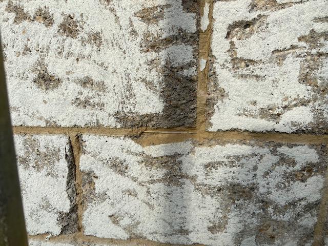

Was the person who attempted bricklaying drunk or just ran out of mortar because they used too much making 40 and 50mm bed joints.

45 minutes ago, Bri44 said:
Right now they are filling in all the mortar joints etc, 4 weeks after the render came off.
This seems very odd. If the survey has not been done and repairs agreed to why are they stating to do a repair that makes it more difficult to see what he problems are.
I would not be allowing any work until there is agreement on all the work that needs to be done (unless it really has to be done to stop further problems)
