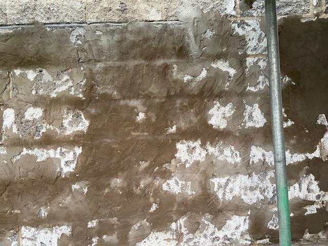

Thanks Guys. I think they are nearly done.
The cavity is breached in many places with mortar snots and loose debris. I could see the fibre glass type insulation was wet already.
I too think it`s an attempt to make it look better.
This is what has been done , not a pretty site. ]

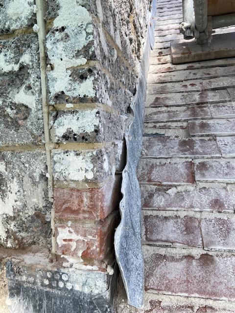

The lead flashing is still loose on Gable end, hopefully it does not cause problems for my neighbour.
Are they going to coat that patchwork quilt with something to make sure the render can get adhesion to it. Previously it would have had the rough blocks. Now it has motar that looks like it was thrown at it from 6ft away and pointed in with the back of the shovel.

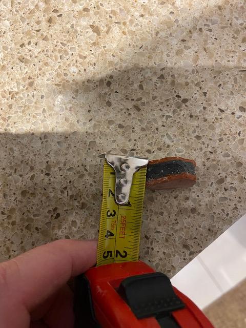

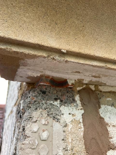

Can anyone tell me what this is called? Is it a roof tile? It`s 10mm thick and inserted under the end of a stone ledge. Under my stone window sills they have a lot of roof slate in the mortar.
They have used whatever was lying round and hard to pack up a head or a cill to get it level. You can use a deep bed of motar as the weight of the head and cill will just make it sink so you find something to use as a packer. Could be a tile, cement board, slate. Have seen lots of things used.
What is holding that up???
The fact that it has a round hole in makes me think it's a sliver of brick,  but it's not compressible, so is ideal to pack up one ens of a stone ledge to get it level
Nothing under or on top this piece of whatever it is. It just sits on top of the concrete block and under the ledge. No mortar there.
Edited by Bri44
It does look like brick but must have been cut pretty straight with a grinder or something if it is.

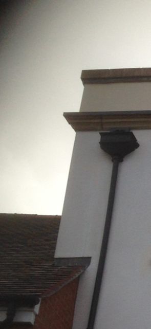

I took a picture that shows the Gable not looking good or safe.

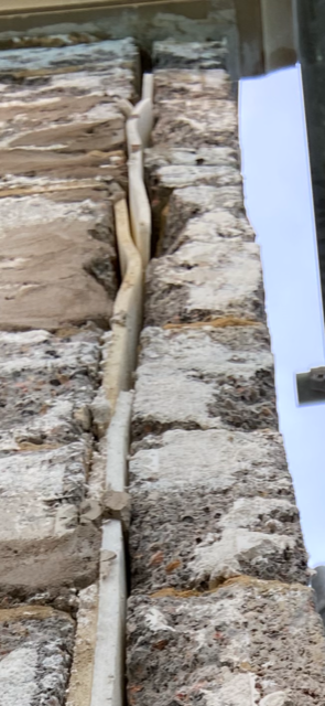

Have they ever gave you a reason why they have an expansion joint at a corner. Never seen them like that before. Might be a perfectly good reason for it but the corners of any building are it's strongest points and by putting an expansion joint there it's made it weaker. You usually find them along a very long stretch of brickwork/blocks but right at the corner is a new one for me.
I am glad someone asked this as I had the same thought. I have never seen an expansion joint at a corner, it seems strange to me.
If you look on the parapet wall picture there is one near the corner on the front of the house too. This one is about 15 inches from the corner whereas the wonky back one is about 4 inches from the end.
Could it have something to do with that piece of wall overhanging my neighbours roof?
According to Ancon wall ties, only flat slip ties should be used in a movement joint. My gables have embedded wire type which will prevent the intended movement.
I`ll ask the LABC warranty inspector why the movement joints are there. Any other questions you can think of that i should ask? I`ll put it all in writing to them.
Just speculation but is that a bit of quarry tile that you would use on your hall floor say?
This looks like a piece of clay drain pipe to me
I'm surprised this house hasn't taken itself down yet!
I found another bit of tile. It matches my neighbours roof where the builders have damaged their tiles.  So it`s a roof tile they stuck under.
Measuring under the ledge, at the opposite corner the mortar is twice as thick which I`d say means the top layer of blocks this ledge sits on is not straight.
The corner in above post is not even straight.  Above and below view.
The use of a tile or anything for that matter isn't really a big deal. It happens. Won't cause any issues. The bigger issue looking at the last few pics is either that house is way way out of square or really out of plumb. Have you enough room between the wall and the scaffold at each corner to drop a plumb Bob to check how bad it could be. A long piece of string and a weight, bolt would work.
I have checked the plumb. The front of the house is out by roughly 50mm
The curve is out between 20-28mm
The back seemed out just a few mm but it is windy there so hard to get a reading.
Here are 5 pictures showing from the parapet wall down. I had to start over the ledge. When looking down you can see the line is further out from the base of house a lot.
Edited by Bri44
