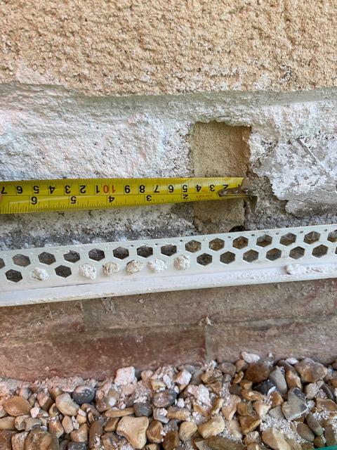

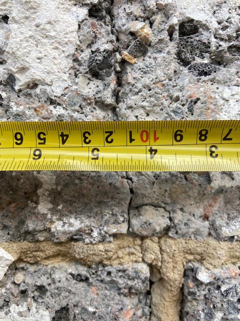

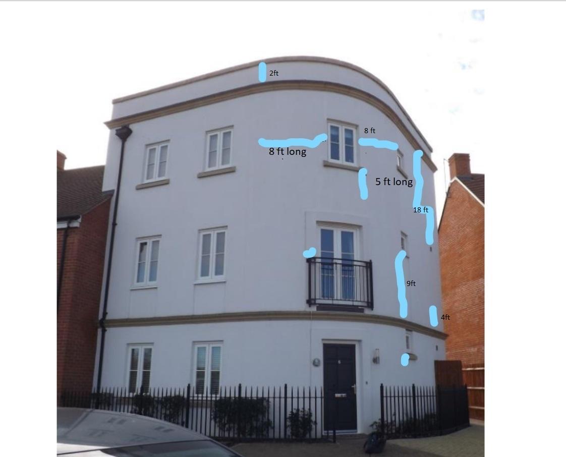

Bri44 Posted August 3, 2020 Share Posted August 3, 2020 Hi all. I`m having render repairs done and have noticed that the mortar between an exposed block is 40mm wide. If it`s like this up the whole elevation what are the possible issues? The other side of the house are 10mm but there are cracks in the blockwork. One vertical crack is 18 foot long and getting longer. Waiting on the developer sending a structural engineer. Any advice appreciated. Link to comment Share on other sites More sharing options...
bassanclan Posted August 3, 2020 Share Posted August 3, 2020 I don't think the 40mm joint will be a problem. If a structural engineer is coming he will be able to provide an opinion, but you may want an independent opinion. Is it a new build house with nhcb warranty? Link to comment Share on other sites More sharing options...
Bri44 Posted August 3, 2020 Author Share Posted August 3, 2020 The house is 7 years old. It was a show house. I bought it from the developer Feb 2017. It has an LABC warranty. Would the mortar not cause structural issues regarding the strength etc? It is recommended that mortar joints should be no more than 10mm. I`ll see what their engineer says and look at getting my own. Link to comment Share on other sites More sharing options...
Declan52 Posted August 3, 2020 Share Posted August 3, 2020 It will be fine. I have seen kerbs, lath and all sorts of things built into walls of houses and they are still standing. Link to comment Share on other sites More sharing options...
Mr Punter Posted August 3, 2020 Share Posted August 3, 2020 No issue as long as it is not throughout but it is unusual if the crack is through the blocks as well as the render. It is good to get render cracks sorted as water can get in behind it and freeze / thaw can take off large sections. It is very difficult to get the patches so they will not show, so unless they are serious I would just fill and paint. Any cracks in any brickwork? Are you on clay or made ground? If no to both I would not worry. Link to comment Share on other sites More sharing options...

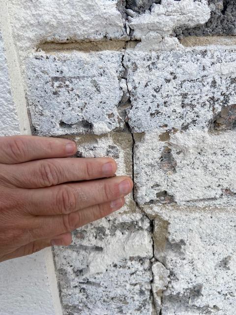

Bri44 Posted August 3, 2020 Author Share Posted August 3, 2020 (edited) If you look at pictures in the first post you can see the cracks go right through the blockwork and mortar and through the render which is why it was cut out. This is a different wall to the one with the 40mm mortar. Why would they make the gaps that wide? I`m on clay ground. Edited August 3, 2020 by Bri44 Link to comment Share on other sites More sharing options...
Declan52 Posted August 3, 2020 Share Posted August 3, 2020 It's just the way it works out when you bond a wall out. They really should have space out a few blocks so spread the extra 30 mm over 4-5 blocks but it won't make no difference. The crack could be just from the house drying out. Is it on the inside as well or does it continue on down the wall??? Link to comment Share on other sites More sharing options...
Bri44 Posted August 3, 2020 Author Share Posted August 3, 2020 I can`t see if it is on the inside due to plasterboard and wall paper. The biggest crack that has been cut out is 18 foot long and extends a further 15 down as a hair line crack in render so the blockwork is most likely cracked behind it. There are numerous other cracks mainly at window corners. They have cracked blockwork too. This cant be from drying out as its 7 years old. Link to comment Share on other sites More sharing options...

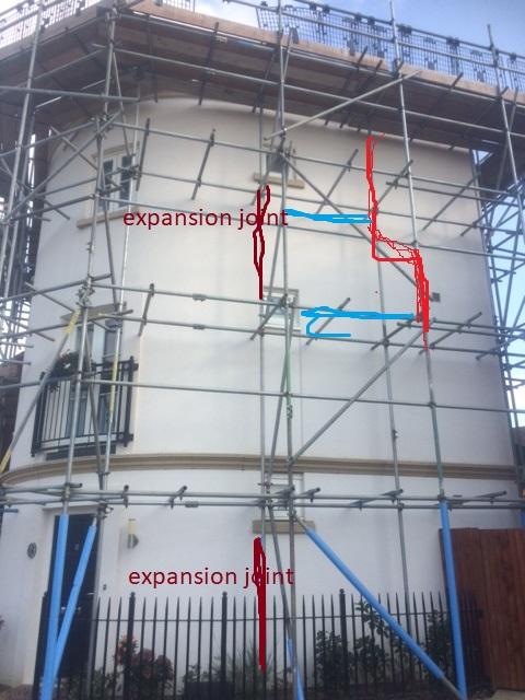

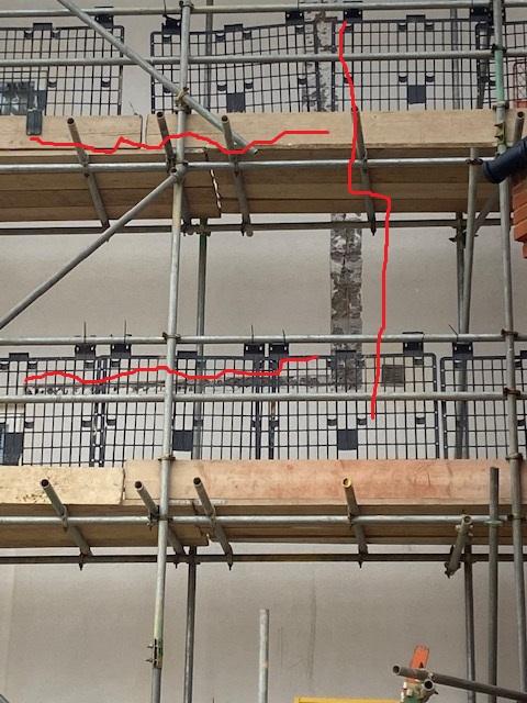

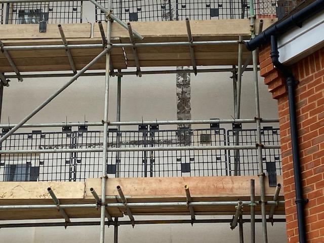

Bri44 Posted August 3, 2020 Author Share Posted August 3, 2020 In this picture you can see that the cracks have been cut out horizontally from the 18ft crack. The top horizontal crack is above the one you can see, level with the next level of scaffold boards. I have marked in blue the horizonal cracks. Link to comment Share on other sites More sharing options...
Bri44 Posted August 3, 2020 Author Share Posted August 3, 2020 Here shows the horizontal cracks marked in red. Take no notice of wonky red line, it should be straight. The red line shows the path of the 18 ft plus crack. Link to comment Share on other sites More sharing options...

MikeGrahamT21 Posted August 4, 2020 Share Posted August 4, 2020 Blocks from original photos appear to be aircrete, they are prone to cracking like this, probably just looks worse as the render has taken some of the block with it when its been removed. Link to comment Share on other sites More sharing options...

MikeGrahamT21 Posted August 4, 2020 Share Posted August 4, 2020 They get a lot of post install shrinkage, especially if they had been stored incorrectly on site before use (basically in the rain, they should be kept as dry as possible). The cracking is generally just cosmetic and nothing more. They're used as they help developers achieve certain u values cheaply and quickly. Obviously get it proper checked to confirm, but it may just be a case of crack stitching to ensure they don't show through again in the render, and some expanded metal lath attached to the blocks and then rendered in for additional strength at these points. Link to comment Share on other sites More sharing options...

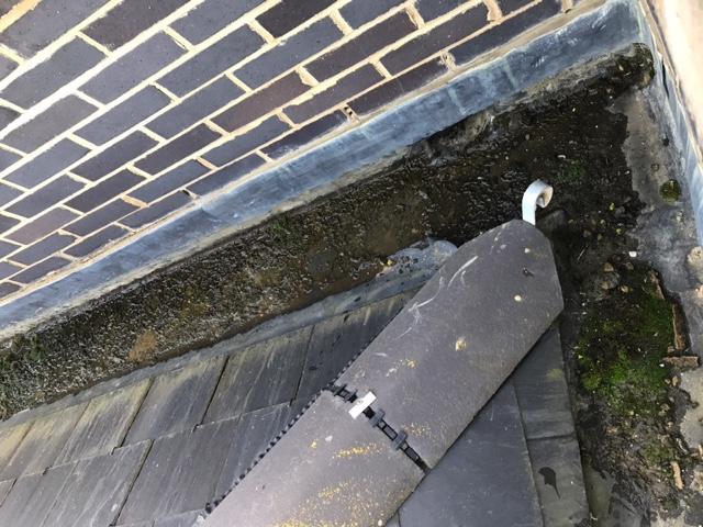

Onoff Posted August 4, 2020 Share Posted August 4, 2020 13 minutes ago, Bri44 said: Had the roof replaced twice already. In 7 years? What was wrong there and why twice? Link to comment Share on other sites More sharing options...

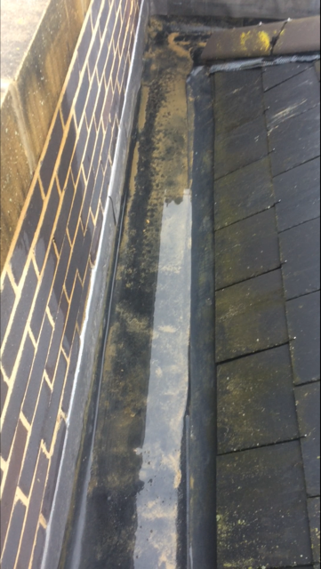

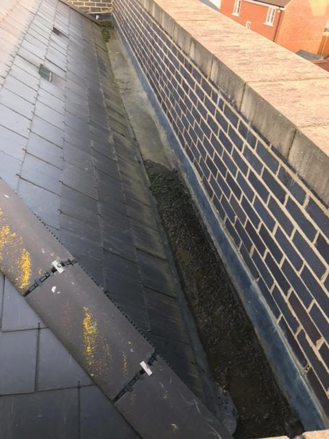

Bri44 Posted August 4, 2020 Author Share Posted August 4, 2020 (edited) 26 minutes ago, Onoff said: In 7 years? What was wrong there and why twice? It has a pitched roof with a flat gulley around. The gulley was lower than the exit point for the rain water so it pooled up like a moat. I was told the pitch roof was constructed wrong. First roofer took 3 months to replace roof. It was not done right. LABC said not correct. Next roofer ripped everything off first roofer did and took a further 6 months to complete. Whilst second repair was in progress it rained heavy on a Sunday afternoon. Water is pouring through my ceiling. I`m there with buckets catching it to stop it going through the next floor. I ring emergency developer number, no one answers. finally get an answer after 40 minutes only to be told because it`s raining no one can be sent out due to health and safety reasons. Could not make this up. I have another thread on here about all my DPC ground levels wrong. Most has been rectified now after a 2 year battle with developer. Floor tiles are cracked at base of door frames. Skirting boards not meeting in corners, filled with bodge and painted over. Lots of other issues. Edited August 4, 2020 by Bri44 Link to comment Share on other sites More sharing options...

MikeGrahamT21 Posted August 4, 2020 Share Posted August 4, 2020 11 minutes ago, Bri44 said: I asked a builder who lives round the corner to have a look. He said there is no expansion mesh i think between the layers of the blocks and no mesh under stress points like windows. Yeah, its known as bed joint reinforcement, and will stop the cracking, its not essential for structural reasons though, just cosmetic. The post build fix is helical bars ground into the blocks to stitch them together. I bet you are absolutely gutted about this house?! Unbelievable the quality of new build. Link to comment Share on other sites More sharing options...
