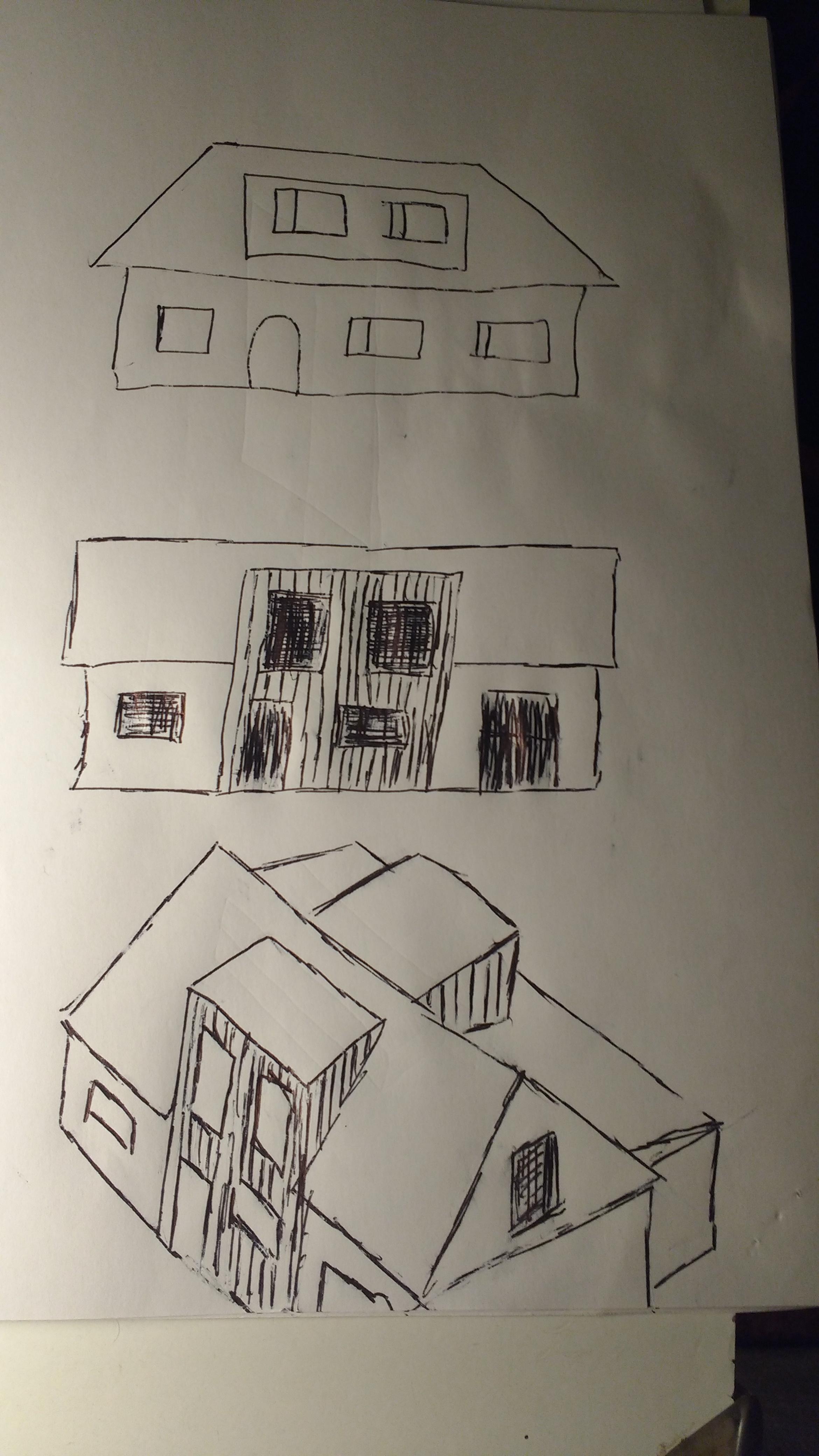

Onoff Posted August 2, 2020 Share Posted August 2, 2020 Pipe dream possibly but as opposed to a knock down rebuild I've been musing if I'd get pp to: - change hips to gables. -extend the front dormer and bring level with the front of the bungalow. Vertically clad to the full height (black possibly). -make front dormer windows full height -extend the rear dormer slightly -make downstairs front windows full height (just the RHS one shown) -ewi and warm roof What would be my next logical step to see if this would be permitted? Bungalow in an AONB has already I think had its 50% extension (must check that). Cheers Link to comment Share on other sites More sharing options...

DevilDamo Posted August 2, 2020 Share Posted August 2, 2020 Your best bet would be to seek Pre-application advice. The LPA would normally be mindful to grant PP for alterations that would then take you over the 50%. Are there any other buildings on the site that could be used as a trade off? Link to comment Share on other sites More sharing options...
Onoff Posted August 2, 2020 Author Share Posted August 2, 2020 19 minutes ago, DevilDamo said: Your best bet would be to seek Pre-application advice. The LPA would normally be mindful to grant PP for alterations that would then take you over the 50%. Are there any other buildings on the site that could be used as a trade off? I wouldn't be increasing the footprint btw. Stable block, double garage and 8x10 wooden shed. None of which I want to lose. 31 minutes ago, PeterW said: Are you in a conservation area ..? Just done a quick search and no, it appears not. In however the Kent Downs AONB. Link to comment Share on other sites More sharing options...

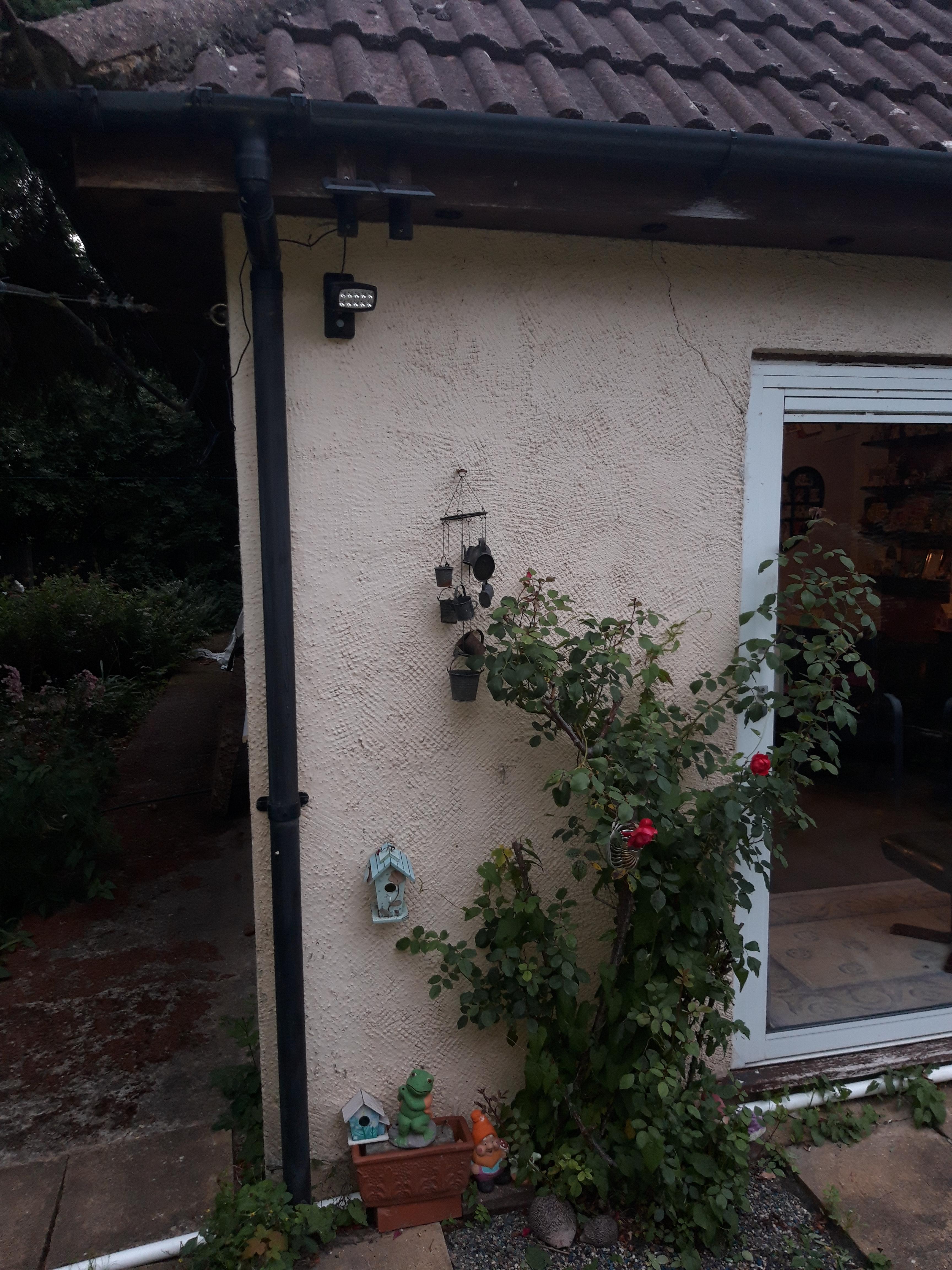

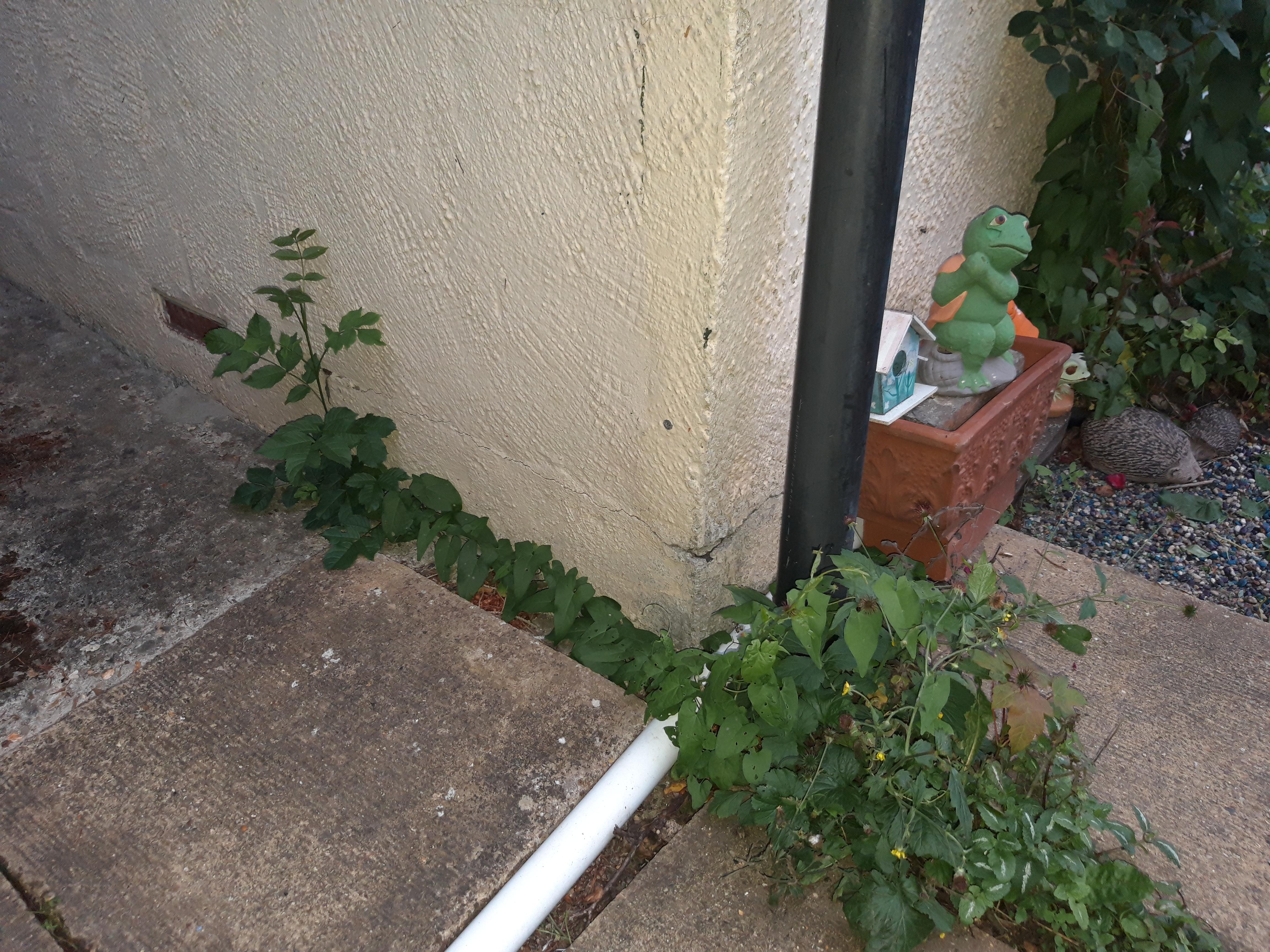

joe90 Posted August 2, 2020 Share Posted August 2, 2020 (edited) @Onoff You say You have little foundations, but has it moved yet? You don’t appear to have any cracks in your render. Lots of old buildings don’t have founds and they are fine. Good example in Shropshire when I lived there, chap wanted to convert an old threshing barn 200 years old, no additional load (the guy was an SE!) but council made him underpin it at great expense . I have done up loads of old houses in my life but my new build was lovely not having to deal with unforeseen problems and able to work with a clean slate but I was lucky that I had the money to do it because I worked my nuts off for years doing up old houses. How much could you do to your house without involving the council? Only get them involved with stuff not permitted development. i think you have to have a budget and work out what you can do for that price! Edited August 2, 2020 by joe90 Link to comment Share on other sites More sharing options...

joe90 Posted August 2, 2020 Share Posted August 2, 2020 22 minutes ago, Onoff said: Unfortunately we do! Corner of the lounge is "falling off: But is it still moving?, my son bought a Victorian end of terrace in bad need of TLC and the gable wall has moved, back bedroom floor goes “downhill” but the signs are it has not moved recently so it’s settled as much as it is likely too. Stitching brick courses and underpinning is not too bad a job to be done DIY. Link to comment Share on other sites More sharing options...
