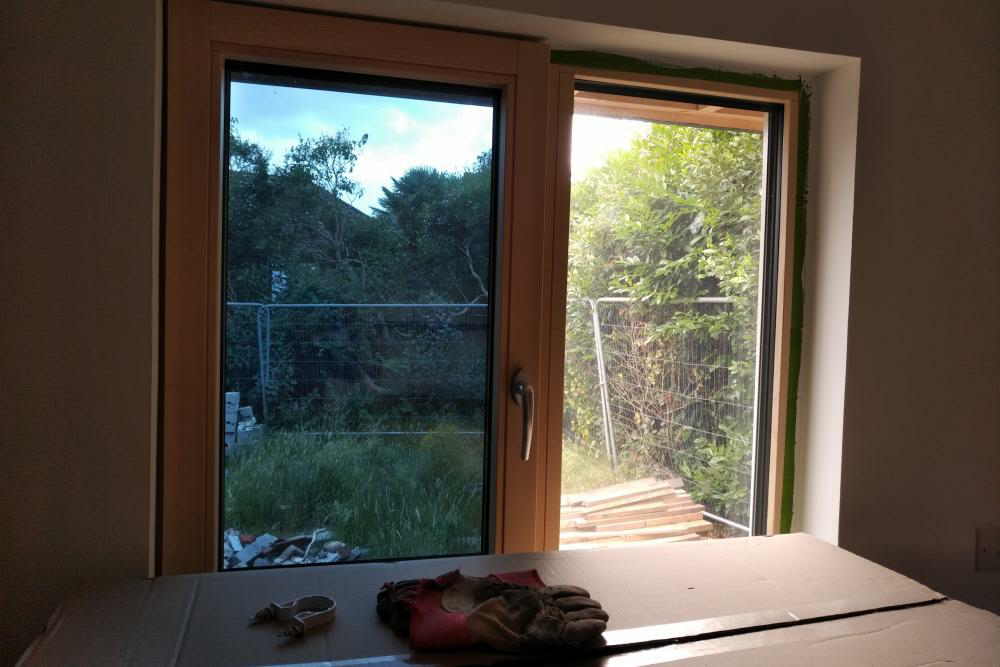

Nick Laslett Posted June 15, 2021 Share Posted June 15, 2021 On 30/08/2020 at 21:50, tanneja said: @Dan F thank you for the link, as best as I can see, the comparative numbers are: Standard Internorm Triple Glazing: 71% Light Transmittance, 0.5 g-value SKN 176 II Coating Triple Glazed: 62% Light Transmittance, 0.34 g-value Has anyone got a feel for how impactful this would be when looking out of the window throughout the year light levels? @tanneja Hello, how did you get on with your windows? We are looking at Pilkington Suncool 70/35 triple glaze which have LT 60% and 0.35 g-value. Link to comment Share on other sites More sharing options...
osmononame Posted June 15, 2021 Share Posted June 15, 2021 For what its worth I ended up with SKN176 coating on my rear elevation and unless side by side you couldnt really tell that it was solar glass. Link to comment Share on other sites More sharing options...
tonyshouse Posted June 16, 2021 Share Posted June 16, 2021 External shading is best and west facing windows generally cause biggest problems with overheating Link to comment Share on other sites More sharing options...
Conor Posted June 16, 2021 Share Posted June 16, 2021 We asked this question and the guy said don't even think about it as the cost will be way out of our budget. The units have arrived with the standard glazing as requested, and have a fair bit of shading on the inside and reflective on the outside, have noticeably darkened the rooms. Wouldn't want any more than this. Link to comment Share on other sites More sharing options...
