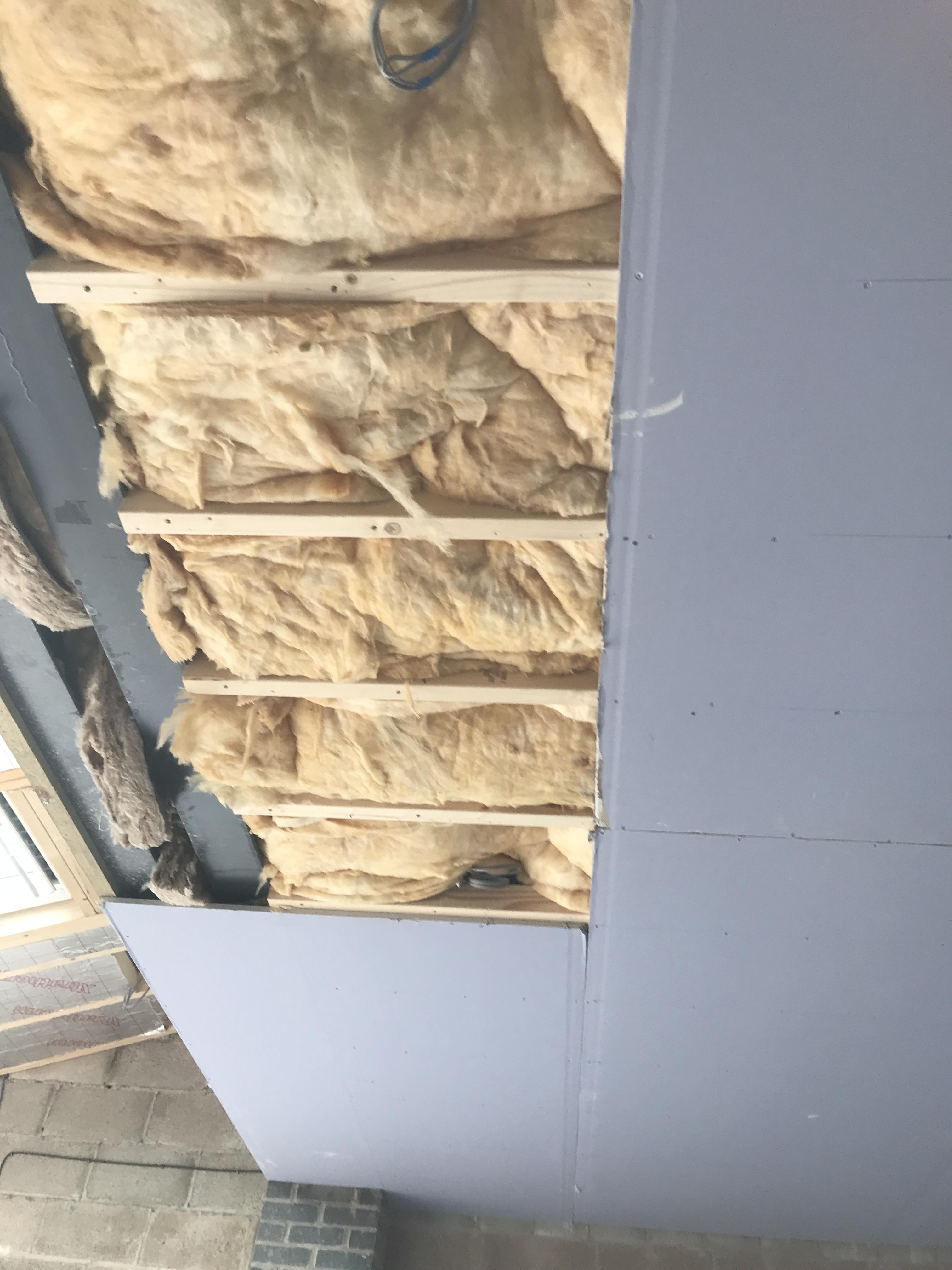

jl9r Posted July 29, 2020 Share Posted July 29, 2020 Sorry if this is repeating a common thread. We have recently purchased a new build detached house and noticing airborn noise between the upstairs and downstairs rooms. We also have a lot of joist movement noise, but the builders are coming back in a few weeks to remedy this by installing noggings. The ceiling / floor joists are engineered timber joists with chipboard above and 15mm regular plasterboard below. Nothing inbetween, just air. As they are going to be ripping up the upstairs floors, we have an opportunity to install some acoustic insulation. I am thinking just some acoustic slabs at 100mm and 60kg/m^3 (RS60 or RW3). My question is does anyone have any experience on doing this and how much effect it actually will make. I am nervous we do this at quite a bit of cost and lots of trouble and in the end the result is minimal. Is it worth the effort? I am surprised that the part E regs do not cover detached builds at all....surely they still require airborn noise regs. Thanks. Link to comment Share on other sites More sharing options...

jl9r Posted July 29, 2020 Author Share Posted July 29, 2020 Thanks for the replies. PeterW - the joists are the I-beam type with 'cardboard' between the small timbers. The builders say we didn't need noggins but the amount of creaking and movement has led them to now have to install them on most of this house type now. You are correct, they were only going to cut out a 300mm strip, enough to put the 4" x 2" noggins in but I have asked they widen to at least 600mm. This should allow enough to slide in the acoustic slabs. Bitpipe - yes they should and other builders have said it should have sound board as a minimum, but "value engineering" dictates it is all done as cheap as possible and then try and do as little as possible to fix it if it goes wrong. ProDave - yep! Link to comment Share on other sites More sharing options...

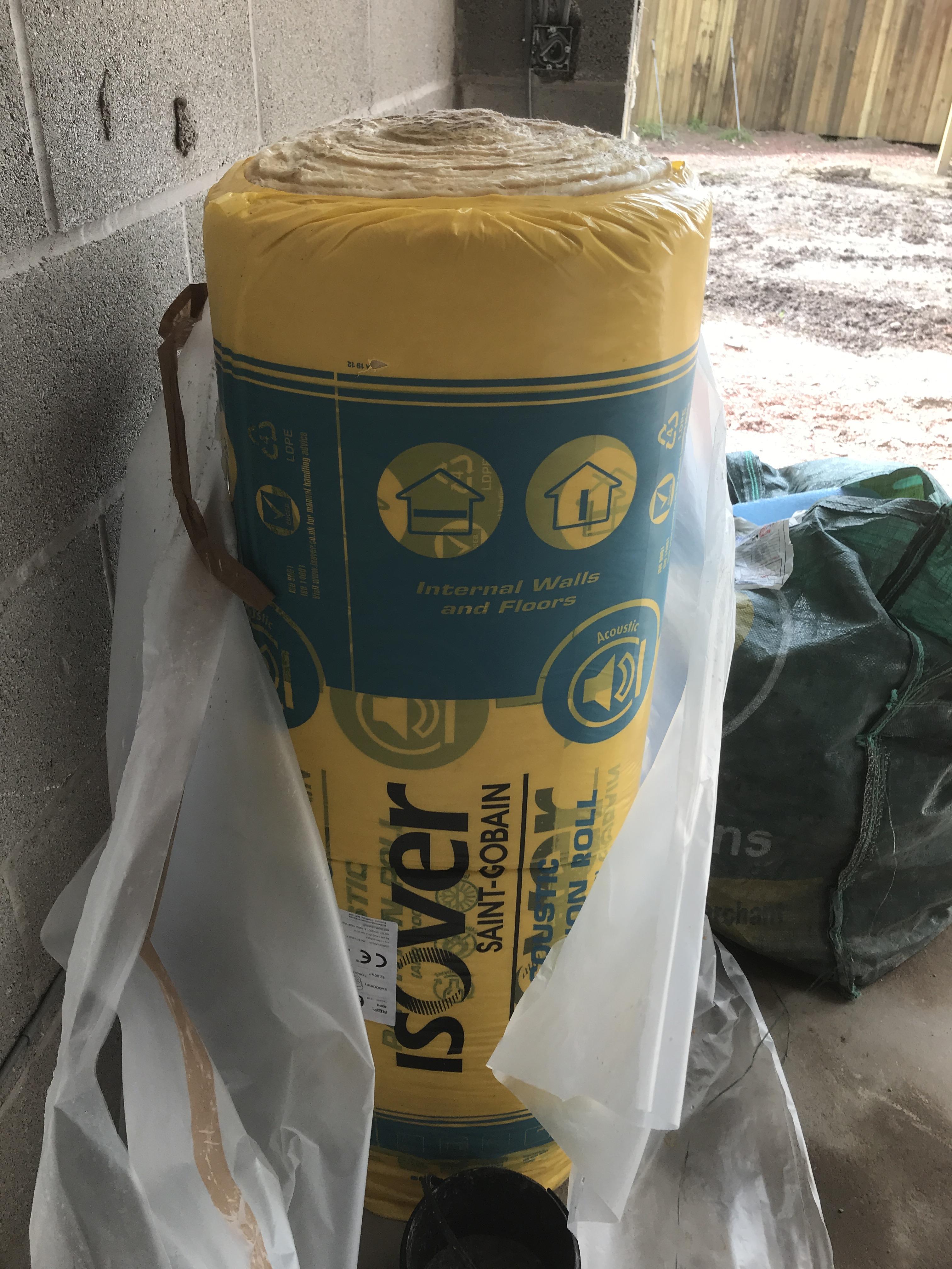

nod Posted July 29, 2020 Share Posted July 29, 2020 100 mil acoustic will greatly reduce noise Link to comment Share on other sites More sharing options...
jl9r Posted July 29, 2020 Author Share Posted July 29, 2020 Thanks Nod. Is this from experience of before fitted sound travel and after fitting the mineral wool? Link to comment Share on other sites More sharing options...
Russell griffiths Posted July 29, 2020 Share Posted July 29, 2020 Tbh I don’t think you stand much chance of sliding in anything, the first obstacle and the acoustic roll will bunch up and stop. Link to comment Share on other sites More sharing options...
AliG Posted July 29, 2020 Share Posted July 29, 2020 I was going to say the same thing. The ceiling space will be full of pipes, cables and, knowing builders, rubbish. So you won't be able to slide stuff in. Do you know someone who has had the noggins installed and has it worked? It might be that they should be that they need to attach the floor better, indeed they will weaken the floor by cutting a strip out of it. I would try and get them to agree to take up the floor to put in the noggins. They you can get in the insulation and they can fix it down with glue and screws. I would maybe offer to pay part of the cost as it is non standard as far as they are concerned. Link to comment Share on other sites More sharing options...

jl9r Posted July 29, 2020 Author Share Posted July 29, 2020 40 minutes ago, Temp said: I'd be very surprised if that meets building regulations, specifically Approved Document Part E. Apparently part E sound regs do not apply to detached houses? 3 hours ago, Russell griffiths said: Tbh I don’t think you stand much chance of sliding in anything, the first obstacle and the acoustic roll will bunch up and stop. The acoustic insulation wouldn't be on a roll, it would be the higher density slab type and have heard it does push in. The builders (Persimmon) are doing the same noggin for job to many houses on the site and apparently other sites now. The ones i have spoke to say it has totally fixed the floors, no creaking and way more solid feel. Like I said before, you can value engineer a job down to save cost, but go too far and you have to accept rework cost - that's what they are having to now do. Link to comment Share on other sites More sharing options...
