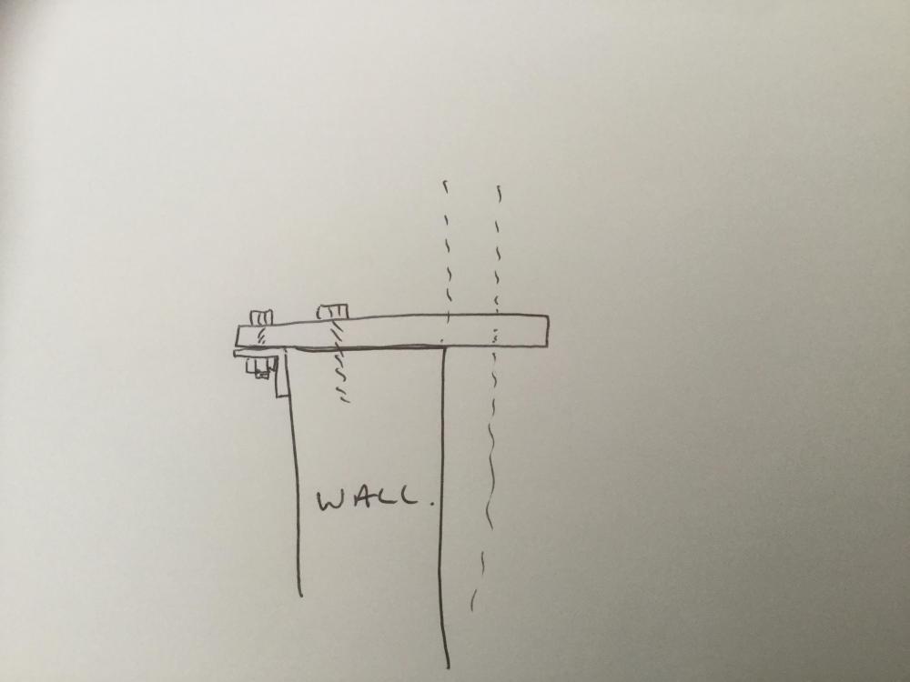

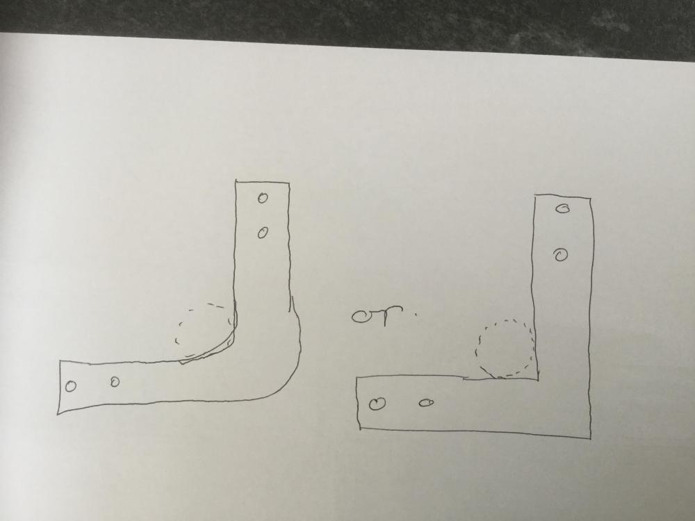

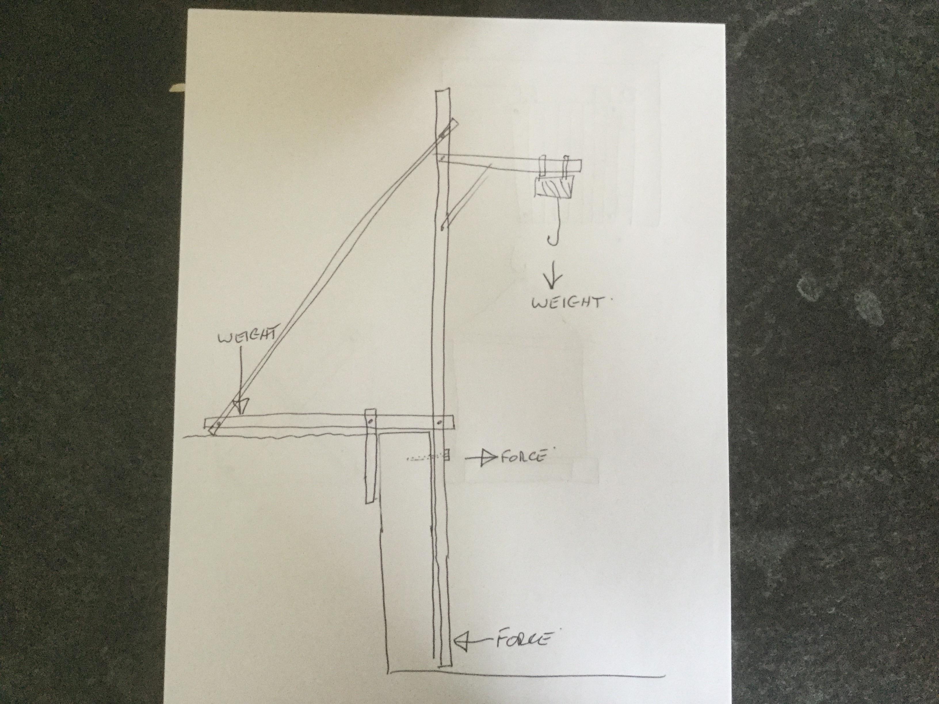

joe90 Posted July 23, 2020 Share Posted July 23, 2020 15 minutes ago, pocster said: So @joe90 the winch hanging off 1 pole with the hoist support is strong enough on it's own for 100kg? Now I am no SE but 100kg is just shy of 16stone, so a (well proportioned) person. The only weak spot IMO is the fixing of the pole to the top of the wall, this could be mitigated in two ways, 1/ another pole from top of the pole down to the other side of the basement 2/ see diagram 1 Link to comment Share on other sites More sharing options...

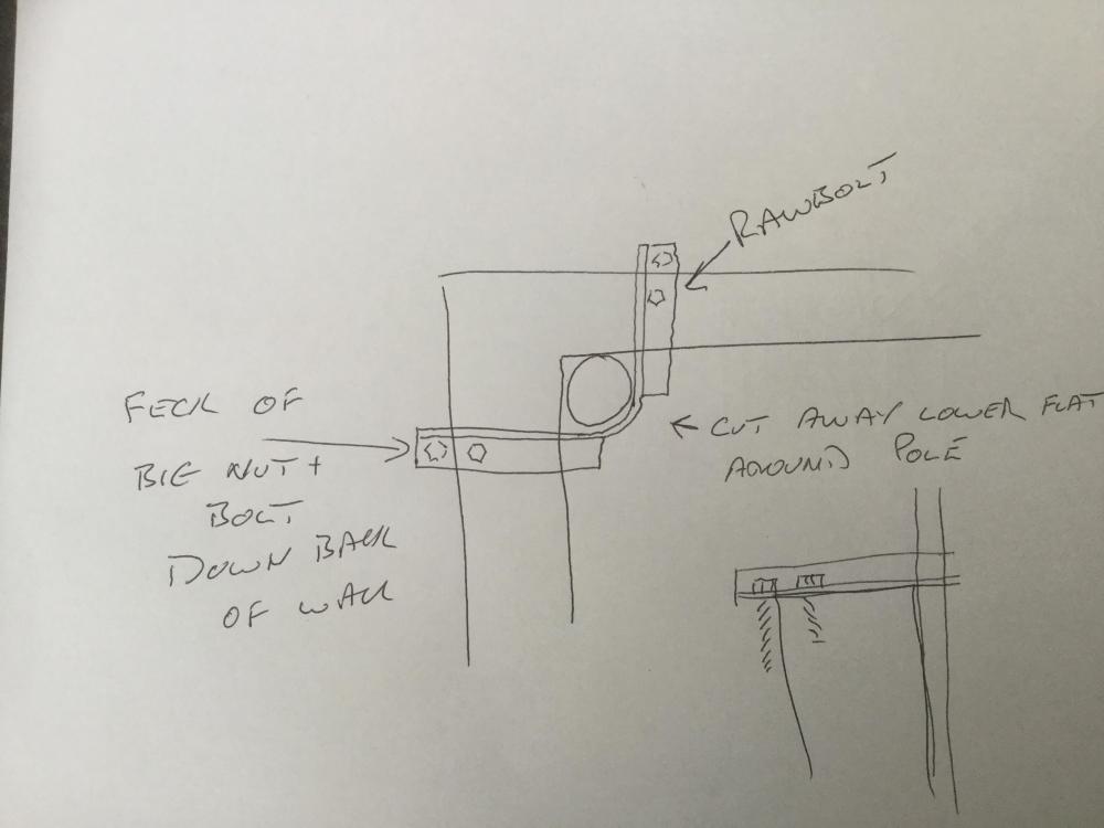

Pocster Posted July 23, 2020 Author Share Posted July 23, 2020 Another thought as I piece this together... What 'wire /chain' should I use for the platform support to hoist? - perhaps ratchet straps ?? https://www.scaffolding-direct.co.uk/ratchet-straps/ What type of fixings do I need to bolt the vertical scaf pole to the concrete walls? I'm sure there are other things I need to consider Link to comment Share on other sites More sharing options...

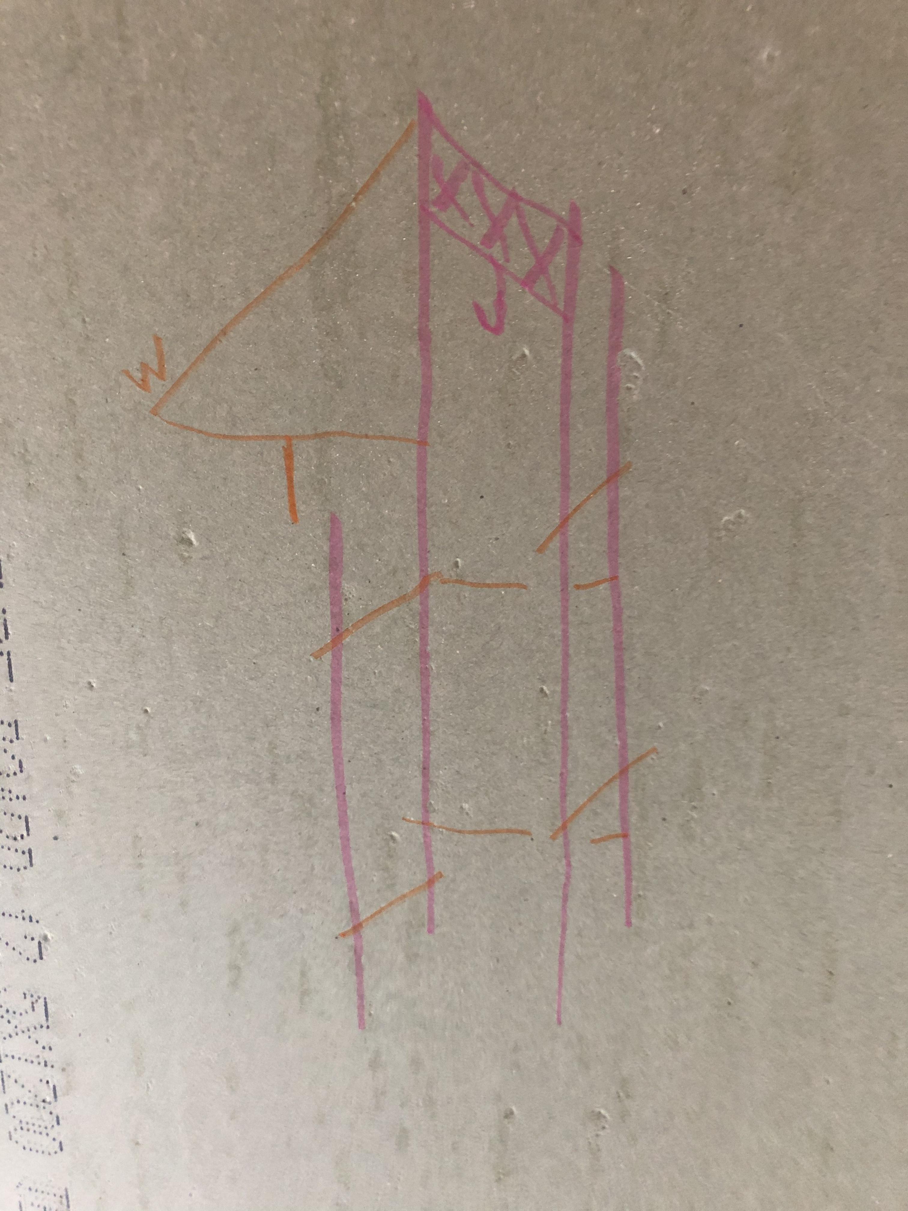

Pocster Posted July 23, 2020 Author Share Posted July 23, 2020 5 minutes ago, joe90 said: Now I am no SE but 100kg is just shy of 16stone, so a (well proportioned) person. The only weak spot IMO is the fixing of the pole to the top of the wall, this could be mitigated in two ways, 1/ another pole from top of the pole down to the other side of the basement 2/ see diagram 3 minutes ago, Onoff said: Why not just erect a quick build steel tower and use that as your "lift shaft"? Strap to the walls rather than use outriggers. Your're so off piste with this in terms of H&S and probablyy LOLER and PUWER if you have any trades using it. https://www.toptower.co.uk/classic-scaffold-tower.html?gclid=EAIaIQobChMIqpuo55zj6gIVVeDtCh0Odw8KEAYYAyABEgJgffD_BwE Not sure now what benefit that would be?. H&S just called me and said it was "deemed acceptable" . I think @joe90 plan seems a go'er .... Link to comment Share on other sites More sharing options...

joe90 Posted July 23, 2020 Share Posted July 23, 2020 ?, now I am only 9 stone but I would certainly ride that ?. There are lots that wouldn’t tho ?. Just had another thought, if that horizontal pole extended over the “platform” (pallet) a little, a long bolt in the end could locate in a hole in the platform to stop it swinging away from the wall when loading it!!! The winding mechanism has an “auto stop” to stop you winding the hook into the motor, you could rig it so this coIncides with the platform being level with the ground. (am I on commission???) 1 Link to comment Share on other sites More sharing options...
joe90 Posted July 23, 2020 Share Posted July 23, 2020 (edited) 2 minutes ago, pocster said: Yep. Still need to guard against twisting. no, being in the corner rubbing up timber verticals it cannot twist, any weight on the platform will keep it against the wall. The advantage of using scaffold clamps mean you can adjust any joints rather than drilling etc. Edited July 23, 2020 by joe90 1 Link to comment Share on other sites More sharing options...

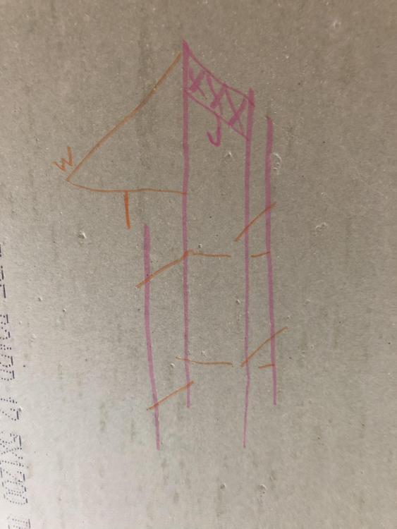

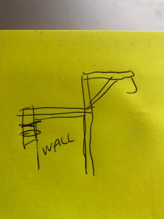

Pocster Posted July 23, 2020 Author Share Posted July 23, 2020 Ok not all verticals required . Most important ones are the corner one going to the other corner . Better strength as gantry supported at both ends - also reduces swing . Link to comment Share on other sites More sharing options...
joe90 Posted July 23, 2020 Share Posted July 23, 2020 From my experience using scaffold as a hoist I think one pole (suitably triangulated above ground) will be well able to cope with 100kg, if you load the counter weight matching platform loading . Running up a corner (on suitable vertical timbers) the platform cannot twist. If the platform is located on a bolt as suggested at the top it cannot swing during loading. stop procrastinating and get on with it ?????????? 1 Link to comment Share on other sites More sharing options...

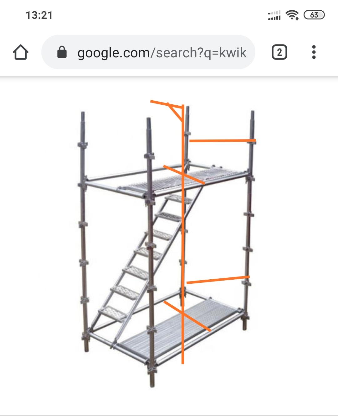

Declan52 Posted July 23, 2020 Share Posted July 23, 2020 I put up a kwikstage frame to lift both my 4.2m concrete lintels. Used a pulley block and sling attached to a standard across the top ledgers. It was easy 200kg+ in weight and the frame took it easily. You could easily use the same but connect the electric winch onto the top. Have planks across the gap and you can set your cage on them and load it with whatever is going down. Start the lift and remove the planks and lower it down. With the winch on the inside of the frame it won't tip over as all the weight is in the middle. You have diagonal bars to each corner to strengthen it all up. 1 Link to comment Share on other sites More sharing options...

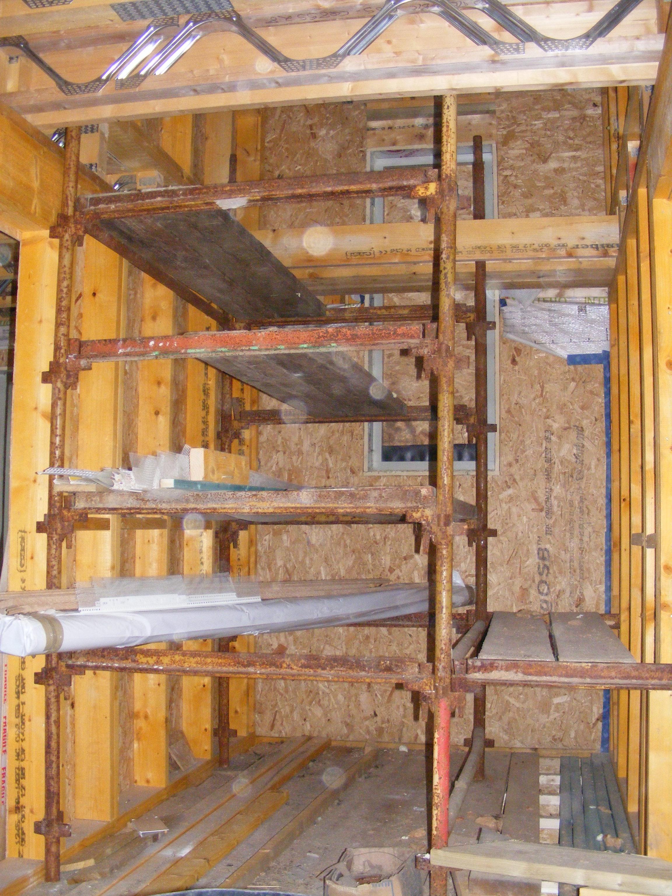

ProDave Posted July 23, 2020 Share Posted July 23, 2020 I lifted quite a lot of stuff up my scaffold stairs, a step at a time. Link to comment Share on other sites More sharing options...

Pocster Posted July 23, 2020 Author Share Posted July 23, 2020 1 hour ago, Declan52 said: I put up a kwikstage frame to lift both my 4.2m concrete lintels. Used a pulley block and sling attached to a standard across the top ledgers. It was easy 200kg+ in weight and the frame took it easily. You could easily use the same but connect the electric winch onto the top. Have planks across the gap and you can set your cage on them and load it with whatever is going down. Start the lift and remove the planks and lower it down. With the winch on the inside of the frame it won't tip over as all the weight is in the middle. You have diagonal bars to each corner to strengthen it all up. Without googling I'm guessing this is more expensive.... Link to comment Share on other sites More sharing options...
Declan52 Posted July 23, 2020 Share Posted July 23, 2020 23 minutes ago, pocster said: Without googling I'm guessing this is more expensive.... Under 20 bars of scaffold would be cheap, £50 to a local scaffolding company . 5 mins to put in place and take away. Can be stored in a fairly narrow gap. The frame is much more important than a fancy winch. It's what will take the weight. 2 Link to comment Share on other sites More sharing options...
