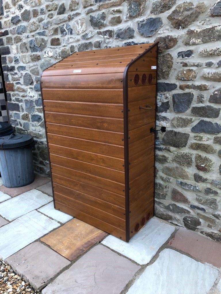

Temp Posted July 21, 2020 Posted July 21, 2020 We use a metal gas cylinder store. They come in different colours, typically grey and green. They can be a bit expensive for what they are but hide your cylinders well. Main thing I've discovered is that some 47kg cylinders are taller than others and the roof on my store is a bit low. It can be a job wrestling the cylinder into it. Helps if you have long hoses so you can connect up the cylinder outside the store.

Temp Posted July 22, 2020 Posted July 22, 2020 Range of cylinder stores.. https://www.smartfabcovers.co.uk/shop/gas-bottle-pods/gas-bottle-pods/ 1
