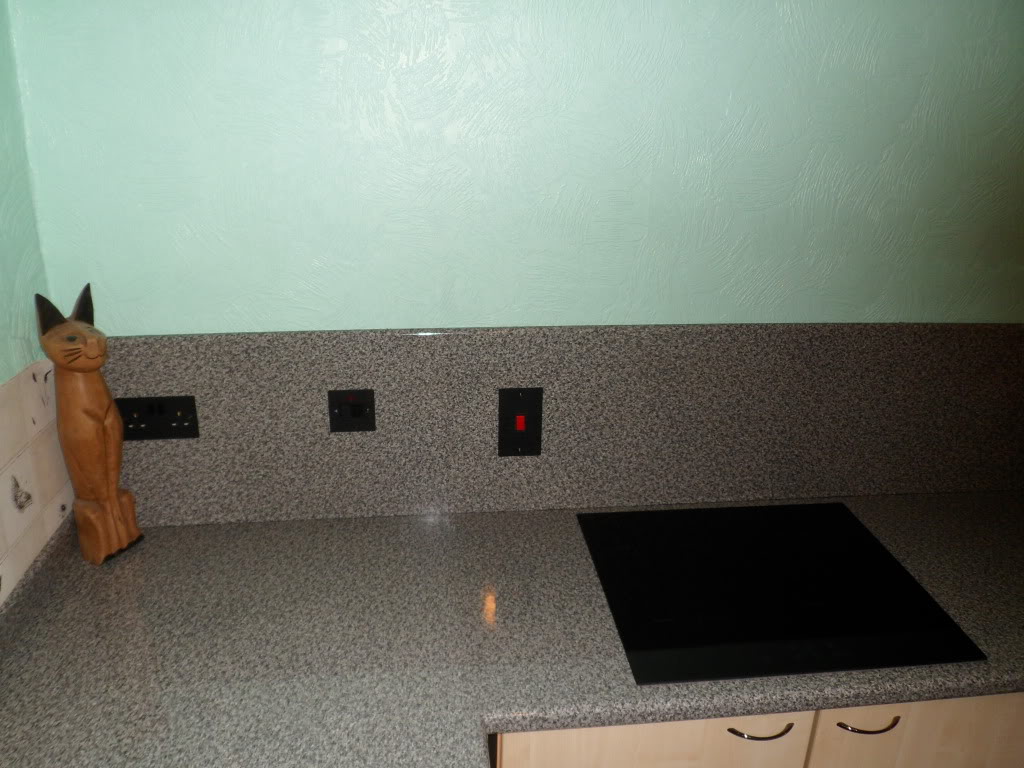

Onoff Posted December 23, 2016 Posted December 23, 2016 If you're desperate you can join worktops pretty much invisibly. The pattern helps greatly and this "granular" one was hugely forgiving. The key is to use the router to cleanly and sharply edge the abutting ends / faces. The cat in the photo is sitting on a 400mm wide piece grafted to the stock 600mm worktop over a 3m length.

Onoff Posted December 23, 2016 Posted December 23, 2016 The more "speckly" the finish the easier it is to hide the join. You need to factor in the cost of a bit too. Depends how handy you are with the router? On that score the bigger, better the router, the better balanced it is. The big, heavy 110V DeWalt I have on semi-permanent loan is so much more superior anything else I've used. When I cut an "edge" I: - Support on trestles - Masking tape the cut line - Mark a line 3mm off the cut line and jig saw to that - Clamp a straight edge and cut to the cut line in 3 or 4 passes, increasing the depth each time I use the router for pretty much everything, cutting / edging Contiboard, holes for hobs etc @Construction Channel I'm sure could do a video!

Onoff Posted December 24, 2016 Posted December 24, 2016 I did say if desperate! My local Wickes has had in the past an area where they sell off cheap, broken and chipped 3m tops. If delivery is what £39 then get a long one. As forgiving as my pattern is the join is noticable to the touch with a finger tip. The bit that came out barely OK and needed filling and speckling with a black Sharpie were the mitres on the breakfast bar I made. Of course there is the fact I'm not known for taking the easy route...
