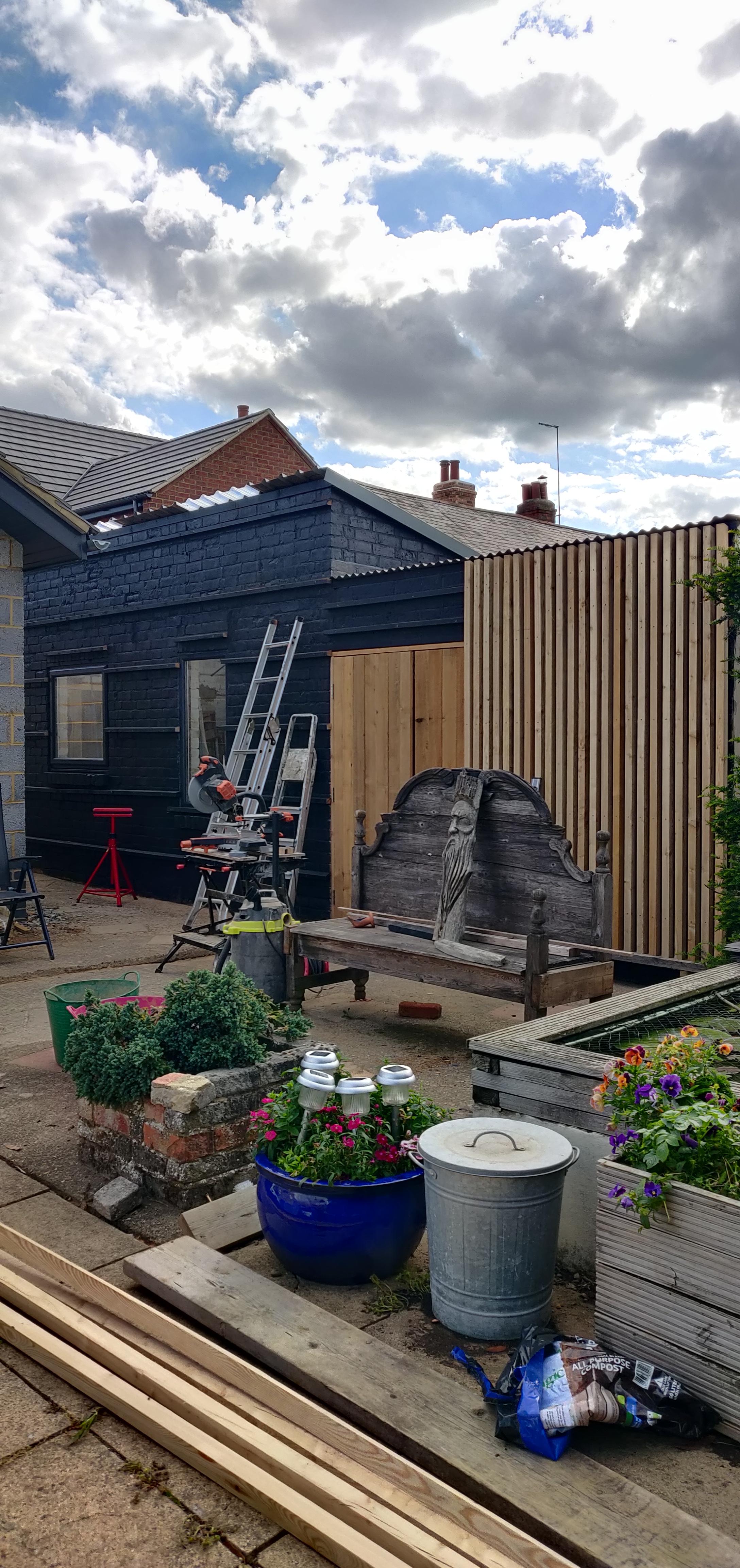

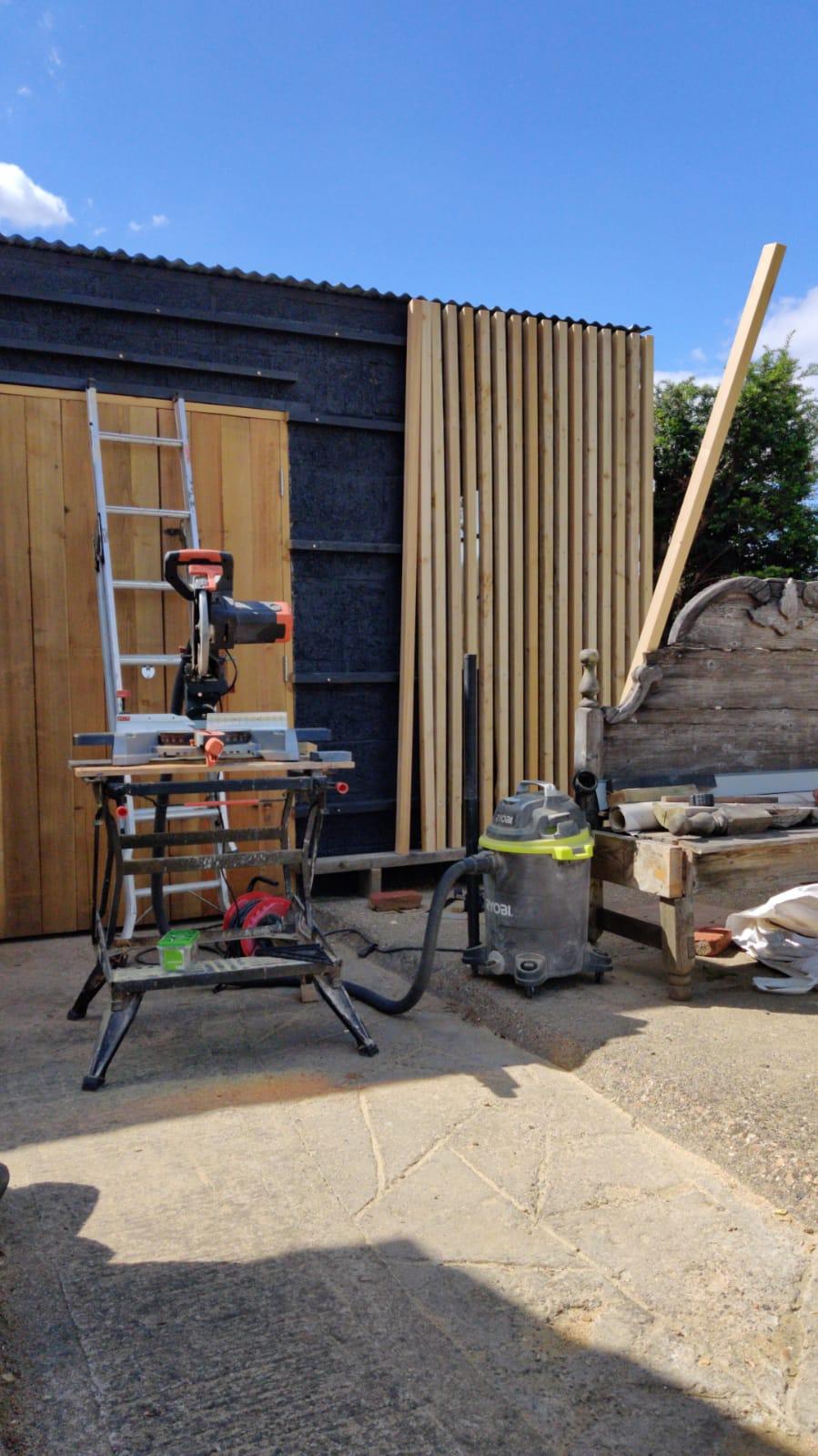

GaryM Posted July 19, 2020 Author Share Posted July 19, 2020 Well I've made a start on the sheds, i'm just using horizontal battens on the sheds and no membrane, but it's on brick and there is a lot of gaps for air to circulate Link to comment Share on other sites More sharing options...

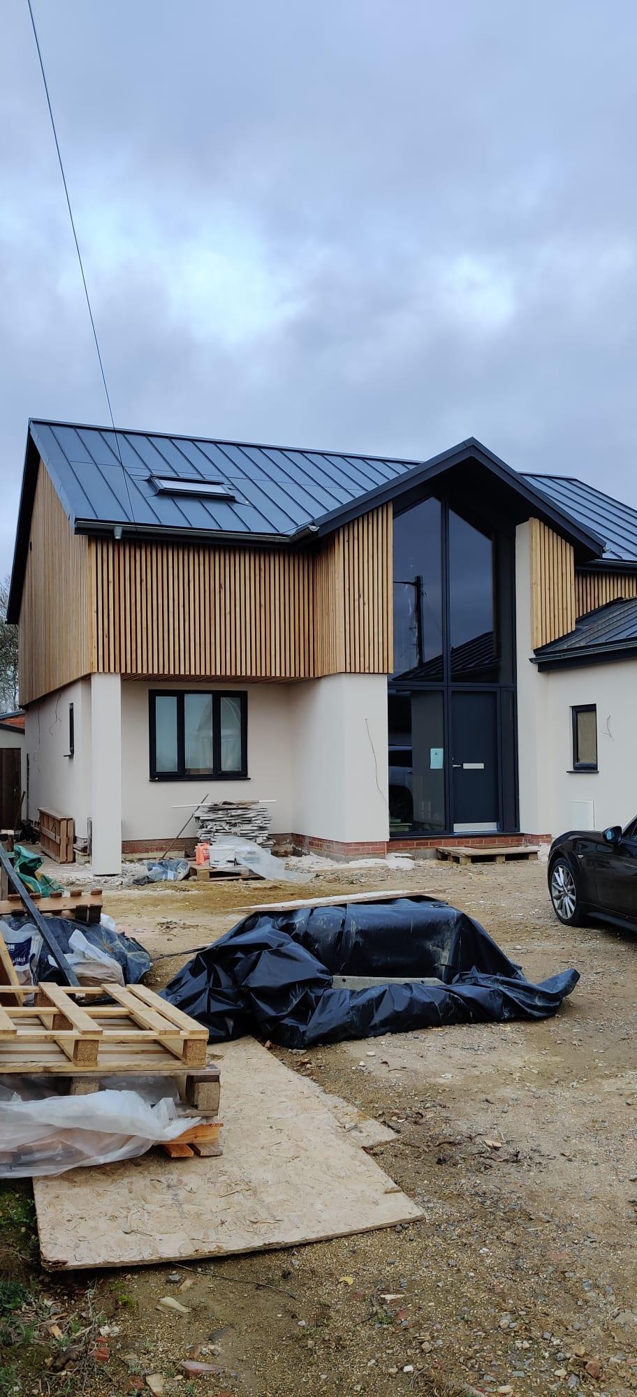

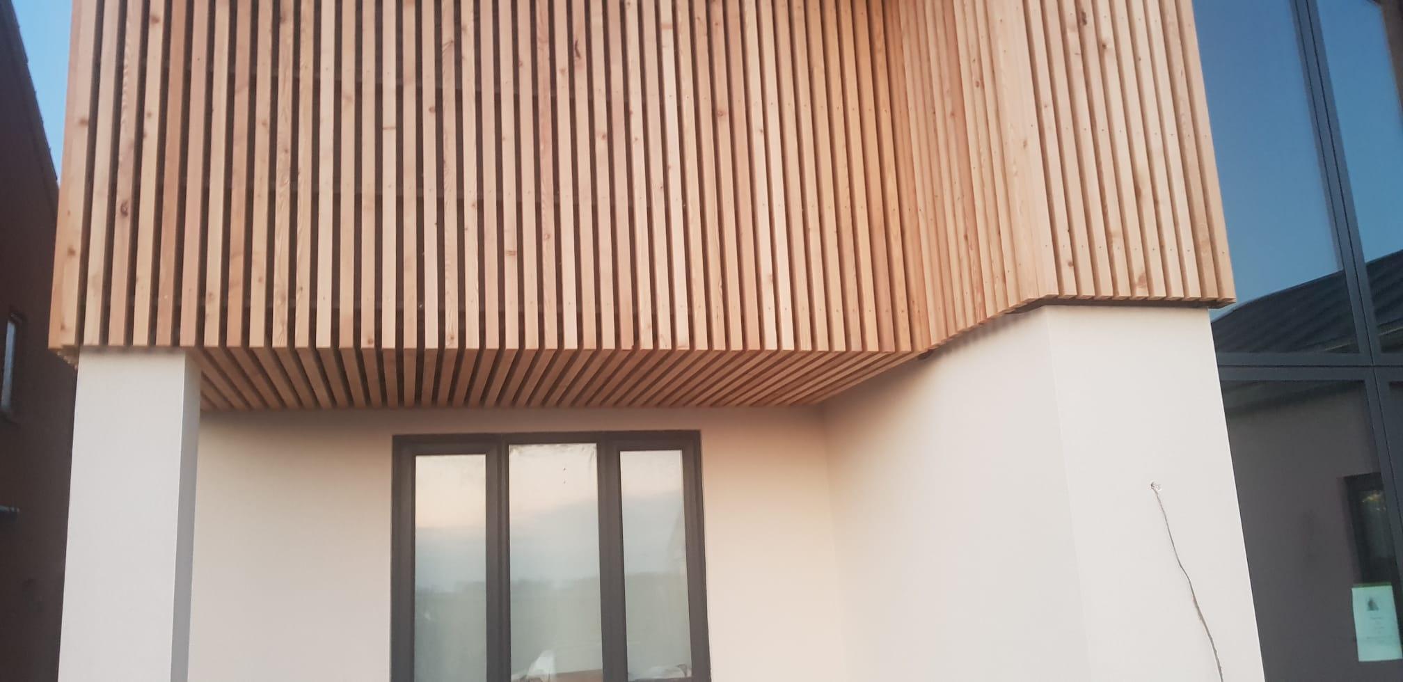

GaryM Posted November 5, 2021 Author Share Posted November 5, 2021 Well it has been some time since I posted about the cladding, well finally we are making progress. Attached is the latest photo 2 Link to comment Share on other sites More sharing options...

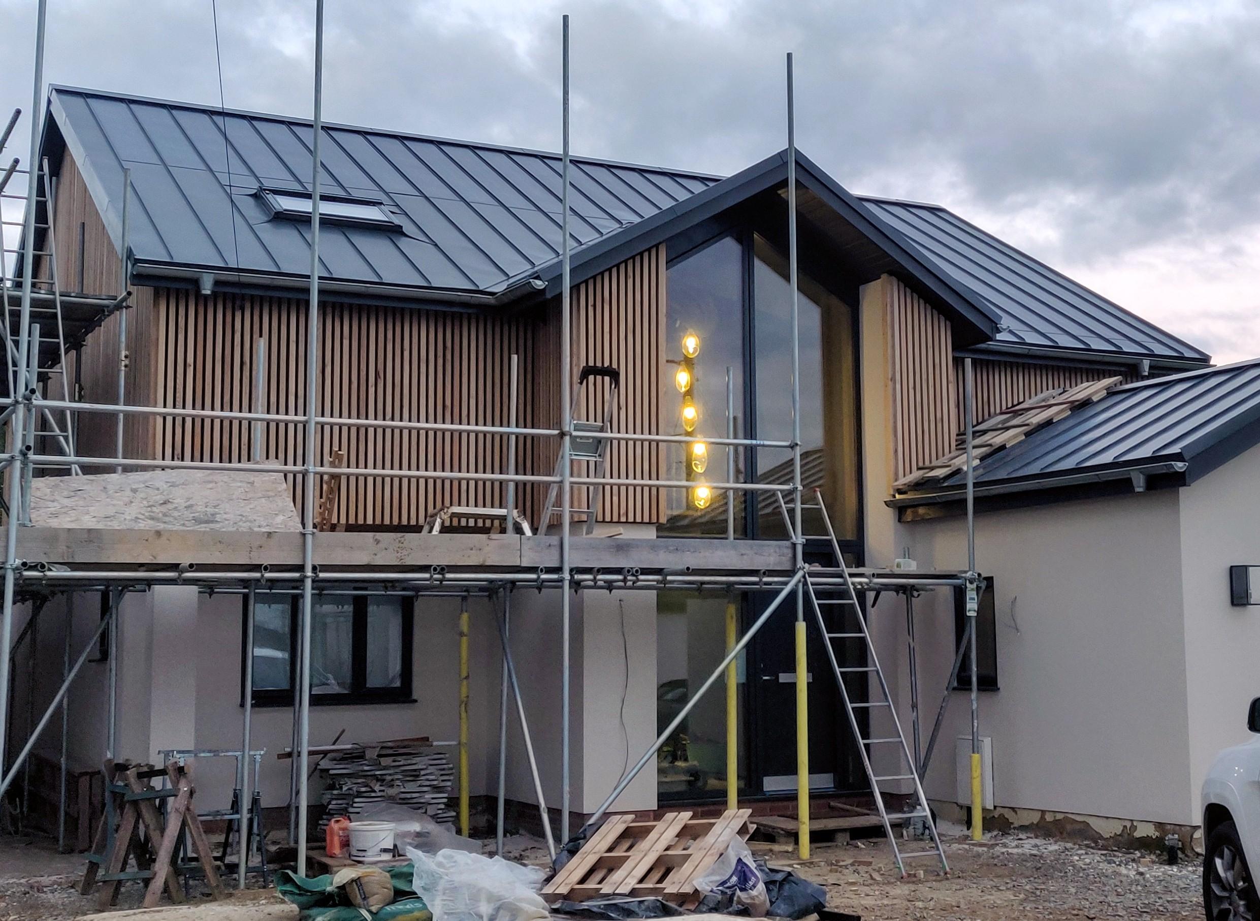

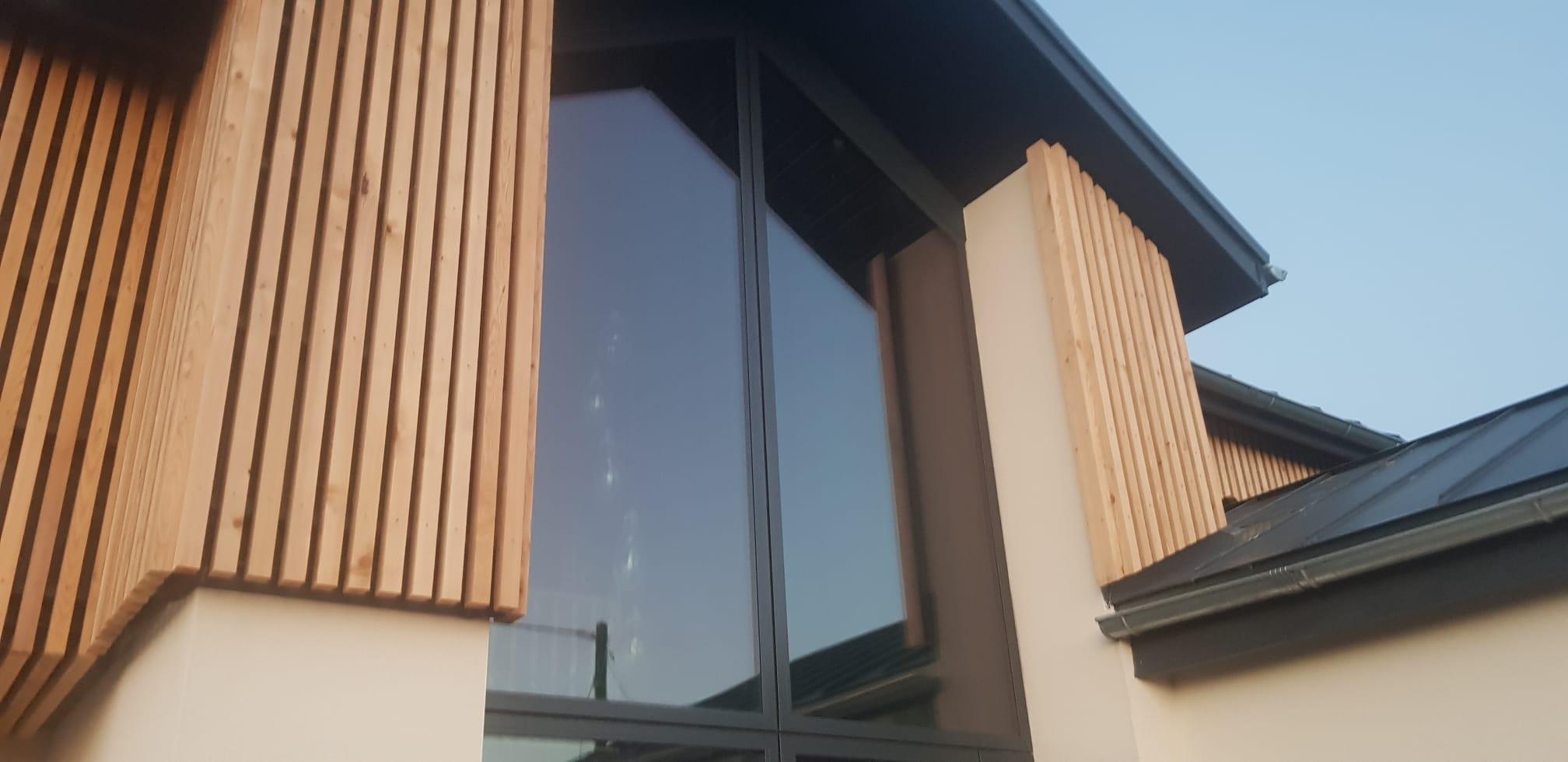

GaryM Posted November 25, 2021 Author Share Posted November 25, 2021 The cladding now with the scaffold down. I am really ok pleased with the look of it. 2 Link to comment Share on other sites More sharing options...
Mr Punter Posted November 25, 2021 Share Posted November 25, 2021 That is a great finish. It looks very like your original image. Did you join the ends where the vertical meets the soffit? A couple of points: I heard that with some of the ventilated cladding insects are not an issue as they don't like the constant breeze from the chimney effect. We have used Tyvek UV Facade membrane in the past and it seems very strong and does not look vulnerable to insect damage. Link to comment Share on other sites More sharing options...
Thorfun Posted November 25, 2021 Share Posted November 25, 2021 @GaryM looks great! 3 hours ago, Mr Punter said: That is a great finish. It looks very like your original image. Did you join the ends where the vertical meets the soffit? A couple of points: I heard that with some of the ventilated cladding insects are not an issue as they don't like the constant breeze from the chimney effect. We have used Tyvek UV Facade membrane in the past and it seems very strong and does not look vulnerable to insect damage. we were originally planning to do as @GaryM did and had the black Tyvek UV Facade membrane put on so we didn't see the usual silver through the open cladding but after much deliberation and the thought of painting over 1km of battens black so they wouldn't be visible behind the charred timber cladding we decided to simply go for a tongue-and-groove type shadow gap profile like this. that way we didn't have to worry about a load of insect mesh as well as all the other stuff! Link to comment Share on other sites More sharing options...

GaryM Posted November 26, 2021 Author Share Posted November 26, 2021 19 hours ago, Mr Punter said: That is a great finish. It looks very like your original image. Did you join the ends where the vertical meets the soffit? A couple of points: I heard that with some of the ventilated cladding insects are not an issue as they don't like the constant breeze from the chimney effect. We have used Tyvek UV Facade membrane in the past and it seems very strong and does not look vulnerable to insect damage. Thanks for the comment. We put horizontal battens close to the top and bottom to help reduce any warping, the bottom one really helps clean up the look. We used a UV membrane by powerlon designed for open joint cladding Link to comment Share on other sites More sharing options...

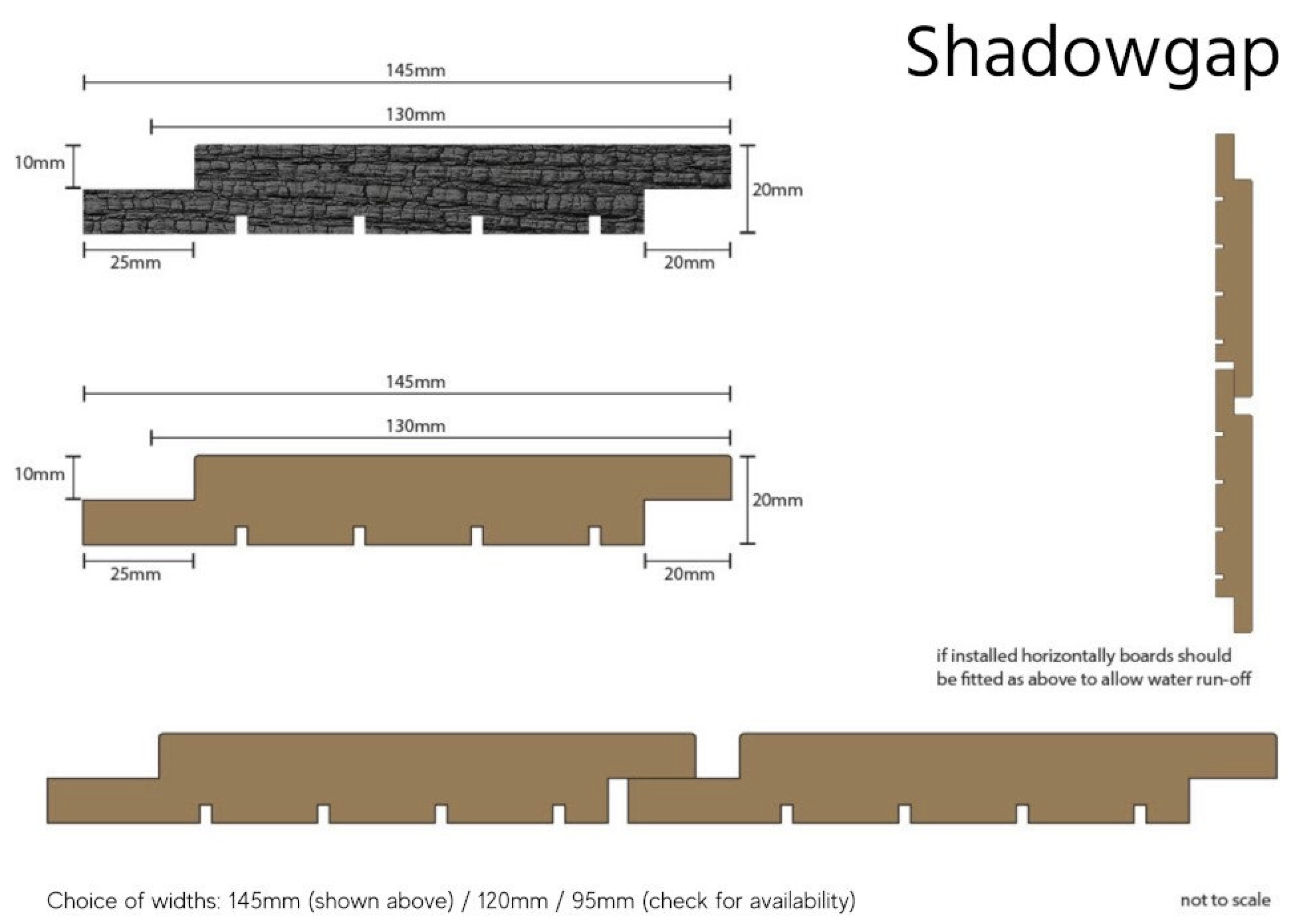

GaryM Posted November 26, 2021 Author Share Posted November 26, 2021 16 hours ago, Thorfun said: @GaryM looks great! we were originally planning to do as @GaryM did and had the black Tyvek UV Facade membrane put on so we didn't see the usual silver through the open cladding but after much deliberation and the thought of painting over 1km of battens black so they wouldn't be visible behind the charred timber cladding we decided to simply go for a tongue-and-groove type shadow gap profile like this. that way we didn't have to worry about a load of insect mesh as well as all the other stuff! I thought of using the shadow gap cladding, it can look good, but I just loved the look of the battens. We did discuss the insect mesh with the building inspector and it was decided we didn't need it. I wouldn't want to paint over 1km of timber, I think we ( ha, l) just did the vertical and cross battens around a mere 400m :-). It took some time, but pleased with the results, now to see how well it lasts 1 Link to comment Share on other sites More sharing options...
Dave Jones Posted November 26, 2021 Share Posted November 26, 2021 looks really good, shame about the render though. A nice brick with a plinth would have looked stunning. Link to comment Share on other sites More sharing options...
AliG Posted December 19, 2021 Share Posted December 19, 2021 Hi @Thorfun This shadow gap cladding looks interesting, who is the supplier? Can you get this kind of cladding which has extra grooves in it so that it looks like narrower pieces of cladding? Looking at issues with black membrane, insect screen, black battens etc this seems to help out with many issues. Link to comment Share on other sites More sharing options...
Thorfun Posted December 19, 2021 Share Posted December 19, 2021 1 hour ago, AliG said: Hi @Thorfun This shadow gap cladding looks interesting, who is the supplier? Can you get this kind of cladding which has extra grooves in it so that it looks like narrower pieces of cladding? Looking at issues with black membrane, insect screen, black battens etc this seems to help out with many issues. even though I haven't ordered our cladding yet I have had quotes and believe that my chosen supplier will be Permachar (https://permachar.co.uk/product/charred-timber-cladding-deep-char/). I'll be looking to order early in the new year. But the shadow gap profile is pretty standard with most timber cladding suppliers tbh so if you have a cladding supplier of choice then they'll probably do it. I'm also sure you can get the profiles with extra grooves but I don't think Permachar do that. but there are many other suppliers that might! 1 Link to comment Share on other sites More sharing options...
GaryM Posted January 16, 2022 Author Share Posted January 16, 2022 (edited) On 26/11/2021 at 16:16, Dave Jones said: looks really good, shame about the render though. A nice brick with a plinth would have looked stunning. Cheers mate the render cost more than the cladding Edited January 16, 2022 by GaryM Link to comment Share on other sites More sharing options...
