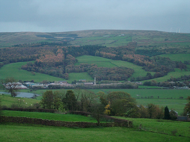

Having done exactly this because of my brick-obsessed dad, (and given the sensible approaches above) I'd say make sure you get the right clay: it's critical you get that right.
'.... bottom of the pond....' WILL fail.
Go and beg 50Kg of clay from your local  brick company : this is ours (Claughton)
the source is the 'smudge' in the hillside, and the line through the trees is the aerial rope-way laden with buckets down to the factory
When you get the clay 'work' it thoroughly with your hands, get rid of every bit of 'rubbish' and pack and stack your forms under pressure for a few hours before firing. Vibrate the forms if you can (get rid of as much air as you can). Your local clay may well be different. Good excuse to visit pubs and ask if any locals have experience with local brick making.
The satisfaction of making your own brick is immense. Good luck.

:( OK ill try and find out where the original bricks clay was dug from,
 If that fails ill just have to go to the Brick company and ask ( I do like the idea of digging it out of the ground though)
I am goint to make a few just in case so i might make one out of pond clay just to see what happens ;)
