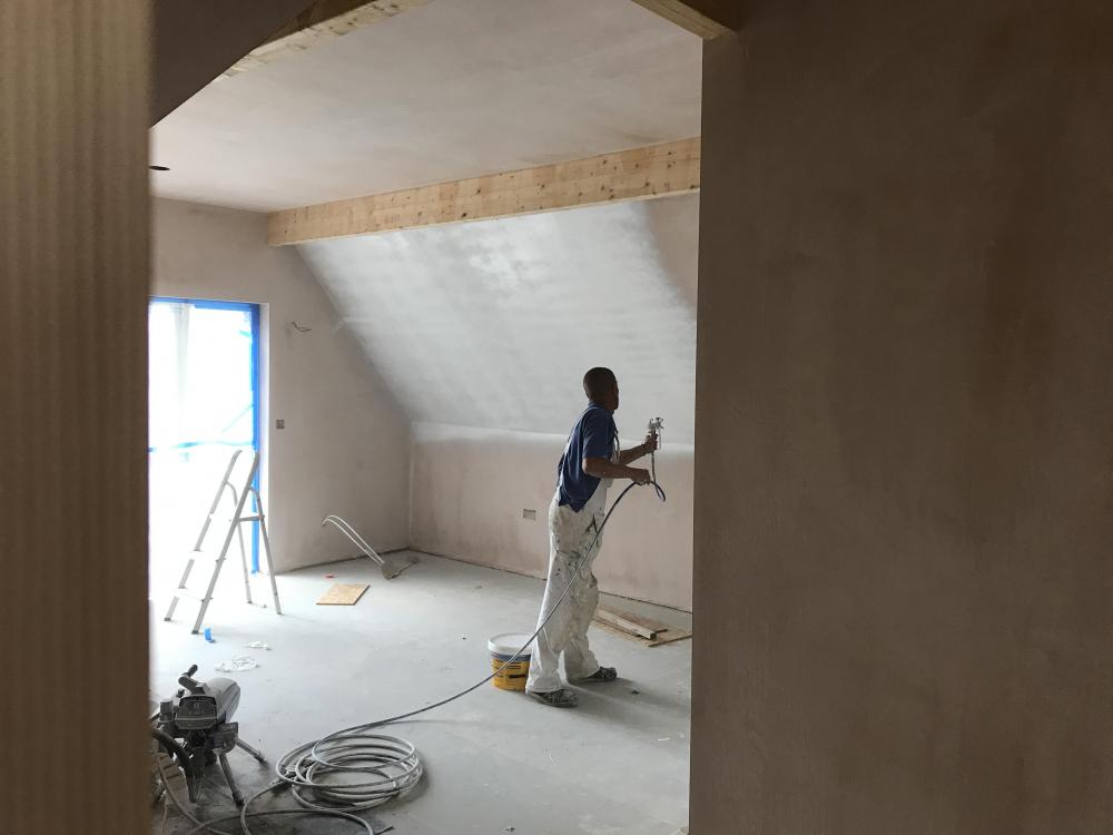

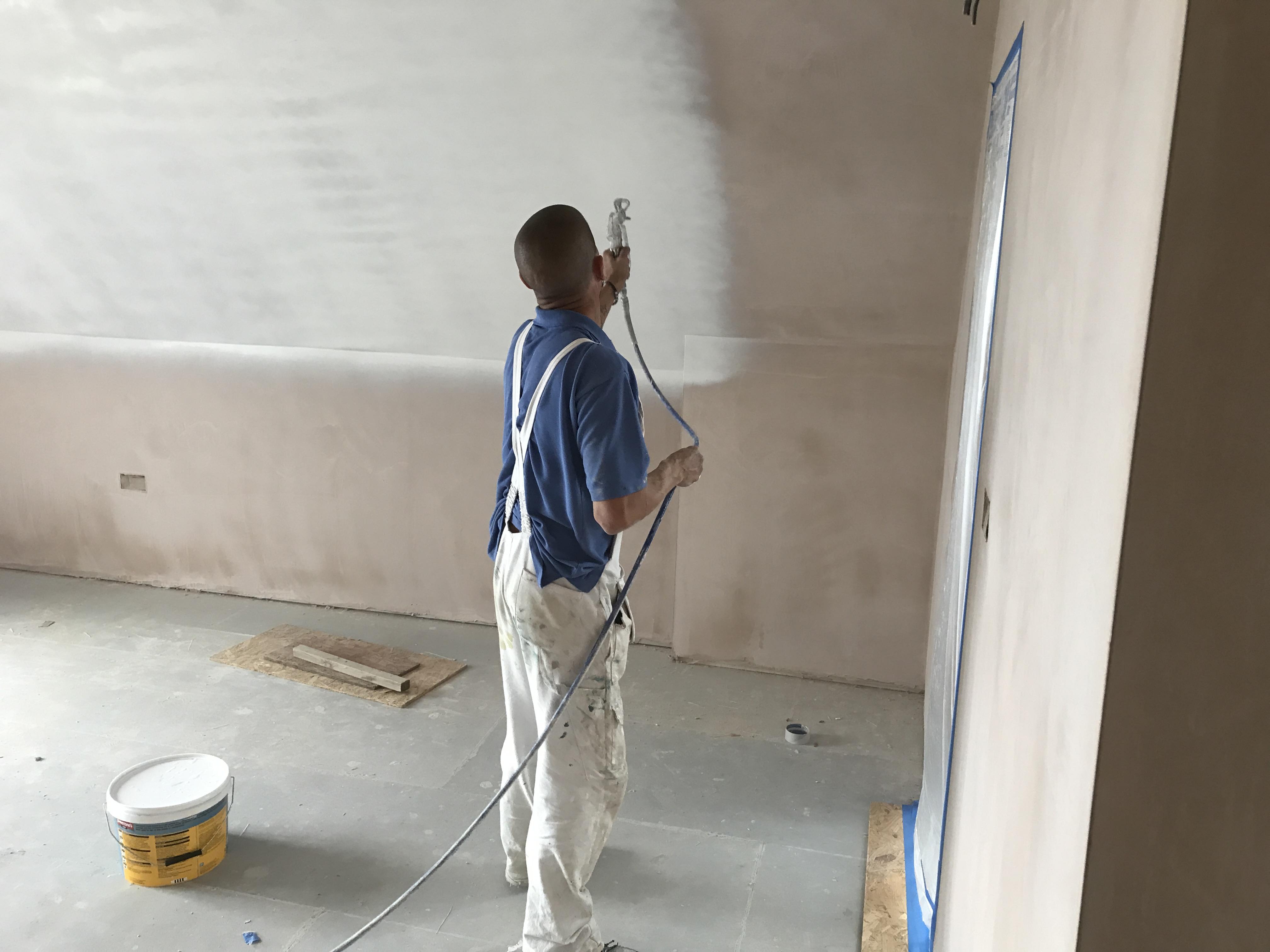

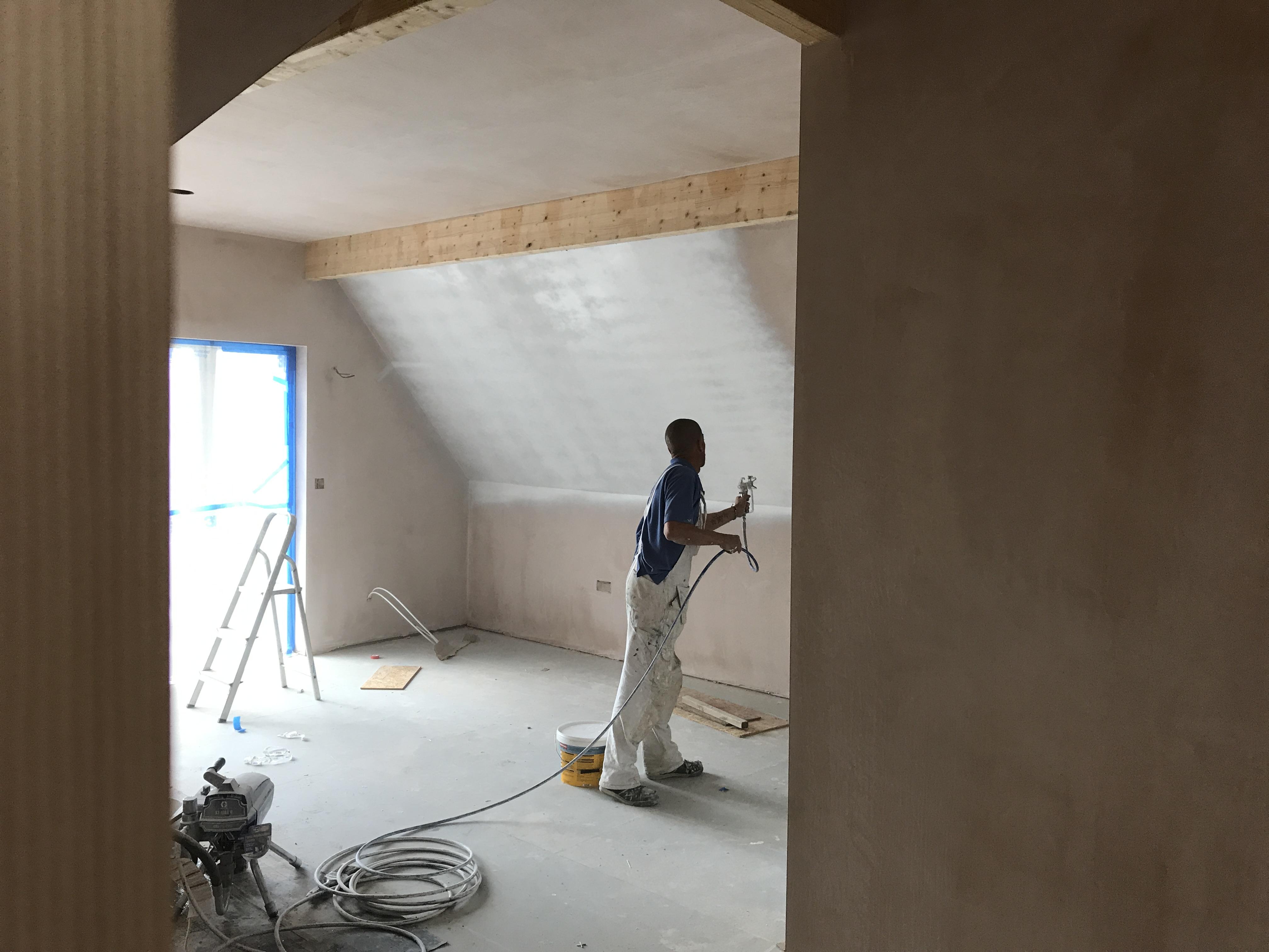

RandAbuild Posted June 24, 2020 Posted June 24, 2020 Here's our guy spraying a mist coat in the bedroom. Byt the time the top coat went on, it was like a white-out - I couldn't focus my eyes becuase there was nothing to focus on. 1

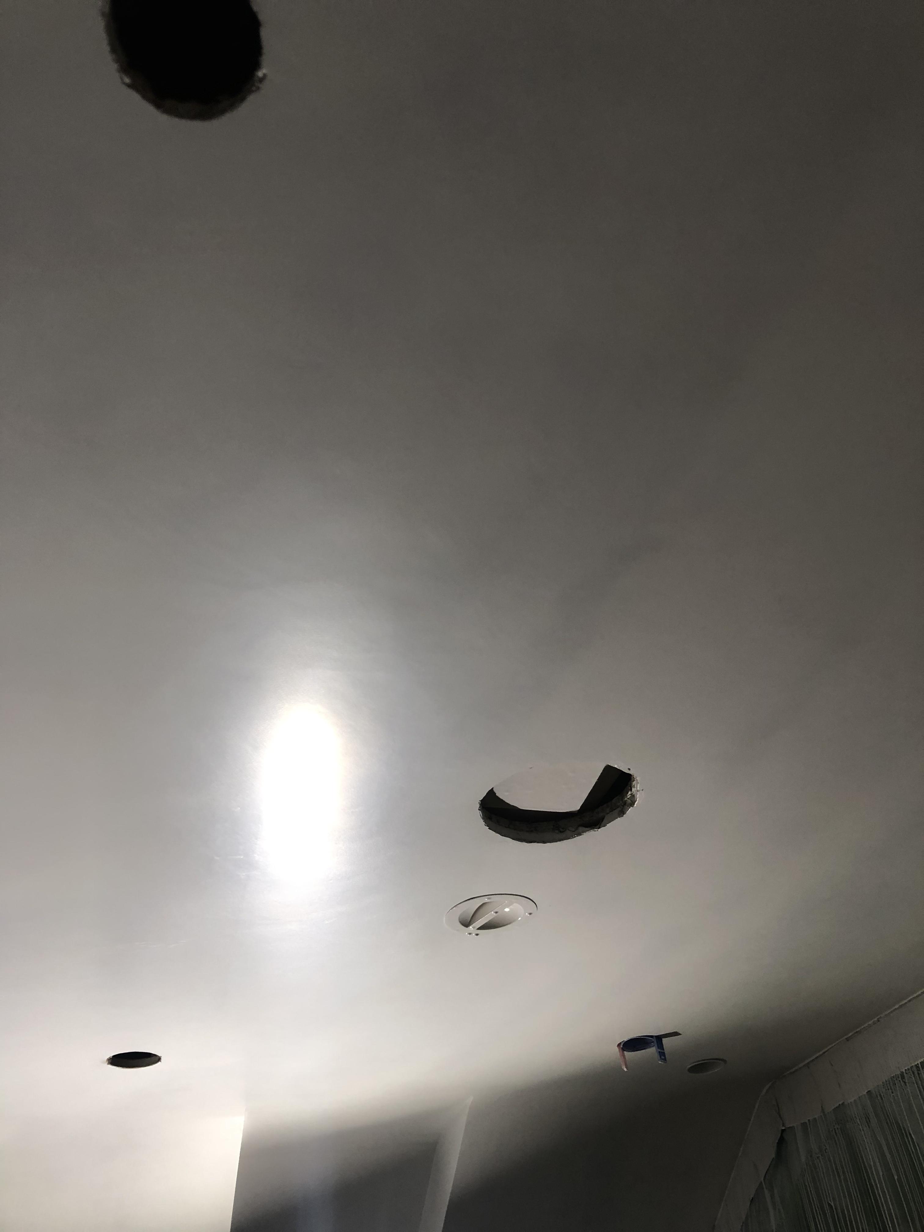

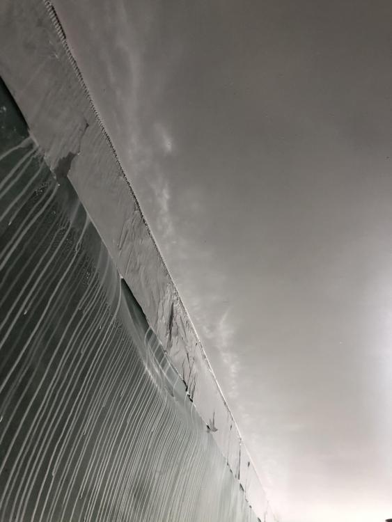

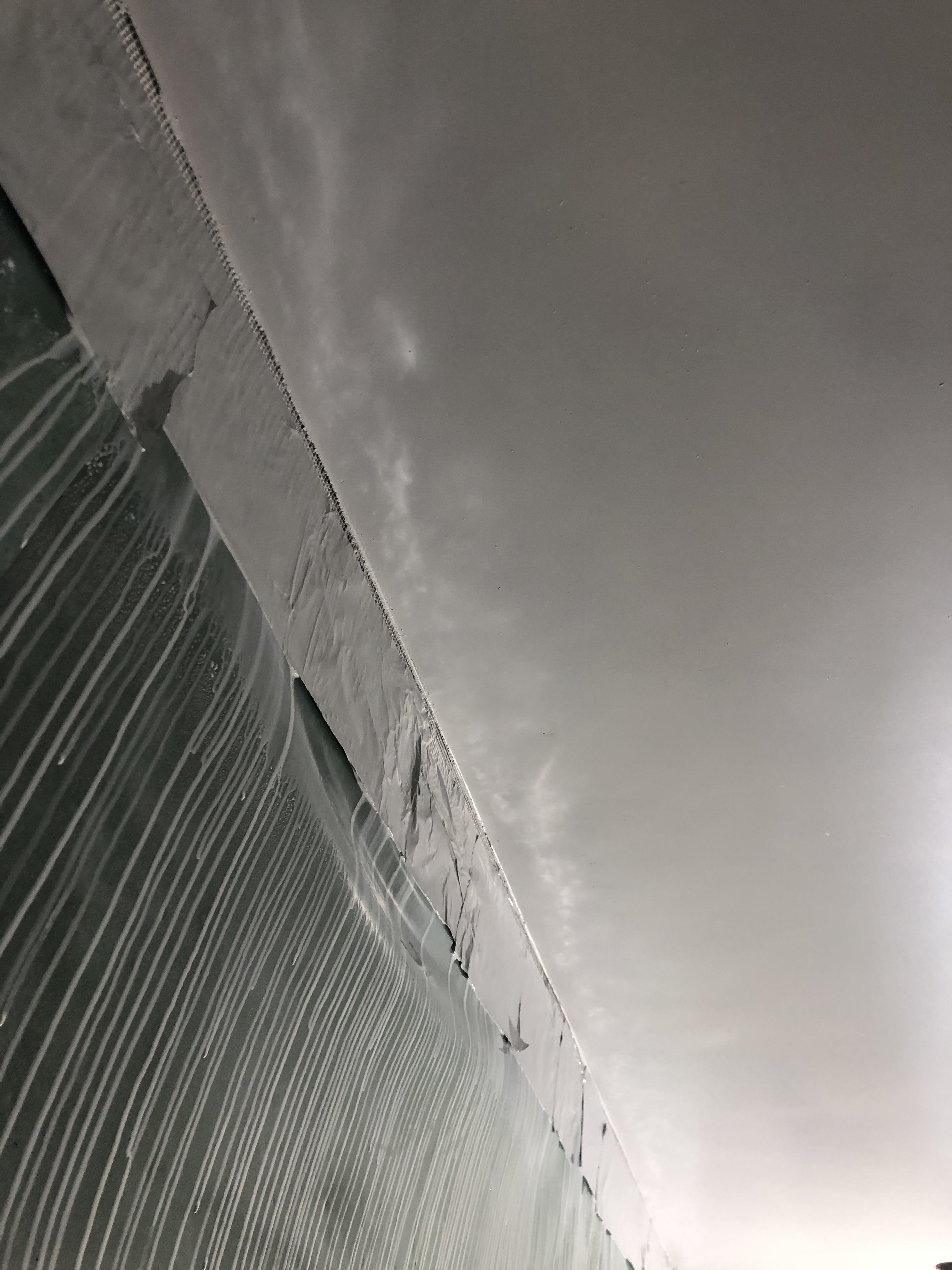

Pocster Posted June 30, 2020 Author Posted June 30, 2020 (edited) @Thorfun want to buy a sprayer ?? Jesus ! The mess !! Firstly the paint I choose was surprisingly thin so I added a bit of water as new plaster . Mixed mechanically for 10 mins . What came out of the sprayer was more water than paint . Anyway plaster got a water coat .... Added more paint and mixed .Proper coating now . Some observations though I blocked some of my ceiling holes with projecting bits to hold circle in place . Bad idea as it caused the spray to pattern as it hit them . Removed them . Edges seem to be an issue as paint splatters off walls and onto the ceiling . You can see the edges have a ‘dimple’ effect . Hope that dries out . i then ran out of paint before even getting to the ensuite . The main finish looks good . If anything it shows up plasterers imperfections !! But the mess ! I mean on me not the bloody machine !!! I’ll take advice on the edges . Might 2nd coat it when dry ( and have more paint ) Photos of fun Actually it might be the silver foil I used playing tricks with my eyes . Even though it’s painted out I think it’s still reflecting . Have to admit that was not enjoyable ! 5 hours of cleaning now !! Ffs Edited June 30, 2020 by pocster 1
Pocster Posted June 30, 2020 Author Posted June 30, 2020 20 minutes ago, Thorfun said: it does look good though. good job! (expletive deleted) me ! Though ! I’m still tidying up ! I had a bucket of painty water with the filter in soaking . Forgot about it and tipped the lot straight down the man hole ???? 1
