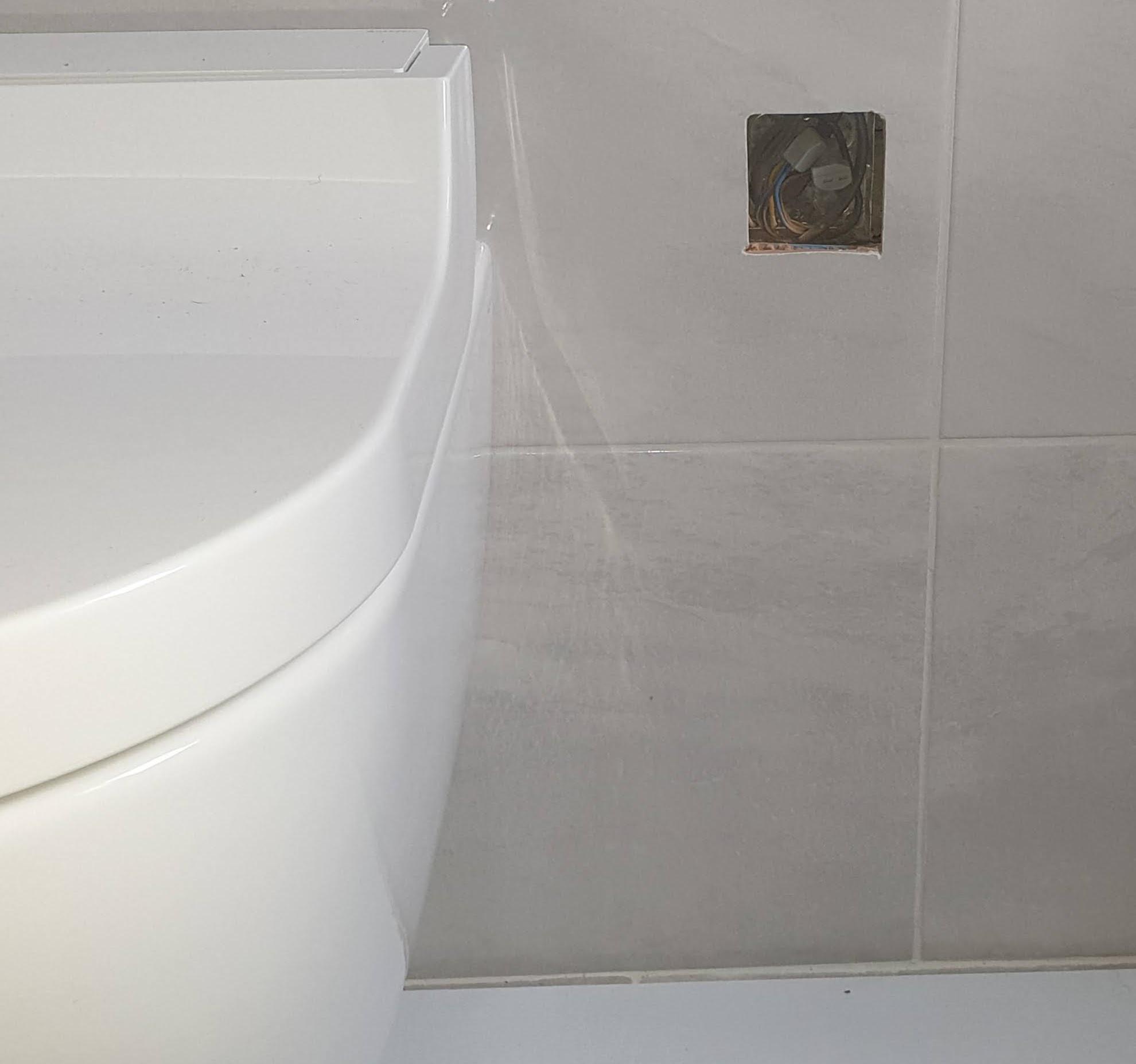

ToughButterCup Posted June 19, 2020 Share Posted June 19, 2020 I blame myself. Even though I had told the tiler not to cut this hole ....... How on earth do I fill it up / camouflage it elegantly? Link to comment Share on other sites More sharing options...
Onoff Posted June 19, 2020 Share Posted June 19, 2020 Got a pic taken further back? Bespoke stainless bog roll holder? Just a flat plate with a capped tube welded on & sticking out. Stick it on the tiles. A Quinetic switch and use as a disabled call button? Ash tray? A bit of walk on glass to forever remind you of you & @pocster's mistake... 2 Link to comment Share on other sites More sharing options...

Pocster Posted June 19, 2020 Share Posted June 19, 2020 59 minutes ago, ToughButterCup said: I blame myself. Even though I had told the tiler not to cut this hole ....... How on earth do I fill it up / camouflage it elegantly? What was it intended for ? BTW my glazing will certainly cover it Link to comment Share on other sites More sharing options...
ToughButterCup Posted June 19, 2020 Author Share Posted June 19, 2020 ... intended for ... ? A small Euromodule light. But I was persuaded to change the layout of the shower: and now the lighting point is directly in line with the shower flow .... ? I did ask the tiler no to cut a hole there. 1 Link to comment Share on other sites More sharing options...
PeterW Posted June 19, 2020 Share Posted June 19, 2020 9 minutes ago, ToughButterCup said: ... intended for ... ? A small Euromodule light. But I was persuaded to change the layout of the shower: and now the lighting point is directly in line with the shower flow .... ? I did ask the tiler no to cut a hole there. If the light is IP65 then i would put it in regardless 1 Link to comment Share on other sites More sharing options...
Temp Posted June 19, 2020 Share Posted June 19, 2020 Got a spare tile? I'd have the loo out and replace it. 1 Link to comment Share on other sites More sharing options...
Onoff Posted June 19, 2020 Share Posted June 19, 2020 A night light type thing seems to be right for that hole tbh. 1 Link to comment Share on other sites More sharing options...
MikeSharp01 Posted June 19, 2020 Share Posted June 19, 2020 Did the tiler keep the outcut - why not just grout it back in and call it a talking point Link to comment Share on other sites More sharing options...

joe90 Posted June 19, 2020 Share Posted June 19, 2020 Ask the tiler to replace the tile as you told him not to cut it!. However, as you have cable there are you not liable to have access to it (new build electrics not allowed to have hidden joins so I am told). Link to comment Share on other sites More sharing options...
Onoff Posted June 19, 2020 Share Posted June 19, 2020 (edited) 2 minutes ago, joe90 said: Ask the tiler to replace the tile as you told him not to cut it!. However, as you have cable there are you not liable to have access to it (new build electrics not allowed to have hidden joins so I am told). The WAGO blocks are considered maintenance free. The bigger issue is if someone decides to drill into that wall later and there's nothing to say there's a bunch of wires there. In that case back to a blanking plate or obvious electrical accessory (light). Edited June 19, 2020 by Onoff Link to comment Share on other sites More sharing options...
ToughButterCup Posted June 19, 2020 Author Share Posted June 19, 2020 10 minutes ago, Onoff said: ... In that case back to a blanking plate or obvious electrical accessory (light). a blanking plate is ... I have TLCs catalogue open in front of me and cant find one - even in the Bits and Bobs section Online though , is this what you mean? Presumably if I decide to do that, then it'll need to be sealed with something like CT1 maybe? Link to comment Share on other sites More sharing options...
PeterW Posted June 19, 2020 Share Posted June 19, 2020 https://www.tlc-direct.co.uk/Products/SF8350BC.html 1 Link to comment Share on other sites More sharing options...
Onoff Posted June 19, 2020 Share Posted June 19, 2020 2 minutes ago, ToughButterCup said: a blanking plate is ... I have TLCs catalogue open in front of me and cant find one - even in the Bits and Bobs section Online though , is this what you mean? Presumably if I decide to do that, then it'll need to be sealed with something like CT1 maybe? Just a good quality clear silicone in case you ever need to get it off. Nothing that sticks like sh... Link to comment Share on other sites More sharing options...
