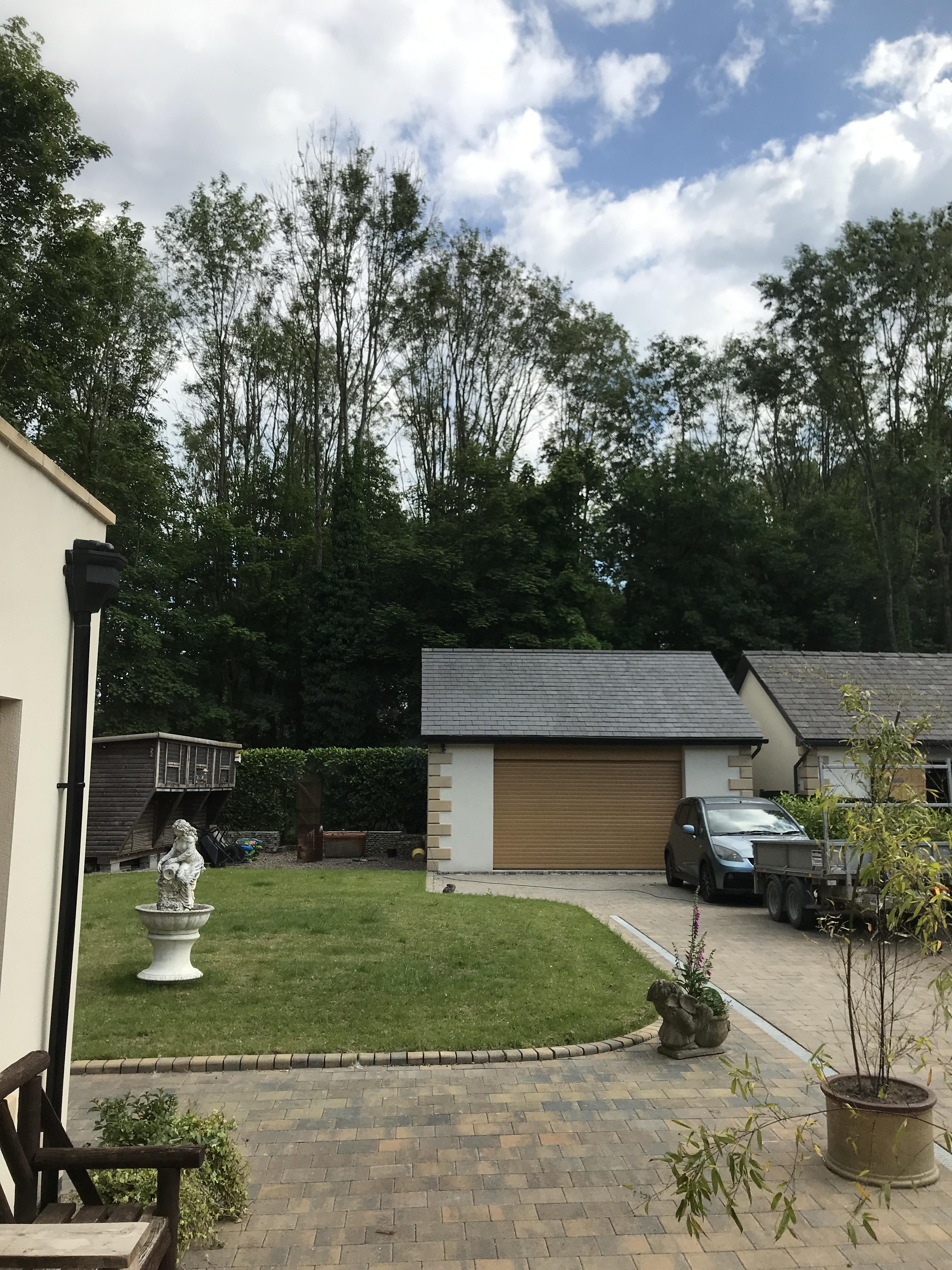

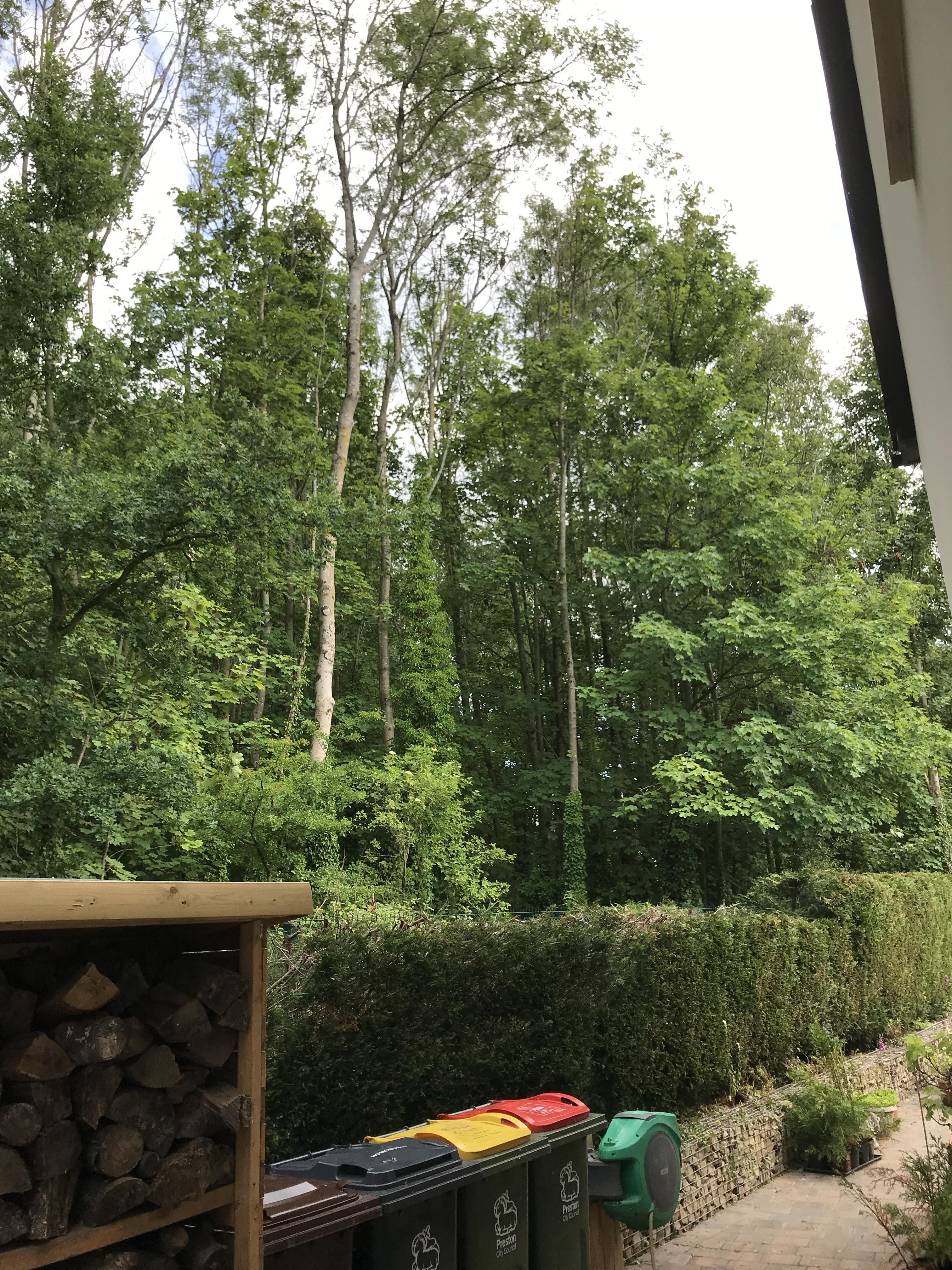

nod Posted June 14, 2020 Author Posted June 14, 2020 I’ve just cut Two 5 mtre tree down and cut them into wood burning size off one sharpen as John points out the ivy is the main culprit still a few to go
scottishjohn Posted June 14, 2020 Posted June 14, 2020 wait till the ivy is as big asthe trees you show LOL
