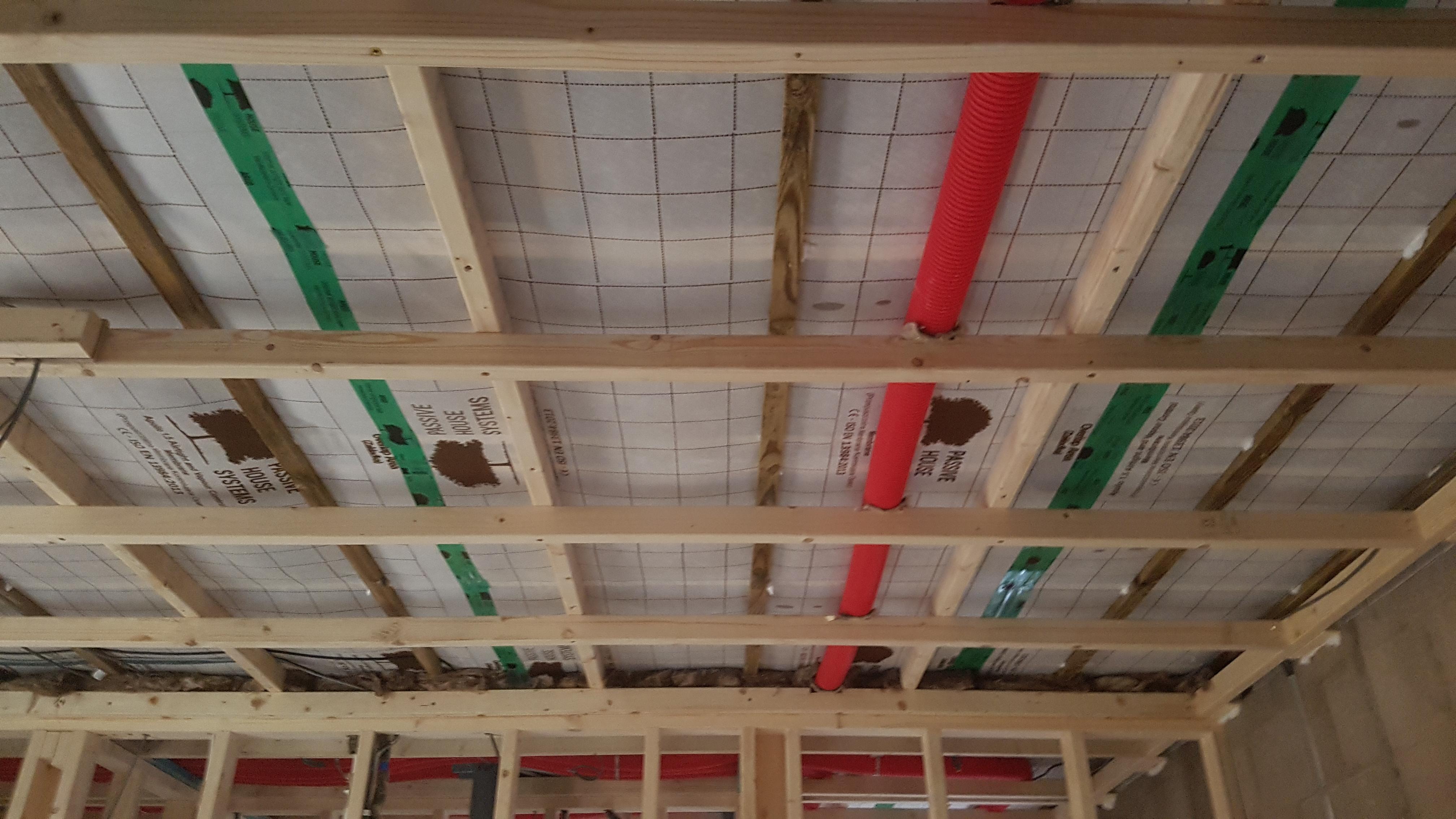

Oz07 Posted June 14, 2020 Posted June 14, 2020 Here's my hybrid. After much procrastination I went with the membrane as opposed to OSB. created a void below trusses for services. 1
tonyshouse Posted June 14, 2020 Posted June 14, 2020 How will you ensure no draughts from outside get into the void?
Oz07 Posted June 14, 2020 Posted June 14, 2020 Membrane is taped and linked down to parge coated blockwork. Only 3 penetrations in membrane all taped around 1
