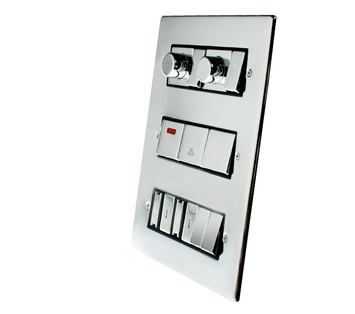

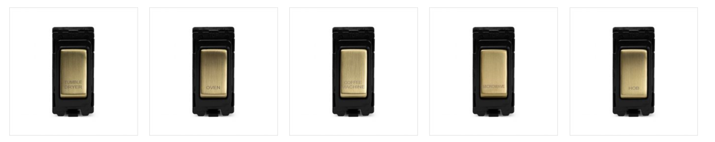

Adsibob Posted April 11, 2021 Posted April 11, 2021 On 03/07/2020 at 19:34, PeterW said: Just remember that most breakers are not double pole - you really should be isolating both live and neutral. I'm going to order a "make your own switch" grid (like this) with a bunch of double pole switches like these: But my question is: how many appliances should I do this for. Have I understood correctly that the big stuff like the laundry machines, oven and induction hob needs a double pole isolation switch for safety, but the rest is more "optional". What are the advantages of having a double pole isolation switch for each appliance?
TonyT Posted April 11, 2021 Posted April 11, 2021 Just make sure you put the deepest box in the wall possible as it’s a pain connecting grid switches! if you can get 47mm in, it will make live easier.
PeterW Posted April 11, 2021 Posted April 11, 2021 6 hours ago, Adsibob said: I'm going to order a "make your own switch" grid (like this) with a bunch of double pole switches like these: But my question is: how many appliances should I do this for. Have I understood correctly that the big stuff like the laundry machines, oven and induction hob needs a double pole isolation switch for safety, but the rest is more "optional". What are the advantages of having a double pole isolation switch for each appliance? You can get them pre-engraved and are much easier than guessing what is what. Unlikely you’ll get one that takes the 40A an induction hob takes - these are mostly 20A at best.
ProDave Posted April 11, 2021 Posted April 11, 2021 Best of luck getting that many double pole switches with large cable into a grid switch box. It is certainly a work of art and patience.
TonyT Posted April 11, 2021 Posted April 11, 2021 9 hours ago, Adsibob said: I'm going to order a "make your own switch" grid (like this) with a bunch of double pole switches like these: But my question is: how many appliances should I do this for. Have I understood correctly that the big stuff like the laundry machines, oven and induction hob needs a double pole isolation switch for safety, but the rest is more "optional". What are the advantages of having a double pole isolation switch for each appliance? The double pole isolation gives you the benefit of the appliances goes faulty and takes out the MCB/RCBO, you can isolate the equipment and carry on regardless until a repair is sorted.
Onoff Posted April 11, 2021 Posted April 11, 2021 (edited) Click Mini Grid do a 32A DP grid but it's WIDER than a "normal" grid switch from other makes. For example: Check them out here: https://www.scolmore.com/products/minigrid/ If you really want normal width grid switches throughout then you could use a 20A one but then use it to switch a contactor hidden away somewhere (accessible ?). Edited April 11, 2021 by Onoff Contactor not contractor!
Adsibob Posted April 11, 2021 Posted April 11, 2021 8 hours ago, ProDave said: Best of luck getting that many double pole switches with large cable into a grid switch box. It is certainly a work of art and patience. You make a good point @ProDave. Particularly because I’m not sure my electrician has that much patience. I’m keen not to have too many switches on my splash back above all these appliances as I already have most of my sockets there. How many appliances is it worth having isolation switches for given a new consumer unit (which will be on the same floor as the kitchen, albeit at the other end of the house) should be capable of isolating the oven and the induction hob (separately). In addition to the oven and induction hob, I will have: Full size fridge freezer second fridge dishwasher recirculating fan If the isolation for the oven and hob are each done from the consumer unit, the recirculating fan is done separately and concealed within a cupboard above the fan, the dishwasher is done separately and placed near the dishwasher, that would just leave the two fridges and the freezer. Could those three be done on a 3 gang grid, or would that be tricky as well? The other alternative is to have some isolation switches in the adjacent utility room, but not a huge deal of space there either.
