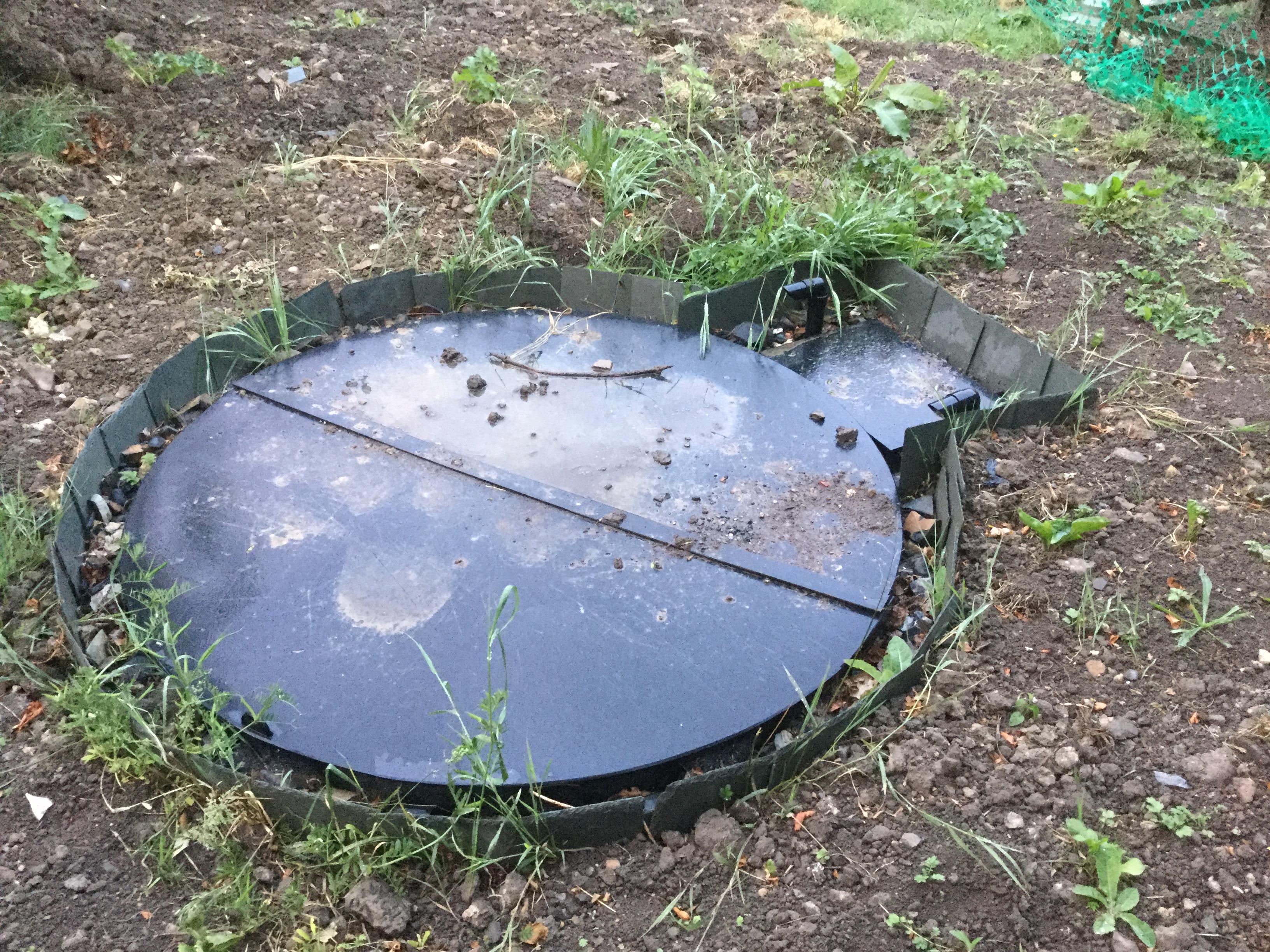

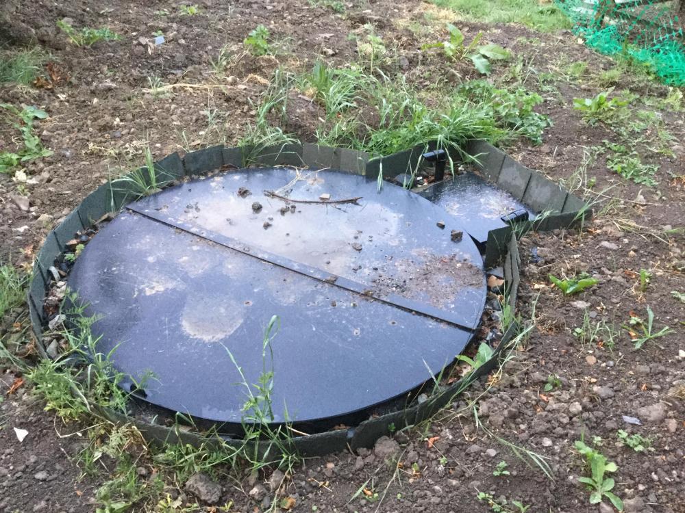

joe90 Posted June 5, 2020 Share Posted June 5, 2020 (edited) Hi @Miek here is a pic of mine, excuse the weeds, yet to do the landscaping. I dug a hole which is directly over the rumble drain and lowered the pump box onto and surrounded by 50mm drainage stone, any water that gets near it drains away through the rumble drain to a ditch. You can see two black 40mm pipes sticking up, these allow fresh air to keep the pump cool as it needs ventilation. Any questions please ask ?P.S. the existing air pipes were long enough to be re routed through new holes in the side of the tank. Edited June 5, 2020 by joe90 1 Link to comment Share on other sites More sharing options...
