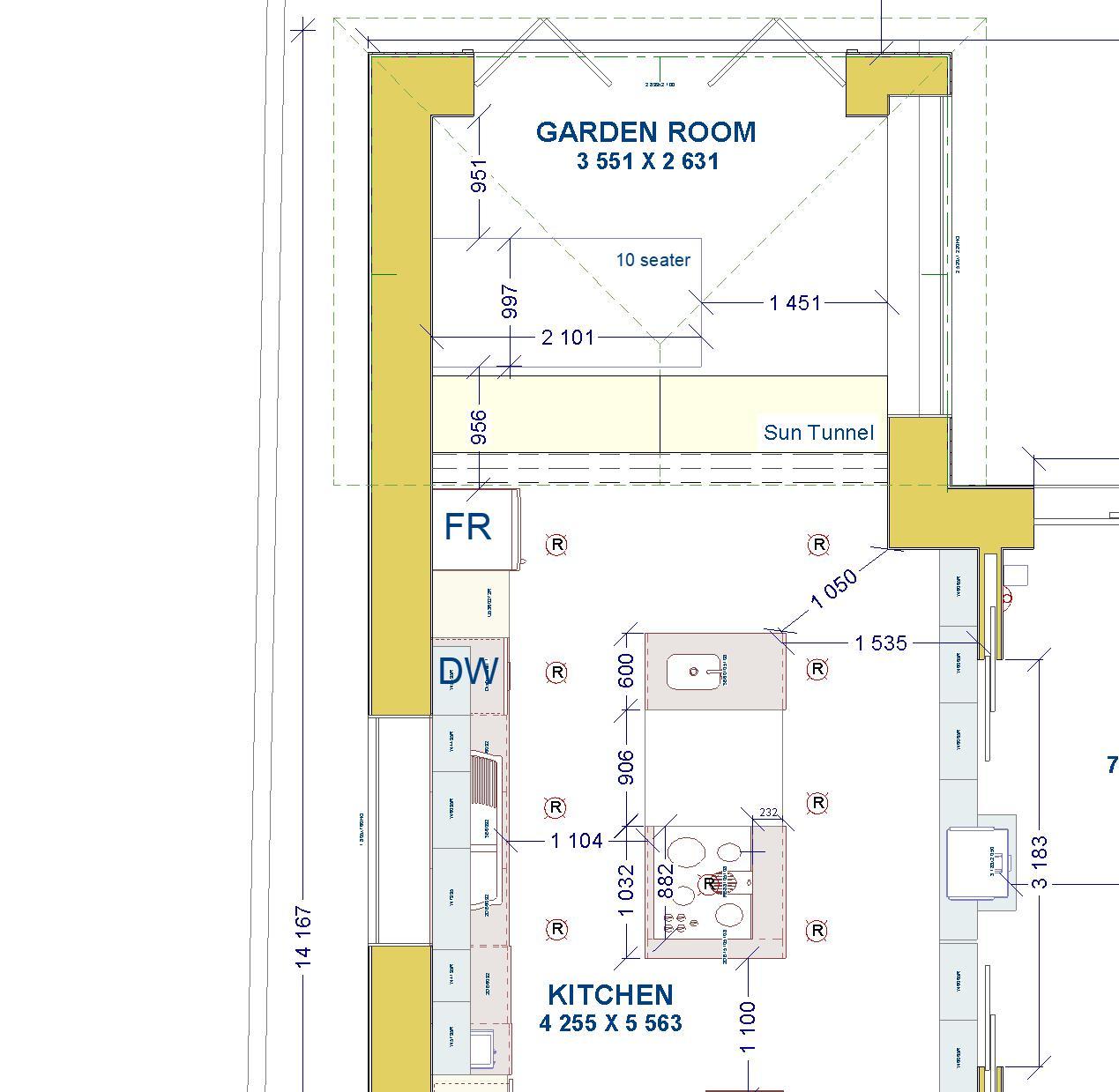

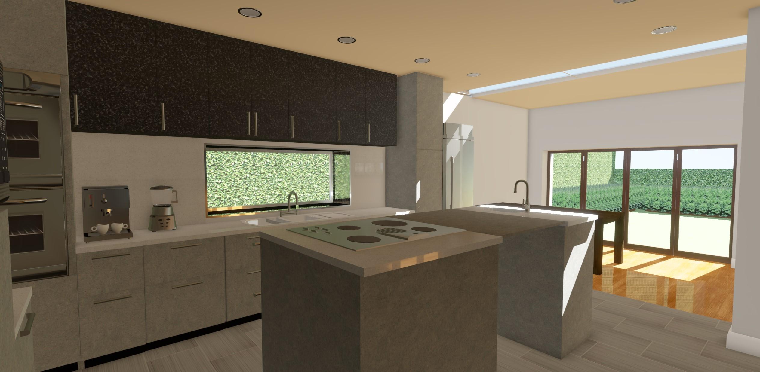

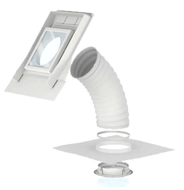

puntloos Posted June 4, 2020 Posted June 4, 2020 (edited) Has anyone got any experience with sun tunnels? Context: I'm a bit worried about my kitchen being dark, and the closest sunlight is more-or-less at the edge of the kitchen. Is there some way to 'duct' this kitchen sun light pretty much horizontally towards a more central exit in the middle of the kitchen? Or are there many downsides that should stop us considering it? See attached example: The last bit of direct sun hits the garden room ceiling as per picture, which in this example just hits the tap on the island. But while the 'wide window' is fairly classy looking as it is, I'd like to know if it is even an option to create an effective sun tunnel from the side (rather than having to punch through multiple floors!) Would this work? E.g. https://www.velux.co.uk/products/sun-tunnels/pitched-roof Edited June 4, 2020 by puntloos

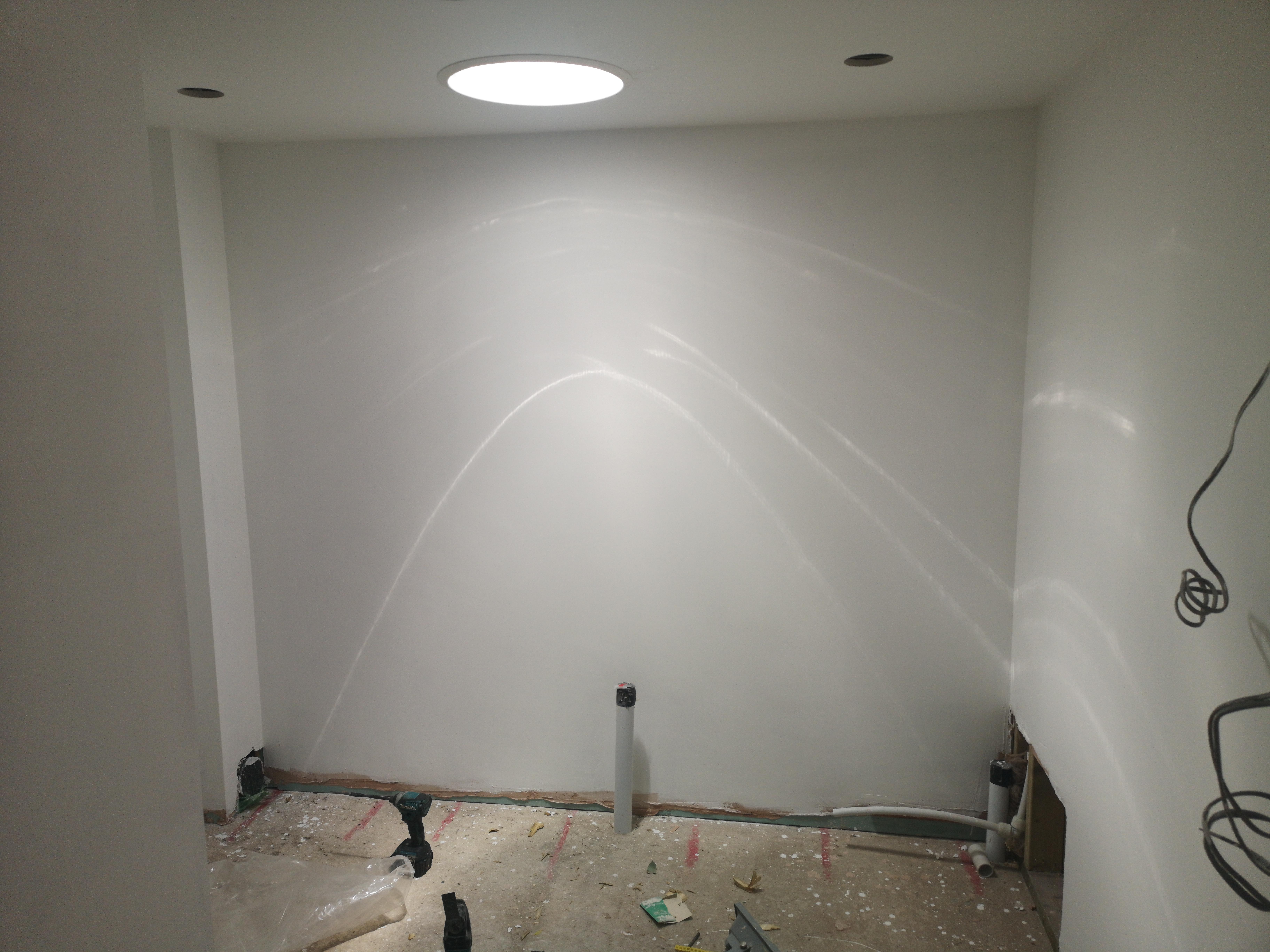

Construction Channel Posted June 4, 2020 Posted June 4, 2020 In my experience suntunnels are great. Rigid are far better than the flexible ones and the bigger the better although the smaller ones are still better than nothing. My bathroom before: My bathroom after: This is the 14" rigid velux version with about a 30 deg kink in the pipe. The insulation issue isnt really to do with the tunnel itself as you can wrap that fairly well with insulation. The issue is the 2 ends where the internal bit is a fairly rubbish attempt at plastic double glazing Hth Ed 1
puntloos Posted June 4, 2020 Author Posted June 4, 2020 15 minutes ago, Construction Channel said: In my experience suntunnels are great. Rigid are far better than the flexible ones and the bigger the better although the smaller ones are still better than nothing. My bathroom before: My bathroom after: This is the 14" rigid velux version with about a 30 deg kink in the pipe. The insulation issue isnt really to do with the tunnel itself as you can wrap that fairly well with insulation. The issue is the 2 ends where the internal bit is a fairly rubbish attempt at plastic double glazing Hth Ed Hmm dunno, that 'before' picture has a certain charm... But good to know that the kink can only do '30deg'. Surprising really, wouldn't a straight mirror not be able to bounce 90deg..
Construction Channel Posted June 4, 2020 Posted June 4, 2020 You could bend it further. I think each "bending bit" would go up to 45deg (they're a variable angle thing that you twist to incease the angle). So with 4 bendy bits you could make the horizontal periscope that you want https://www.sterlingbuild.co.uk/product/velux-6013710k14-adjustable-elbow-for-14-sun-tunnel

Mike Posted June 5, 2020 Posted June 5, 2020 22 hours ago, puntloos said: while the 'wide window' is fairly classy looking as it is Make it wider still - the full length of the wall cupboards?
puntloos Posted June 9, 2020 Author Posted June 9, 2020 On 05/06/2020 at 16:29, Mike said: Make it wider still - the full length of the wall cupboards? If I understand you correctly, right at the top of the picture, above the sink? There is a house above the kitchen though - not sure if there is side-catching sun catchers? (ha, I guess they are called 'windows' but unless we do something clever I'm not sure they will actually reach into the house very well (not a sun-facing side)
