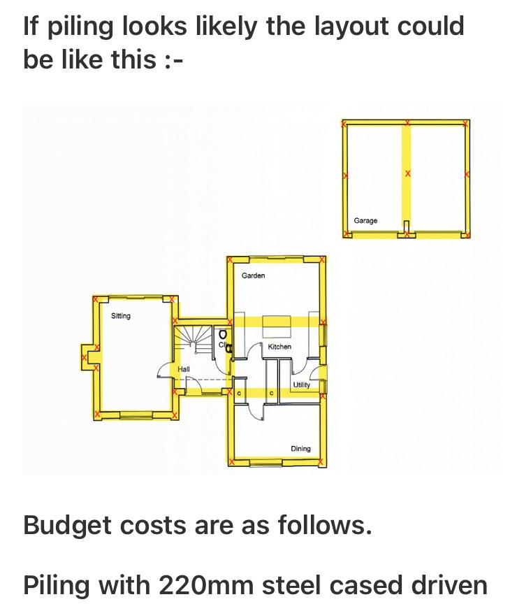

DragsterDriver Posted October 10, 2021 Posted October 10, 2021 9 hours ago, Makeitstop said: Well, for my own job, I can get pre welded cages for under £1k and the concrete isnt much on top at all. The piling cost is a killer though for six piles. for me: 8m piles £8900 ground beams £19400
Makeitstop Posted October 10, 2021 Posted October 10, 2021 (edited) Am I reading that correctly as 26 piles?....All at an estimated 8 metres?....And that's odex? For £8900? Edited October 10, 2021 by Makeitstop 1
DragsterDriver Posted October 10, 2021 Posted October 10, 2021 5 minutes ago, Makeitstop said: Am I reading that correctly as 26 piles?....All at an estimated 8 metres?....And that's odex? For £8900? steel case driven. like I said- the ground beam cost is eye watering.
Makeitstop Posted October 10, 2021 Posted October 10, 2021 (edited) So they are using a mini piling system such as grundomat yes? Driving rather than drilling is considerably cheaper, but even so, your piling costs are low, so well done on that. I had quotes for my job that were cheaper for both piles and beam using driven system that was lower than piling alone when using odex. Its nastily pricey. Edited October 10, 2021 by Makeitstop 1
DragsterDriver Posted October 10, 2021 Posted October 10, 2021 6 minutes ago, Makeitstop said: So they are using a mini piling system such as grundomat yes? Driving rather than drilling is considerably cheaper, but even so, your piling costs are low, so well done on that. I had quotes for my job that were cheaper for both piles and beam using driven system that was lower than piling alone when using odex. Its nastily pricey. yeah standard driven- the ground is fen peat/clay like a big pudding, it’s horrible! I’m going to price up the rebar to do the beams myself and see what’s what- I know the raw material cost has doubled since I last did some. Probably going to go with raised piles with beams on top which will save £20k when accounting for block and brickwork to dpc. It needs to be well over 1 metre above ground due to being in a flood zone.
Makeitstop Posted October 10, 2021 Posted October 10, 2021 I guess you have soft ground at depth, whereas I have soft / hard / soft / hard / rock, with frequent cobbles and boulder suspected. On your beam costs, for the apparent scale of it, it doesn't look overly horrible, but any saving is worth having isnt it. 1
DragsterDriver Posted October 10, 2021 Posted October 10, 2021 5 minutes ago, Makeitstop said: I guess you have soft ground at depth, whereas I have soft / hard / soft / hard / rock, with frequent cobbles and boulder suspected. On your beam costs, for the apparent scale of it, it doesn't look overly horrible, but any saving is worth having isnt it. for sure, the ground is horrific. materials have risen so sharply it’s hard to know when I’m being tight, unrealistic or what having done some steelfixing my automatic answer is always sub it out...
